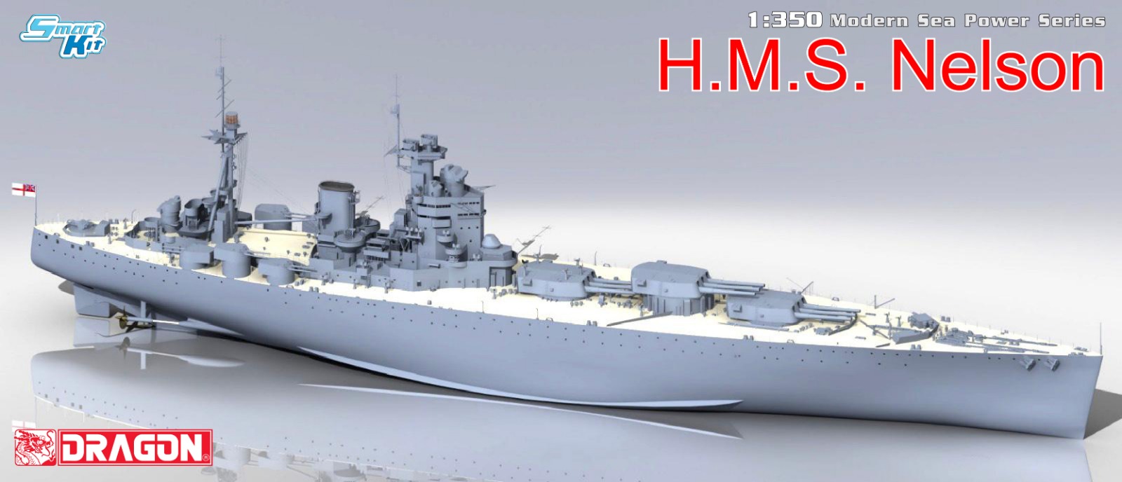

Mr. Church wrote:From FB:
I hope the hull is not the final version, at first sight I already see some grave errors... like the widest frame too far forward, and the bilge keels are note even close to what they should look like!

I'm not super clued up on the Nelson class, but shouldn't dead flat be just abaft X turret? Not between X and B as appears to be the case here...

... but shouldn't dead flat be just abaft X turret?...
When "dead flat" supposes there is a section where the hull sides and bottom run parallel, like in a tanker or a container ship, then the answer is clearly 'no'. In technical terms this is called a "constant section".
From stem to stern the hull shape of these battleships first gradually increase their frames to a widest point, roughly halfway, and from there reduces again to the stern. But there is really no two frames having exactly the same shape, and hence no constant section.
In the pictures (renderings) of the new model however, it seems the 'widest point' is too far forward, and it's clearly visible too.

Well, thank you for explaining what "dead flat" means. In this forum your translation "absolutely widest part of the hull" is something we all understand.
The point in question was that the 3D rendering of the announced Dragon 1/350 kit shows this "widest point" to be too far forward on the hull, whereas it should sit at the "X" turret, not further forward than that.

Thank you. I agree with you about the apparent position of the "dead flat."
It will be interesting to know if the Dragon 1/350 hull is of the correct form once someone has had a chance to review the kit. The manufacturers must have got the dimensions from somewhere. If the form is not correct, the question is why?
