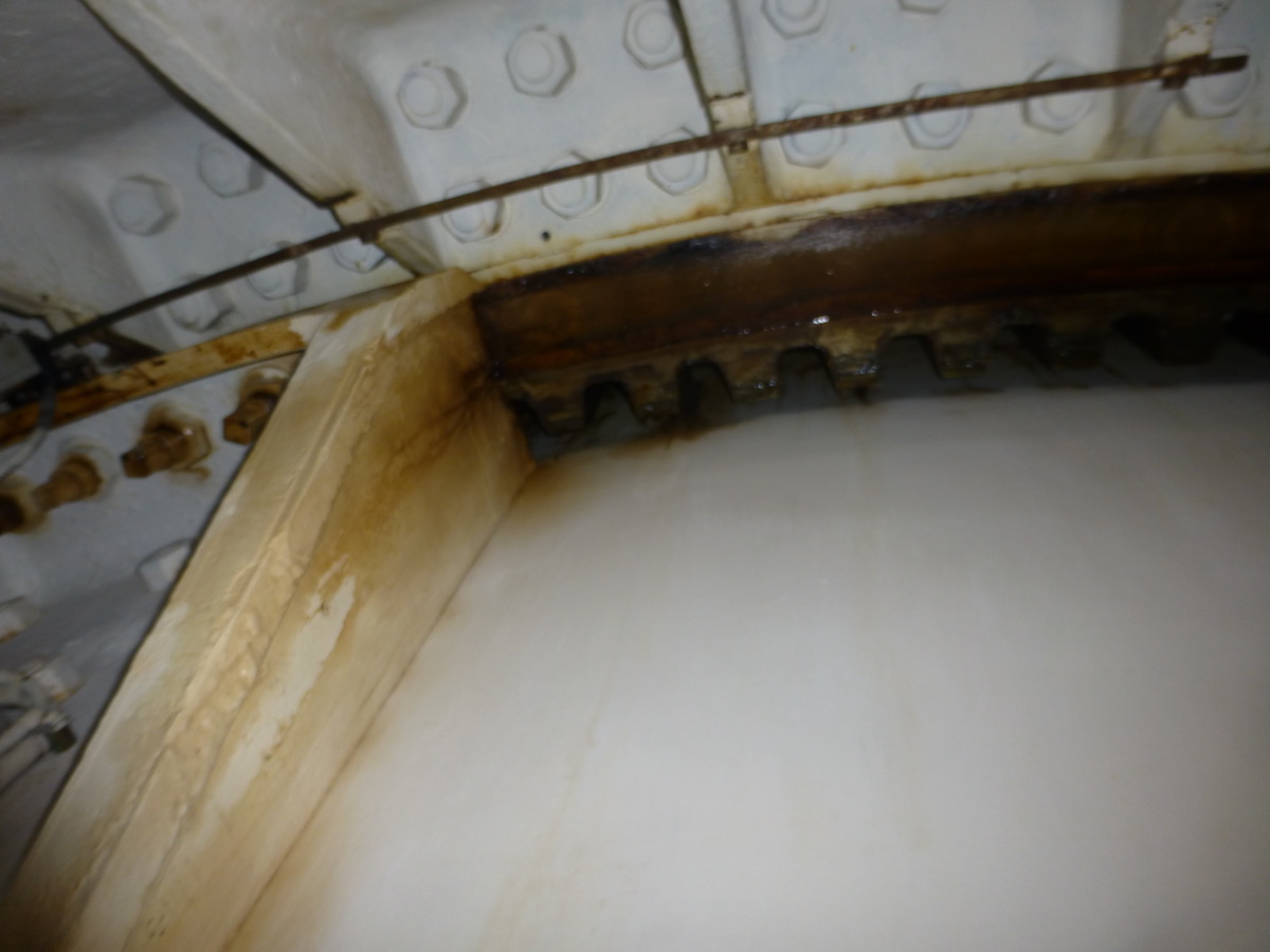

More Turret Stuff
Post by bigjimslade »

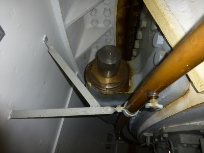

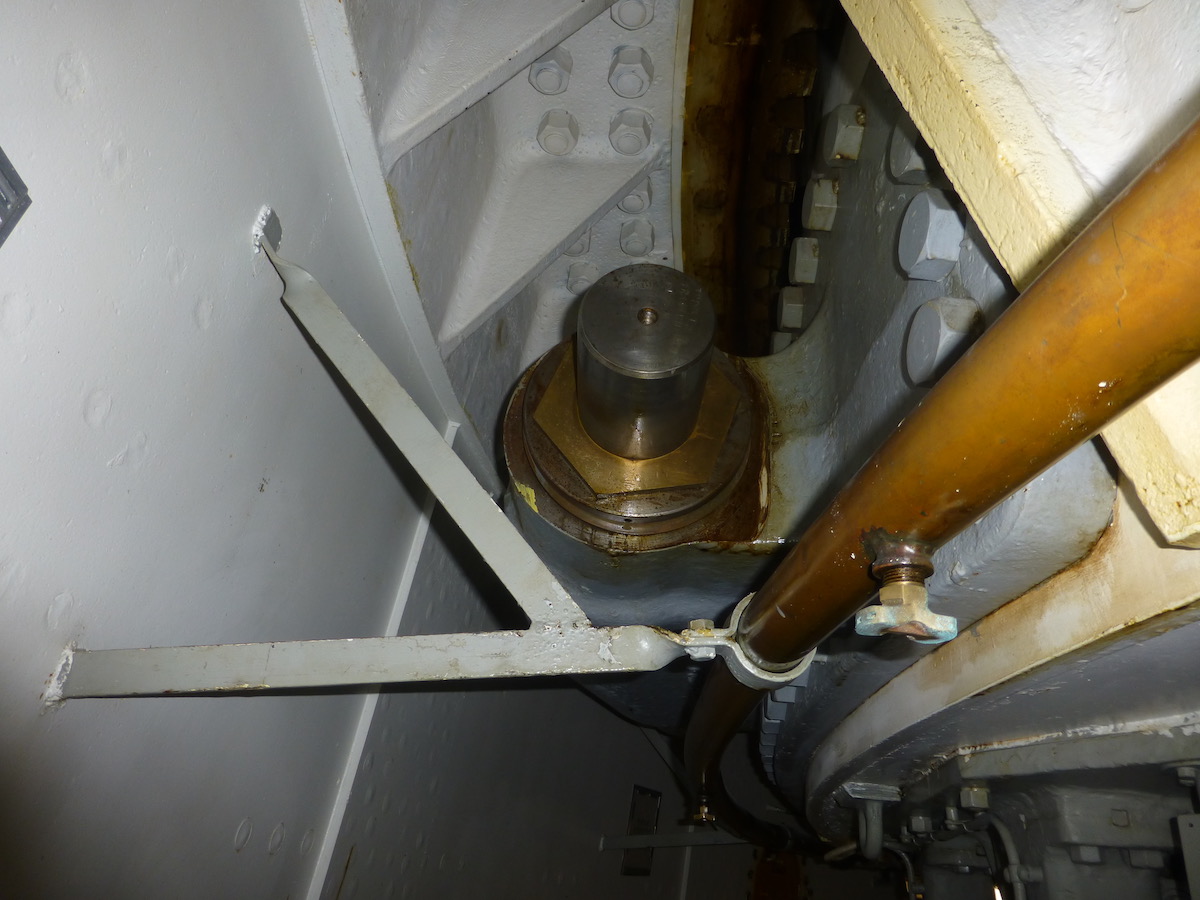

To the right is the circular gear that rings the turret support. The turret motors drive gears against this to rotate the turret. To the left is one of the turret clips.These keep the turret from lifting upwards.
Although not visible, the bolts connect the lower roller track to the lip shown. This is the point where the turret rests on the ship (it does not rest on the barbette, contrary to appearances otherwise).

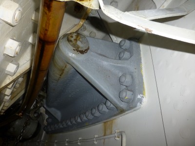

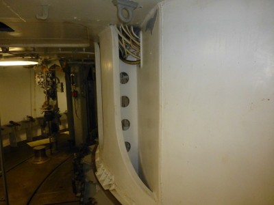

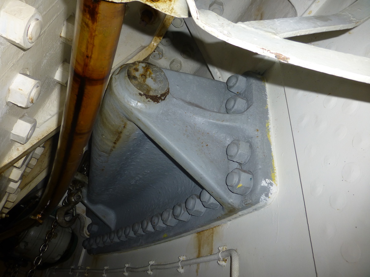

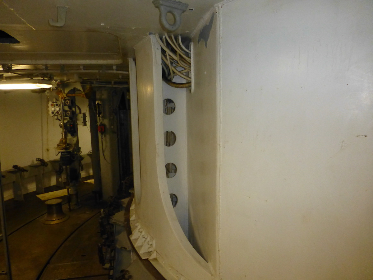

This is the turret buffer. It is attached to the rotating part of the turret. The projection cuts off the turret motor when it is pushed in. There is one on either side of the buffer.
This is one of the two turret stops that the buffer can run into. It does not look like the turret was rammed into the stops very frequently.
