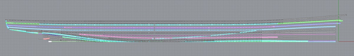

NARA has the plating in uFilm.chuck wrote:I�ve never seen any official plating plans or plank expansion plans for the Iowa class in public circulation.
There are planking "plans" as well but it looks like such plans were guidelines and it was just done largely according to tradition. I learned yesterday that entire deck of the New Jersey was planked, except at the bow and helipad. The dark areas (that change over time) at the stern are rubber mats. To save money, the navy poured copious quantities of adhesive over the stern planking to fill in rotted areas then put mats over the top.
In regard to the plating, the plans are difficult to read and you have to look at a lot of them. I have been picking at it but am not finished. I have to decipher if a number is a 3 or a 5 or a 1 or a 7.
My still unfinished attempt (bow not shown here):
I don't have this in any state where I can share it yet and someone else could make sense of my files.
One thing's fur shur: The kits doing plating get it wrong.
Strakes can be scarfed, overlapped, overlapped with double plates (so no overlap is visible) or butt joined with butt plates. I have not figured out any rational plan behind the overlaps. There are some weird ones where the bottom plate overlaps the top plate then suddenly it reverses.
The edges of the strakes do not follow knuckles in the molded lines. You can see the knuckles bent into the plates but the effect is much more subtle than what you see in the molded lines.
If you are doing a model, the only plate lines you should show are the ones where the plates overlap and those only occur at the bow and stern above the waterline.
There are some sections of the hull that are castings.

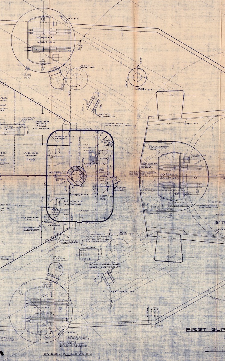

This shows the pattern of numbering.Fliger747 wrote:Wonder what the nomenclature was on the 40 mounts. More than ten of those and they wouldn't go to 50 mount etc. Three digits?
It front to back with odd on right right and even on the left. The centerline mounts can be either even or odd (and shift the numbering).

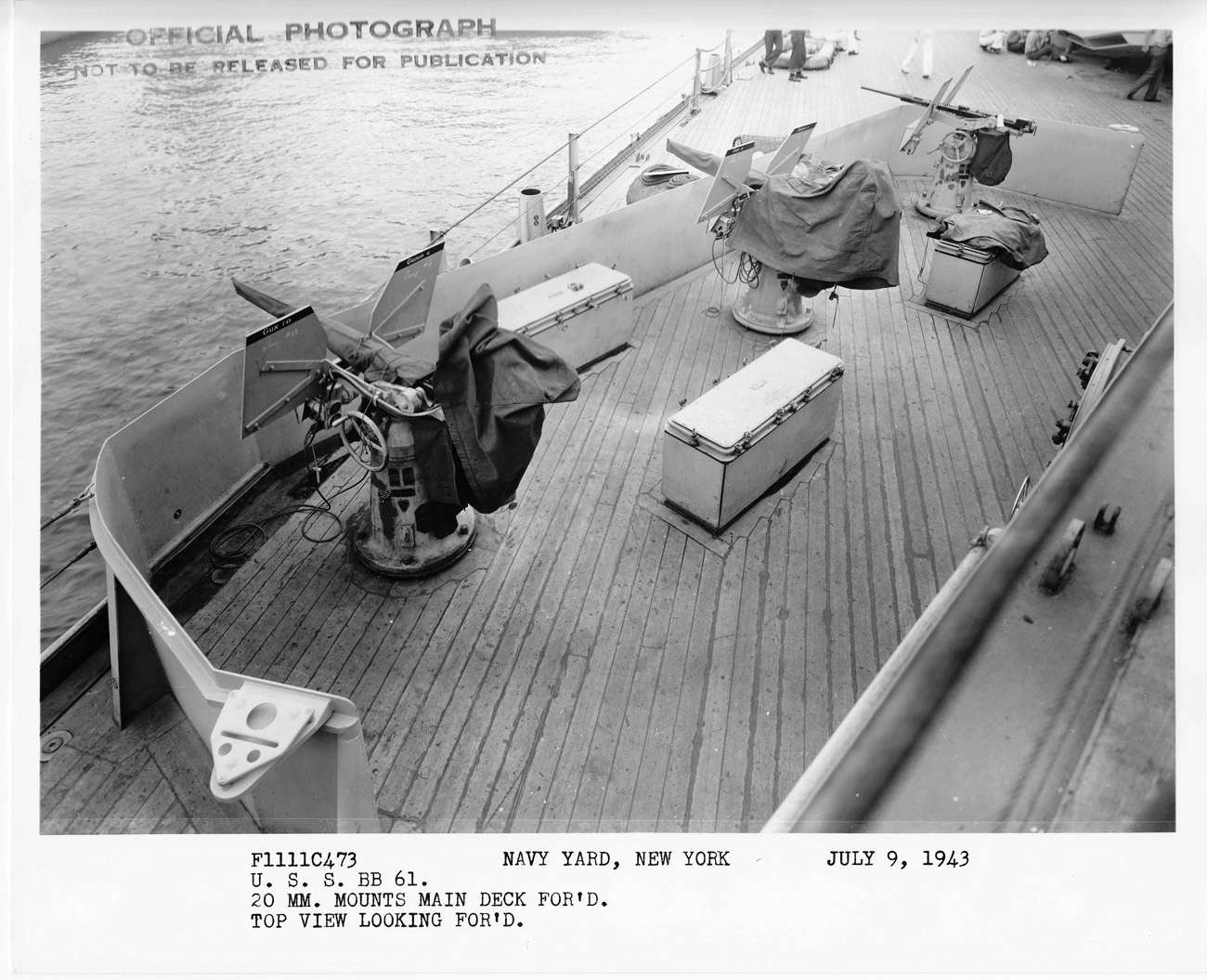

Re. the 40mm plan:
Using this plan and obvious visible numbering, this makes the forwardmost 40mm mounts as Mount #1 (starboard side) and Mount #2 (port Side) - I would guess that the F.C. Directors are numbered accordingly also.
Since all my reference materials are packed up (including my MO Plan Book!!) I'm wondering if the TFD MISSIOURI Plan Book doesn't also have the 40mm mounts numbered as well.

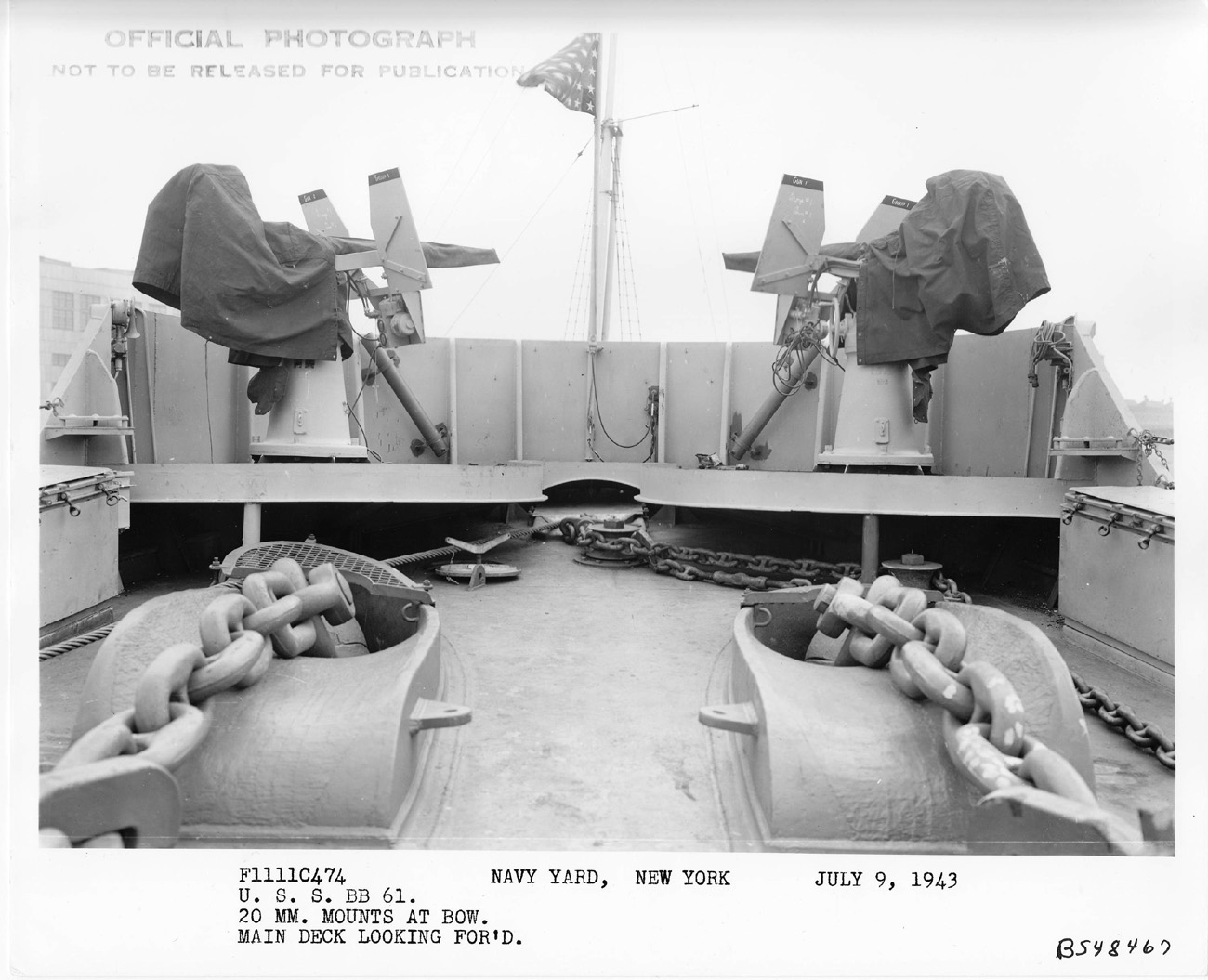

On the 20mm mounts: Below are a couple photos from IOWA which show the backside of the 20mm Shields - both the gun and group numbers are shown in white, block lettering. We could therefore conclude that the other IOWA class were similarly so designated: If you zoom in you may be able to make out these details. I haven't found any photos of the 40mm mounts from the backside which show the mount #'s, etc.
Hope this helps,
