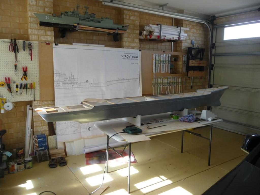

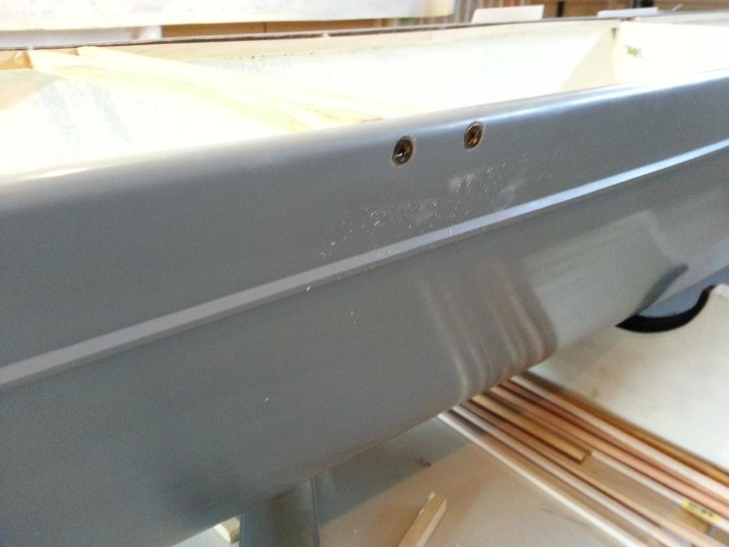

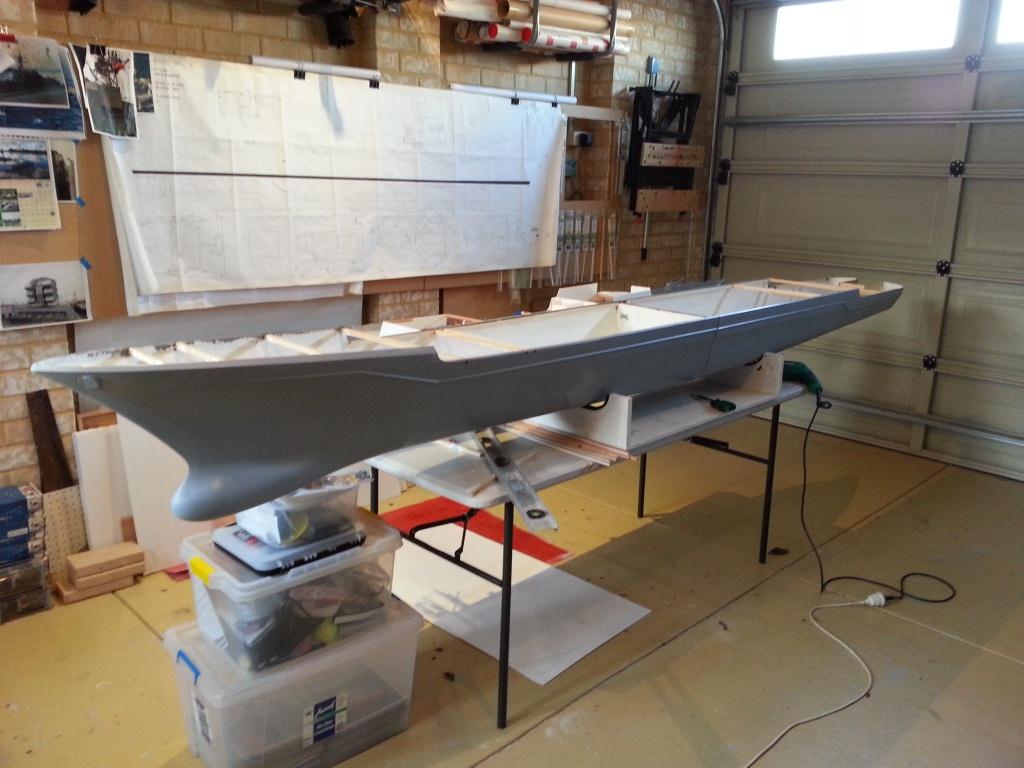

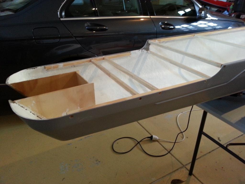

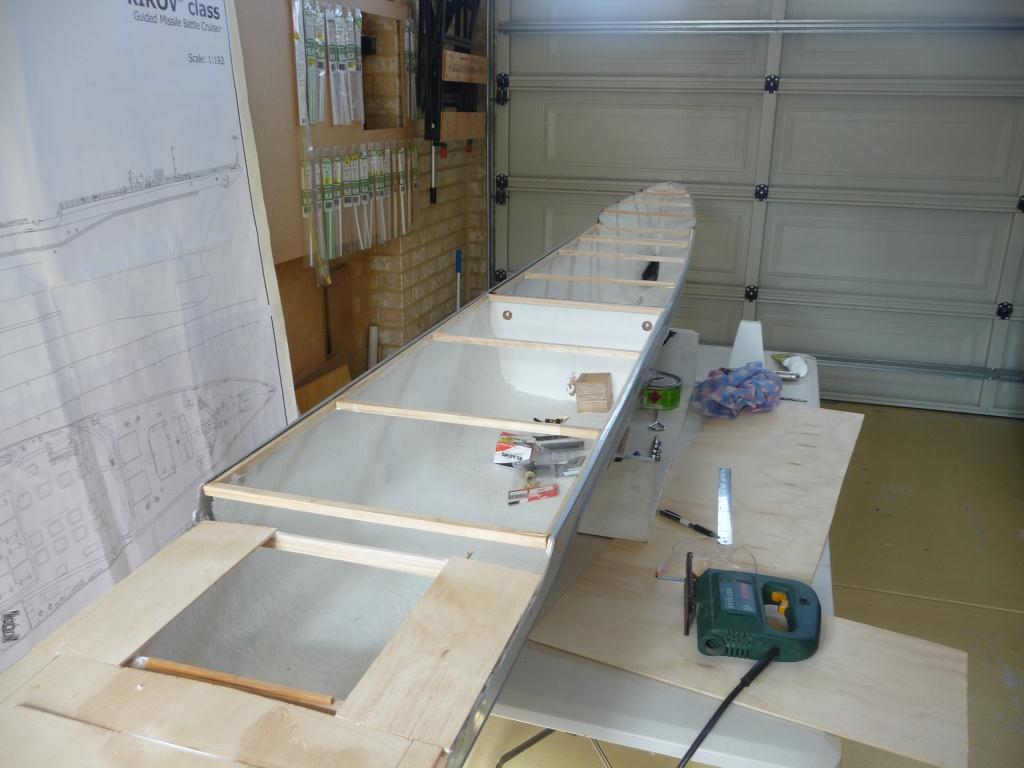

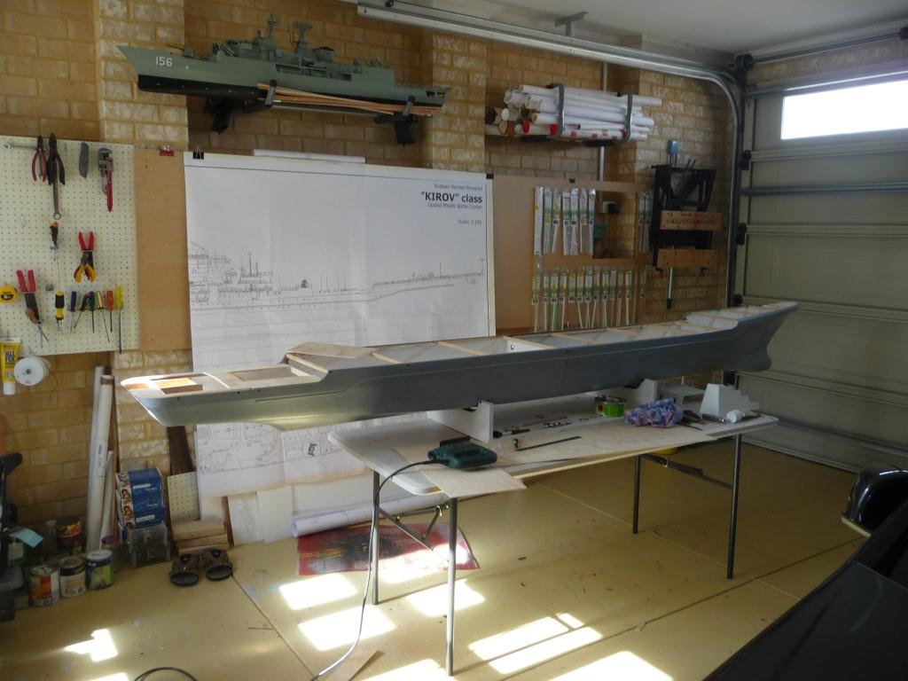

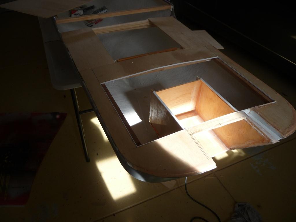

Hi all, well it has been a while since I have been able to get back to the battle-cruiser. I�m strengthening up the stringers and doing the cross-members. Following a few builders idea�s over here in Australia, I using counter sunk screws to hold in the stringers (besides the resin) and also longer ones for the cross members. These will then be covered with filler and sanded back, so once the hull is painted you will never know they are there.
I may also put in some "blocks" around the water tight bulkheads with countersunk screws to increase their strenght.
The cross members will get a "curved" top glued onto them so I can shape the deck as per the real kirov's.
Robert

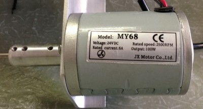

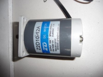

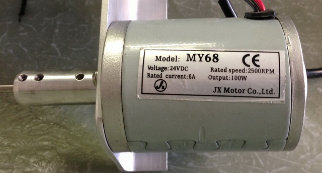

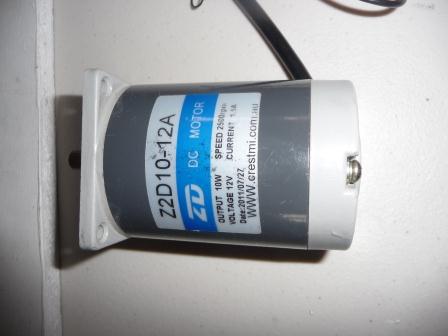

Hi Dave, at the moment I'm planning on using two of these, they can turn a 60mm prop for considerable speed, so hoping the cruiser's props (although still larger) will be ok, it will be an experiment though.
they are 2.5 Inches in diameter and 4inches long.

Yeah those motor's are very torquey Ideal for large dia. props and if you need more speed turn the ESC's speed up! (If its an Electronize unit!!) :thumbs_up_1: :thumbs_up_1:

They are thru the TF72 club shop mate, Give Michael Brown an e-mail to see if he has any left (I think they are $50each) Jim down here in Adelaide has 4 in BB63 (turning 78mm props!) and she hauls A$$!! :heh: :heh:

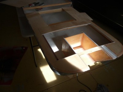

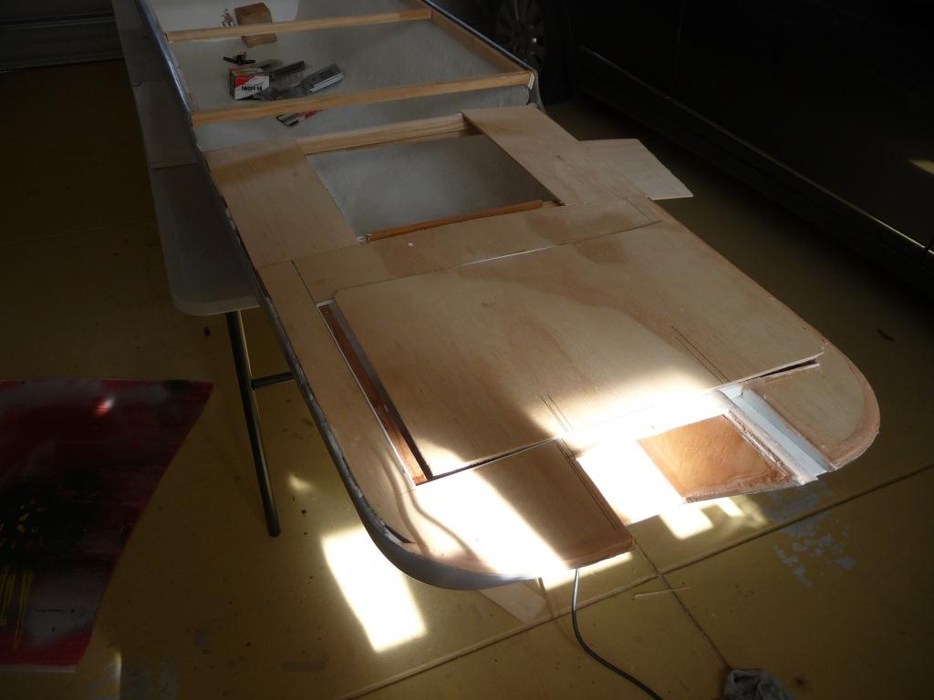

Time for an update, I�ve been much delayed with uni study and work, but today the decks started. These will take me a little, as I need to leave holes for removable sections (such as the forward missile launchers and anchor winches) but her quarterdeck/flight deck, will have two openings, one for accessing into the Towed sonar array dock as build that later, but also more importantly it will give me access to the rudders and servo without the need to take off a deck. The second area is for access to her helo hanger. Whilst I do not know about the operation of the elevator (maybe later) I will have the doors opening and closing so that people can see the unique helo hanger when the model is at a static display.

I like the idea with the working hanger doors . Question are there any other working features you want to include in the build?

Rob well done on your Kirov Hull. I like that you plan to have a working elevator on your aft deck. Do you also plan to have the VDS working? What about the Torpedo hatches? I want mine to work on my Frunze. I might even think about a few rockets but that will depend on safety if I go there. Next time I get a chance to look at someone else attempt, I want to even try a working anchor system.
Your aft hatch is rather large, I guess its for access to the rudders and VDS. Is the area covered by the helo netting to small? I was thinking about that size of hatch myself. Keep up posting of your model I'm very interested.

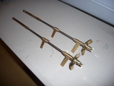

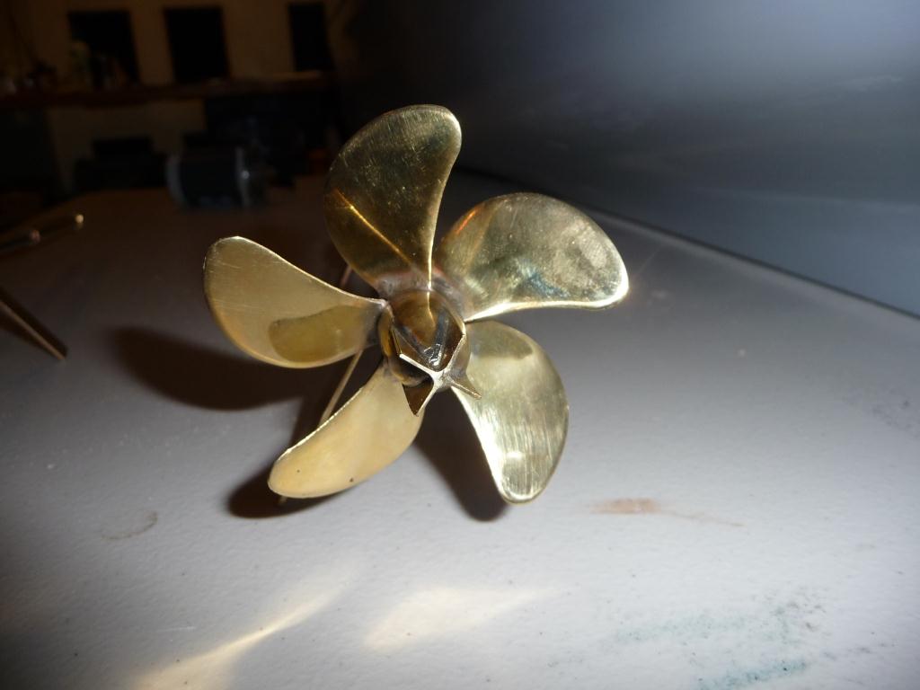

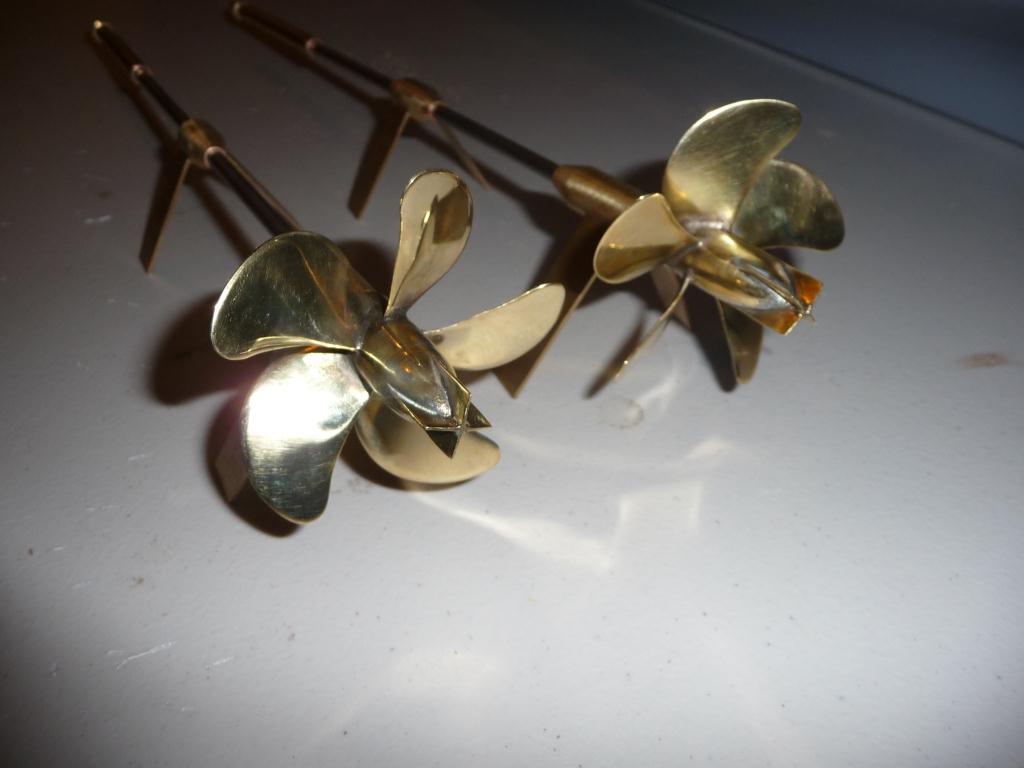

Well today is a very good day, as I arrived home to two new sets of running gear from George Sitek. Scharnhorst (also 1:72) and Peter the Great.
George�s skill never ceases to amaze. I sent him some photos, the size I needed and I get back an excellent copy.
The shafts are 450mm long from tip to tip, 6mm diameter and the props are 80mm. I�m not entirely sure of the weight as I have not worked it out yet, but I�m estimating about 35KG finished and ballasted.
Moving parts wise, I�m planning the following, although not all will be installed at build, some I will come back and do, such as the missile launch system.
� Independent engines.
� Rudders.
� Nav lights
� Flight deck lights (seperate switch to Nav lights)
� Opening VDS door (this will be for static displays so people have more to look at, not for whilst she is sailing)
� Opening Helo hanger doors (also for static display to allow people to see inside)
� Navigation radars (will always be working)
� Firecontrol radars (will run off a seperate switch so they can be switched on and off)
� One of the anchor winches
� Rotatable main gun
� Working missile launcher.
So this weekend, the running gear goes in.

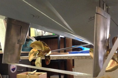

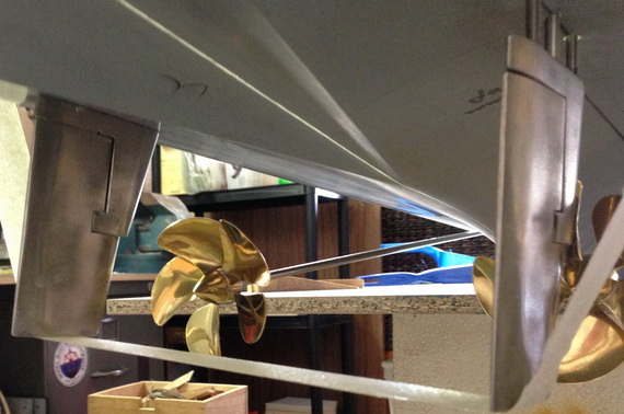

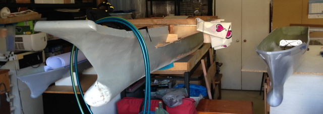

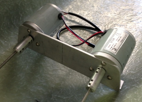

Well Rob today I started a bit of work on my Frunze. Set up the area for the shafts through the hull and where I will place the motors. My props don't have the cross in the middle yet, I'll add that later maybe. Also included some pictures of the motors I plan to use.

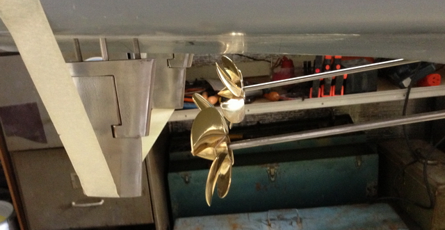

ozpirate
Posts: 473
Re: 1:72 Kirov class battlecruiser
Post by ozpirate »

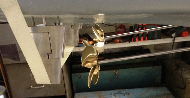

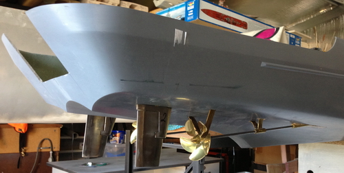

Well my props shaft and Rudders are now in place
Working on stabilizers today.
