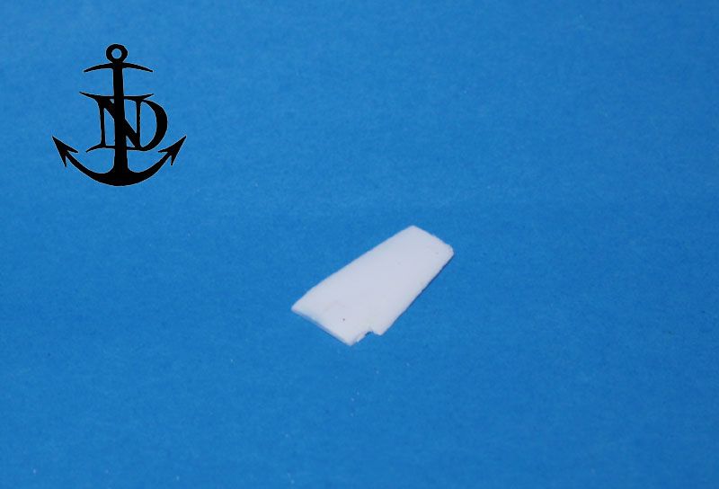

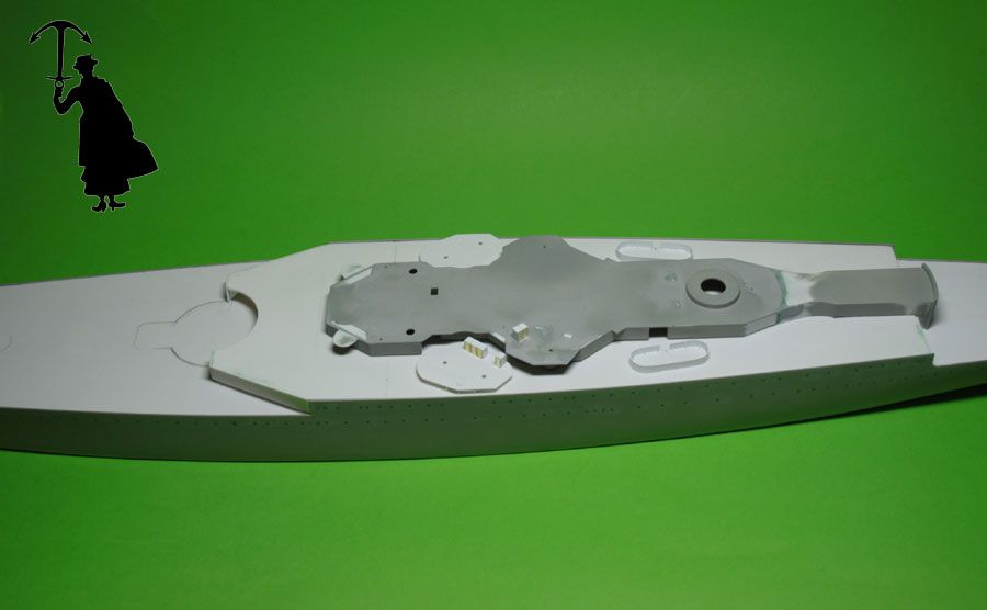

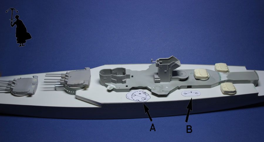

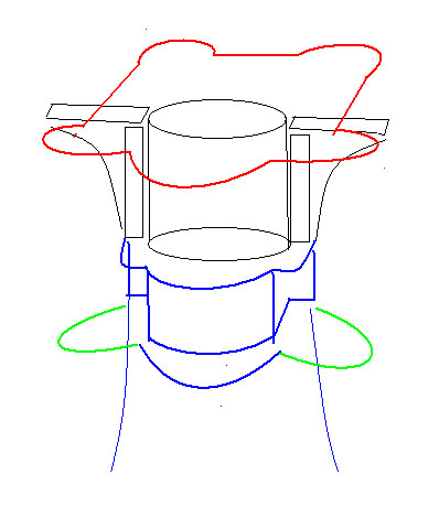

Hi gents
thanks Christian !
a small error is slipped into my latest transformations, I cite
"openings 5 ??on the starboard side and 7 on the front" hey well all wrong !.... at least ,mainly on the front face, the exact number is 6, error that I corrected immediately:-)
The superstructure at the rear of the chimney is amputated these two "wings"
et les cloisons sont refaits en carte plastique
to show you the next steps, a larger view
in A ,the platforms of 100 mm that I will redone,starting from a plan of Mr Dumas
in B ,Mr Dumas,represents bulwarks surrounding the 37 mm CAD ,for the moment I have no confirmation their presence on photos, but I do not despair to find them
cheers
Nicolas

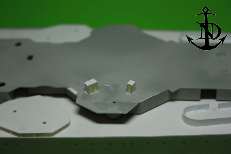

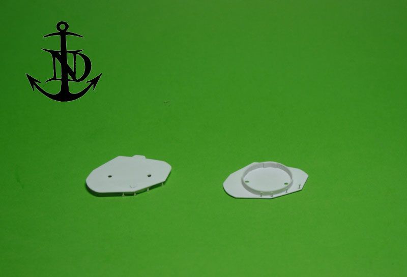

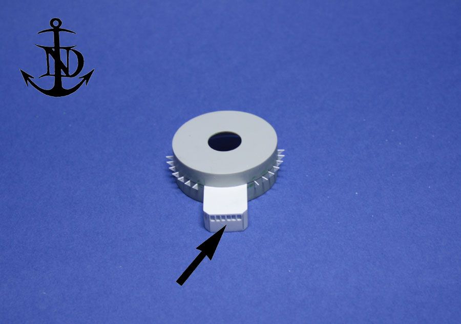

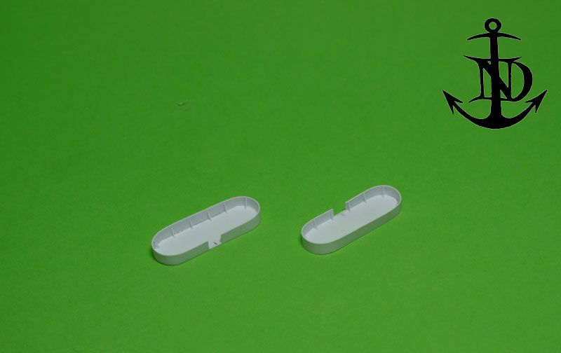

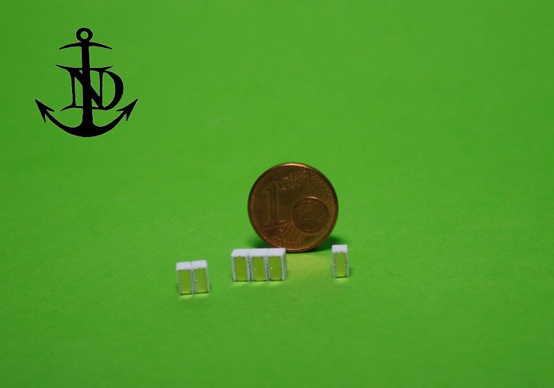

Thank's Guys

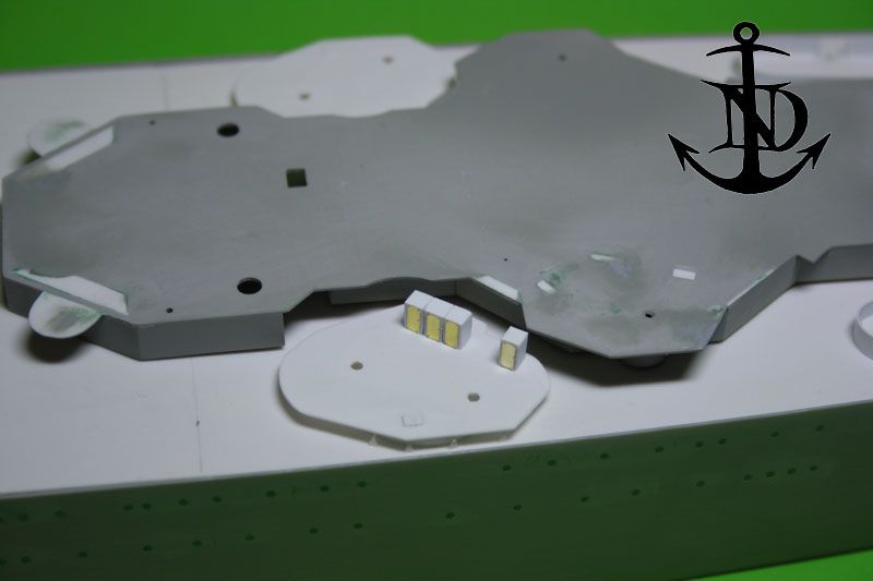

the work ahead, and last night I finished with the platforms of 100mm
and "bathtubs" of 37mm
on the platforms of waterproof boxes for ammunition were present. all three types are present, (they will duplicated in resin)
the position of boxes on the platforms
and the location of the roof
a small overview
Here, I will now move on to something else, and this is not what is missing
cheers
Nicolas

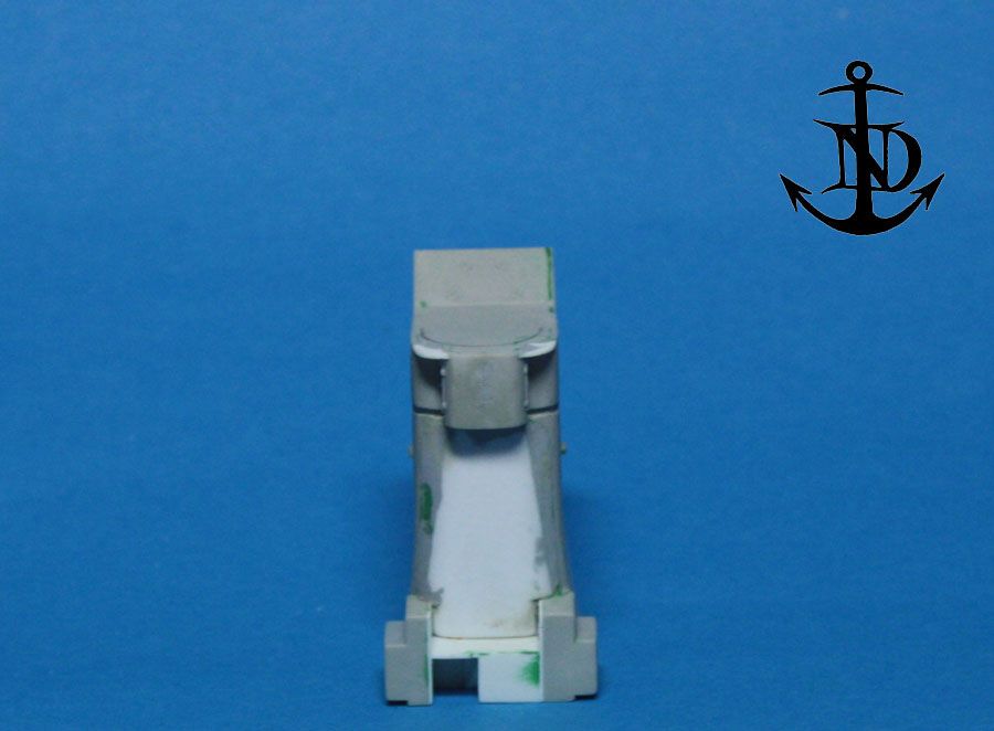

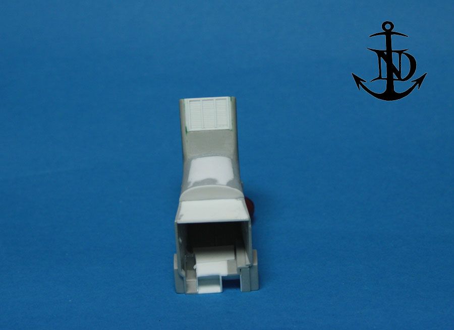

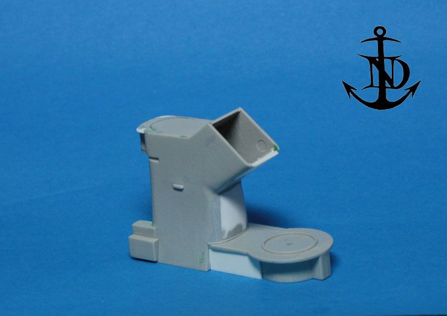

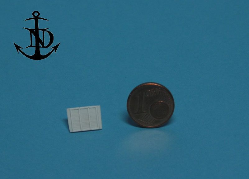

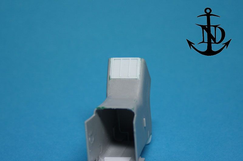

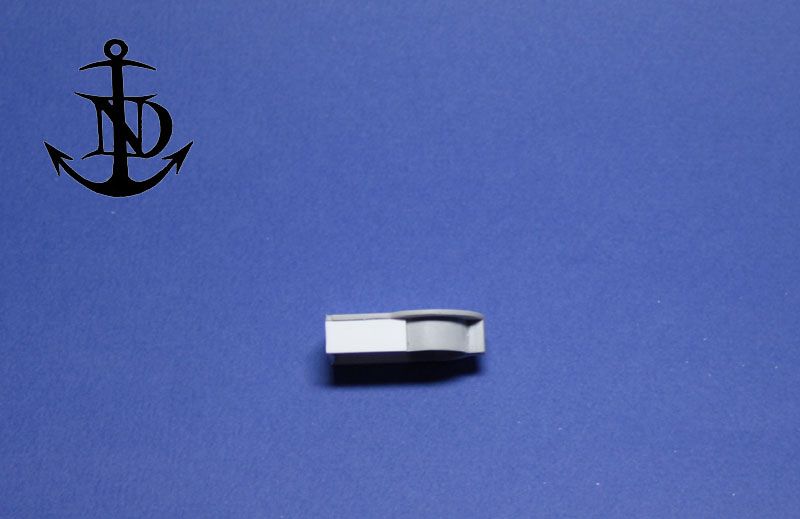

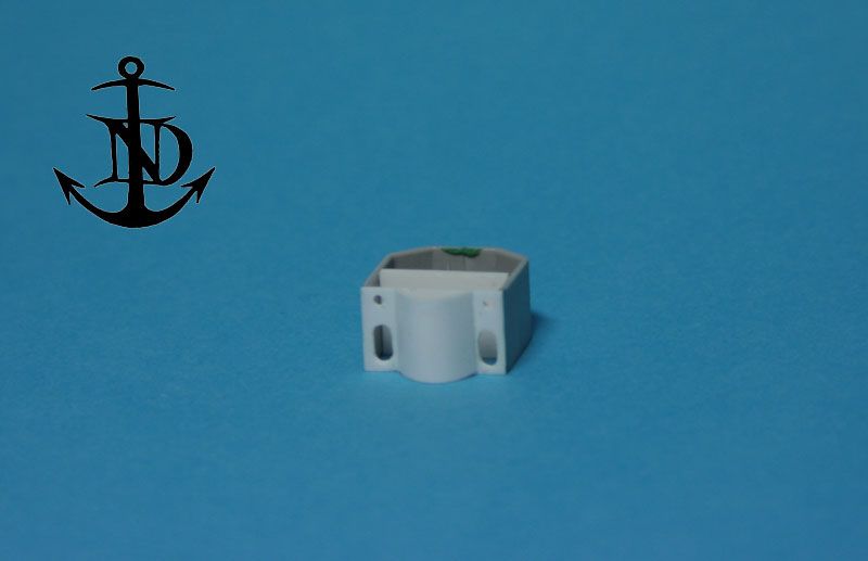

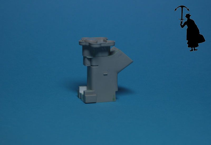

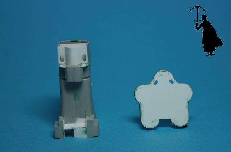

HI all
thank's for your kind comments!a little progress on my Richelieu

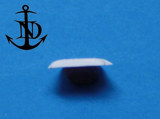

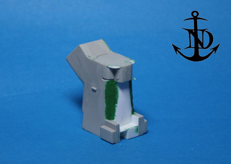

an air vent in the oblique portion of the chimney,has been forgotten by Trumpy!on my first mounting,I did not make a copy in resin,
this time around I make a (for a 3 richelieu ???
a copy in place

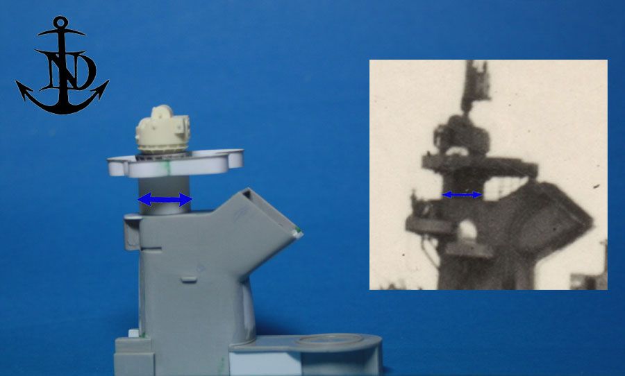

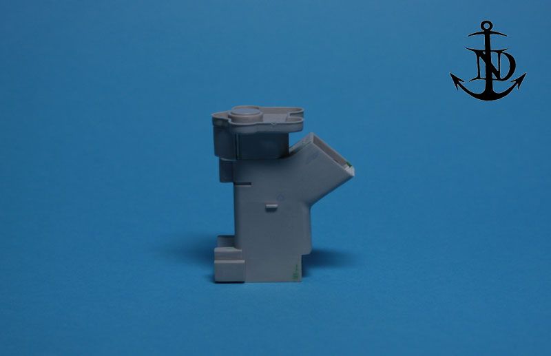

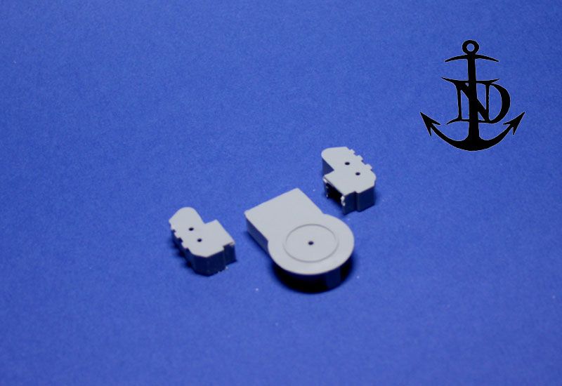

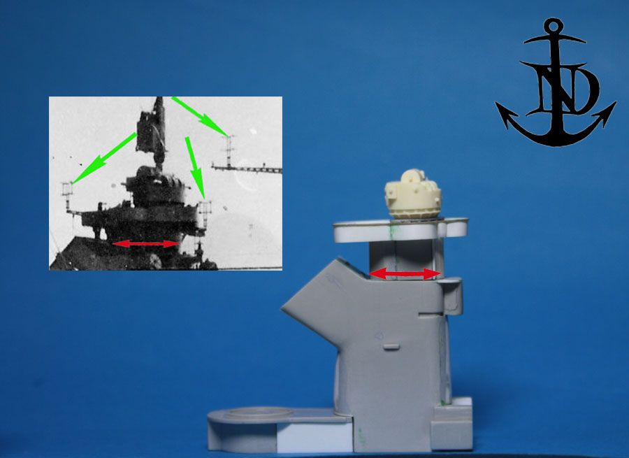

for the version after 43 the chimney and the superstructures ,have this aspect
but for the 1940 version a litlles differences exist,in particular,this block under the platform

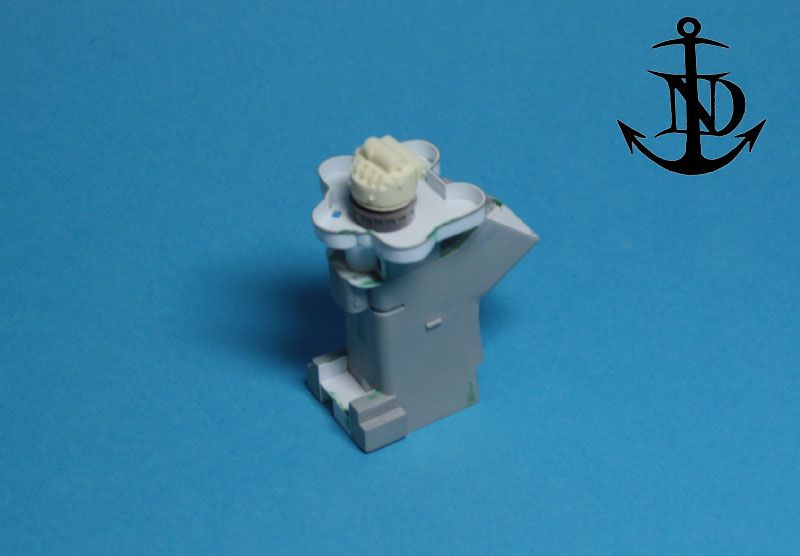

the block in place whith the new platfom and thebeginning modifications blocks aerators
giving a different appearance (more conform)to the whole
see you soon
cheers
Nicolas

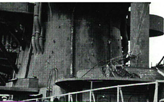

Re: 1/350 RICHELIEU Dakar 1940-41

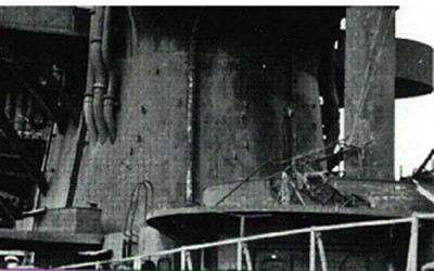

Hi le bosco,there are two pics,the first one is from jean bart,and i especially observe her basal part of chimney which seems like pyramidal and more oval like contour. the second one is my sketch about the elusive part under the platform,which i suppose it to be a standard cylinder with two wing like yardarms and aisles between them?The info about the cylinder structure are scarce, but I surmise it from 1935 the original plan of "serive historique".Thanks for your suggestions
sirmaumau
- Posts: 173
- Joined: Fri Mar 28, 2008 10:02 pm
- Location: hangzhou china
here is the lost pic

Hi all
to reply to Sirmaumau ,in my last post ,the configuration under the platform,corresponds to the Year 41 (may), indeed,under the platform in 1940 (upon arrival to Dakar) the Richelieu is not completly finished ,especially the chimney
the "round" corresponds to the base of the rangefinder armored
the poses of yardarms and of D.E.M antennas (Detection Electro Magn�tique) (green arrows)allows me us to date the progress of finishing under the platform (may 41)
if not, for the base of the chimney, on my first Richelieu ,I did not make the correction,but ,on this one,I adjusted and profiled the thick plastic card on the front face (and rear face)
"the dressing" in place with putty
the front and rear aftet the "treatment"
the effect without being of more consistent with the reality,is pleasant to the eye
Christian ,to the next platform,promised, I detail how to make the bulkheads (if I understand your question
