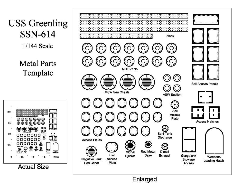

UPDATE 23
Hi All!
It has been a while since my last update, but that is not because I have not been making progress. Rather, it is because it got to onerous maintaining two logs, and the other Forum I have been posting to, the SubCommittee Forum
(http://s181686668.onlinehome.us/phpBB3/ ... 35&t=11272), allows posting multiple pix at one time rather than having to put them in one by one, which is a lot faster. Anyway, the AutoCad model is completed, so I thought I would post the final results.
The first image shows the port side view, as well as the front and aft views.
The next two images show the starboard side from oblique angles.
Here is a close up image of the forward escape trunk area. You can clearly see the sonar fairing, the retractable cleats, as well as other detailing.
In the next image some of the detailing on the port side of the sail can be seen, including, but not limited to the bow-light/jack staff attachment (the staff itself is not part of the model), the hull numbers, the ladders, the port side navigation light and the open bridge closure and windshield (another good thing about the plastic being clear).
The next image shows the forward section of the ship on the starboard side. The sail including the search and attack periscopes (aft), the BRA-21 Antenna, the BRD-6 ECM, the top of the BRA-21 antenna and snorkel inductor (fwd) are visible on top of the sail. All but the top of the BRA-21 antenna are separate parts. The bow light/portable jack staff is seen on the bow. Barely discernible aft of the sonar dome line are some of the bow draft numbers.
An image showing the bottom of the ship, as seen from the front, is shown next. You can see the some of the MBT flood hole baffles, the rod meter (not included in the model) and the Secondary Propulsion Motor (SPM).
The SPM is shown in more detail in the next image. Additional MBT flood hole baffles may be seen as well. The hole at the top of the picture is one of the mounting holes.
As you can see from the images, if you have been following this build, the final product is a bit more elaborate than I originally imagined. The final part diagram is shown below.
As you can see my original concept of a dozen parts expanded a wee bit to 27 parts. Designing the model in AutoCad was so much fun that I just kept going. I figured that even if my buddy can�t make all of the parts, the fun of doing it made it worth it. As for the SPM assembly, that was probably a little bit of an overkill, because I doubt if it will ever be retracted, but making it retractable was beneficial for three reasons. First, if it was fixed to the hull, it would be a protrusion begging to be broken off, so making it a separate part eliminated this potential. Second, I think it is a cool feature (if it works), even if it is never used. Third, it was friggin� fun to do!
The final image shows the metal parts template. It is shown actual size and enlarged for better viewing. As you can see, it also got a bit more elaborate than I originally thought, but not by much.
Now that the design has been completed, the DWG (drawing) files have been converted to STL (stereolithography) files and sent to my buddy, the waiting begins.
How long the wait will be, I do not know. My buddy leaves for China Thursday and will be gone 2 weeks. Since I would be extremely surprised if he got them made before he leaves, I expect the wait will be 3 weeks or so. What happens next? I have no idea.
To begin with, I�m not sure my buddy has had time to look at the latest design, so I�m not sure that he knows that it has expanded from 12 to 27 parts. Though I think the chances are small, he may not be able, or willing, to do this many parts. If that happens, I will have to rethink the design.
Otherwise, it all depends on how the parts turn out. The test parts, even though they fit together well and had sufficient detail to show that the moveable planes was possible, were a different design and did not have any detailing, so I really have no idea how they will turn out. Under the best of circumstances, I am not na�ve enough to think that Murphy (as in Murphy�s Law) won�t make an appearance somewhere. With 27 pieces, it seems unlikely that I won�t have an issue with one or more of them. The question is how many there will be. And how hard they will be to fix.
The metal too, is still a big unknown that we haven�t talked that much about. He told me where to get the metal, but I haven�t started looking into that yet, and even though I have completed the template layout, we still haven�t talked about what format he needs it in. In my limited experience with laser cutters, 2D line drawings were used and I imagine that is the case with the one he has. I also do not know if the laser he has can etch as well as cut by simply reducing the beam strength, or if it can only cut.
So there are still many unknowns to come. I�ll keep you posted when something changes.
CHEERS!!!

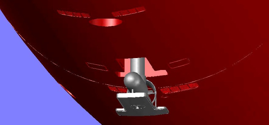

UPDATE 24 � 1/18/2012
Hi All,
First, let me start by saying that the forum seems to be acting up, in that it won�t let me insert Smilies or change my font styling. Nor will it let me insert pictures, so I am going to try to see if connecting to PhotoBucket works.
There haven�t been any major changes since my last update. My buddy is still in China and the parts have not yet been made, but it turns out that my buddy�s trip to China may have been a blessing in disguise. I have been asked to write a paper on the build for the SubCommittee Report on-line magazine, and in the process of writing the paper I discovered that I had an alignment problem with the rear escape trunk, which you may recall lies mostly on part 8, but partially on part 7 as well. Somehow, the sides didn�t match with the parts aligned properly. The other features (the waterline and anti-skid line) matched, but the escape trunk lines were off. I was able to fix it and redo the two parts, but had my buddy not gone to China, they probably would have been built incorrectly. The extra time also allowed me to drill a small hole in the top of the snorkel inductor for a whip antenna, a feature that probably should be included.
On a related note, I discovered something pretty cool I thought I would share. For some time now I have noticed that AutoCad has a little icon that looks like a camera and I knew that it was possible to do a �walk around� or �fly-by�, so I wondered if I could make a video of the model. I typed �making autocad video� in Google and found a little tutorial on how to do it, and it is really quite easy. You simply pick a point or path for the camera to follow, and a point or path for it to aim at, tell it how many frames per second to shoot and how long to shoot, then select the output format, and you get a video.
I decided to try it, so for a path I drew a circle and rotated it 45 degrees so that it would pass over the bow and under the stern, as seen in the image below.
For some reason, AutoCad went into horizon mode so it looks like Greenling is doing a trick at a water park and leaping through a hoop like a dolphin. Wouldn�t that be something to see?
Anyway, I then used the ANIPATH Command to generate the video. I used the red circle as the path and the center of the ship as the target. After a few tries experimenting with the settings, including camera angle and resolution, I created the attached video. Just click on the image and the video should open a new window and play the video.
I decided to give it a second try, but this time I drew an ellipse, instead of a circle and rotated it only 5 degrees, instead of 45 degrees, to use as the camera path (blue), and instead of using the middle of the ship as the target, I drew another ellipse, roughly corresponding to the hull of the ship at the midpoint (green) and used that for the target.
After again experimenting with the number of frames per second, the video length, and the camera angle, and increasing the resolution, I made a second video.
The videos aren�t top quality, but for the short time I spent making them, they are pretty good. More experimentation with the various settings would no doubt result in a much nicer video. For one thing, even the last image was created using only the second level of resolution, and the number of frames per second was relatively low. Going to the highest resolution and increasing the frames per second would certainly produce a more detailed video with smoother movement.
Of course processing time will increase, but that isn�t that bad anyway. The second image at the 2nd level of resolution (600x800), at 25 frames per second took maybe 5 minutes to process, and that is with my computer, that I just took to IT with hard drive issues. It has been running slow in the last few weeks, and then the hard drive started making this obnoxious grinding sound, so it is at IT getting checked and reformatted. Boo Hoo!!! Oh well, at last it didn�t die when I was in the middle of designing the model, because my back up does not have AutoCad.
As a side note, to show how fast processing speed is increasing, the tutorial I used was titled �Creating Rendered Animations in AutoCAD Architecture 2009�. When discussing processing time, it says, �I have decided to set my movie for a Duration of 20 seconds and with the 20 Frame rate, this will require 400 frames. Rendering a single frame can take anywhere from seconds to minutes so lets say one frame takes an average of about 30 seconds (30sx400 =12000s/60s =200min/60min =3.33hrs)� High quality can easily keep your machine busy for hours and hours which is why professionals use �Render Farms�.� Three or four years later, I used a Duration of 30 seconds with the 25 Frame rate, requiring 750 frames and it took maybe 5 minutes to process on an ailing laptop. We no longer need farms because we all have our own gardens now. :o)
I will keep you posted, and let you know if anything changes.
CHEERS!!!
