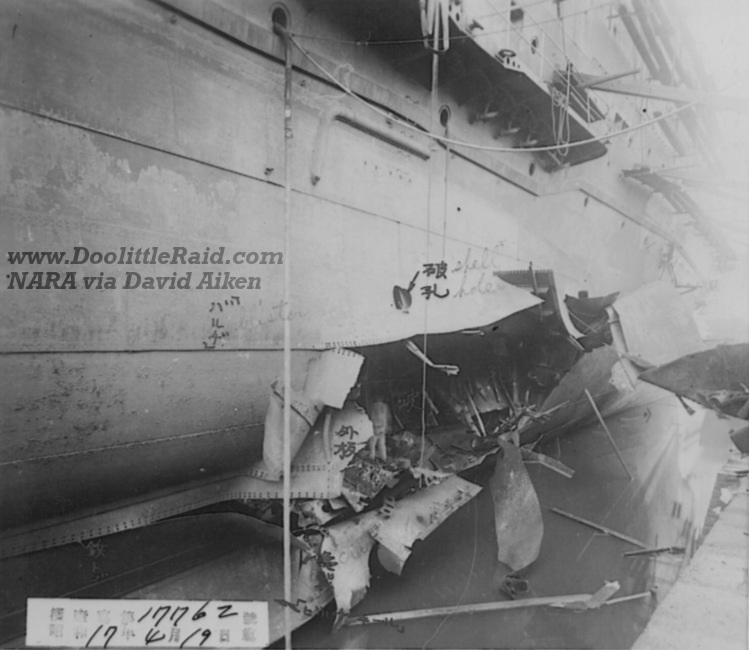

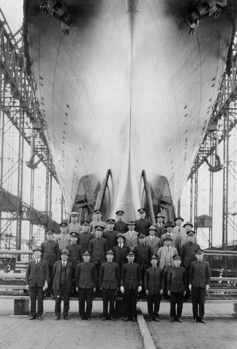

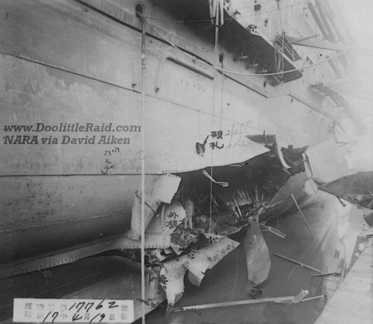

What is a typical width of a band of hull plating on large Japanese warships? It appears each band of Shokaku hull plates as depicted by Fujimi is more than twice as wide as those shown in most midship sectional drawings of Yamato. That seems usual considering the two ships were built practically at the same time and driven by the same need to reduce weight, which argues for big individual hull plates to reduce excess weight imposed by plate overlapping.
- Posts: 9128
Re: Calling all IJN Shokaku-class fans
It's a great question, but I don't know what the answer is. It's hard to tell without a definitive document as there are so few photos that allow for comparison.
First photo is Shokaku prior to launch - hard to say size of plating.
Second is Ryuho hull damage after the Doolittle raid (photo credit on photo). What makes this interesting is the man standing inside the damage - great size reference. Big plates. Maybe Fujimi got it right.

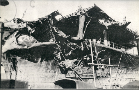

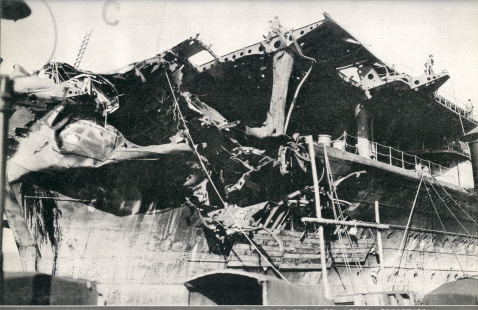

Does anyone know of close up photos showing the type of plate joints Shokaku used? Did Shokaku have overlapping hull plate strakes for flush hull plate strakes?
- Posts: 9128
It's a good question. Problem is the dearth of good photos. Aside from the photo of Shokaku's bow prior to launching, there's really only the photo of Shokaku's bow damage at the Coral Sea, below (credit Maru Special). Can't seem to find an enhanced version. I believe the plates are flush, side to side, and overlap/underlap in horizontal strips.
There are closeups of Soryu and Hiryu's hull and this certainly seems the same for them. Can't imagine it being different for thje Shokakus.

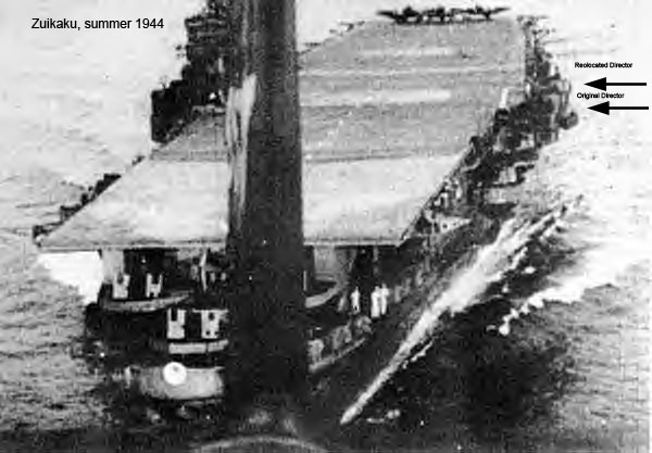

- Posts: 9128
Re: Fujimi 1/350 Zuikaku released
I know I've covered this before but.......perhaps the moderator will move this into the CASF Shokaku class thread at some point.

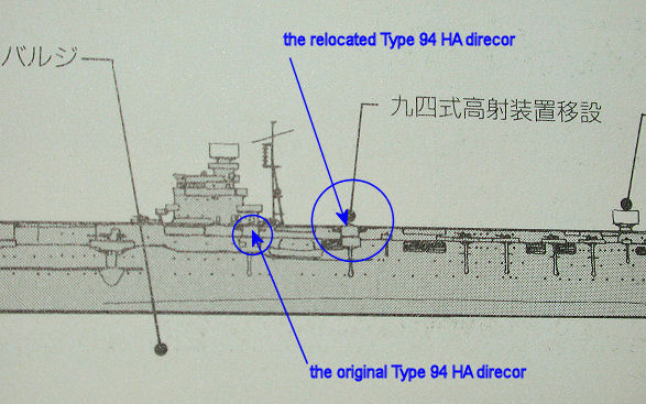

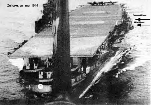

Neither sister lost the Type 94 HA director atop the bridge that they were commissioned with. When replaced by the Type 22 radars installed there, the director was moved down to the port side forward boat deck, just aft the original one in that position, with the 9m (or 11m?) cutter between them. It mimics the setup on the starboard side under the bridge. There is ample photo evidence - one example below.
Also, the yardarms of the main mast were damaged at the Phillipine Sea and rebuilt angled back, much as was Junyo's. It gained a Type 13 radar at this point as well, not before.
Also, the radar tub at the base of the radar should have walls, not solid as the kit seems to have it.
There's also a new, stubby blister on the hull - you can see the wxtra wake in this same photo (Credit - Gakken #13). I'm critiquing just based on what I see in the kit photos.

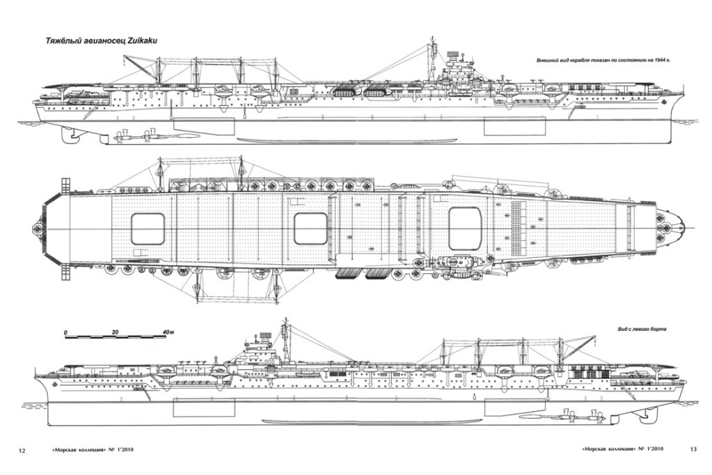

- Posts: 9128

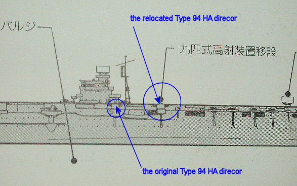

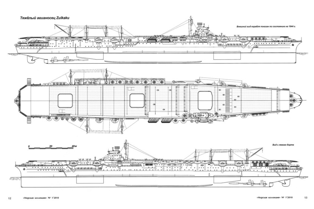

Here's a diagram from the Gran Prix Shuppan volume on IJN CVs
Adaks
- Posts: 142
- Joined: Thu Dec 08, 2005 8:37 am
Thank you for information Dan. Do you know when these blisters were added ? After the Battle of the Philippine Sea ?
- Posts: 9128
Yes, though I'm not sure how prominent they were; probably not very.

- Posts: 9128
Good reference. I think it is accurate. Notice where the blister ends; it extends only over the forward av gas tanks (an area roughly equivalent to the length of the forward 12.7cm AA gun sponson. Notice also how blunt the edge it - hence the extra wake in the photo.
Notice also the cant backwards of the yardarm

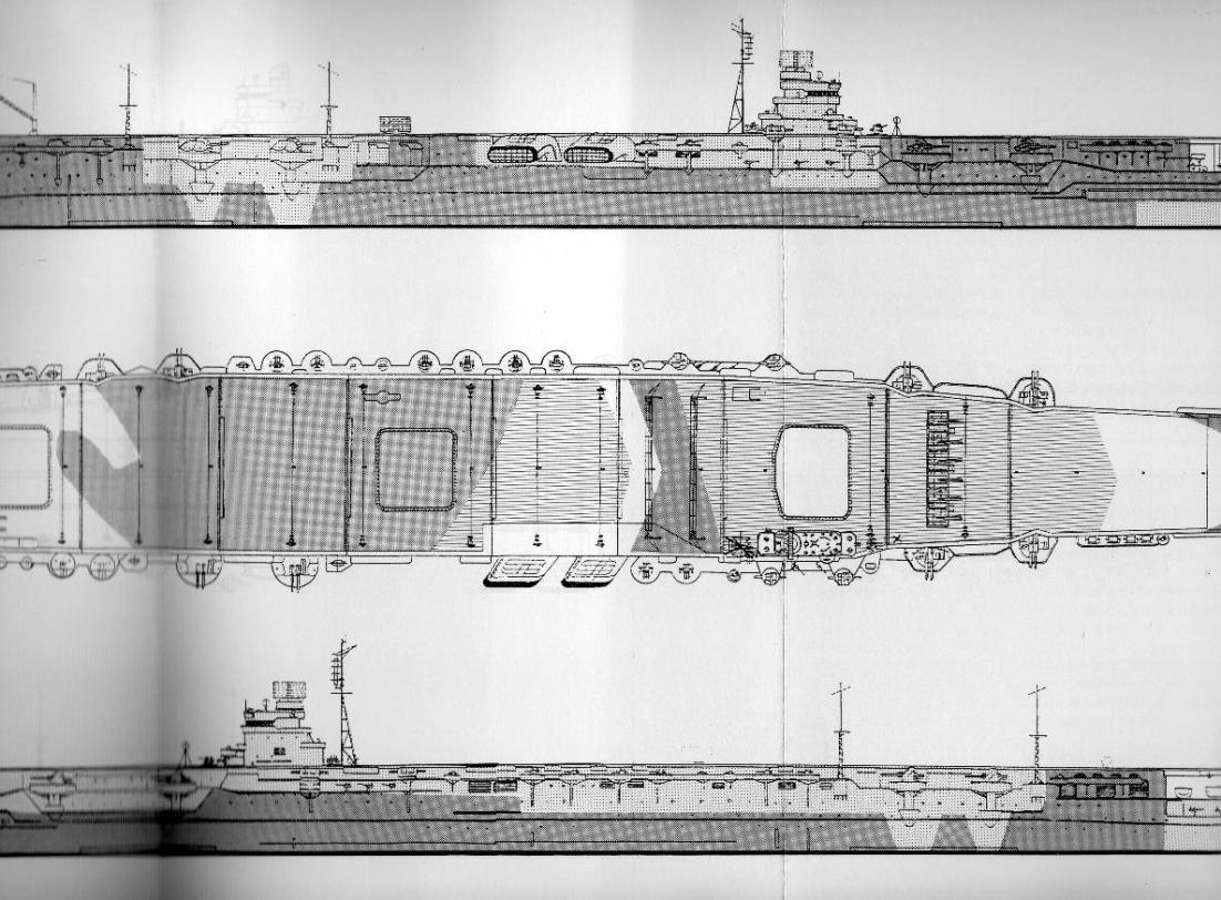

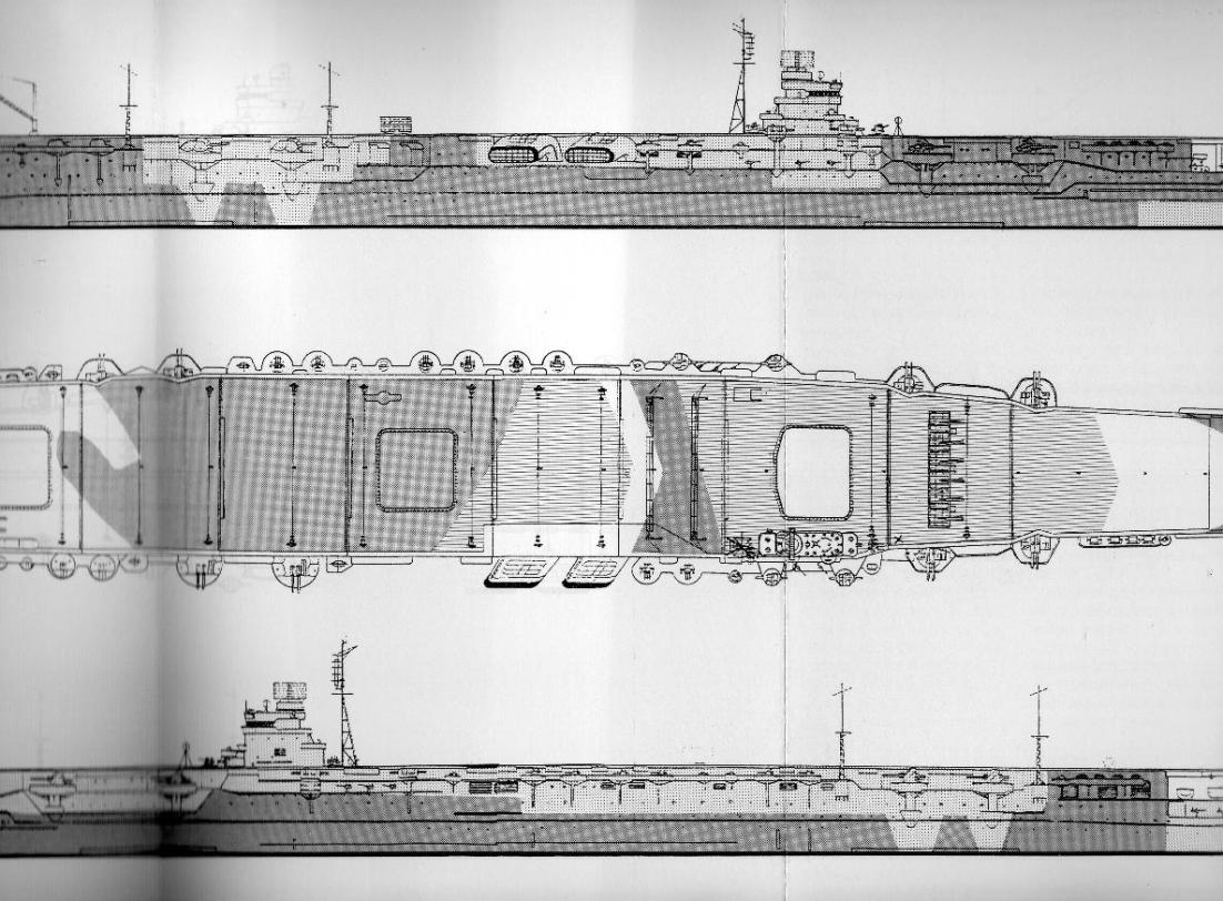

two more sources on the "blisters", from a russian booklet (morskaya collectyia) and from a japanese source (model art)
ciao peppe
ciao peppe
