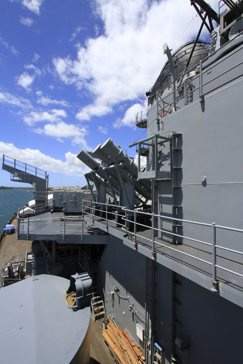

Luky:
Not the clearest photo of the area, but you can see that the area beneath the fwd end of the large Tomahawk Deck is only one deck tall. The ladder leads up to the fwd end of what was the base of a 5 in 38 twin mount.

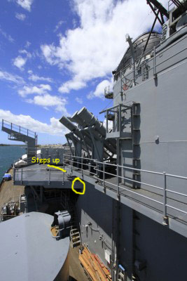

Re: 1:192 USS Missouri modern configuration
Thanks for that photo.
The area in the yellow circle was unclear and now I can finish that.
The deck does steps up just a little but not one whole deck level.
- details,details.jpg (32.11 KiB) Viewed 1330 times
I think I know what you mean. I cannot add that part( deck you are talking about), yet until the railing is in, because the tomahawk deck would prevent me from drilling the holes for the railing.
This one?
This one?
- sub-deck copy.jpg (32.2 KiB) Viewed 1313 times

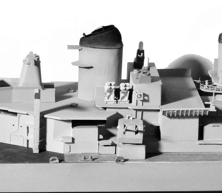

A photo of my "interpretation" of this area. Unfortunatly this part of the shp is not currently acessable in the upper superstructure.

WOW!Fliger747 wrote:Ah, very well, a method to the madness.
Your model is coming along very nicely.
You are ahead of me thats for sure.
Looks very clean and precision too.
Went to get coffee.
- Posts: 5068
Thanks... Resumption of an old project. Had to rip out a few things along the way as revised info has become available. Small things like the hoods on the 5" mounts can take some time to scratch! Might be able to get out to the ship next week for a few hours.

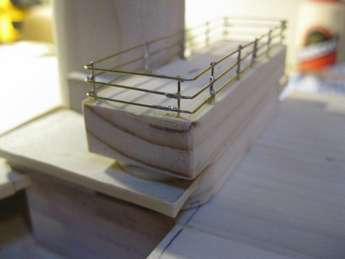

I am working on railings on the deck structure now.
Very difficult.
I do not know how the 1/700 scale modelers do it.
I will post some photos of my fixture that
I made to put together brass railings.
Very difficult.

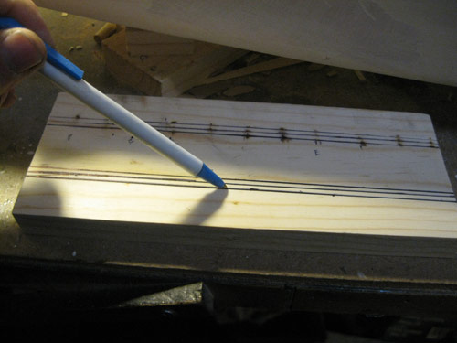

This is my method for railings.
I use .020 brass wire.
I know it is too large for the scale but it looks ok.
I use a pine block and draw lines with a ball point pen
pressing down to leave a groove. Does not take much pressure in the soft wood.
Then I tape the 3 railings down.
I solder the uprights in one at a time and when cool I snip them off with a fingernail clipers.
The finger nail clipper cuts very close and accurate.
For a 1:192 scale model the height of the railing should be about .200 thousandths.

- Posts: 5068
Railings look great. The fwd tomahawk deck is at the same level as the harpoon deck and walkway long the side of the aft Ciws superstructure. The corners of this are square all the way down on Missouri. I'll see if I have any photos of this area. You can see how the deck levels are arranged. The fwd tomahawk deck is about 11/2 decks high. Is finer brass wire/rod available?
Might have to give that technique a try.
T
T
