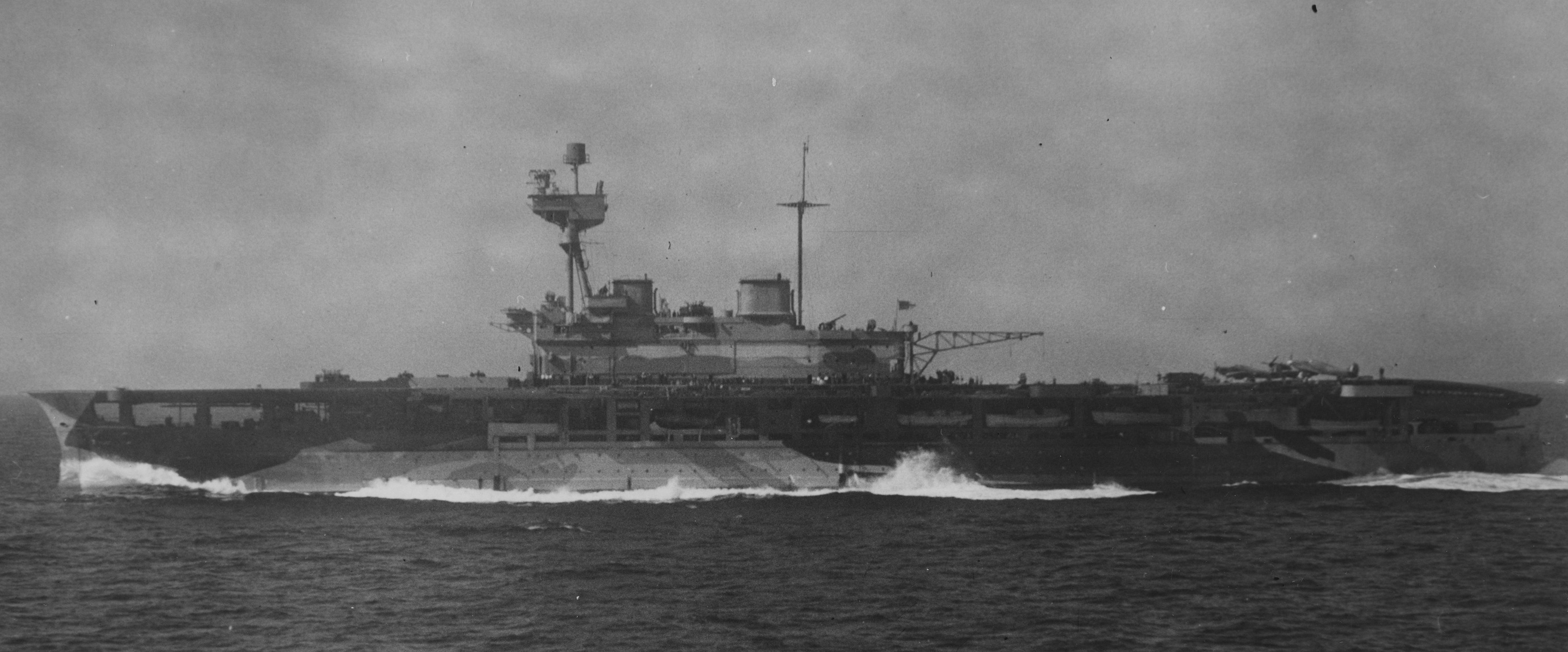

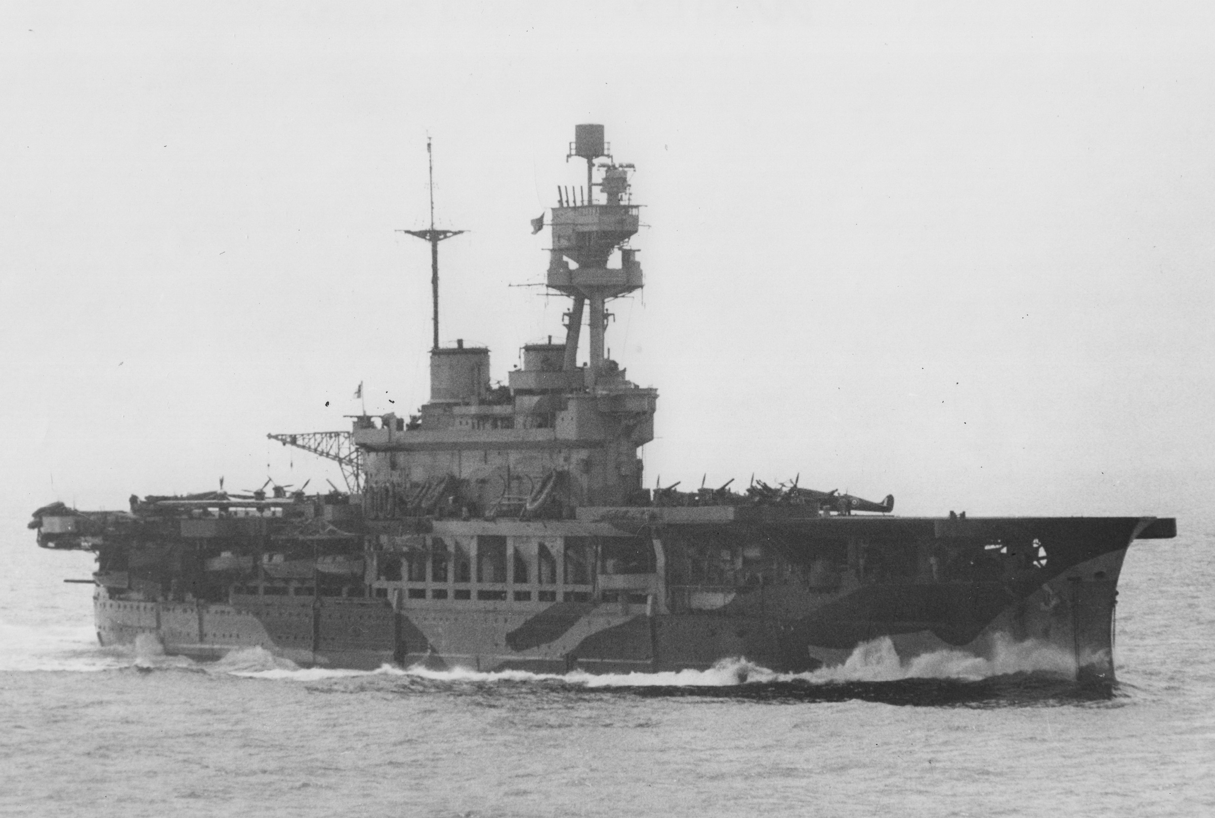

Posts: 8596
Re: Calling all Early War RN Carrier Fans Hermes/Eagle/C'age
Two shots of Eagle, taken from USS Wasp, during one of the ferry missions to Malta. Photos from NARA II, courtesy of Roger Torgeson.
Aop Aur
Posts: 972
Location: Bangkok, Thailand
Post by Aop Aur »
Very nice photos! Thanks for posting.
Aop
Graham Boak
Posts: 255
Joined: Tue Jun 16, 2009 1:49 pm
Post by Graham Boak »
The second trip, Operation Bellows. Lovely photos, but for those of us interested in the delivery Spitfires, frustrating because the codes on the side of the aircraft can't be seen. I know, asking for too much.... good to have the photos anyway.
