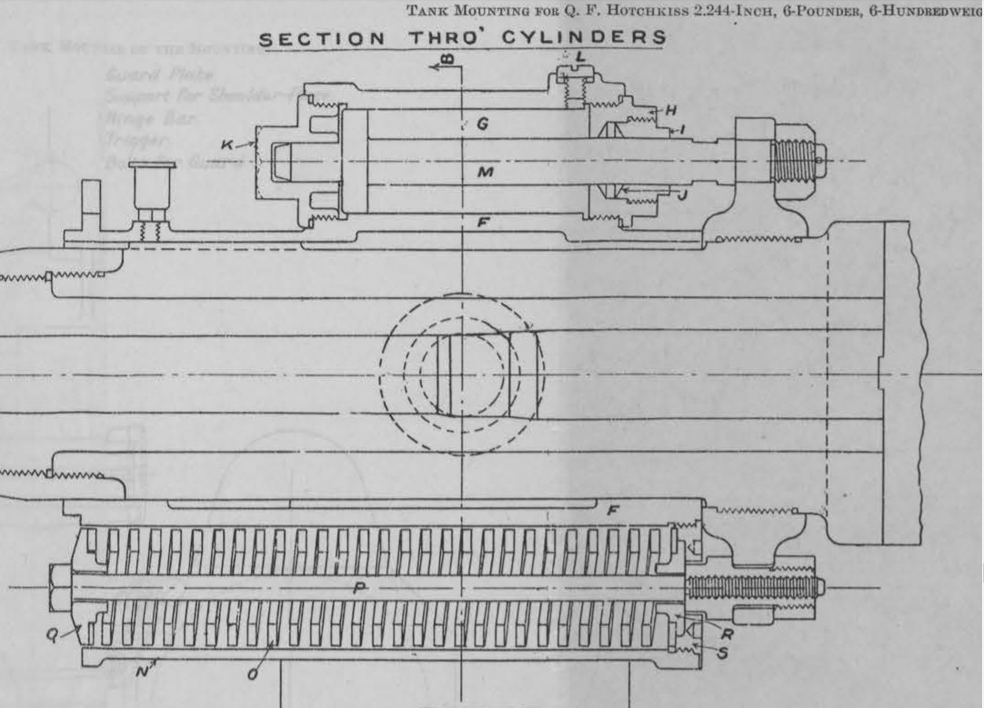

Is the following relevant? It's an Army application, but perhaps there are similarities?
Handbook for the Q.F. Hotchkiss 2.244-inch, 6-pdr., 6-cwt. Mark II gun with tank mounting.
https://cdm16040.contentdm.oclc.org/dig ... ll9/id/943
Thank you Cliff. This shows a WWI version of a Hotchkiss 47 mm. The recoil mechanisms we have been discussing are more highly evolved, or maybe adapted to work inside of a tank. The designer has separated the springs and the shock absorber. The shock, now identified as a "counter recoil" is mounted above the gun tube. The springs, two of them, go below. In this system the cylinders are fixed in position and the piston moves with the gun tube.
In the early 57 mm I am modeling, the whole system, spring plus shock, is designed within a single long cylinder. The handbook makes it easier to understand the variety of recoil systems that turn up in photos taken across the years. And it is great to see some 3-view machine drawings, rather than perspectives! Michael

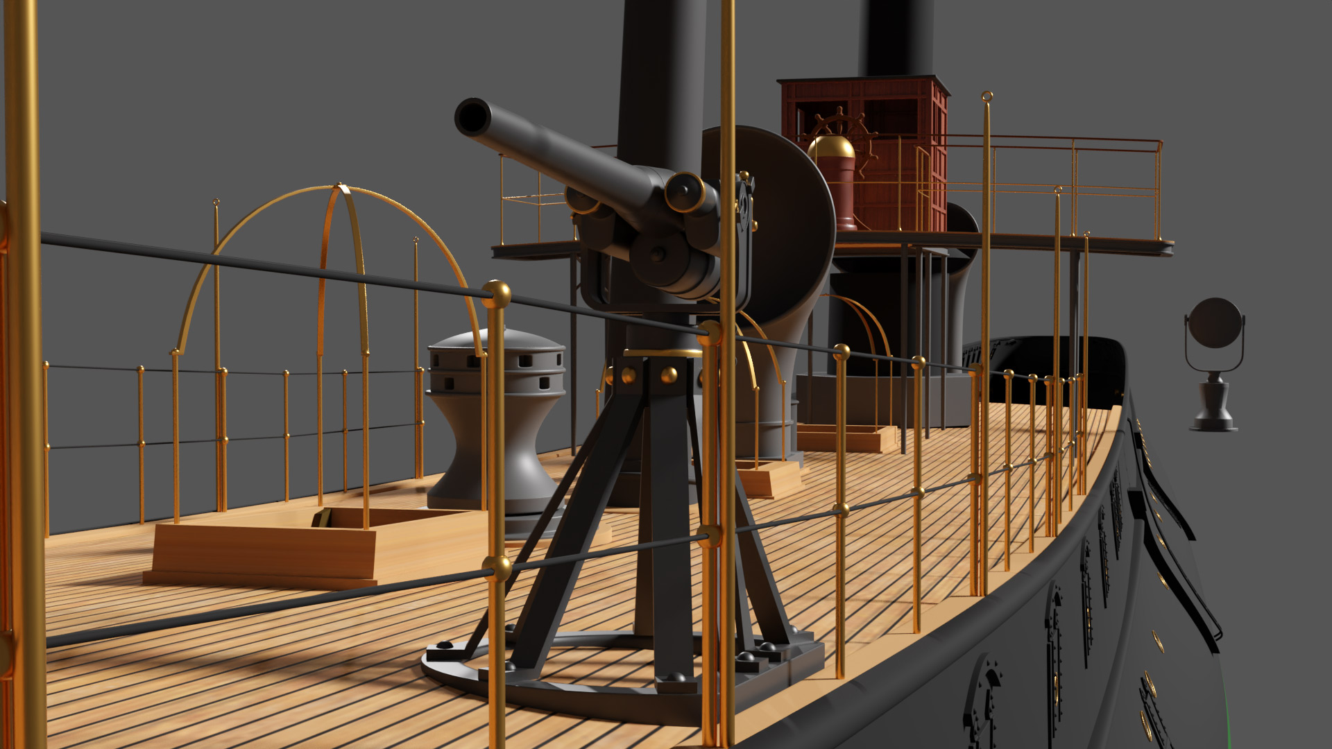

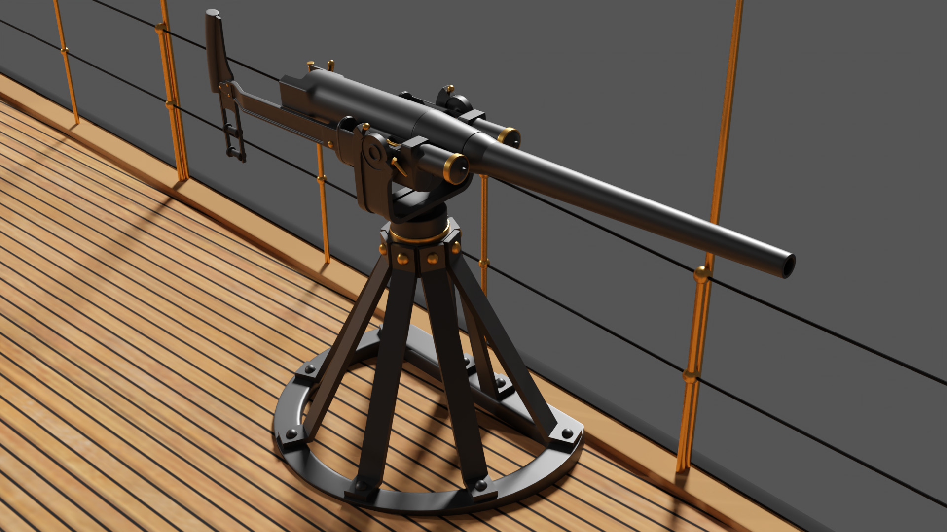

Post by taylormade »
Very interesting post with an amazing amount of detail I wish I had seen this before I modeled my Hotchkiss for my virtual model of the French cruiser Cosmao (1889). It's not that detailed as it's part of a much larger model and the file size is already quite large. Here is what I came up with.

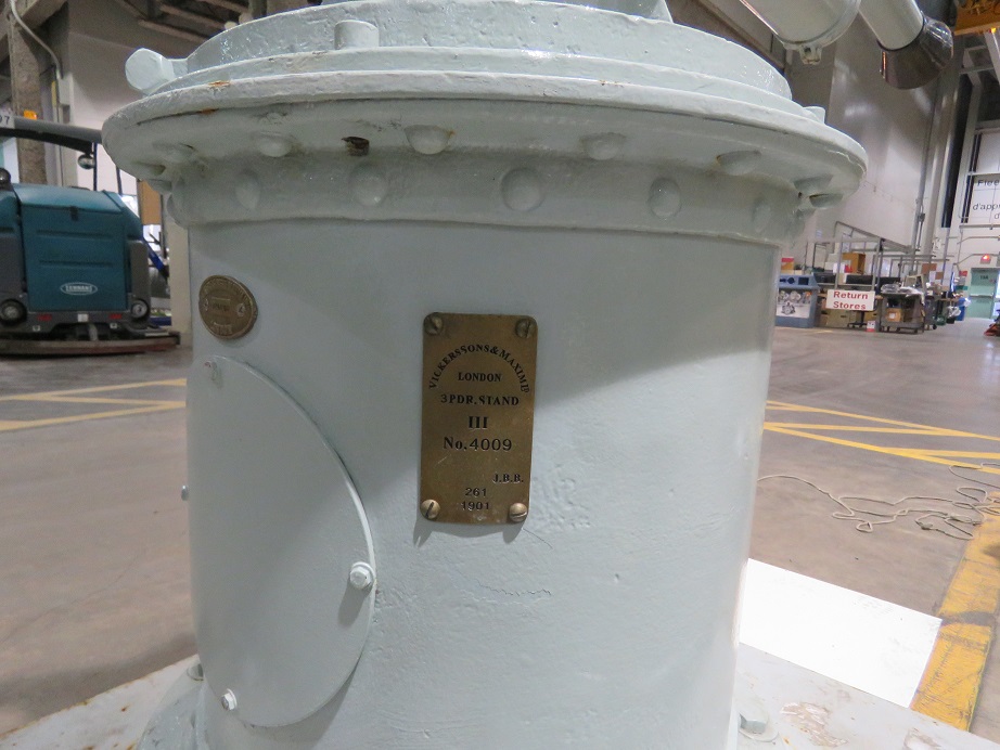

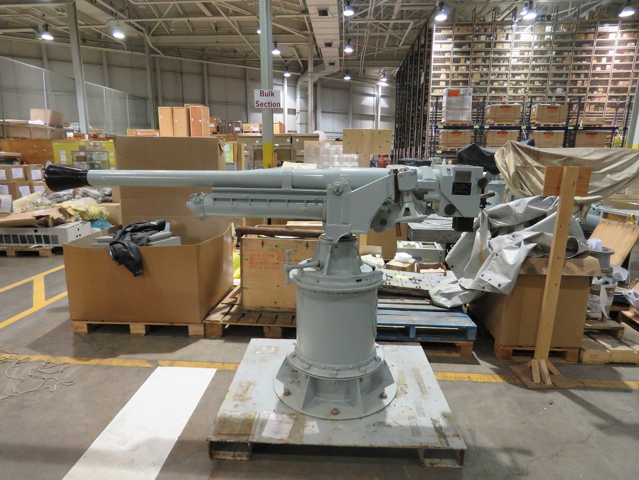

Someone mentioned earlier in the thread about RCN Saluting guns.
Here are some photos of current service RCN Saluting guns - these appear to be WW2 6 Pd AT guns mounted on modified original 3Pd QF mounts from VS&M in some cases dated 1901.
