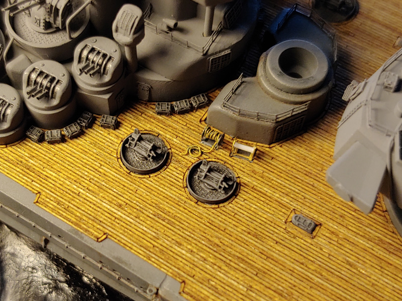

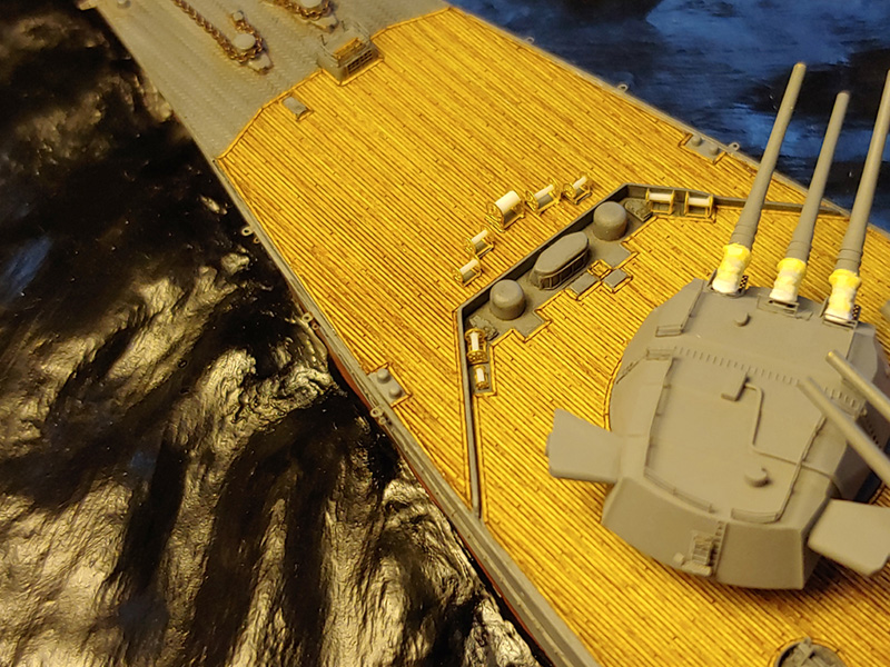

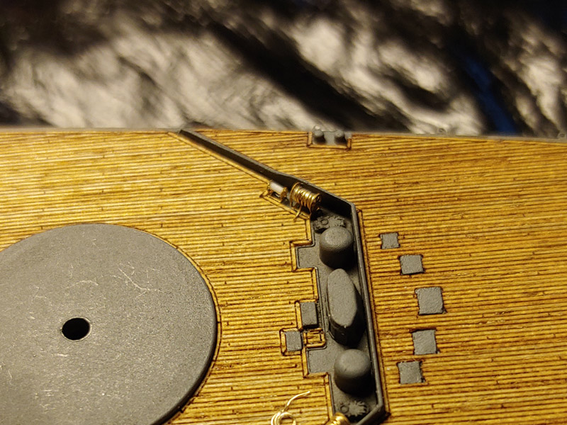

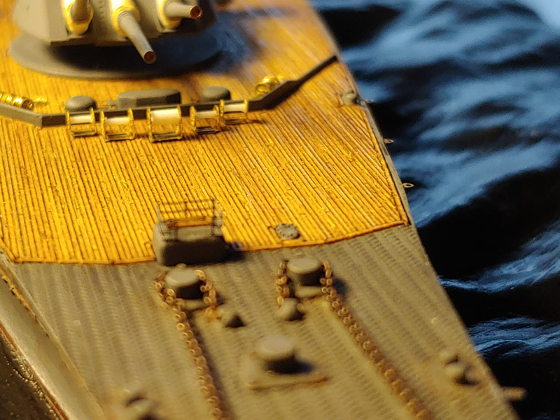

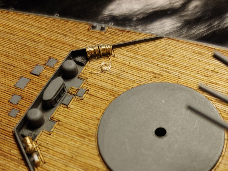

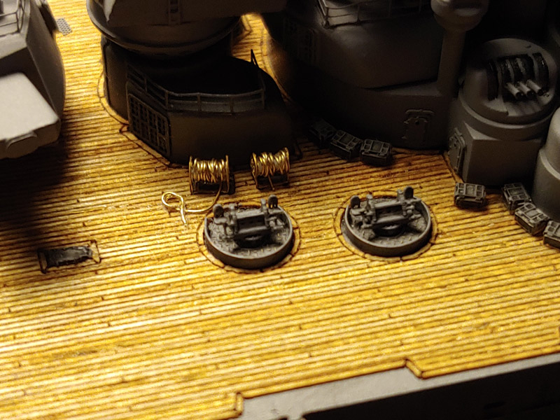

Finished building all 15 reels. Each one takes about an hour to build - add another 2 hours looping the hose (.006mm brass wire) around the plastic rod and, finally glue in place and paint. I could only complete one for today.

Nicely done. Yep, wire wrapped reels are a pain.

They sure are a pain! I had a few break apart from the rod and, a couple of the brass frame bent too much from the pressure of handling to wrap the wires around the rod - but Thanks!

Another way to do these, is to:
- glue the copper wire around an oversized length of rod
- then cutting the rod to size (to fit the reels),
- then gluing the rod with already attached wire to the reels.

I started to do that with some when the rod broke away from the brass reel. The challenge was afterwards -measuring the rod's width with a wrapped wire to be fitted perpendicular to the brass reel. I would have liked a cleaner wrapped-wire; more aligned around the rod. However, at the end, maybe I should have used a thinner wire or different material than brass ..that's how you learn.
Anyway, moving on to the next stage on the ship - superstructure.

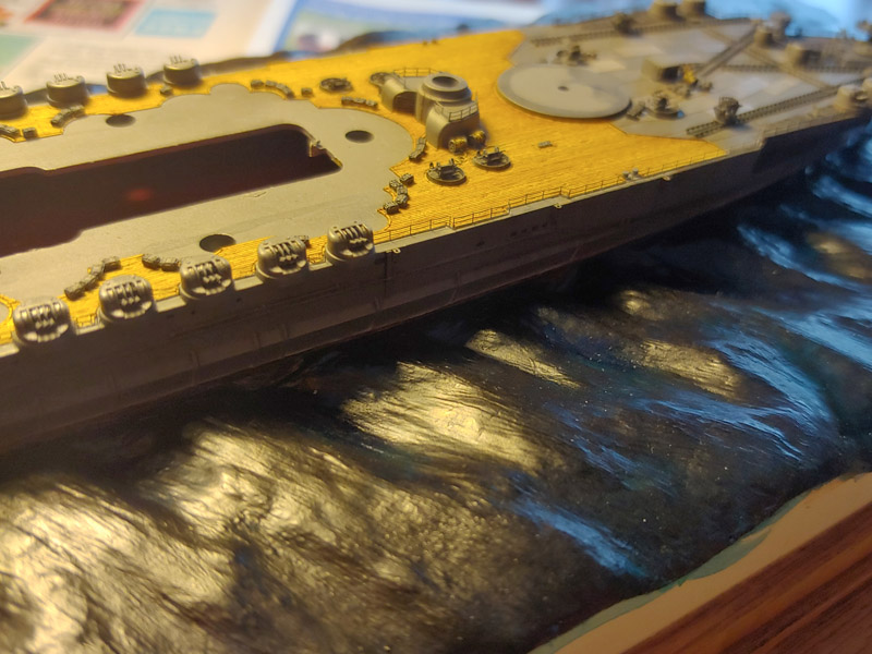

Finished railing on one side. Some areas need to be touched-up with paint.

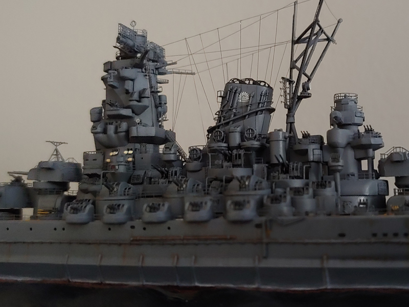

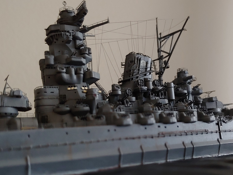

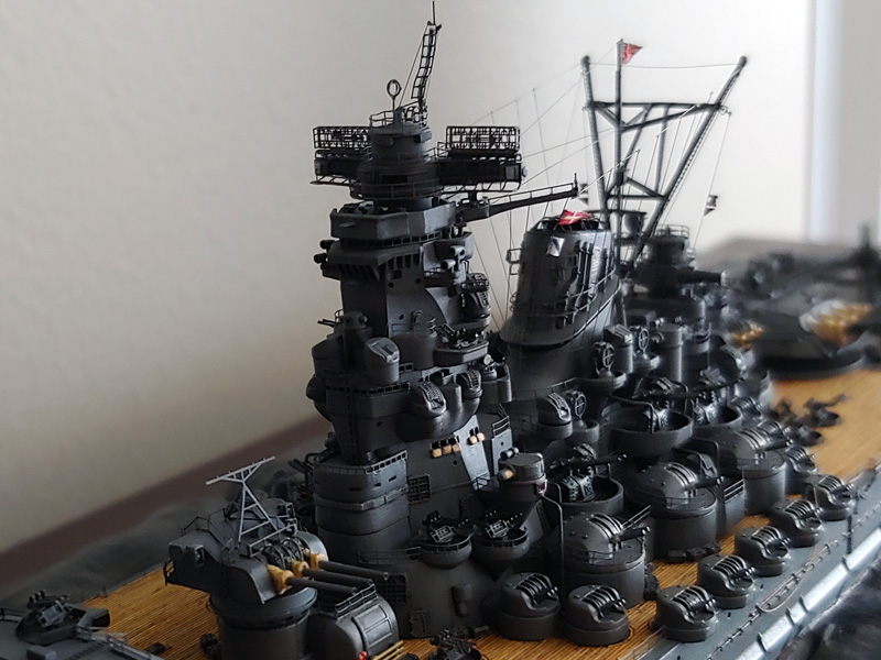

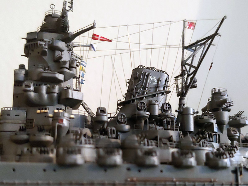

Hello! Been away from the Yamato for awhile. Looks like the next step is the superstructure - weathered and working on rigging it.

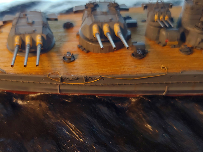

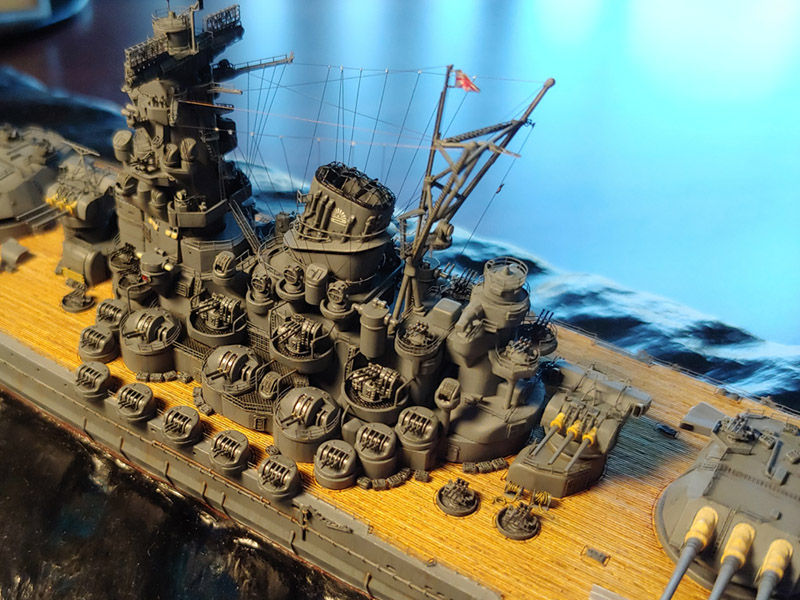

Painted the main gun's canvas. More rigging, added a flag, couple lanterns, and some work on the hangar area.

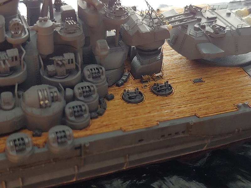

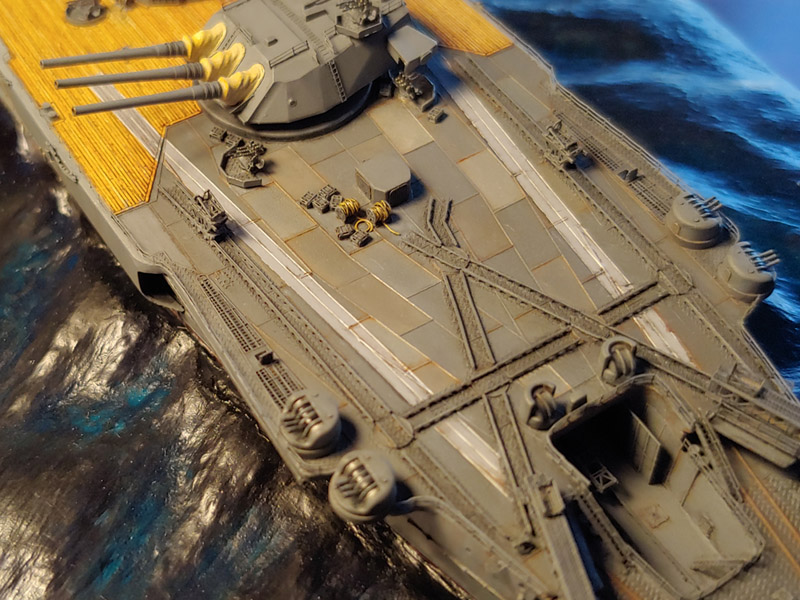

More detail to the hull and superstructure. Started on a Zero Seaplane (biplane).
