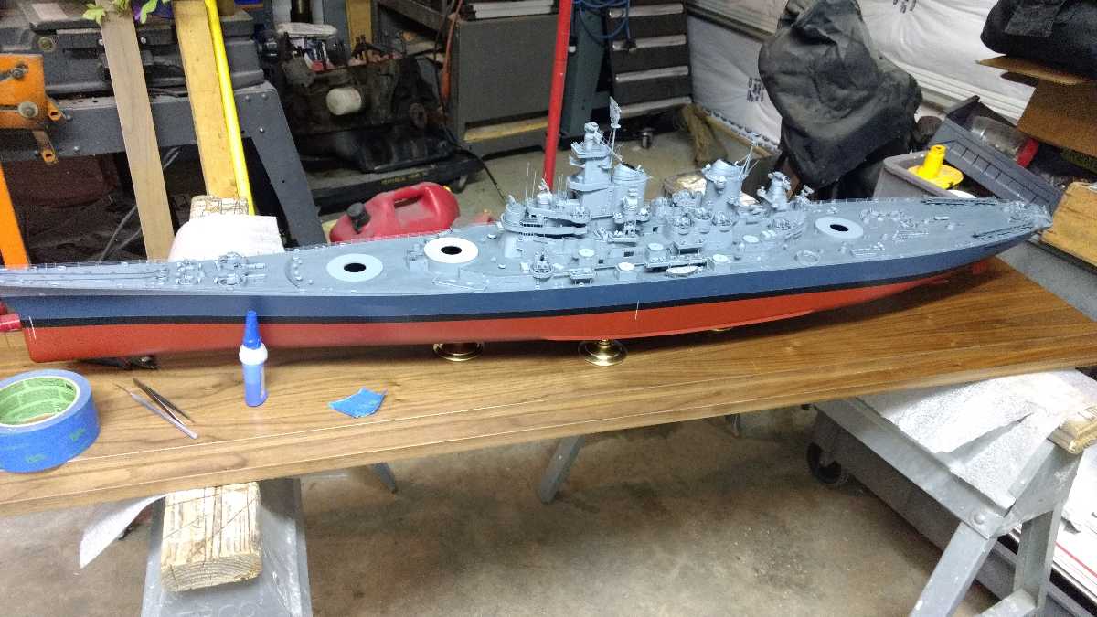

Re: 1:200 Iowa (BB61) 1943 + Pontos
Posted: Mon Jun 05, 2017 12:07 am
by Scott56
Iowa is now mounted to its base. The superstructure is now permanently attached. The deck railings and stanchions are in place a chore I dreaded but was not as bad as expected. I think I'm going to go with the 5" mounts from the kit. I have all the turrets completed just saving them for last.
This was a learning experience as it is my second model in forty five years. Here is one picture, don't mind the clutter in the garage. Having to work on saw horses for now. Ill post some additional pictures in a week or so. I should be finished by then.
