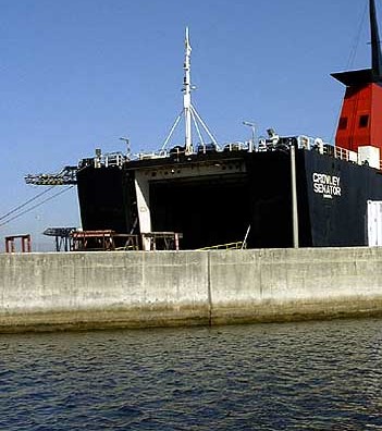

Another photo provides a partial glimpse of the transom area with the ramp open.
BN-12-Crowley-Senator-stern (2).jpg (72.82 KiB) Viewed 1680 times
And my memories provide details that are not clear on any of the prints or photos, such as the fact that the ramp deck was textured, and also that there was a steel curb on either side of the ramp which prevented cargo from hitting the hydraulic rams that lifted the ramp, kept poorly-driven cargo from going over the side (at least until after they left the ramp) and (usually, but not always) prevented cargo from damaging the handrails.

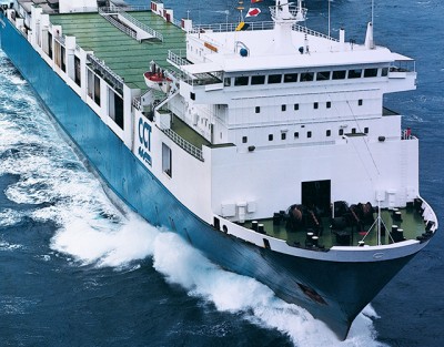

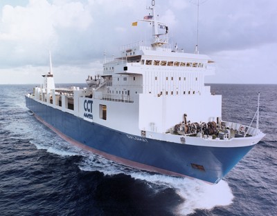

I'm sanding the hull to prepare it for fiberglassing. I'm slowly making progress, but really nothing to take a picture of. Meanwhile, here is a picture of the AMBASSADOR and another of its sister the DIPLOMAT (later changed to SENATOR) that I recently found online.
These look like they were taken on delivery or shortly afterwards. The AMBASSADOR looked pretty much like this when I joined. Shortly after I joined the "CCT" logo was painted over on the side and the stack, and then the stack painted red.
What is interesting to me as a modeler is how these two sister ships, built at roughly the same time, had different paint schemes for underwater hull, deck machinery (and later) decks.
What is also interesting is that the AMBASSADOR (as built) differs from the Painting Plan blue print (which I have) in what will be very obvious, especially in a model: the Plan calls for red hull paint under the waterline, and the actual ship (even as early as this photo) had grey hull paint below the waterline.
Early AMBASSADOR photo.
Early DIPLOMAT/SENATOR photo.
There's another, quite striking difference between the General Arrangement prints and the actual ships (that I believe is just a mistake on the GA print) but I'll wait until I am building the superstructure to show the difference.
