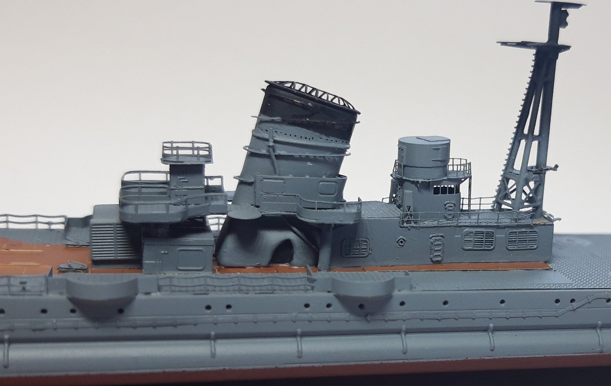

Some further steps done. Started the final assembly with aft bridge. Various gaps filled in by diluted PVA glue. More touchups will be still needed.

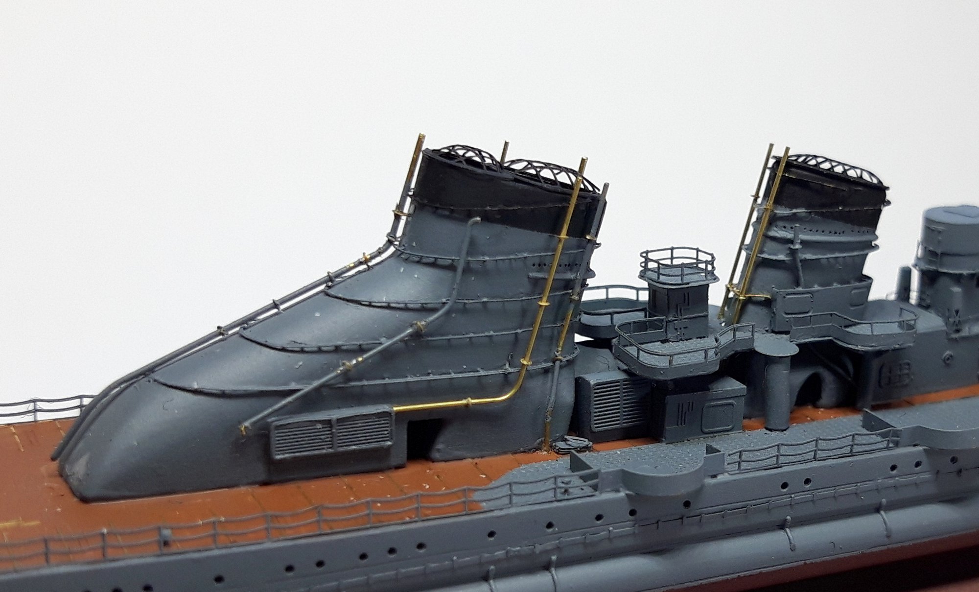

I added the forward funnel and piping to both funnels. I had to use some artistic licence here as my attempts to find someone who would have had any 1942 photo showing the final arrangement (other than the one already shown in this thread) proved unsuccessful.
My other challenge was that I decided to wait with attaching the piping after I airbrushed the funnels so that I could mask the top black stripe on the funnels. That was quite ok but spraying the piping before attaching it was not that good idea as the paint often succumbed to handling etc. In the end I even replaced some of it with non-painted ones and I will have to handbrush it all again.
I used 0.3mm and 0.4mm brass tube for the piping. Two "H" shaped parts (3D printed from the Shelf Oddity set) will be attached to two of the tubes on the forward funnel as seen on photos.
Next comes the main bridge.

Beautiful and crisp.

Love the piping on the funnel. Outstanding work.
