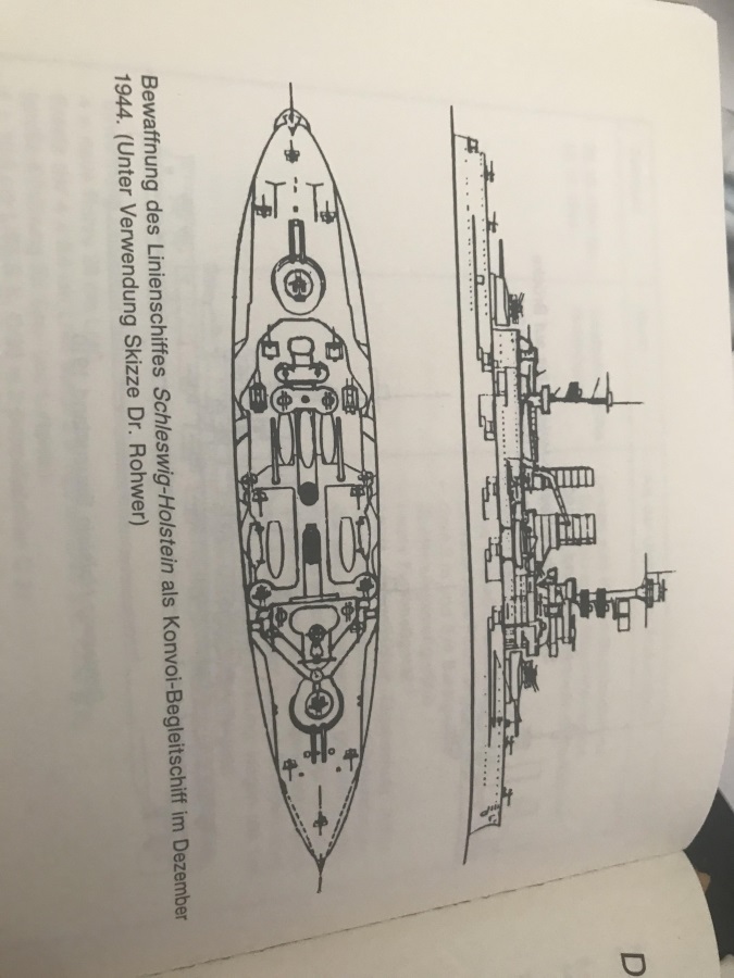

Regarding the 1944 AA weaponry, Schultz notes:
Bis heute is strittig, ob zum Zeitpunkt des Luftangriffs am 18.12 1944 all vorgesehenen Fla-Waffen einschlie�lich 10,5cm an Bord waren. Offensichtlich wurden zur Umr�stung alle verf�gbaren Fla-Waffen herangezogen, bedingt durch immer gr��ere Ausf�lle in der R�stungsindustrie.
Up until today (1990 was the date of publication) it is debatable as to whether all of the planned anti-aircraft weapons, including the 105mm weapons, were on board at the time of the air attack on 12/18/1944. Obviously all available [i.e. a hodge-podge of equipment] weapons were incorporated into the refit, as necessitated by ever-larger disruptions to the armaments industry.
Schultz provides a sketch from a Dr. Rohwer as to the planned location of the armaments. It is too big to upload here (max size, 400 KB), but if you have any ideas about how to overcome that, I'ld be happy to post it and/or e-mail it to you
I Scouting Group
Posts: 7
Joined: Mon Jul 27, 2020 2:23 pm
Re: Calling all Deutschland-class pre-dread fans!
Post by I Scouting Group »
I was able to make the picture of the aforementioned sketch smaller. Here it is.
