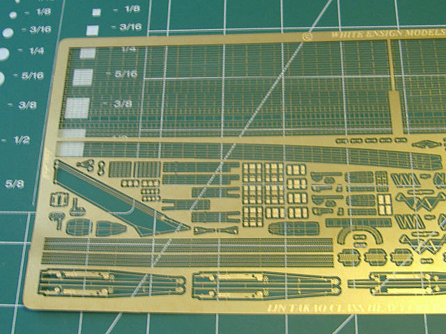

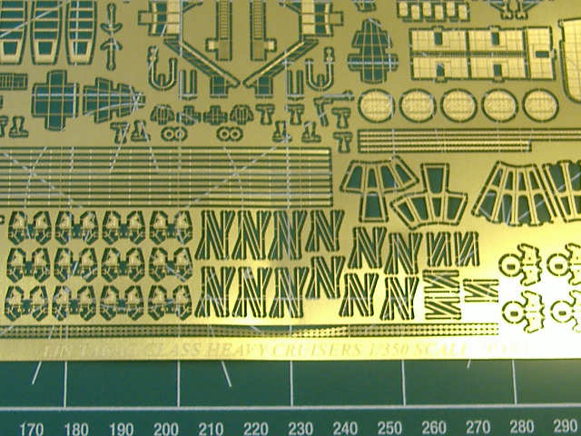

Yesterday I got the Takao P.E set from WEM, I was stunned after seeing the size of those frets. These frets are so complex I couldn�t believe it with my own eyes, you must have these on your hands in order to understand every single P.E part I think pictures won�t do any justice
. I�m really impressed with the whole set the window frames look awesome and the gangways, awning stanchions, boat davits are so amazingly done. With this one and the GMM Takao set + those fittings from veterans, flyhawk and some brass barrels , I think any one could end up with a neat Takao class heavy cruiser. I didn�t mention the LionRoar set because I won�t be buying it this time. BTW, I�d like to thank the people from WEM they did a superb job.

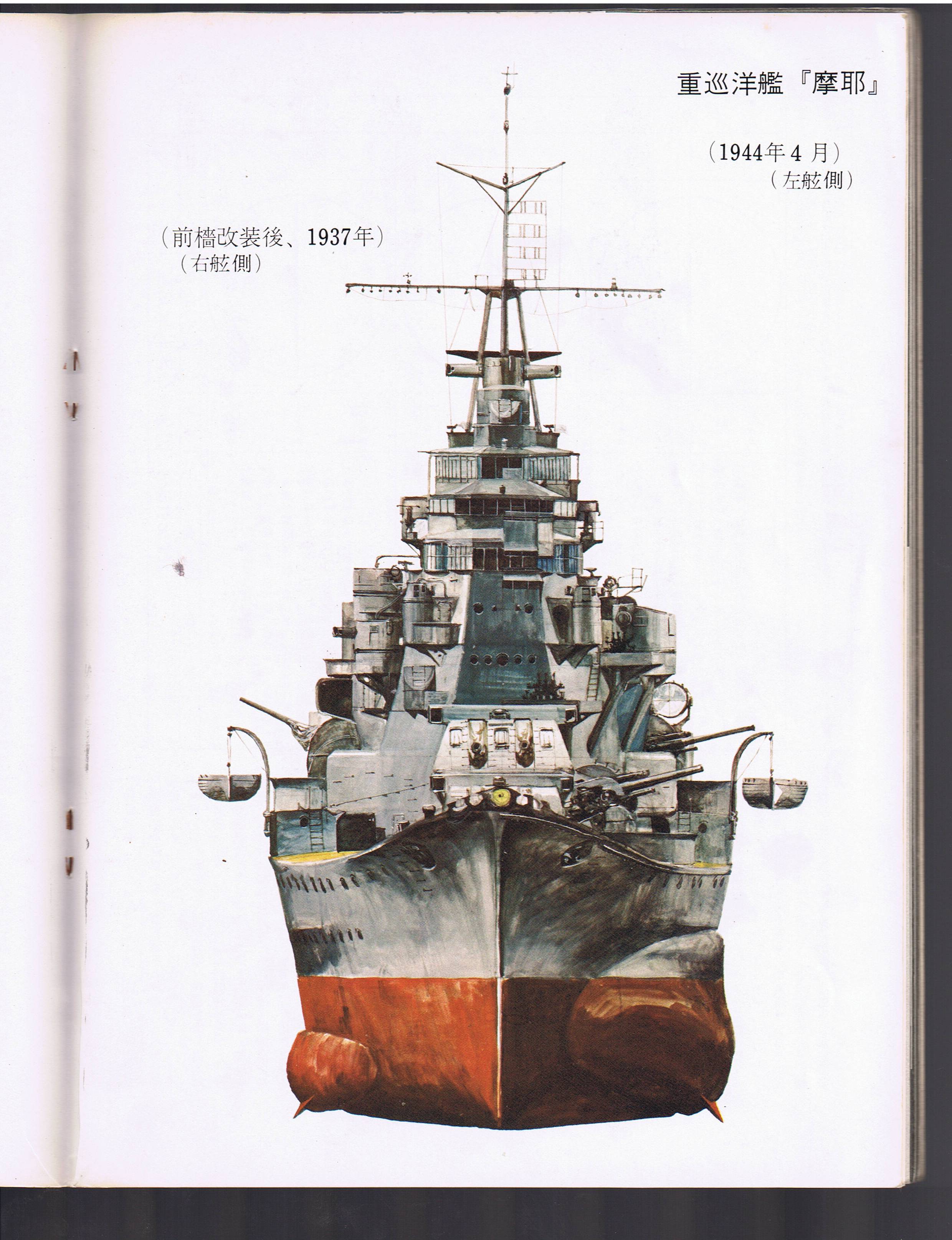

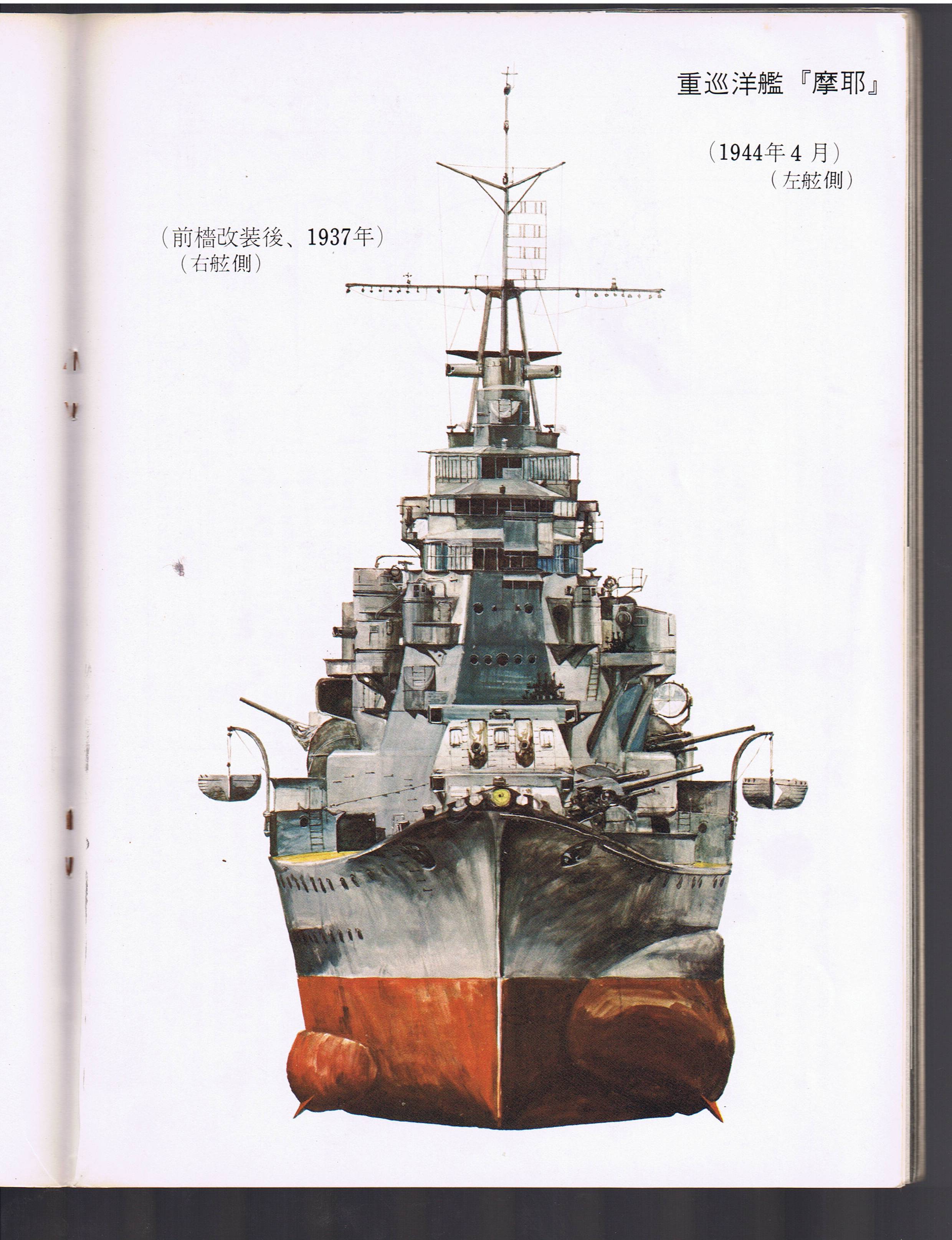

I only got a handful of pictures of Maya these don�t even show the degaussing cable except on a drawing which shows half of the ship in her prewar refit and the other half on her 1944 refit if you have the Maru Special #4 you must have seen it. It�s most likely she had the D-cable back in 44 before she got sunk I�m basing myself in a couple of built models and they all have D-cable I think adding it will make the ship more accurate I don�t know about Chokai now I thought she had it?

The IJN fitted all its major warships and auxiliaries with an external degaussing cable in 1941 in anticipation of war. By midwar, it seems the IJN was either no longer convinced of of the cable's effectiveness, or chose to move it internally for new construction or major refits. So, new construction, like the Unryu class of CVs, or the Matsu/Tachibana classes of DDs, had no external cable.
Large ships undergoing extensive refits or reconstruction after damages also had the external cables removed. Photographic evidence of Chitose and Chiyoda after conversion to CVLS in 1943, Isuzu in late 1943 after conversion to a CLAA, Oyodo, and Junyo in late 1944 all show the external cable removed. On the other hand, CLs Noshiro, Yahagi and Sakawa were completed with an external cable.
There's no debate regarding Chokai - photos at Truk in Oct, 1942 show her with a cable. The problem with Maya is that her circumstance fits the profile of a ship having its cable removed, but the photo evidence is inconclusive. There's that one photo taken of her at Tawi Tawi in May,1944 but it's not quite clear enough for a factual determination. FWIW, current opinion in Japan is that the cable was removed. Here's the best closeup of that photo that I've come across (credit: KMM volume on IJN Cruisers):

This is the drawing I told you about Dan, 1944 refit is dated April 4 I also got the same shot of Maya you showed us above BTW this drawing comes from the MARU SPECIAL edition #4. Unfortunately that pic on this booklet is even darker I can�t distinguish any of the hull detail. I checked Maya�s TROM and she was at Yokosuka at that time who knows what happened there they might�ve removed the D- cable you might be right or wrong
