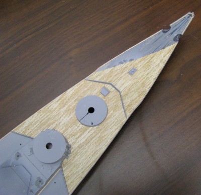

Steve Larsen wrote:That looks so freakin' good.
That's high praise, coming from you - thank you! It's a nice effect, but boy, can it get tedious!

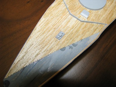

MartinJQuinn wrote:It's a nice effect, but boy, can it get tedious!
Can it possibly be any MORE tedious than decaling 47 1/350 planes?????
:rolf_3:
My test piece wasn't TOO bad, but I only did half of the bow! :big_grin:

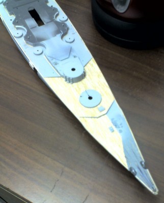

This has been sitting around untouched for awhile, so I've recently gotten back at it during lunch, after I've eaten. A few pictures taken today, with a crappy cell phone camera:

Coming along nicely, Martin! :thumbs_up_1:

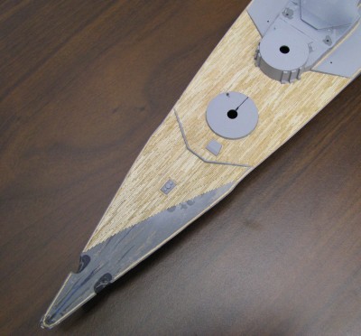

Well, yeah - I guess I did do something. I removed the things that I didn't think I could plank around, then sanded the deck down. The "planks" are very thin as well. I'll have to try and get a photo of a plank.
Posts: 8555
Re: Planking the decks of a 1/350 Bismarck
Some better pictures (brought my camera into work today) and some further progress. I've run out of cut planks, I need to spend a few lunch hours cutting wood!

So, you are planking over where the anchor chain runners were? Are you going to cut new runners from some .010 plastic sheet and glue them on top of the planking?
I was puzzling over that one myself before Arizona went on the back burner. Seems like the wood is just about the same thickness as .010 plastic sheet. I was thinking about cutting a new runner and gluing it to the deck first, then plank around it.

Elvis965 wrote:So, you are planking over where the anchor chain runners were? Are you going to cut new runners from some .010 plastic sheet and glue them on top of the planking?
From what I can tell, those were made out of wood, so that's I'm going to try and replicate, laying that over the deck planking.

MartinJQuinn wrote:From what I can tell, those were made out of wood,
Really? For all ships or just Bismarck in particular? You'd think the anchor chain would tear up a wooden runner.
There's a nice pic of Arizona's bow on page 21 of the Leeward Pubs Ships Data 3, and it looks like Arizona's were steel.
Just for Bismark & Tirpitz, as far as I can tell. Need to do some more research, but that's what photos appear to show.
