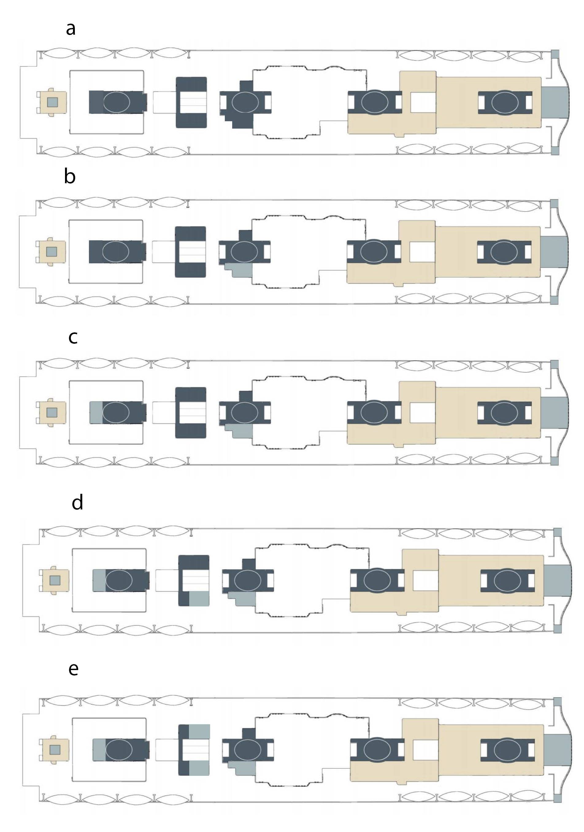

Still no concensus on Titanic roof colours?
I'm really hoping someone out there has some kind of updated, concrete idea about what the exact colour scheme the roofs of Titanic's deck houses were. I've been looking at the two following references.
http://www.titanicmodel.net/uploads/4/1 ... alents.pdf
https://web.archive.org/web/20180227102 ... .com/paint
Are we still in the dark about this 'exactly'?
Is there any new knowledge? I've contact Ken Marschall about this, but don't expect a response. If he does, I'll definitely share.
Which of the following would you do and what would be your reasoning?
Thanks for weighing in!

I have not read of a definitive answer for the deck houses roof color. Your charts look pretty good.

I"ll definitely check those out. But alas, it always seems to come full circle to removed links, a variety of representations, dead ends etc.
As far as I can see, it's modellers choice between the diagrams I posted.
I keep coming back to the same conclusion. Of course I could be dead wrong:
Selection A is the most conservative choice. It avoids getting into the debate and plays it safe.
Selection B is probably the most likely and is still on the conservative side
Selection C adds the very hypothetical 4th funnel area which is speculative based on on Olympic, but who knows.
Selection D adds the argument that the tank room had to be sheathed in wood and painted as per some regulations.
Selection E complicates argument D with another debate as to whether or not both Tank rooms should be sheathed.
Selection E absorbs and accepts all arguments and 'probably' takes it too far.
Again, what do I know. I guess pick the one that looks best to you.
I give up!

My initial thoughts...
I believe I would paint all hatch covers white, not grey
The section of the roof over the officers quarters of the bridge I would do flat white,
I like light grey for all the bases of the funnels.
The two hatch covers on the rear section of the library roof I would paint light grey.
(I was told that Floquil Southern Pacific Lettering Grey is the correct shade of light grey.) (Model Masters Gloss Gull Gray is close)
I have no opinion on the docking bridge other than grey or same as the deck.
Class Lounge Roof- maybe white.
Not sure which of your panels match my suggestions. Just some thoughts.

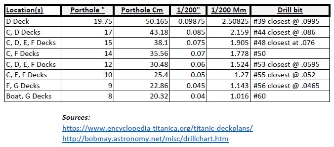

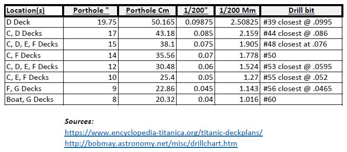

Here's a little chart I did earlier this morning of the drill bits for those wanting to drill out the holes in the 1/200th kit *in scale* - note that I haven't surveyed my kit yet to see if they match or may be over/undersized to what was molded.
I can say that there are some missing lights in the area of the Officer's Promenade - these were the "skid lights" that were 8" portholes about knee to shin height connected to a duct to the deck below for 1st class cabins. The glass was 8" in diameter but there was an inch lip around them. I'm not sure how much of a glow they would have had at night however.

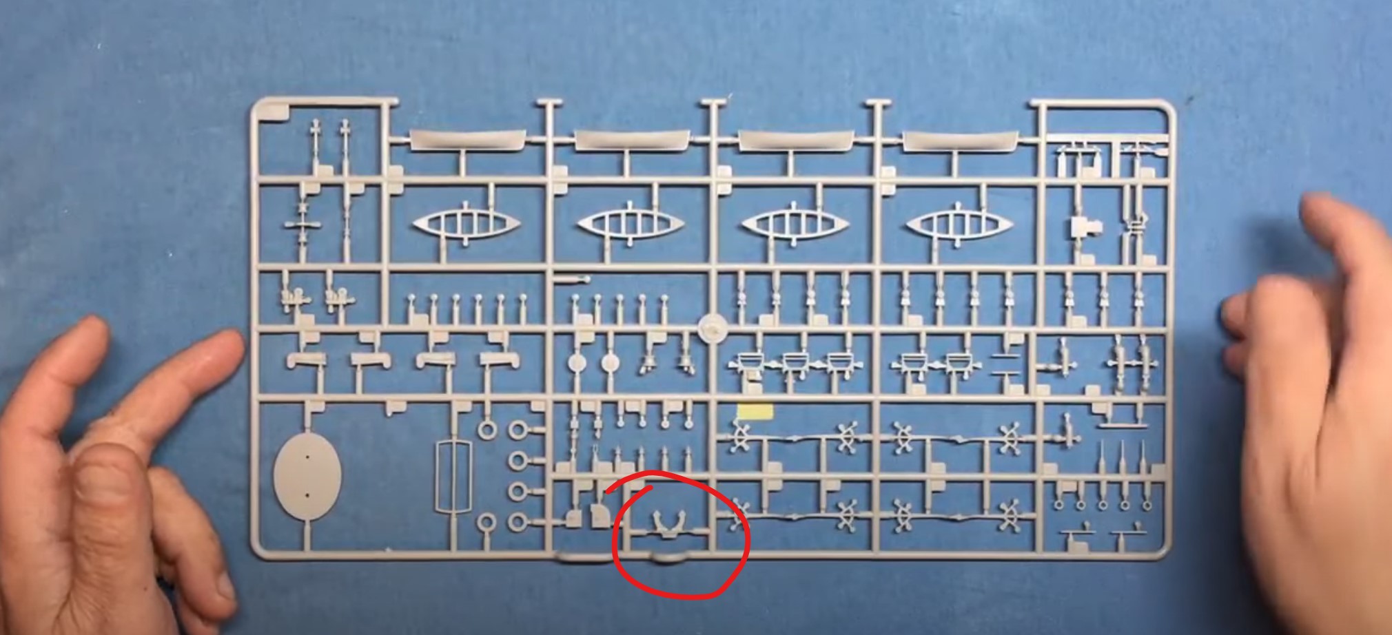

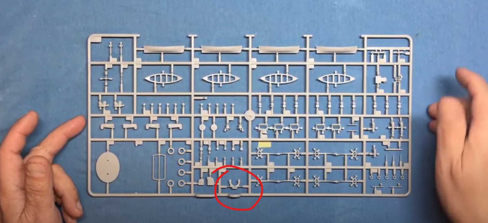

Trumpeter's 1/200 Titanic kit omitted the ship's anchors! There are only two empty hawse holes!
WTF?
WTF?
- Posts: 12472
Re: Calling all RMS Titanic, RMS Olympic and HMHS Britannic
- chuck
- Posts: 3384
It's not in the instructions!

The portholes trumpeter provided for the hull sides seems mostly too small. The thickness of the hull side makes it a challenge to use hand held cordless hobby drills because the plastic is too thick to dissipate heat to the plastic melts and causes the drill bit to seize inside the hole.
