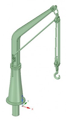

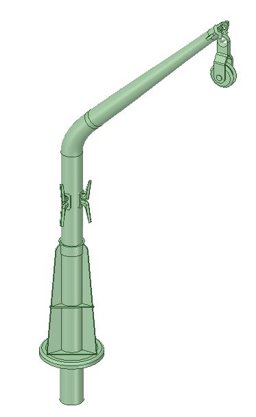

I have finished the re-design of a slightly different small deck davit that I had corrupted the original file last week. So, here are design pix of the two different davits in order to see the comparison of the two:
Small Stores Davit - Cane Fender Davit - Basically, these are both the same size, but differently configured in construction.
I hope to get a print session going on the re-designed cane fender davit possibly tomorrow afternoon or Friday.

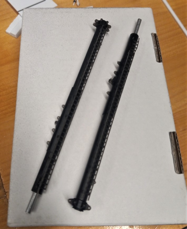

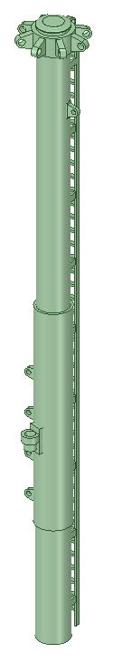

Got a bunch of parts cleaned up - the kingposts are ok - one still has a shadow of a distortion on the ladder, but not enough to worry. However, the hollowed shaft needs a bit of further hollowing to fit the metal insert so I may end up reprinting them both anyhow. I thought I had oversized the hole enough but perhaps shrinkage is at play - George Kastanza knows shrinkage!!

I advise you to hollow out your masts to be able to slide a metal rod "piano wire" style.
Some of mine have bent gently over time because of the rigging. That's the problem with resin.

Pascal,
Thanks - Yes, I did hollow out the kingposts - however, I'll have to open up the opening inside perhaps another 0.5mm dia. in order for the metal tube inserts to fit. This initial set was a bit too small to allow them to be inserted. But yes, you are correct - the resin has a tendency to bend over time. I figured that the metal tube can also perform the function of the center "pin" for located the part when it's time to install on the deck.

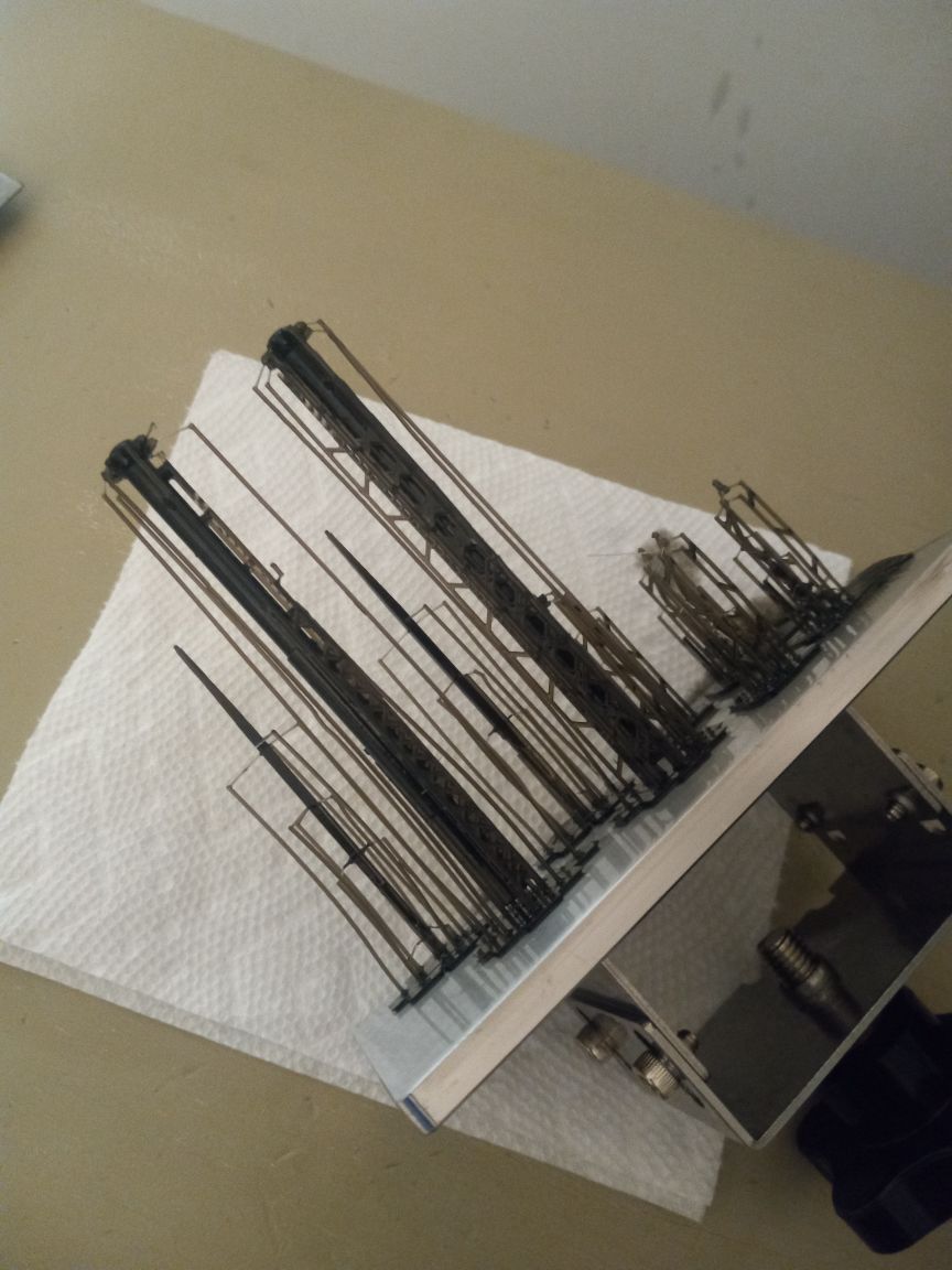

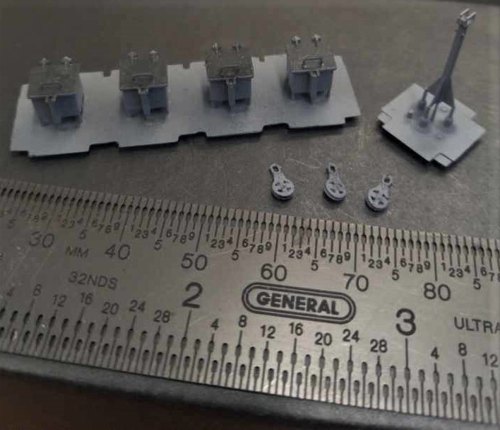

The King Posts, boat booms, and davits all printed well - once the posts were removed from the supports I went ahead and cleaned the hollow core out with a pipe cleaner and then inserted an alum tube that was sized for that dia. opening - sort of like a 3D Resin colonoscopy
Only in this case the tube remains inside............
I left all the parts under the fan to dry out overnight and am now UV curing.

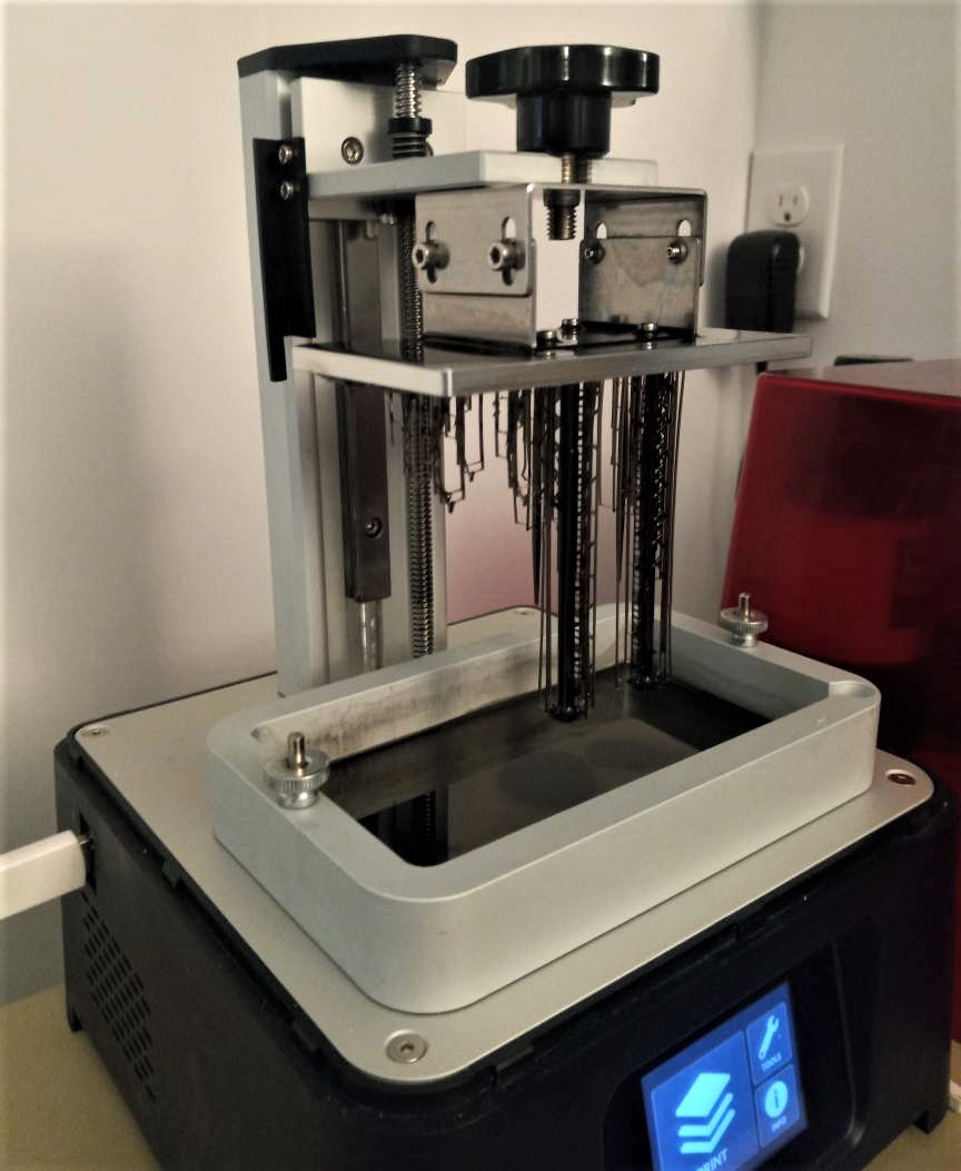

Here are a few photos of the printer and how things are oriented: These parts have reached just about the horizontal limits of my printer in an upright position rather than angled. This shows the parts after removing the upper platen from the printer for removal, etc. The Kingposts after having their center core colonoscopy - the tube will not come out and that's OK as I want to use the end as a "pin" for installation. Those tubes will keep the resin part from curvature, etc.

I had the same issue with my medical procedure and ended up taking it home with me. Those look good Hank! What I do like about printing masts is being able to include the obligatory ladders, brackets, padeyes etc. Picked up a couple of more sizes of piano wire on the way home today.
Not sure about cross trees at present but have some ideas.

I will need to print a couple more for the after set of kingposts (identical) but also one of these has a ladder end that has somewhat bulged at the bottom, so that will need to be reprinted. This week I've been working some on the LSM/R and also designing new cargo handling pieces - Also, a small 2 dog door - These are smaller W.T. doors on pump enclosure structures amidships. I've also drawn a left-hand version as these doors were located back-to-back. Whether or not these small blocks will actually print is unknown - they may end up no more than a blob as they are barely 1/8" dia. or so (if that!) - we shall see.Fliger747 wrote:I had the same issue with my medical procedure and ended up taking it home with me. Those look good Hank! What I do like about printing masts is being able to include the obligatory ladders, brackets, padeyes etc. Picked up a couple of more sizes of piano wire on the way home today.
Not sure about cross trees at present but have some ideas. Cheers: Tom

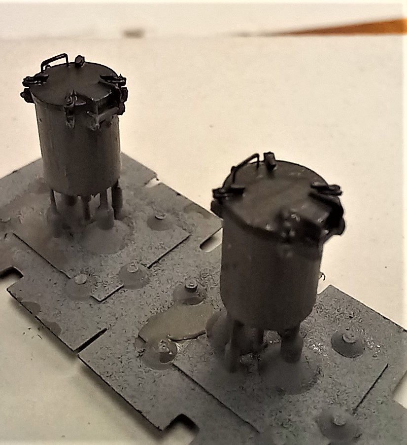

Here is a photo of two of the 30" dia. raised oil tight hatches that I've painted - Testimony that the Rapid Black resin really does a great job on details - these are 5.3mm in dia. (3/16"), so quite tiny in size.

Nice job on the pressure cookers! Should keep the fleet flush with fresh mashed potatoes.

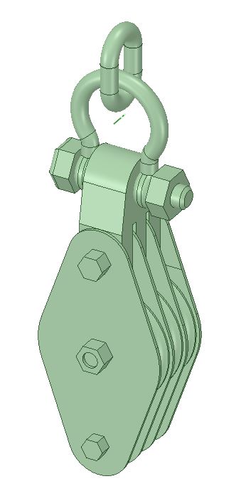

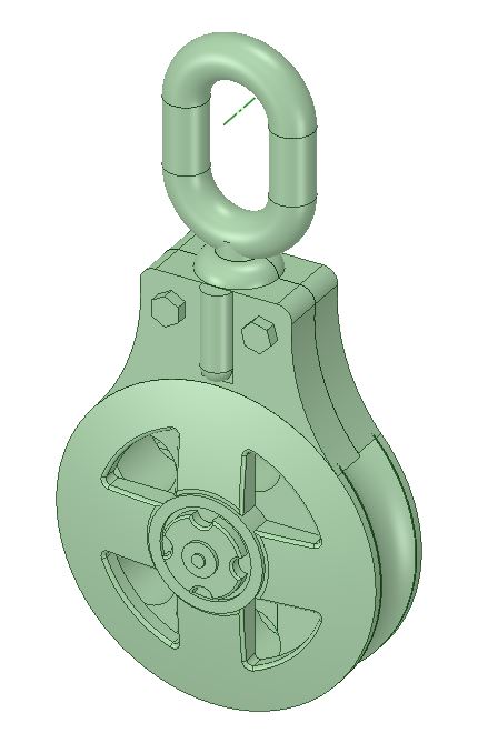

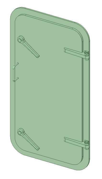

Unfortunately, the doors & blocks failed to print satisfactorily, so I redesigned this-n-that and will go out and do round 2 of printing - see what happens this time!! As we've stated before, it usually takes at least 2 design mods to get a part to print correctly and in a usable state.

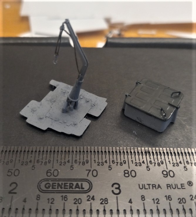

Doors did print ok, but tending to curl - so, I'll again add some thickness and reprint. Blocks a mixed bag - still working on the triple block design & orientation. However, the 16" cargo blocks did print well - here are a few photos of the recent parts design/production:
Getting ready for another print session this afternoon, so small gains amid the losses

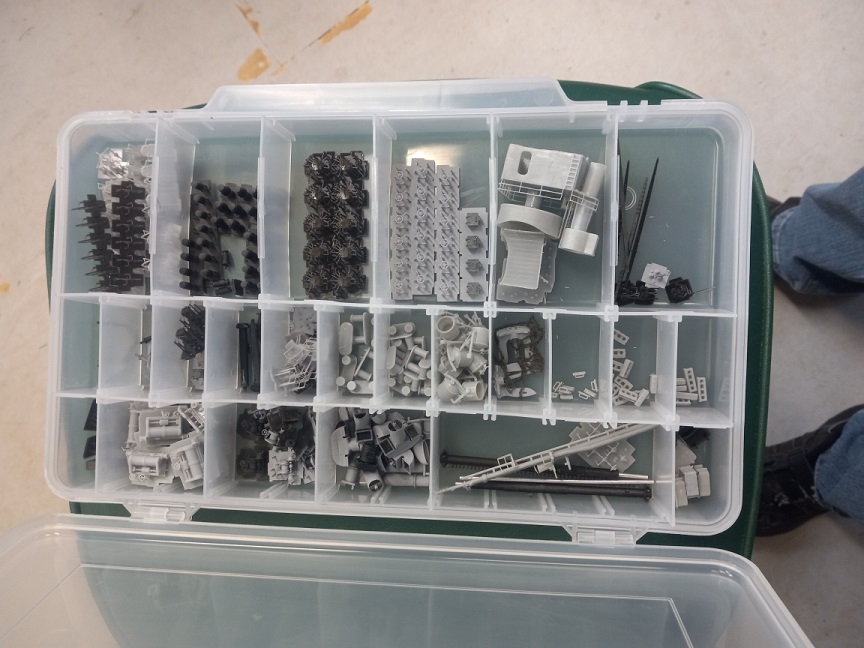

Thanks very much!!! I had completely forgotten about how to store the parts
So, tomorrow I'll do some rearranging of parts boxes and get things removed from supports and put away in cabinets until I need them - quite a task as I have three different models going (more or less). But, good advice and timely!!

Today, taking The Iceman's advice, I took most of the afternoon cleaning parts and removing supports, doing a bit of primer spraying, and getting most of the T-3 parts I've printed into a large parts box and put into a cabinet and out of the light -
Also, I printed 2 ea. of my 5 ton & 10 ton cargo booms and angled at 75� from vertical, they took 11 hr + to print, but came out nicely and I have them drying with inserted .38mm dia. piano wire inserts in each one. There is shrinkage in these parts as my original hollow dia. was .85mm and a .81mm wire would not fit. I made the bottom boom connector pieces separate and they all printed nicely, as well. I plan to develop several boom end attachments in a separate DSM file depending on how I actually display the model and which boom will be handling the refueling rig & hose, etc. They will fit over the upper end of the boom.
