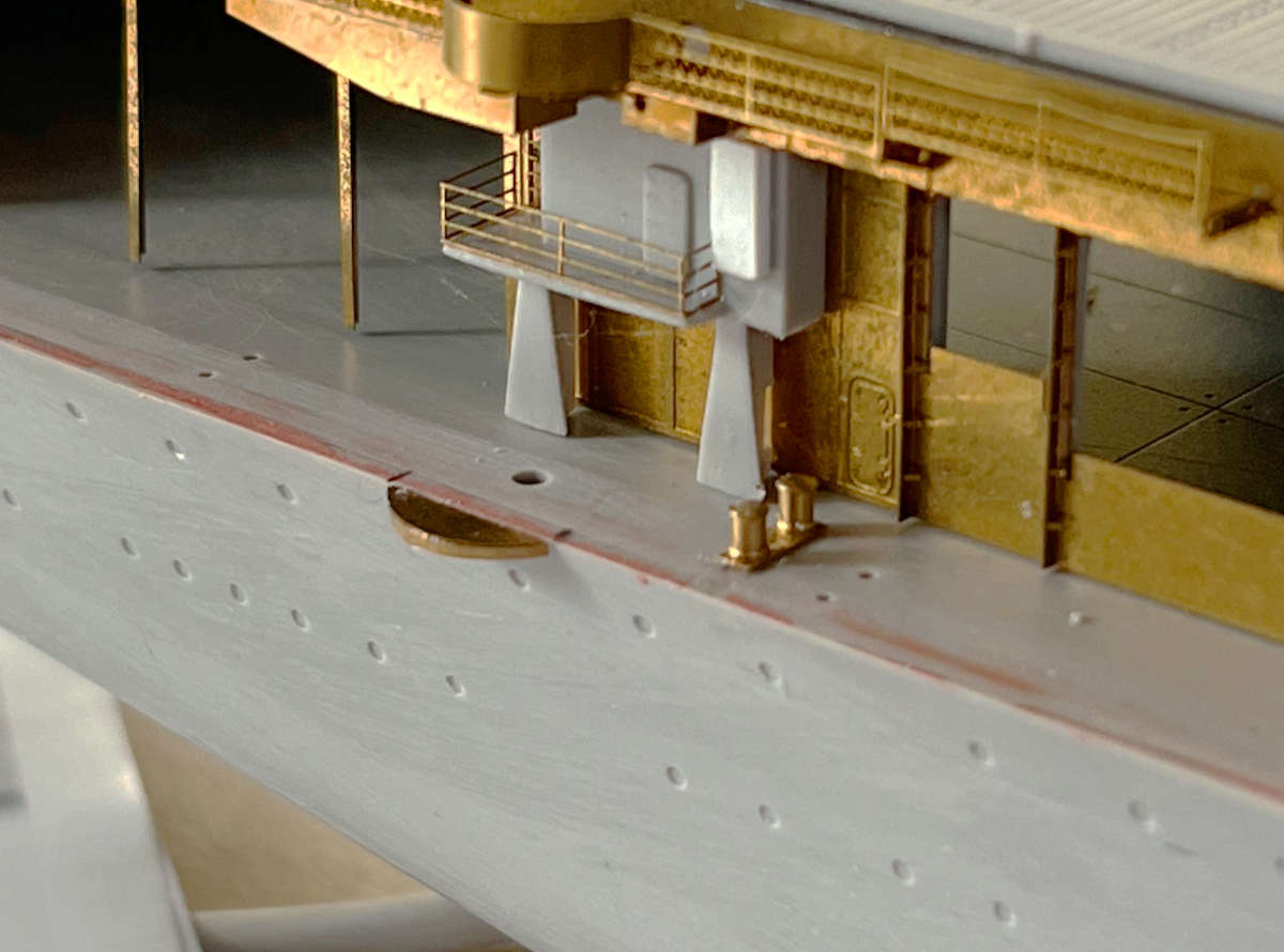

Hello:
I finally did scrape the hatches off with a scalpel blade x-acto, then glued back on just the hatch part. But now given the photo that Matt posted, I might put the 'border' back on around the hole in the deck. With just the hatch sticking up on it's own, it looks like there are 8 tiny tomb stones on the hangar deck...

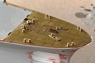

While waiting for the new airbrush hose to arrive, I had a go at the fo'c'sle. I needed to use the extra magnifying lens to get all of the tiny hand wheels and such in place. At least everything made it down onto the deck and didn't go PLINK out of the tweezers. How folks do this in 1/700 scale is beyond me.
One short comment about the bitts...and whether I'm doing them right. There is a bit of a nub on the bottom of the bitt that looks like it should be left on, so I've left that nub on. To get it to sit flush, I then have been drilling holes in the deck after I glue down the rectangular plate at the base of the bitts. I've got nearly all of the bitts on now, so I guess it's a bitt moot at this point as to whether I've been doing them right.
Mike

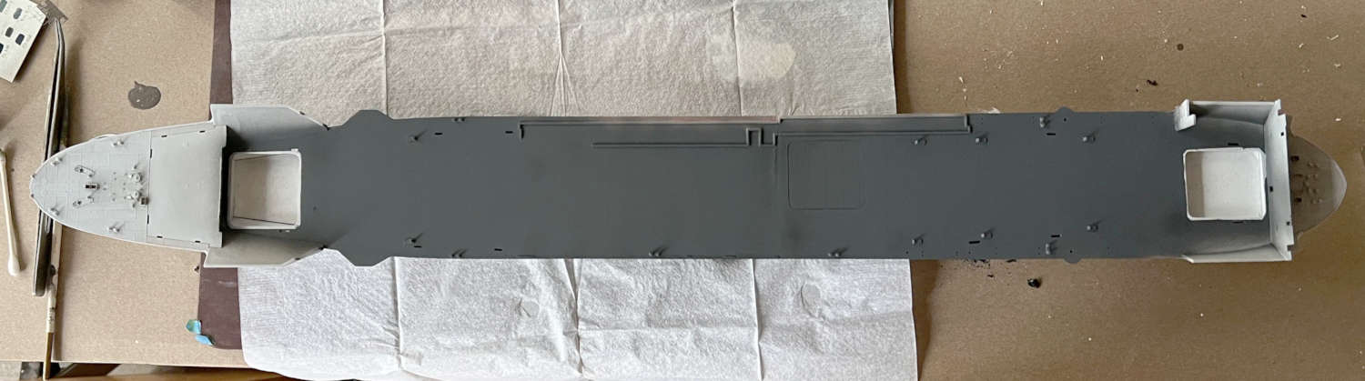

Since the hangar deck was primed, it was also then painted. I just found a dark neutral looking gray that was about as dark as the deck blue. I masked the elevator wells, as I'll paint that white. After the wells are painted, I'll put in the auxiliary elevators, railings, and the hydraulic elevator shafts, then there will be a lot of touch-up painting to do. To me, painting the hangar deck is kind of a big deal, as that was necessary to unlock a lot of other things, like adding the walls around the hangar deck.
Mike

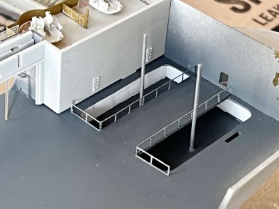

Here's a picture of the area around the aft elevator well. The fore well looks about the same. I made an auxiliary elevator, the hydraulic lifts for the main elevator, and railings. Since this area is always in the shadows and will be hard to see, I'm calling it good enough.
I'm still on the fence as whether to add some details to the walls around the elevator well. The kit walls are plain (aside from some doors that ought not to be there).
Mike

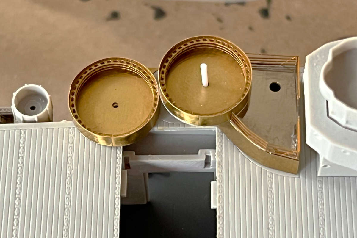

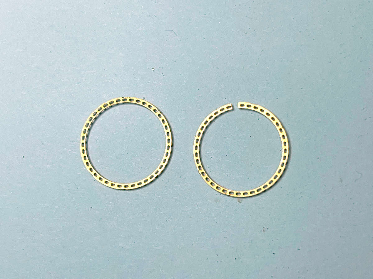

I also built the 40 mm gun tubs. For some reason, the diameter of my tubs came out a wee bit smaller than what the good people at Pontos expected. Thus, the rings that fit inside the tubs wouldn't fit. The solution is to cut out a section of the ring and squeeze it in the tub. The slight squeeze helps to hold the rings in place as I glued them in.
The second picture shows the two front tubs. The white rod is just to help keep the upper tub centered over its base. I'll eventually do something similar for the others.
Mike

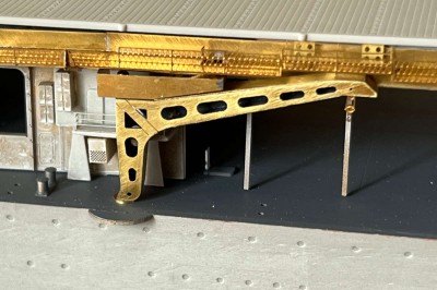

For no particular reason, I felt like making some boat cranes. Well, I was working on the catwalks in the area, and there's a fixture on the under side of the catwalk that supports the crane. At any rate, here it is. I primed and painted the inside before assembly so that there wouldn't be any shiny brass showing through the holes in the crane. I'm pretty happy with how they came out.
You may notice a gap between the fixture above the crane and the catwalk above that. At the time the picture was taken, I was doing a test fit to make sure that the crane would fit into the hole in the deck and the hole in the fixture when the fixture was in the right place. It all fit ok, so I glued the fixture to the bottom of the catwalk. Both cranes are done, so it's time to move on to something else...
Mike

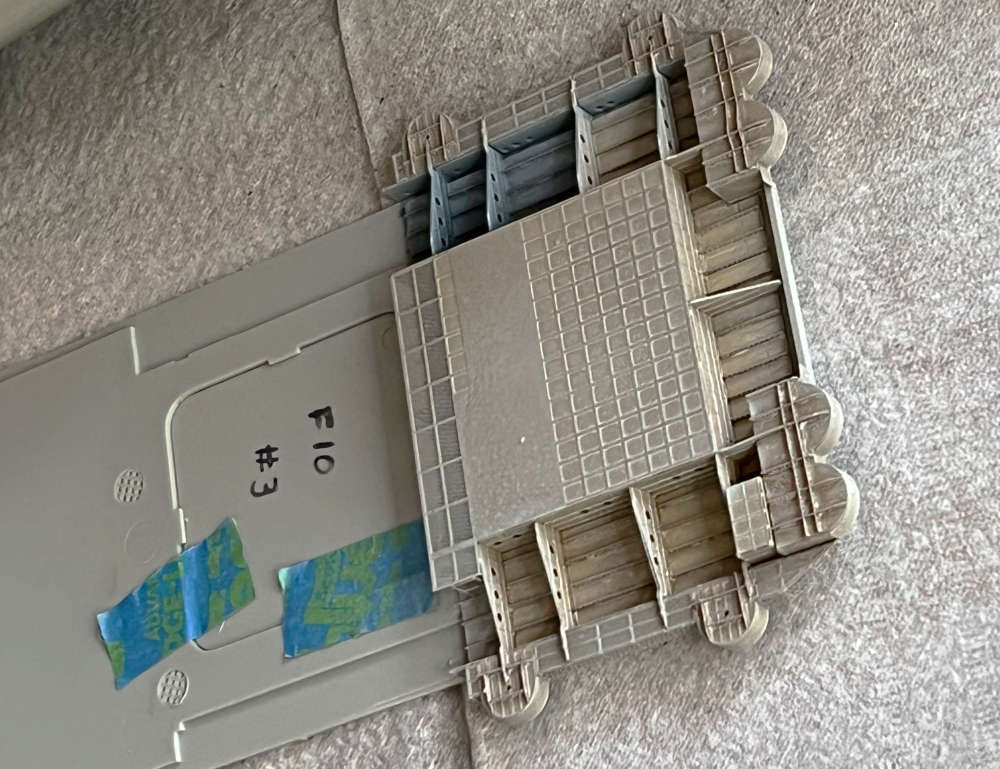

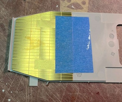

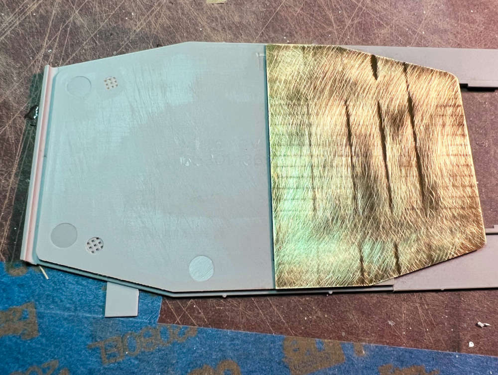

Previously someone asked about how I glued down the large photo etched pieces. I recently glued down the part that goes under the front of the flight deck, and I took some pictures of the process.
Picture #1: The part is dry fit to the underside of the flight deck. Once I have it where I want it, I put a big piece of tape on the aft edge, as that's a long straight edge and it's adjacent to a large flat area where the tape can stick to. Use as big of a piece of tape as you can...that'll help keep the alignment from shifting of you.
Picture #2: I 'opened the door', folding the part back using the tape as a hinge. Slather a bunch of superglue on the PE part, then close the door quick! When I closed the door, I tried to press down starting from the aft edge and working my way forwards so that I wouldn't get any waviness.
Mike
Mike

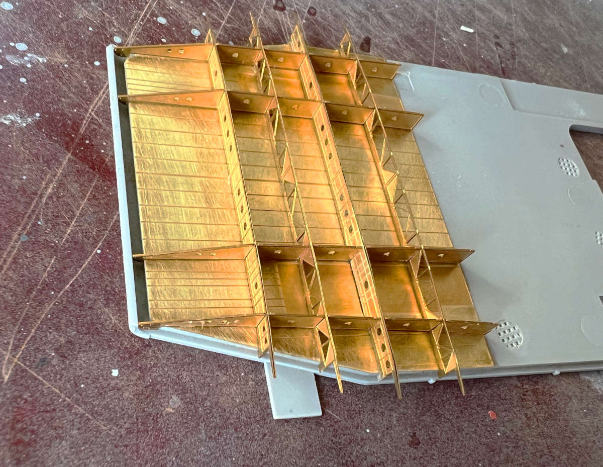

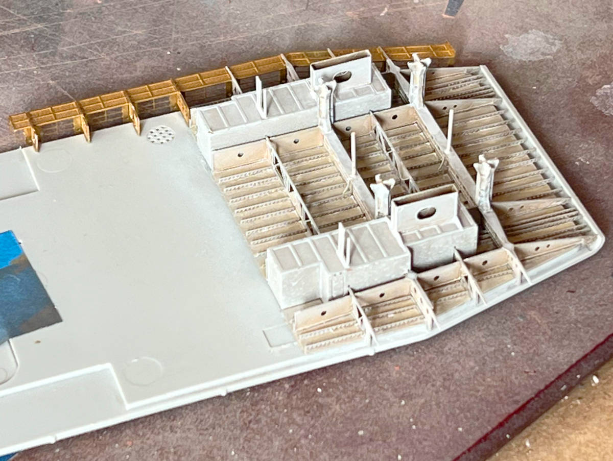

Attention then turned to the big girders that support the front flight deck. These slot together, and the fit is VERY precise. I slotted them together (as shown here), and THEN glued them down. In this picture, there is no glue holding anything together, they're just slotted together and resting on the flight deck. I needed to sand inside some of the slots to get enough clearance, and even then it was a snug fit.
If I followed the directions, which appears to suggest glueing down the length-wise girders and then adding the cross-wise girders, I wouldn't have been able to get things to fit. I've run into that problem elsewhere with the Pontos set. I just can't glue the parts down accurately enough to get the slots to all align. The only way I've been able to get it to fit is to slot them together and then glue.
In other news, parts A15, A17, and A22 are mislabeled in the instructions. The space between the cross-wise girders are all a bit different, so there's only one space where each fits well, so it's easy to figure how where they ought to go. Also, parts A61 in the instructions are actually D61 (these are box like things that go between the flight deck and the fo'c'sle deck).
Mike

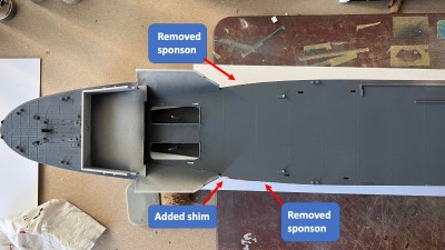

Before I start gluing on the hangar deck walls (for lack of a better term), I thought it'd be good to finish major hull work. Unfortunately, that opened up a can of worms. Careful inspection of photos showed that the sponsons for the hangar deck catapult were gone. Apparently they were removed in mid-42, a little after Midway. Out came the razor saw, clippers, and files, and within a few minutes they were off.
Another thing that I noticed recently a problem with the roller shutter tracks on the front port corner. For the front thin vertical photo etch bit, its bottom was hanging in mid air outboard from the edge of the hangar deck. So, I added a little shim of sheet plastic to widen the hangar deck by maybe 1 mm, right in front of the sponson (no longer there). Now the bottom of that part isn't hanging in mid air, and has something to attach to.
Mike
