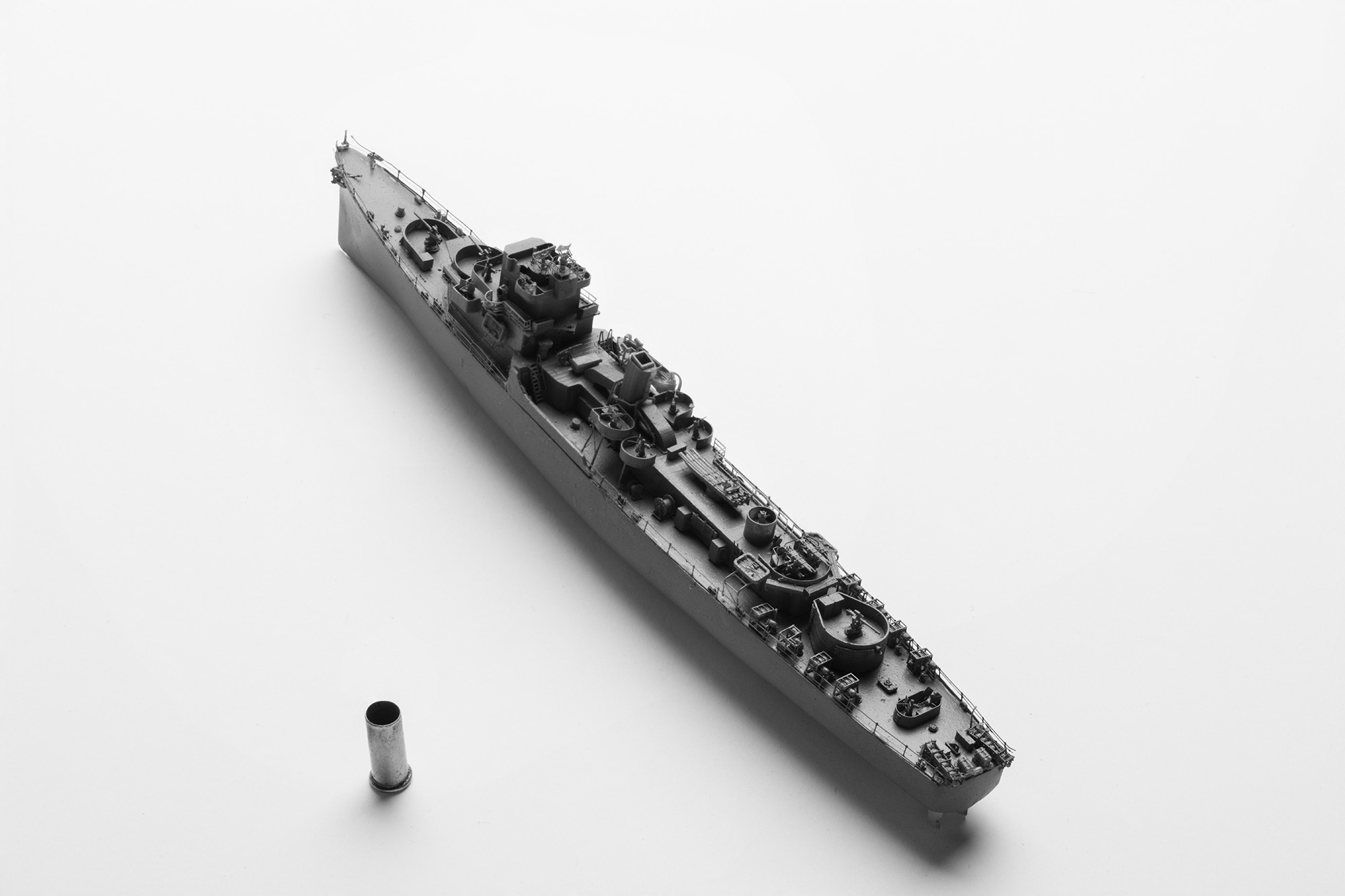

Today's progress. Note the sky lookouts and 26' MWB's. Also 2.5 M rangefinder and Mk51 Director on the bridge. Later the MK51 was replaced with the MK 52 with MK 26 radar attached.

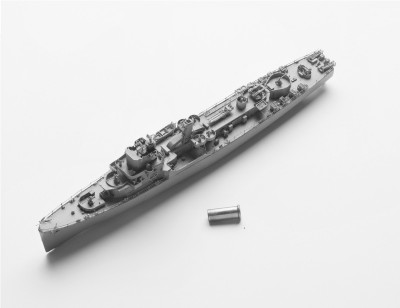

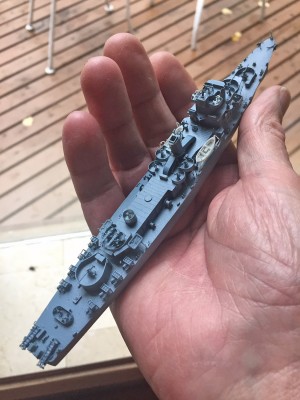

An idea of the size of this "ship"

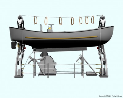

Yet again under the "Wah hail" modeling clause the drawings showing the arrangement of the boats and davits appear to be misleading. The issue is the drawing shows a strong back with two bumpers, being on the inside of the davits and helping to secure the boat when swung inboard. So far I can't find a single photo showing the strong back. In fact most of the DE photos only show the starboard boat shipped. Redrawing the boats, or boat and davits.
Until more info becomes available on the power reel setup I have installed (easily removable) triple torpedo tubes. Still have to cobble up the crane, no sweat.

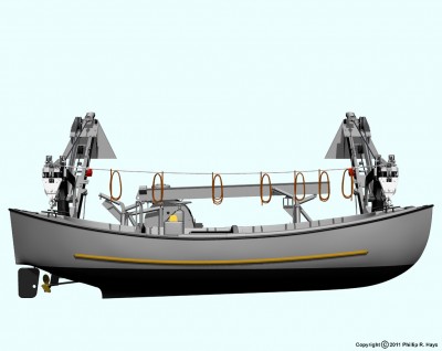

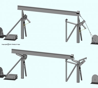

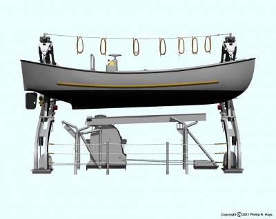

Tom,
This is just a wild guess about the strongback under the motor whaleboat. Below are some images showing how the strongback worked on the OK City.
Here is a picture of the strongback in the raised and lowered position. It pivoted on the short arms at each end. When raised it was held in position with lanyards tied to cleats on the uprights and a cable attached to the deck. When lowered it rested on supports on the uprights. Although the cruiser had gravity davits and the DE had swing out davits the strongback might have worked the same way.
In the nextpicture the strongback is raised to support the boat and the boat is lashed to the davits. In the third image the strongback has been swung down to leave the boat supported by the davits. The last image shows the boat lowered outboard to the boarding position. As I said, I really don't know how the supports worked on the DEs but this gives you an idea how at least one support worked.
There are a few more pictures here that show the single bank, double arm, trackway gravity davits working with the whaleboat:
https://www.okieboat.com/CAD%20miscellaneous.html

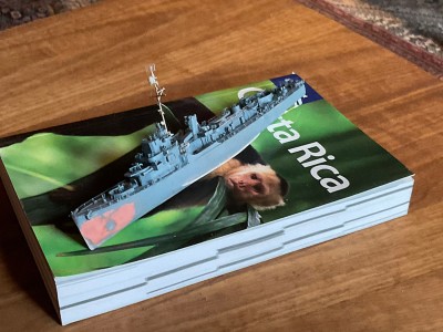

Today I added the Torpedo crane and the MK 52 Director with the MK 24 Radar unit. Currently the proto model is only carrying a MWB on the starboard side with no davits to port. I tried adding the secondary steering station just behind the aft MK 51 director but all three example flew off into tweezer hell.
A fun tiny project, learning a lot. Not sure about the lifelines as yet in this scale, it's pretty tiny and the resin isn't that fun for small bits.
Best regards: Tom
Thanks for the info! Certainly a lot of innovation went into davits, the gravity davits were capable of quick deployment, which is why they were especially useful on the APA's. For whatever reasons, probably weight and space, the WWII destroyers stayed with traditional old fashioned davits dating from the days of sail. Not seeing the strong back in any photos and I don't recall seeing any on ship, though they could be of use. The ability to lower them clears up how the boat got from one side to the other. Looks like Whitehurst at the time carried just one boat, starboard side at the time in question. Hank Strub who was assigned to Stoddard's boat crew for plane guard duty only recalls the strapping.

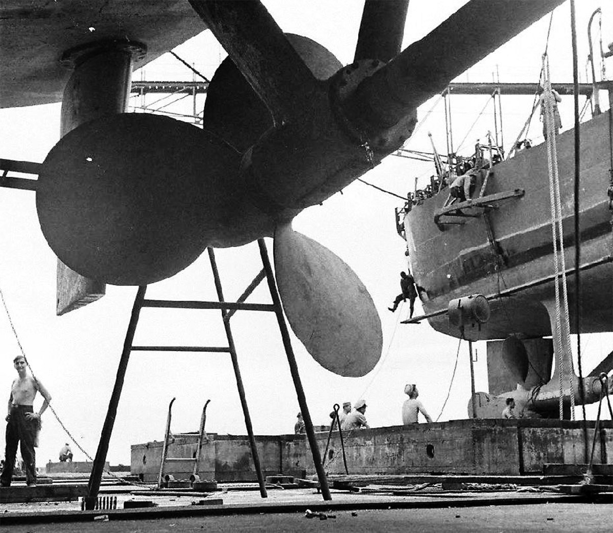

I found a photo in a floating dry dock of one of the screws and rudders which shows both the three blade props, direction of rotation (typical for destroyers) and the method of pivot for the twin rudders. I haven't yet gotten any sound dome info, though at this scale it is grain of rice in size. For a larger model these are constructible details.
