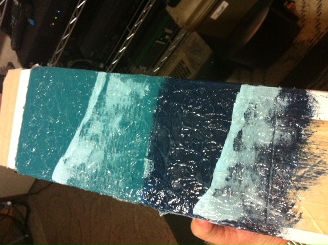

Here are some shots of my tests on an old box.
first one was royal blue as a base color, then morning blue for the wave/foam. Then the silicon built up and brushed/drybrushed with white on top of the silocon.
The second pic here are a few different base colors, Midnight blue, and Ocean blue.
Going to try for some more grey looking water maybe this weekend. I'm open to suggestions on color. i'd prefer to use inexpensive hobby shop acrylics if i can. they seem to work extremely well for this.

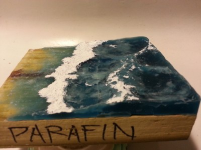

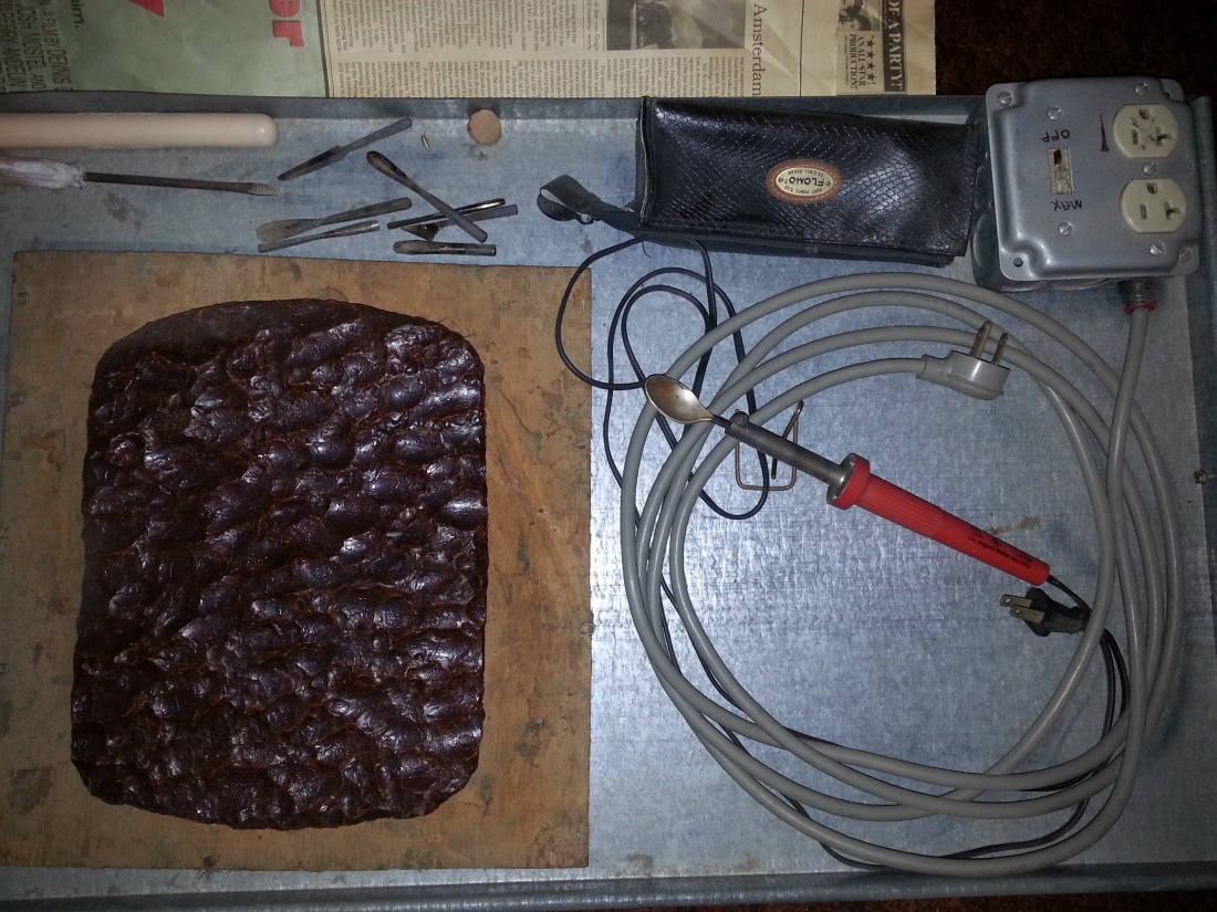

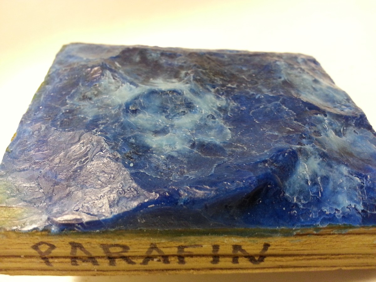

Years ago I promised to find the perfect way to model water - I believe I found it
Making water using wax
So here goes, while taking some art related courses, mould making, lost wax to be exact, I cast an 18 inch chunk of ocean in glass, with a bronze whale diving through it. Next was the "proof" piece, a 6 inch wax square with a 1/700 Alpha.
Perfection!
The tools you need are a wood burning tool with changeable tips, metal double ended scupting tools(cut them in half and fit into wood burner). A variable power source. These are for smaller scales. For larger scales an alcohol lamp and an assortment of spoon sizes.
When you work the wax it's liquid, as soon as you remove the heat it freezes in place. You can move large amounts or very small bits, vary the heat to change the effects. Use low heat and "pop" the tool off the surface and you get the amazing vein texture that makes the water come alive. The more you work it the more tricks you'll learn. Stipple the foam with white paint, no gloss, all the other water is glossed over.
Experiment with differant waxes & paints. Dyes/tinted wax will bleed into paint, you can play with white drier lint (after you remove the hair & dingleberries), and cut brush bristles for spray & splashes depending on scale. Any time you want to change it, repair it, add to it, you can. To tint you might try blending crayons into melted wax.
You can use a solid chunk or any base you want, use glass or plastic and sculpt above and below the surface with the ship suspended in it. To melt larger amounts you need a crock pot, don't inhale the fumes, wax will stay in the lungs, it smells nice!
I felt bad all these years reading about the problems model makers have with water. I have seen some great water, but no matter what you use if it don't look like the picture.....
For the best results the tools should be metal and "spoon" shaped.
I also found myself nodding out because of the calming soothing repetitious wave forming, you might consider coffee or an energy drink !!
If you need some help with the type or tinting/painting of the wax I suggest you visit an art supply store, not a hobby shop.
Many artists sculpt, paint, make moulds with wax and may have some helpful tips. The people working in the store can also be very helpful.
Good luck
Al

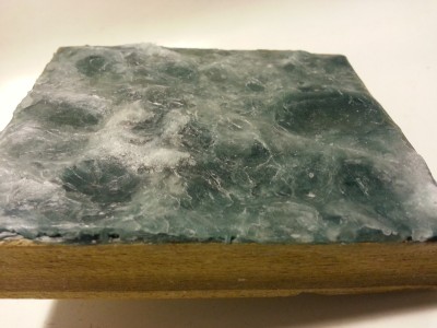

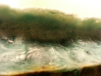

Images of my experiments are below:

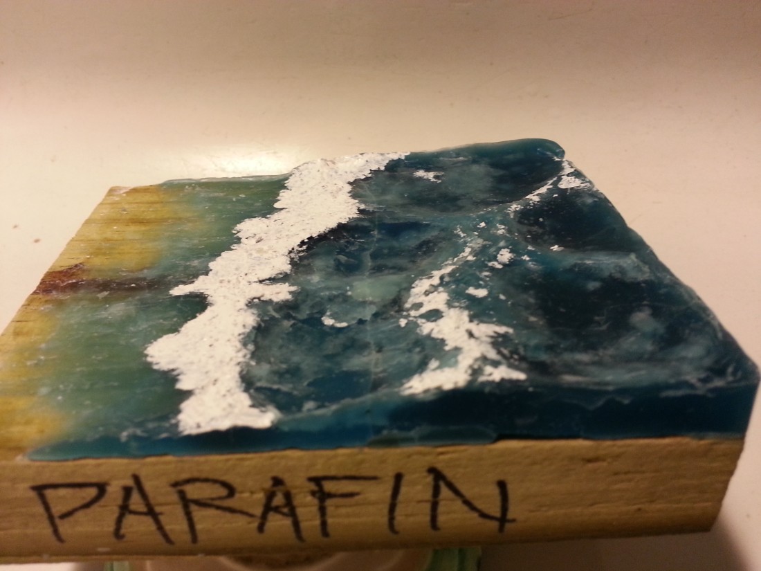

afarkas
Re: Compendium of model-water making links

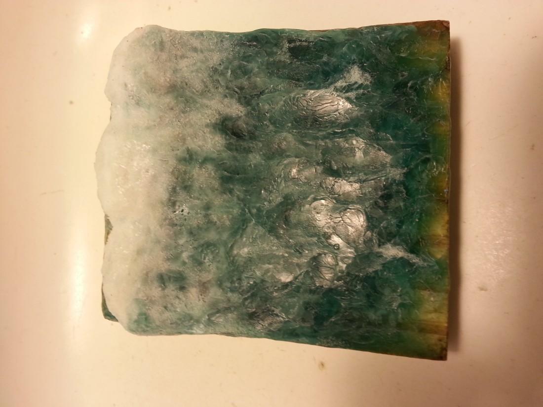

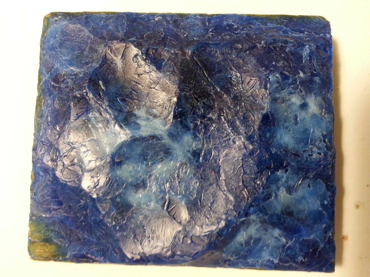

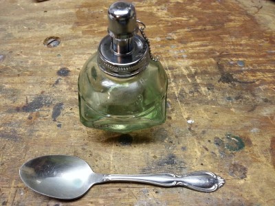

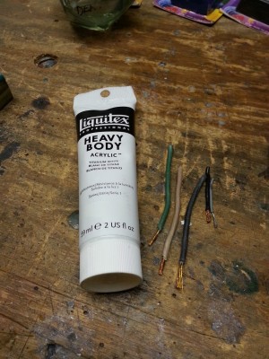

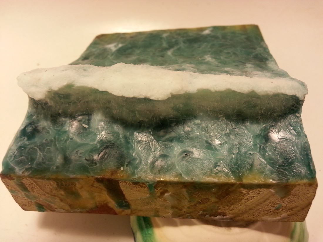

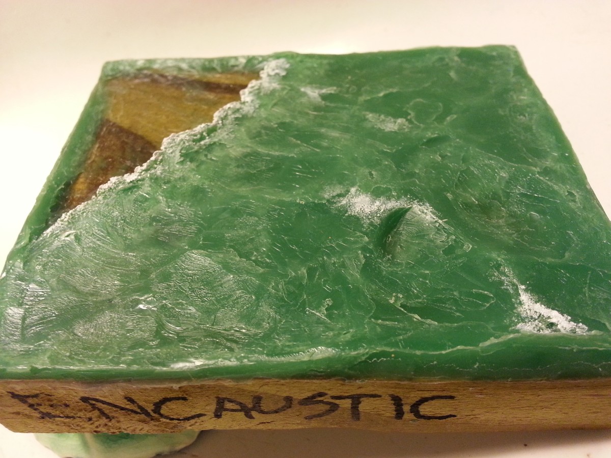

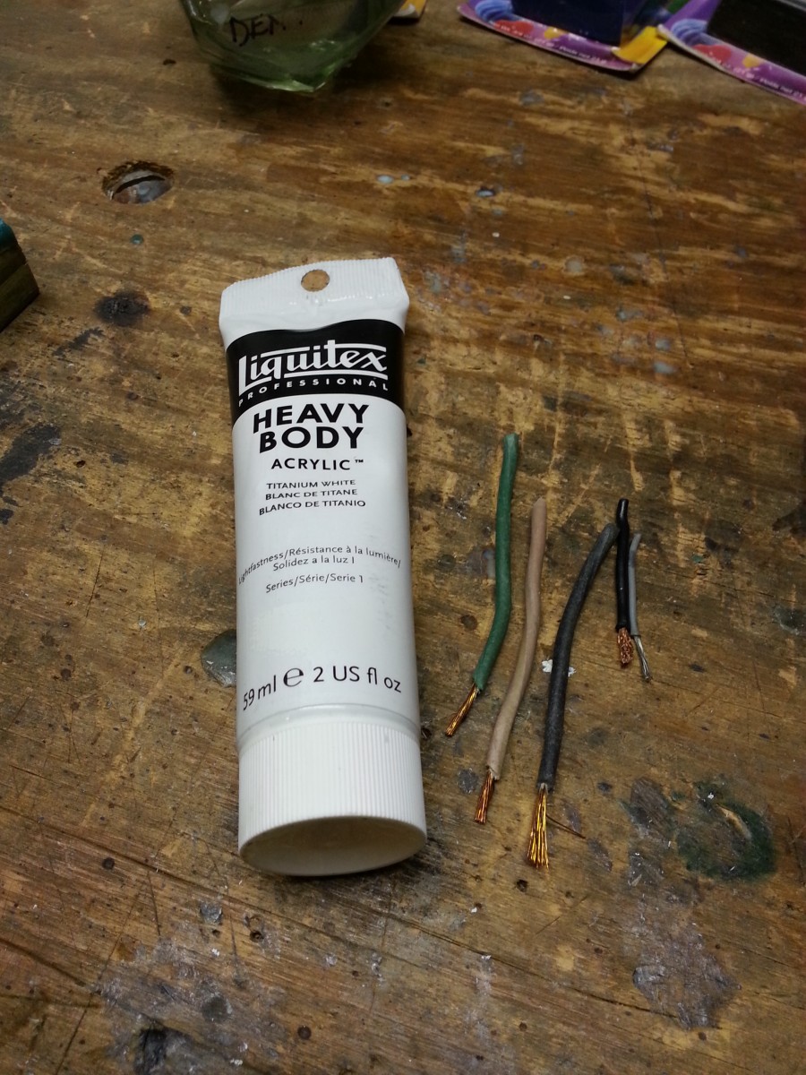

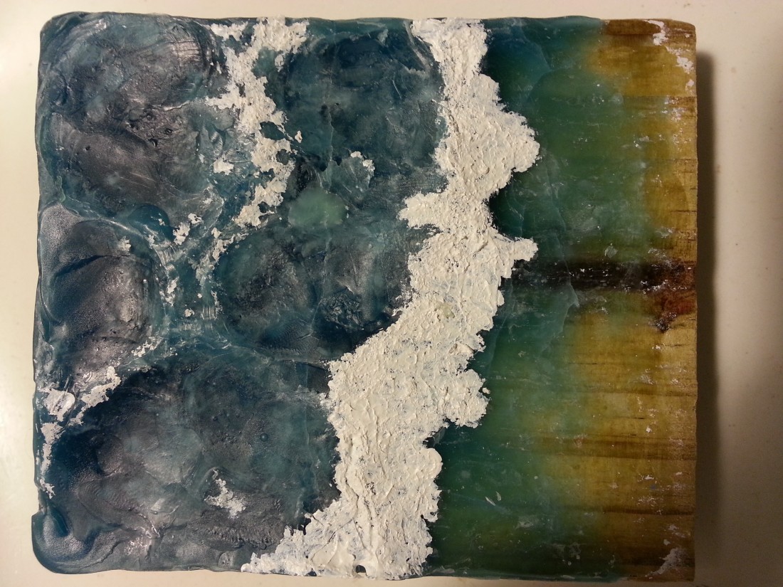

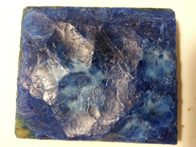

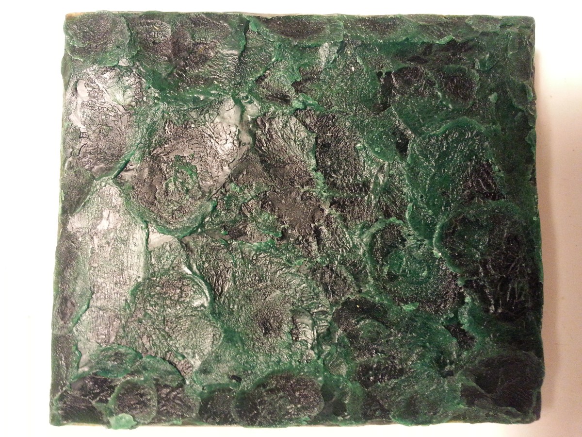

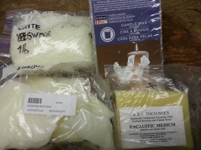

These are the 3 waxes I used. Bleached Bees wax, Parafin , and Encaustic. They all work equally well.
You melt the wax in the Coke cans, using the alcohol burner.
Add some colouring, candle colours, only 4 colours used, green, blue, black, & white. You can use liquid or solid.
Pour into your mould.
Sculpt with a spoon heated on the burner, the measuring spoon set lets you get a variety of sizes.
To make the white caps use the wire to fluff up the foam then stipple with the brush and the heavy body acrylic white paint.
This is what I used to make all the models.
Use these to make the foam.
afarkas

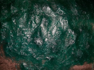

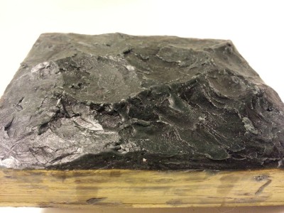

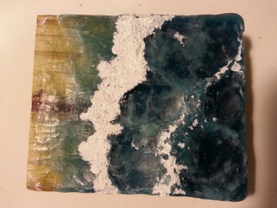

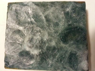

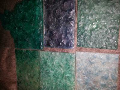

Here are some more images of the effect achieved

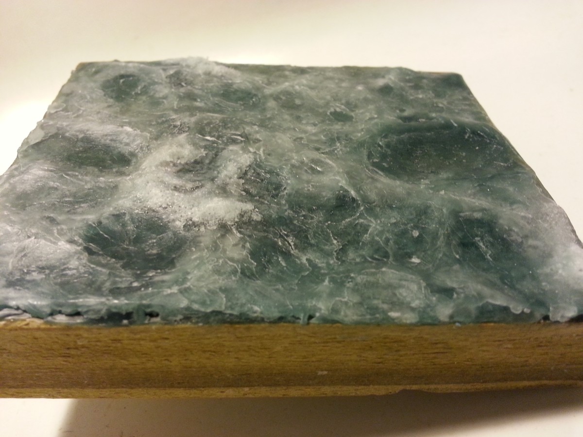

alfarkas

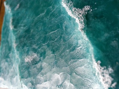

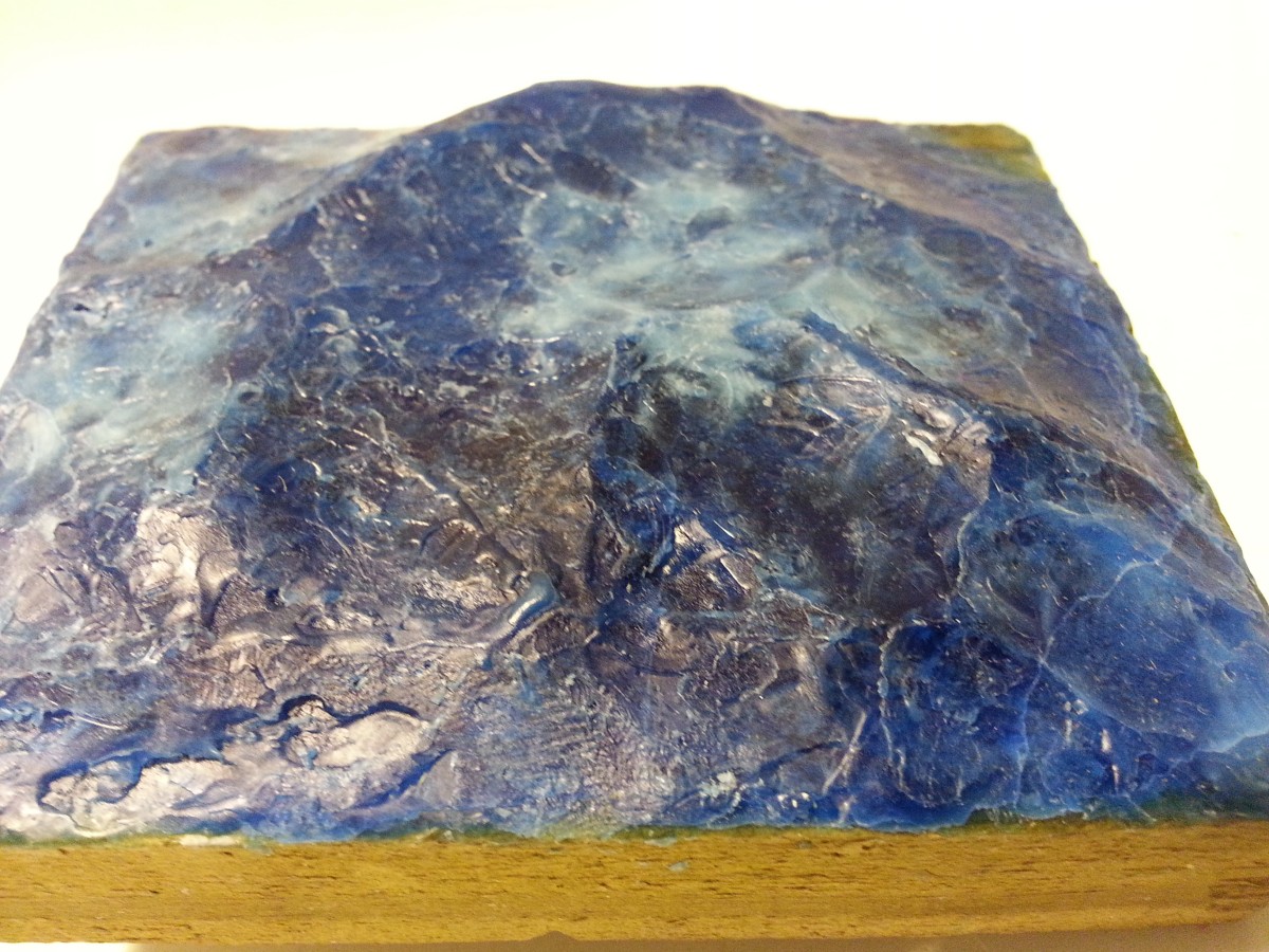

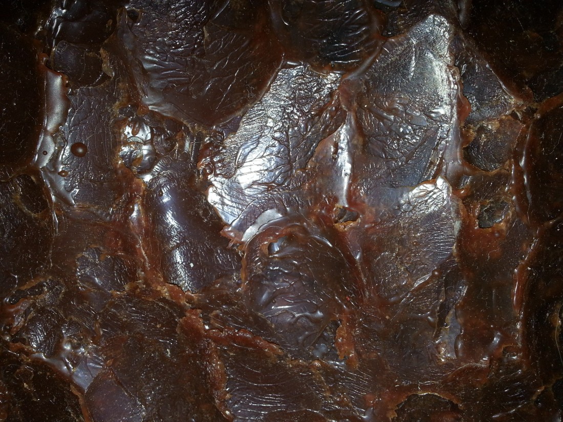

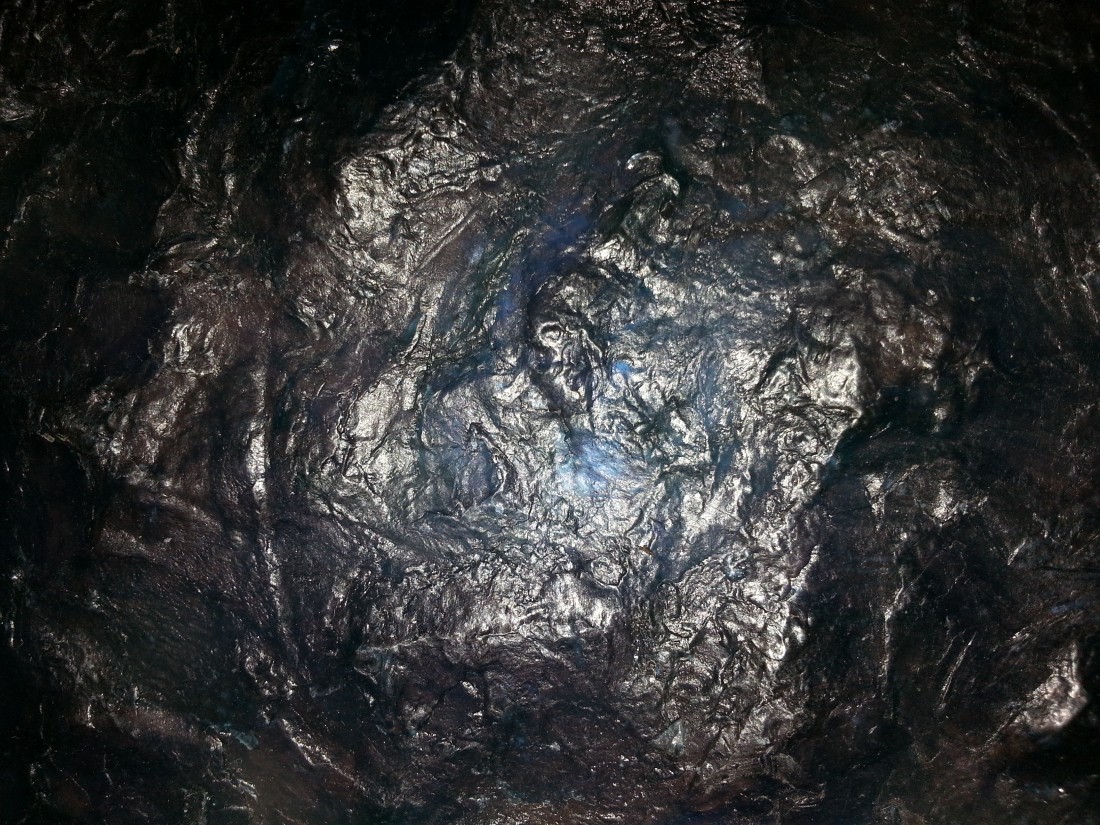

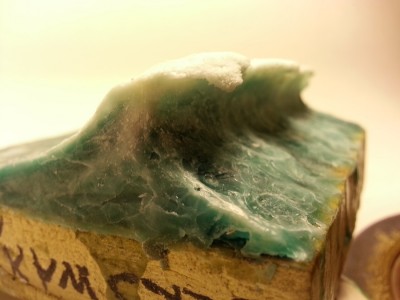

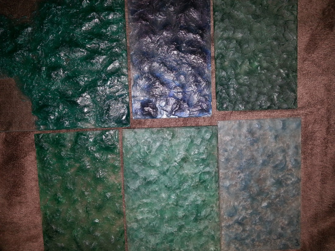

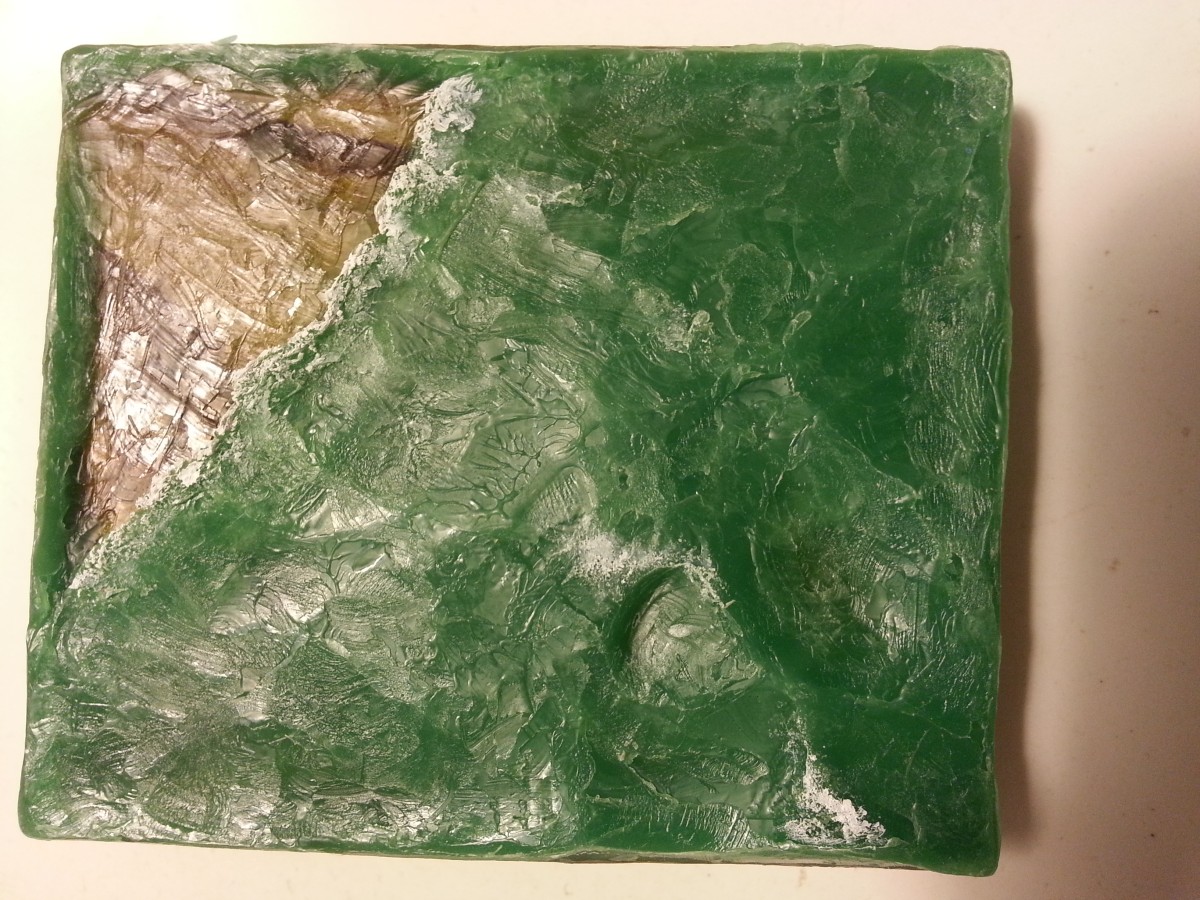

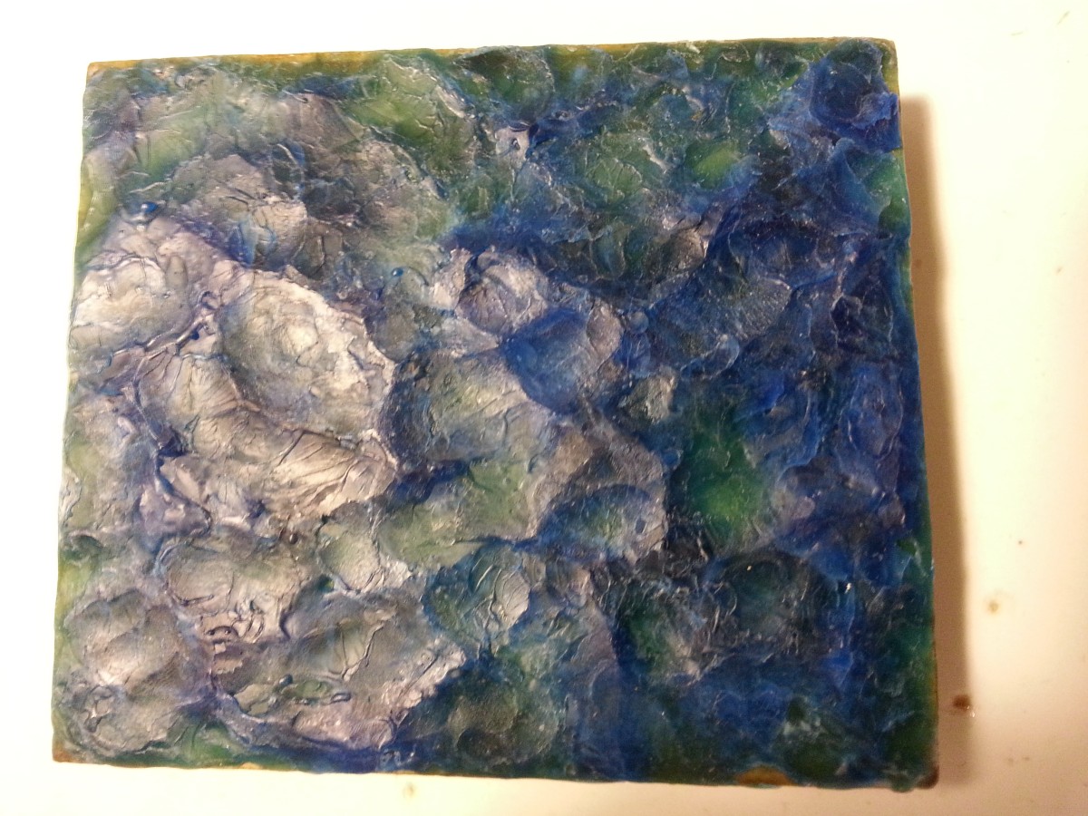

some more images of the wax watermaking experiments
Hope it can be helpful to other modellers

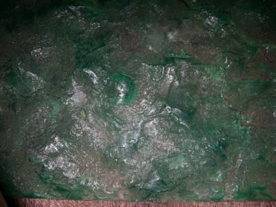

Just adding my 2-cents of a method here, as a few people asked me how I did this Varyag seascape: http://www.modelshipgallery.com/gallery ... /index.htm
Sea scape using toilet paper (TP) and white glue.
There are two advantages that this technique brings. One is that the undulations of the resulting surface are more or less in a parallel direction, tricking us into thinking a breeze is blowing. Second, it is very forgiving: if you goof it up, a bit of water can help undo things, and adding a few pieces of TP can patch it up.
I have used it both on a flat surface and on styrofoam that was already given the basic shape of the waves. In other cases I lay down wires on the surface where the ship�s wave pattern will be, prior to applying the technique. The general idea is that the TP layer will be the final fine-grained layer of the sea surface. Any larger patterns will have to be there before you apply it.
Toilet paper or other kinds of cleaning paper wrapped in a cylinder has one characteristic that is relevant to our task. When you spread it on a flat surface and sprinkle water onto it, it wrinkles form mostly in a specific direction, parallel to the axis of the cylinder. I had success with plain tissue paper also, though one has to experiment to find the direction of the wrinkling.
Once the TP piece is laid down flat, I use either a syringe to wet it drop by drop, with diluted white glue; the degree of dilution is not important, but it should be on the watery side. I do this going left to right (parallel to the direction of wrinkling) over one edge first and progressing in parallel sweeps until I reach the opposite edge.
Sometimes the wrinkles fold over themselves and that does not look natural for a sea surface. Just make sure that the piece of TP is flat before you start wetting it and go gradually. Sometimes, once I wet the starting edge, I hold the opposite edge with one hand keeping the piece taught, as I progress wetting it in parallel sweeps.
Of course the sea base will be made of many pieces of TP that will be laid down progressively one by one overlapping each other. Two things to keep in mind here. One, if you leave the TP pieces intact, their straight edges will be very visible in the end product. So before you lay them down you need to pluck their edges so they are shredded. That will allow them to blur with each other as they overlap. Second, you need to remember the original orientation of the piece of TP as you pluck the edges, so that all of them are laid down in the same orientation. You don�t have to be exact here, within 10-15 degrees is good enough.
I lay down one full layer covering the whole sea scape, wait for it to dry and then repeat 3-4 times. As the thickness increases, the wrinkles become more pronounced and the sea becomes more pliable. At this stage you can use an old thick brush to pound on it perpendicularly and shape the waves that way.
Once you like the surface pattern you may put down your base paint. I use acrylics and have not experimented with oils. You may air or hand brush this; doesn�t make a difference. You can dry brush the wave crests or apply a darker wash at the valleys, but the next step will diminish the effect so I would not spend much effort on this.
The next step is to apply a layer of undiluted white glue with a brush. Be generous and let it dry. It will give a shiny texture to the surface and make it look darker, so take that into account when you decide on your base color.
If the ship is in motion, I start painting the area near the ship after this layer of undiluted white glue is applied. This is because the white you apply will momentarily dilute the white glue and blend in. So the white will not stay on the surface but will enter the layer of white glue. (Again I caution you that this pertains only to water-soluble acrylics.) If the white is too much you can use the base paint again to correct. You can achieve variations of lighter blue hues this way and the layer of white glue at the top gives these some �depth�. I always enjoy this part. It takes some getting used to because as you paint, the white glue is diluted and turns white. So let things dry before you check the results of a session and decide on applying more white or more of the base color.
Once I am happy (or too tired) with it, I apply another final layer of undiluted white glue. I have tried a gloss varnish, but I find the white glue shinier.
I hope you will enjoy playing with the technique and do remember to report back any additional tricks you come up with. But I tell, you, when I grow up, I want to do the seascapes sargentx is making. Man these are great!
