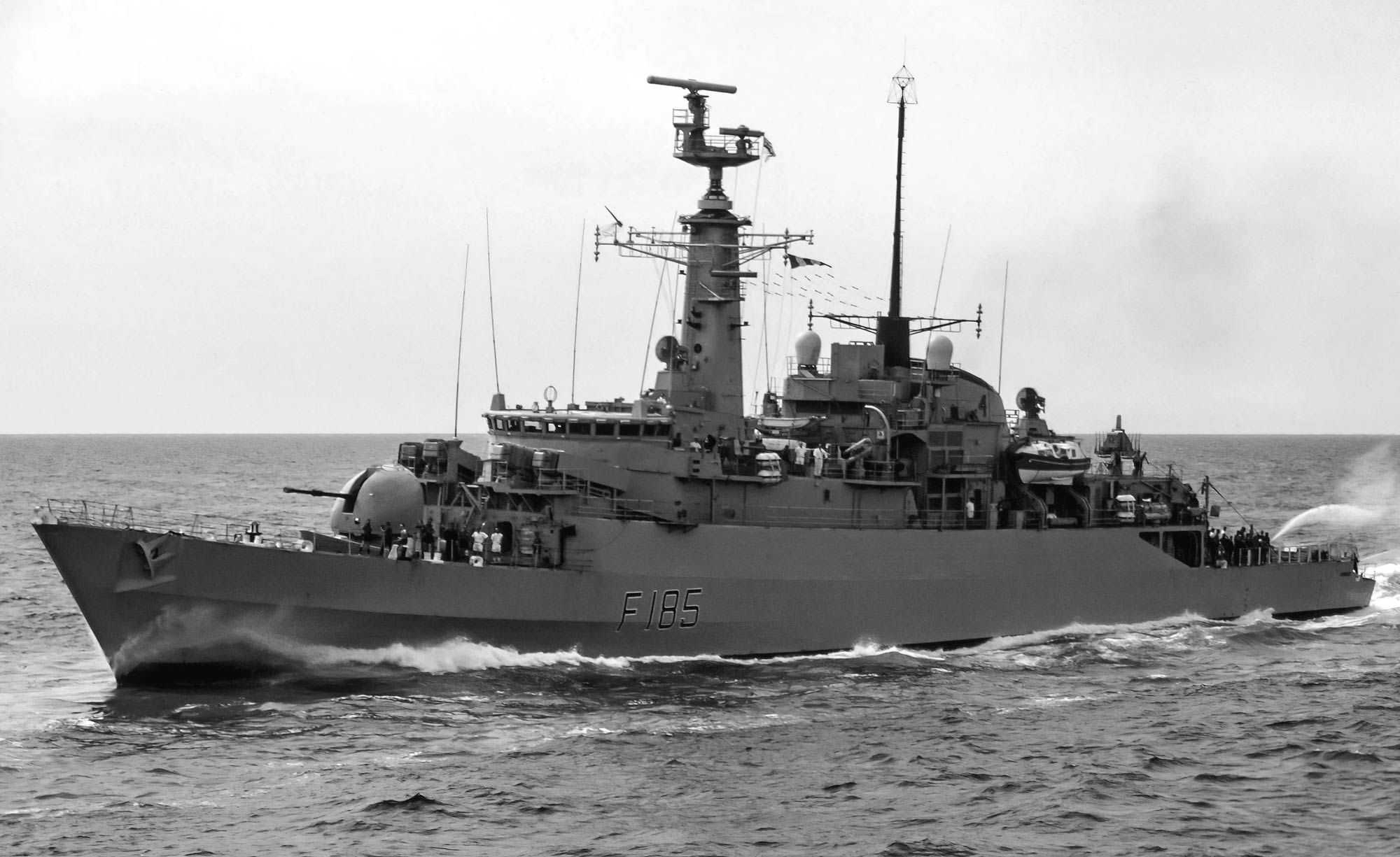

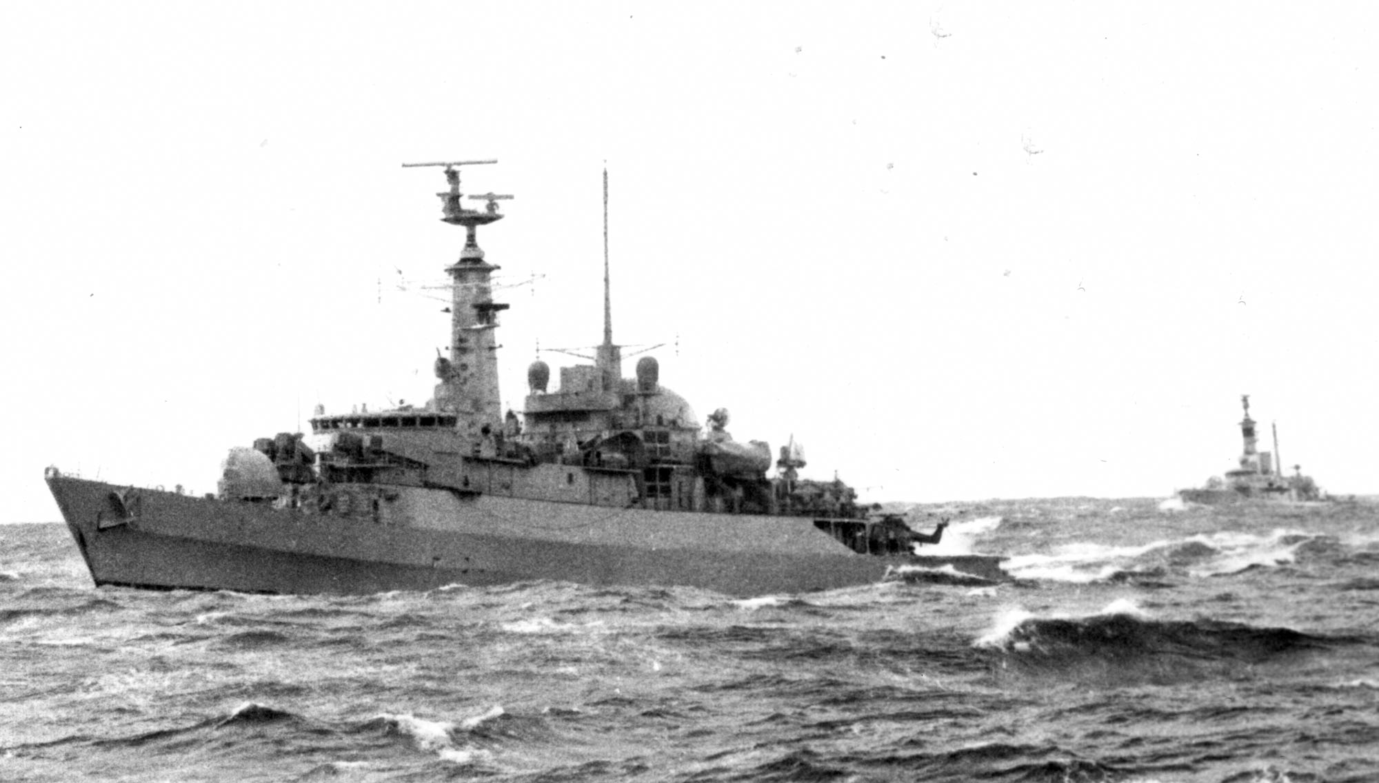

I wonder if anyone would care to ID this ship. The photo was sold some time ago on eBay as HMS Exeter D89, but...............................
tjstoneman
Posts: 444
Re: Calling all Royal Navy Type 42 class (Batch I - III) fan
Post by tjstoneman »
I believe the so-called "HMS Exeter" is actually HMS Avenger. Noting the presence of HMS Andromeda astern of her (recognisable because the other Seawolf-fitted Leanders had jammer radomes on their foremasts when initially converted - Andromeda's were fitted after the Falklands conflict), and that she arrived in the conflict zone after Antelope and Ardent were lost (and left before Amazon arrived post-fighting), that eliminates three of the Type 21s. Neither Alacrity nor Active had ESM aerials below the foremast radar platform in 1982, as this ship does, and neither Arrow nor Ambuscade carried SATCOMs aerials for'd of the funnel during the campaign.

Post by KevinD »
Thanks TJ. I think your on the money (again) there!
