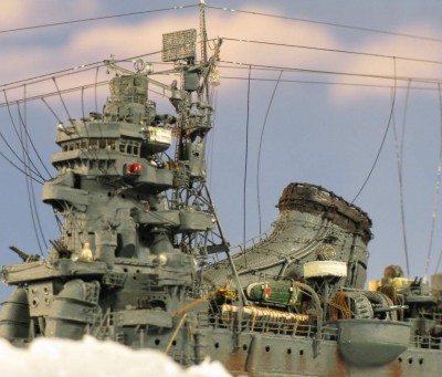

forgot the picture:
Tone (1/350) with additional rivets on funnel and hull (Archer Surface Details)
close up funnel
close up funnel
IJN Tone2.JPG (61.76 KiB) Viewed 4695 times
Re: 1/200 Yamato
Posted: Sun Sep 26, 2010 6:00 pm
by Dirk
Now my message and the pictures are separated. Therefore here the text belonging to the pictures above again:
I saw that you discussed adding rivets. In my IJN Tone build (1/350) I added a lot of rivets. See in the picture above on the funnel and the hull:
The hull from the Yankee Modelworks model did not exhibit much details. I used here for the first time Archer surface details rivets (actually decals, but with rows of 3dimensional resin rivets). For 1/350 scale I would recommend the smallest versions (0.2 mm) and the double row rivets. I used also larger ones and some of the finer weld beads. In your scale 1/200 you have more chice. These surface details can be found on this page:
http://www.archertransfers.com/catSurfaceDetails.html
Only problem: When the rivets are overpainted with final color, the adhesion is a little bit weak. I realized this when I later used Tamiya masking tape on it: One row of rivets (out of 6) was removed with the tape.
