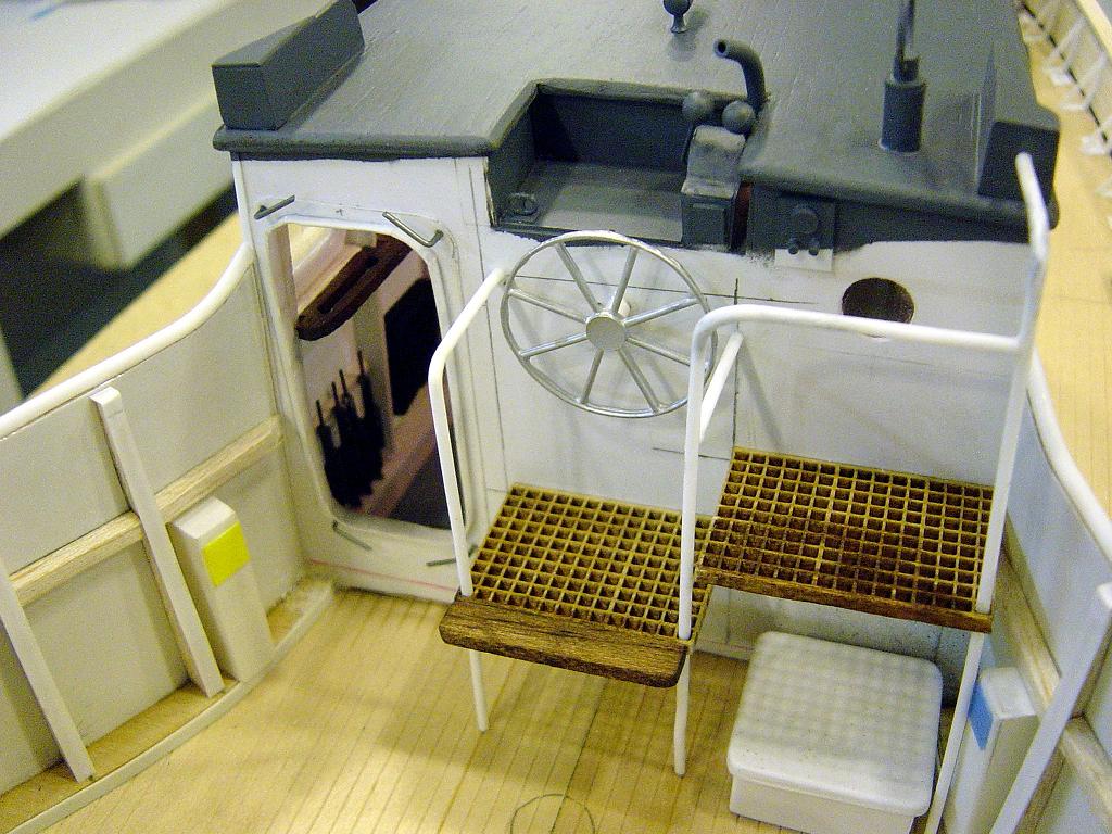

Won't the machine guns be affected by the heater?
If the machine guns are affected by the heater i'd day they won't be stored next to the heater.
Are you sure they've placed them their?

tweety777 wrote:Nice looking model!
Greetings Josse
That is where we had them racked right next to door of PH----5 Riesing sub-machine guns----I gave Bill the location and he kindly put them in for me---
Re: Scratchbuilding a WW2 USCG 83' Cutter in 1/24
Posted: Fri Oct 22, 2010 9:14 pm
by Bill Waldorf
The machine gun placement is correct. I got the info from the Master Chief onboard during WW2. He was THERE, so I assume it is correct. This man has an amazing memory at 88 years young! Has helped tremendosly during this build. He is a very fussy man! Thats OK, we wanna get it right. Doing the best I can. I believe what I will produce will be dam close to the real thing. How many of you out there have someone that was onboard any ship or boat during WW2 guiding things along??? I suspect not many. I am lucky I guess. Enough said.............More to come ........ :wave_1: stay tuned.....

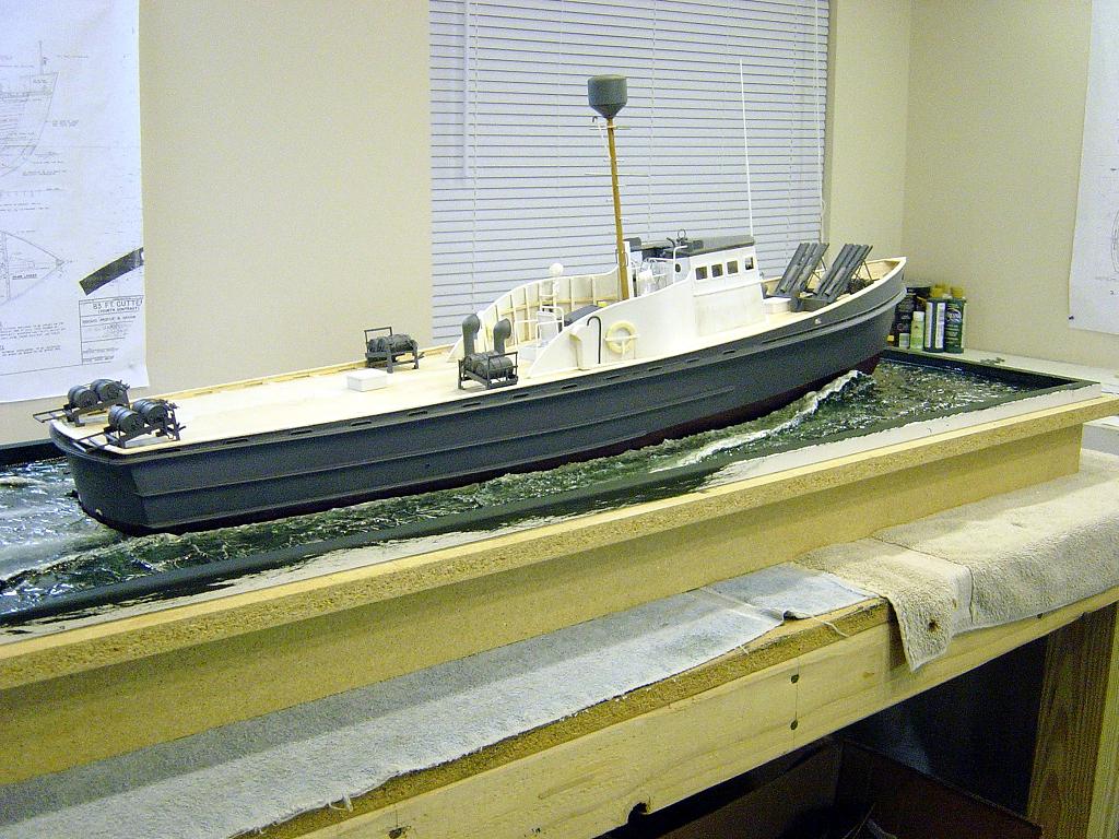

Hello again all :wave_1: Now that most of the sub-assemblies for the boat are completed, I decided to begin final assembly. Been busy with regular job, and this boat becomes more involved as I go along. It is however, coming together. Lets take a look at the progress to date......

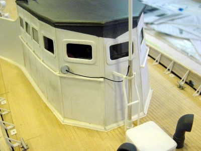

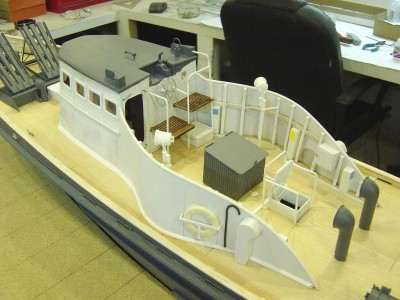

I have now permanantly attached the pilothouse and spray shields to the deck. A few more details have been added to the pilothouse such as nav. lights, horn,RDF antenna, etc. As on the actual boat, a section of quarter round was added around the base of the shields and the pilothouse.
View here from portside. Note the seachlight / signal lights. These are a purchased part while the mount is scratchbuilt from styrene. Ships wheel is cast metal. Grating on flying bridge is laser cut basswood from Bluejacket. All railings here are fabricated styrene rod. Large grey box is life preserver stowage, scratcbuilt from leftover decking material and styrene. Large cowl vents are from a Haynes PT boat, in resin.

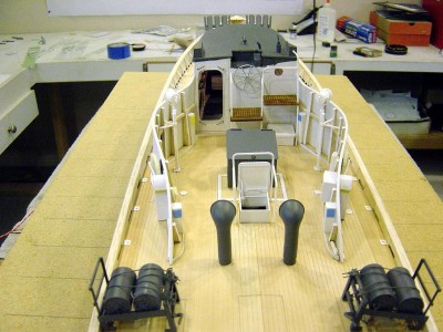

Dead on view looking forward. The addition of the smaller details adds much interest I feel. Note the deck camber.

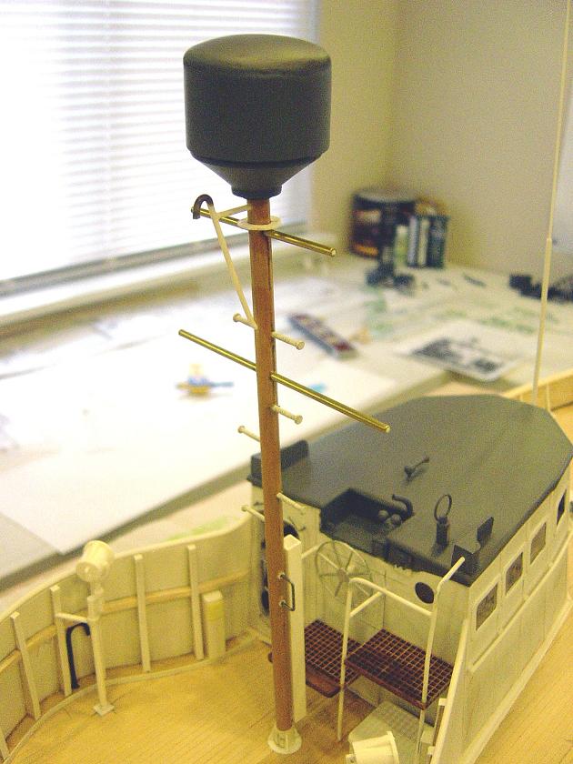

The mainmast assembly. This was scratchbuilt using hardwood dowel for the main shaft, brass tubing for the yardarms. The ladder rungs are small paneling nails. Square tube at lower end of mast is a cable protector. Cable runs from radar dome, down the mast, thru the protector and then runds on deck into pilothouse. Cable yet to be added. Radar dome is three separate pieces. The bottom is a resin casting, mid section is butyrate tubing, while the "dome" is shaped balsa.
Base of the mast, fabricated from styrene.

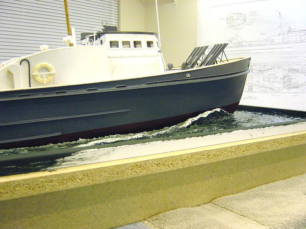

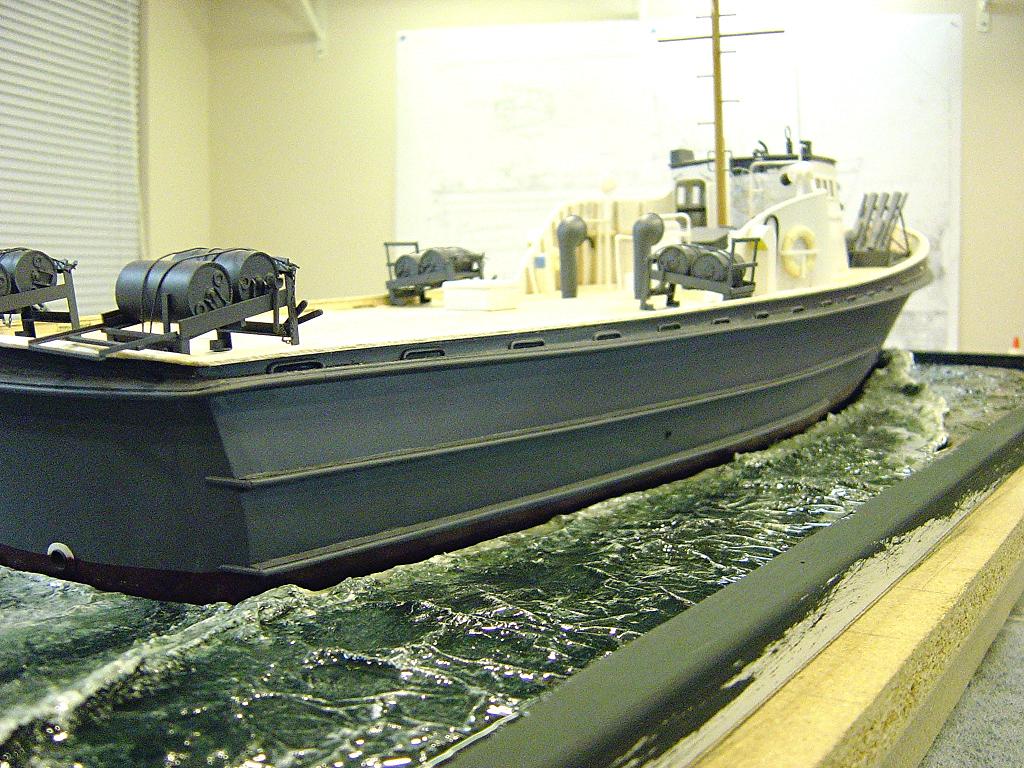

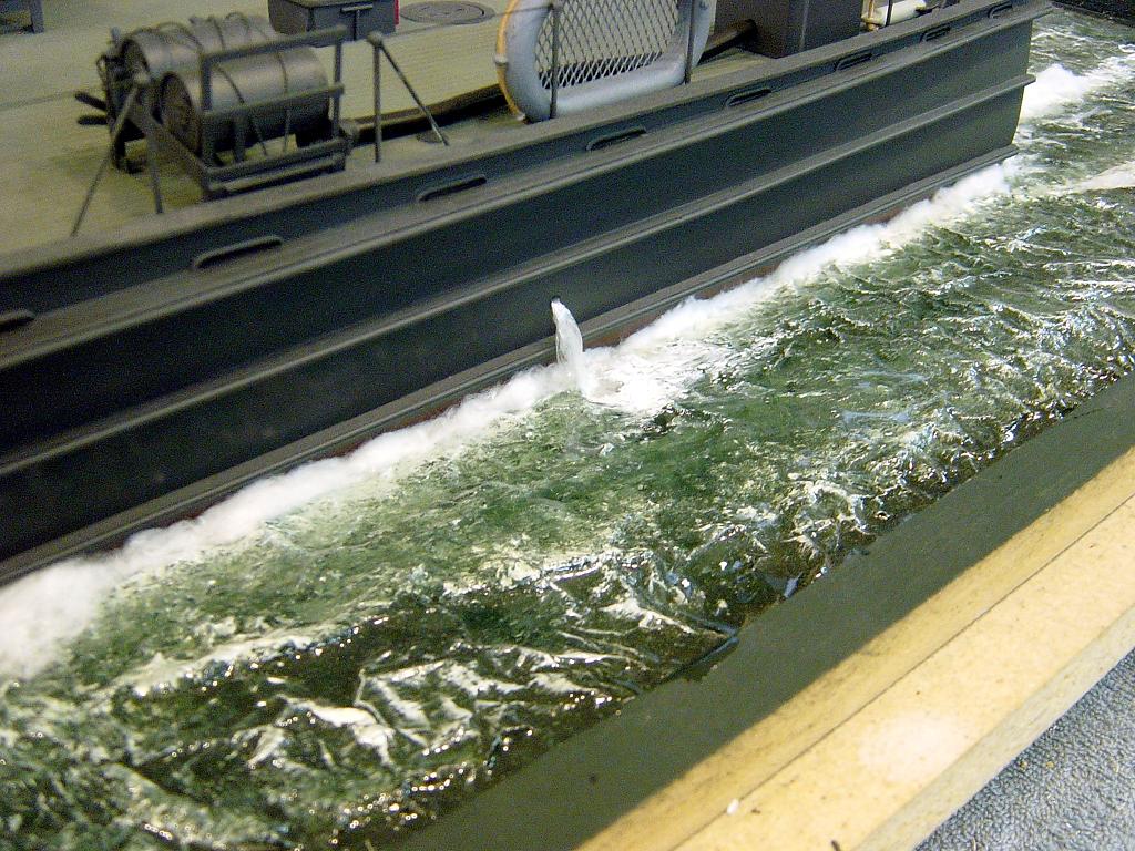

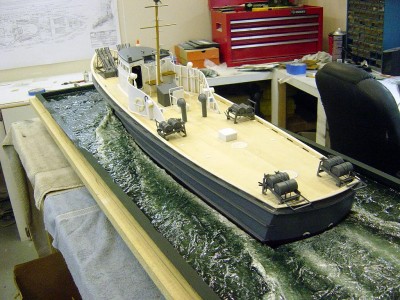

Now that placement of most items on the boat is nearing completion, I decided to try to model the water base. At this stage, the model is still removable from the base as final paintwork has yet to be done. Water not completed yet, but the following photos will give you an idea of the overall picture. I figure the boat making about 10 knots or so, thru relatively calm seas.
More to be added to the water such as spray, froth, etc. I'll do that later once the boat is completed. It is getting there!

Bill I WANNA To say just one thing: superb model. very well done. magnific touch of life you add
the realistic effect of the water is the best i saw.. :wave_1:

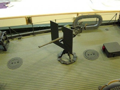

I'll start off with the 20MM gun mount. This is a combination of two small kits, one from JR Haynes, the other from Dean's Marine. By combining the two, I got the correct configuration for the boat.
Another view. I have since added a different sight, not shown here.

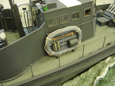

10 Man liferaft here. One on the other side as well. This was completely scratchbuilt. The raft itself is a resin casting, the slats on the bottom are styrene, as well as the water container and first aid / ration box. Oar is basswood. Rope was added using waxed cotton cord. Finally the decals were added, letter by letter.

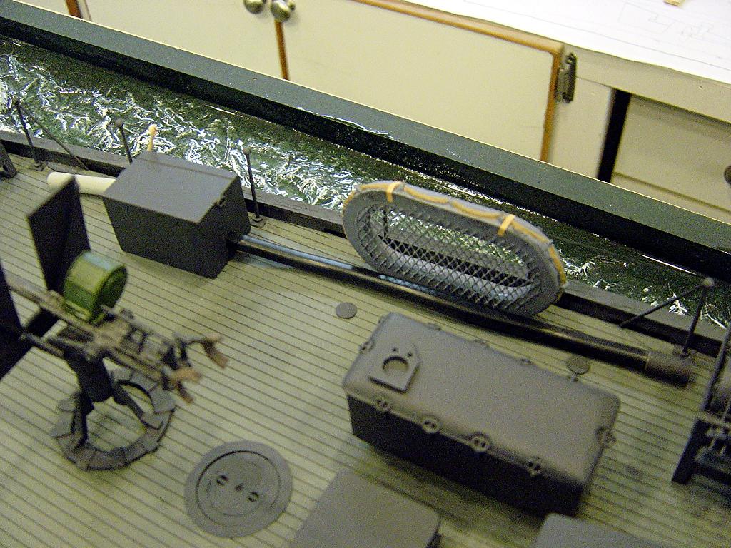

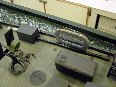

Heres the 5 man rafts, slightly smaller than the others. This is from Macs Mouldings. I added the mesh on the bottom. I'll also add oars and other items to these as I did to the larger ones.

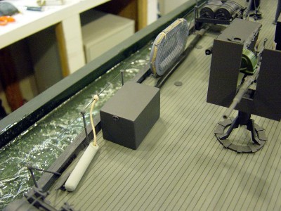

To the left of the raft we have a "Handy Billy Box". This is basically a cover for a water pump used to suction seawater in case of fire. Note the suction hose. Just a piece of electrical cable with some brass tubing at the end.
Couple of boat fenders, one shown here. Made from hardwood dowel, shaped to suit.
20MM ready boxes here. These are made from a balsa block, wrapped with styrene. I then added the lid, a Vac-u-formed part I made. The tube on this box is called a dip pot, to cool the gun barrel. The hold downs on the lid are small cast metal anchor chain links. The bracket on top of the lids is to hold ammo canister. Theres 37 pieces to each box.

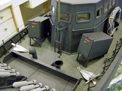

Here are the rocket boxes forward. I've added stenciling from an aircraft decal sheet. Anchors are cast metal from JR Haynes.

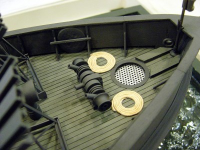

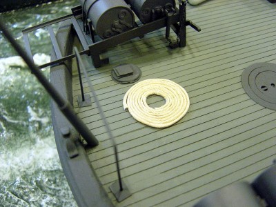

Some rope coils by winch area. Adds a bit more interest.
Another one astern.
Another one astern.

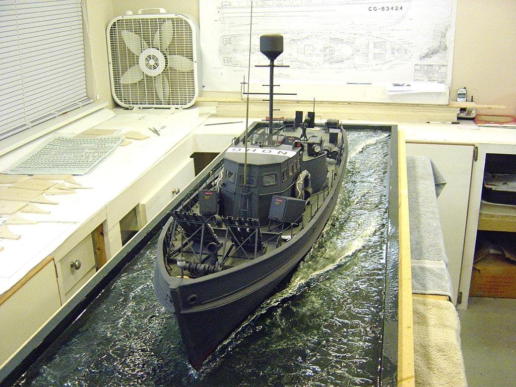

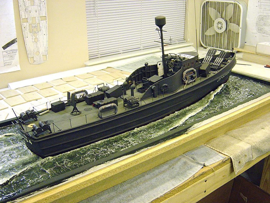

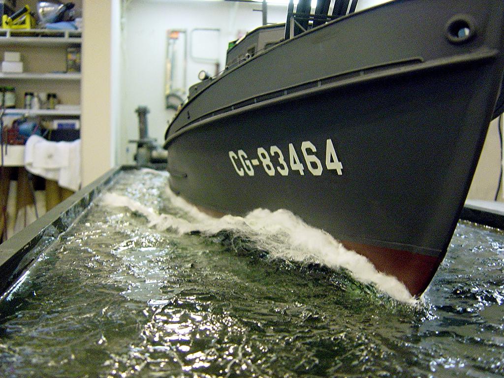

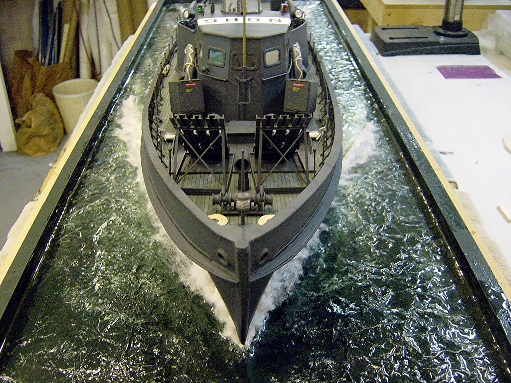

Heres some overall viws of the boat.......
As I stated above, I have been fine tuning the water a bit. Heres some overall views of my tinkering.......
Well, there you have it. Getting close to completion. Stay tuned......More to come.....I continue on.......Comments welcome :wave_1: :thumbs_up_1:

Your build is truly amazing, I do not know how you do it. :thumbs_up_1: :thumbs_up_1: The entire model looks like it is in motion, I would swear that she is underway, very, very impressive. (not to mention the quality of the photographs as well!!)
Thank you for sharing and continuing to inspire rank novices like myself.
Andrew
Posted: Thu Dec 09, 2010 7:09 am
by Sten Ekedahl
I had to look very carefully at those pics because I was shure I thought I saw the water moving! Impressive!!! BTW, the boat isn't too bad either... :thumbs_up_1:
