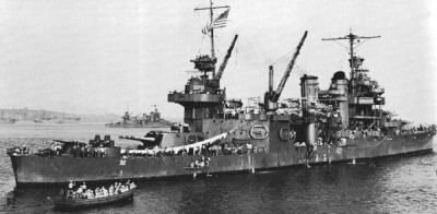

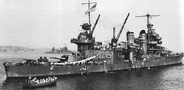

Did the New Orleans have 40mm quads at the battle of Tassafaronga? This picture of her in November of 42 shows a good shot of her stern and those look a lot more like quad 40's than 1.1's in those stern tubs. Being that she got a visit to Pearl in September could it be possible that they fitted 2 quads to her? Is this common knowledge and I have just missed it somewhere before?
http://www.navsource.org/archives/04/032/0403203.jpg
Also of note is the absence of depth charge racks which she had at the battle of the Coral Sea.
Thanks
Thanks

Re: Calling all USS New Orleans class (CA) fans (San Francisco)
Both New Orleans and Minneapolis received quad 40MM on the fantail while at Pearl, where they had escorted Saratoga for torpedo damage repairs (and her own quad 40MM). They retained the 1.1's forward, since the installation of quad 40's there entailed major structural alteration. The tubs were a bit smaller than those installed later (notice they don't overhang the sides). After Tassafaronga, New Orleans had initial repairs at Sydney, replacing Portland in the drydock there. She then proceeded to Bremerton for permanent repairs and modernization. She retained the smaller stern 40MM tubs to the end, and they are one of the recognition points for the ship. Minneapolis had initial repairs at Esprito Santo, and permanent hull (only) repairs at Pearl. (The West Coast drydocks were full of other repairs from the Guadalcanal campaign.) While there, her 40MM were offloaded for installation on other "quick turn-arounds". Her powerplant repairs, final hull fittings (such as anchors), and modernization were done at Mare Island, after she had sailed to Bremerton to donate #1 turret to New Orleans, since the NO boat was otherwise finished. At Mare Island, Minnie also had her stern tubs removed and replaced with the then-standard sized tubs, and received a new turret 1.
