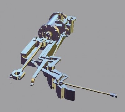

Here is the completed and aligned valve and reversing system for both cylinders of the V-twin. All of the other components of the turret engine have been turned off.
Two straight, simple rectangular section rods connect the crossheads to the tips of the T-links. These two reciprocating rods completely replace and supplant the elaborate cam driven valve gear more typical of 19th century steam engines. This excellent simplification worked because one cylinder of a 90-degree V-twin is always a quarter of a revolution ahead of the other cylinder.

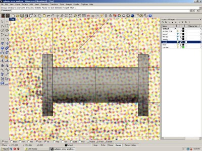

strange looking cylinder problem

Take a look at the cylinders depicted here, in a pioneering CAD drawing from a paper presented at The Third International Conference on the Technical Aspects of the Preservation of Historic Vessels convened in San Francisco, California on April 20-23, 1997:
cylinder diameter seems too small for its length
Subjectively, it seems the cylinders are oddly small in diameter and, therefore, in cylinder bore. The image is intended as a schematic representation, not as a scale drawing. it is a helpful sketch and it shows well the basic layout of the components of the turret drive. But for a scale modeler it is important to note that the cylinder size is not to scale.
How did these tiny cylinders happen? I think it was a CAD issue. It is a question of how you read and interpret into CAD the sense of the original drawings.
For example, here is a reproduction of a small element of a fine USS Monitor drawing that hangs in the Swedish American Museum in Philadelphia.
close up of cylinder and frame
The drawing has been screened for printing in Peterkin's book, hence the bothersome dot pattern.
The original artist -- possibly John Ericsson -- heavily shaded the cylinder along the edge of a horizontal shelf that demarks the slide valve's steam chest. In this overhead view, the steam chest and its horizontal shelf mask from view almost half of the cylinder.
Given the poor reproduction quality of the drawing, it is easy to confound this heavily shaded line with the edge of the cylinder. If you create a hypothetical cylinder in CAD using this subtly deceptive but absolutely false line, it looks like this:
erroneous cylinder -- off the centerline
One clue that this stunted cylinder is wrong is that it is offset to one side of the frame. The centerline of the piston rod and crosshead (green line) does not correspond to the centerline of the cylinder.
Another problem is absolute size. The oak deck beam crossing the picture diagonally is 10 inches wide. If we allow for cylinder wall thickness, the bore of this hypothetical cylinder must be down in the range of 5 inches. Compared to the 12-inch turret engine cylinder diameters of the later Ericsson monitors, a 5-inch bore doesn't seem consistent.
If we ignore the shaded line marking the edge of the steam chest, and instead revolve in CAD the upper, outer edge around the centerline, we get a much more robust and normal looking cylinder:
corrected cylinder
corrected cylinder
In this one the centerline is correct. The cylinder's outside diameter corresponds well with that shown in another drawing in the Stevens McCord collection in Hoboken.
