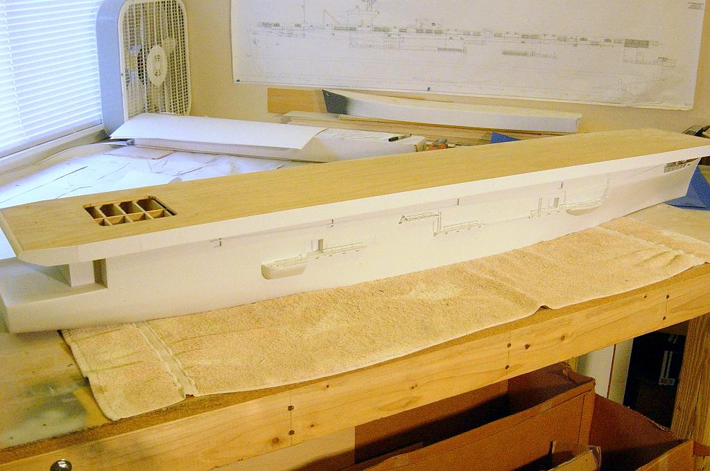

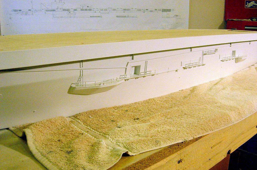

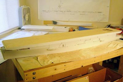

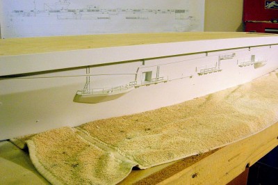

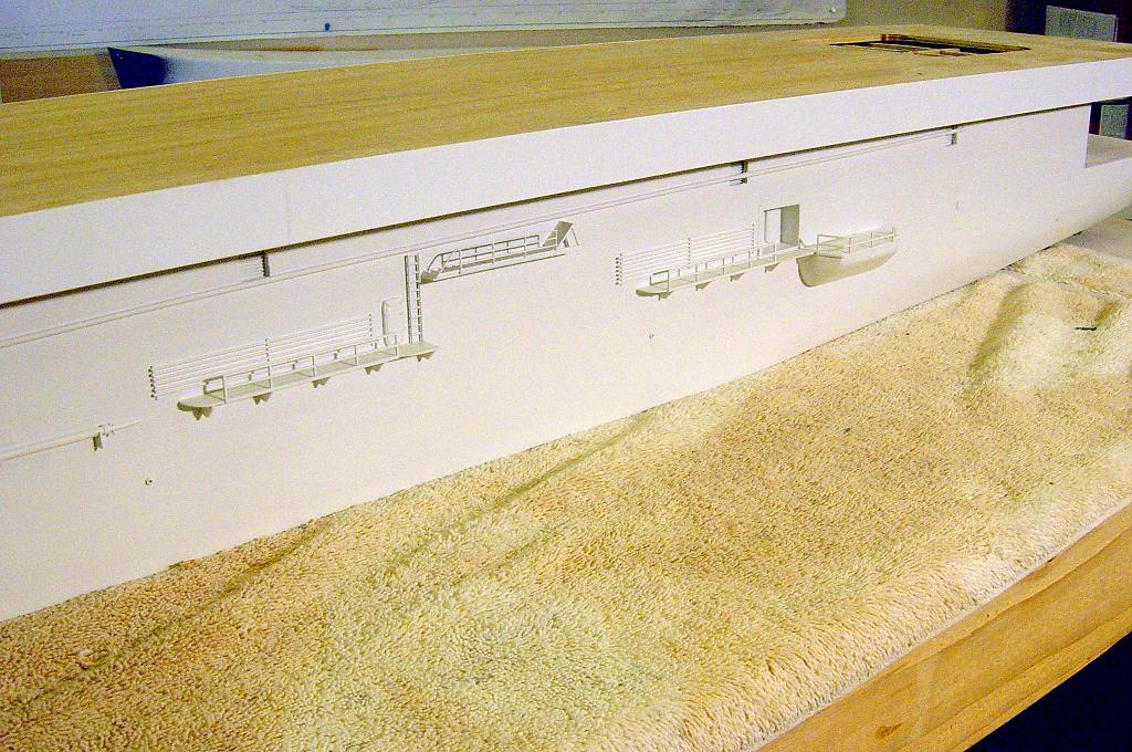

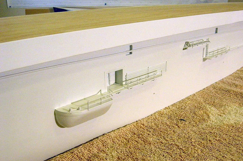

Hello Again all :wave_1: Thought I would post some overall shots of the work done on the sides of the carrier. The DE is now underway and I have begun the superstucture work, using all styrene for construction. Lets take a look.......
Heres the aft sponson on stb side. A small winch needs to be added here yet.
Midships and fwd. sponson from stb. side again. Another winch will be added on the fwd. sponson, as well as paravanes and 26' lifeboats, port and stb.
Overall view from stb. Note I have placed the flightdeck in its approx. position. Aft elevator will be in its down position eventually.

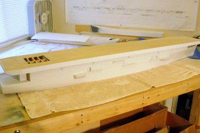

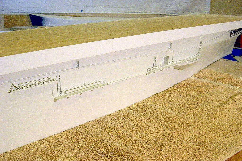

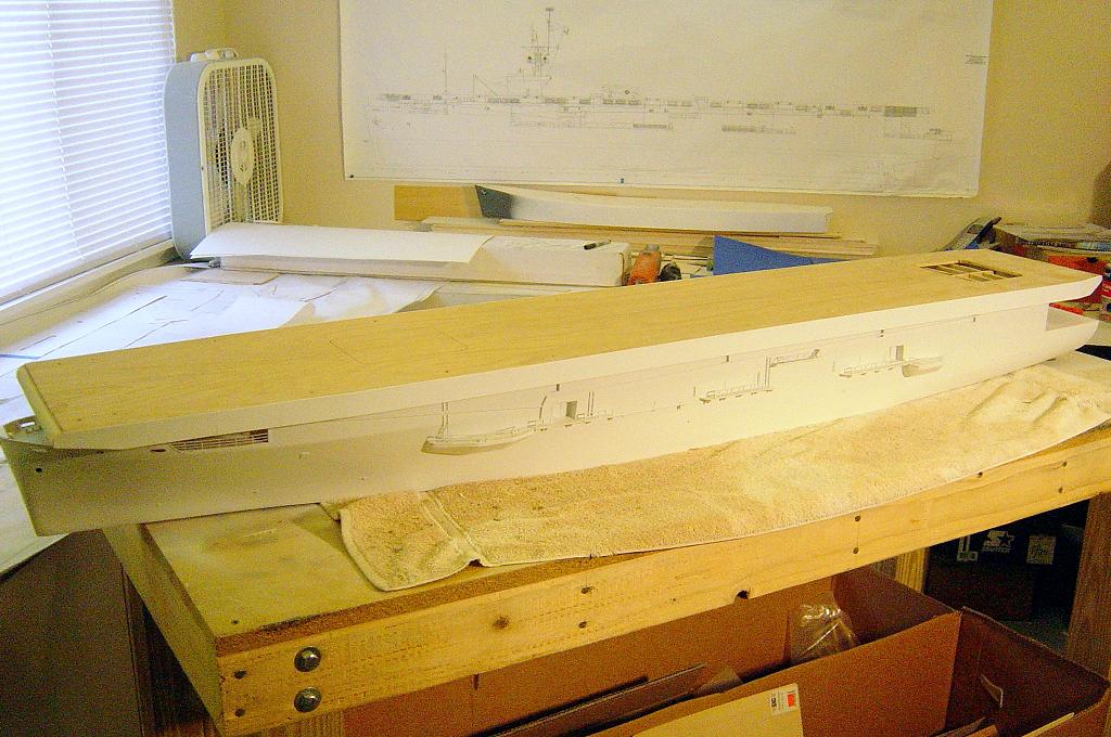

Good view of portside.
Midships and aft sponson from port.

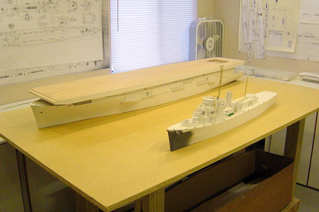

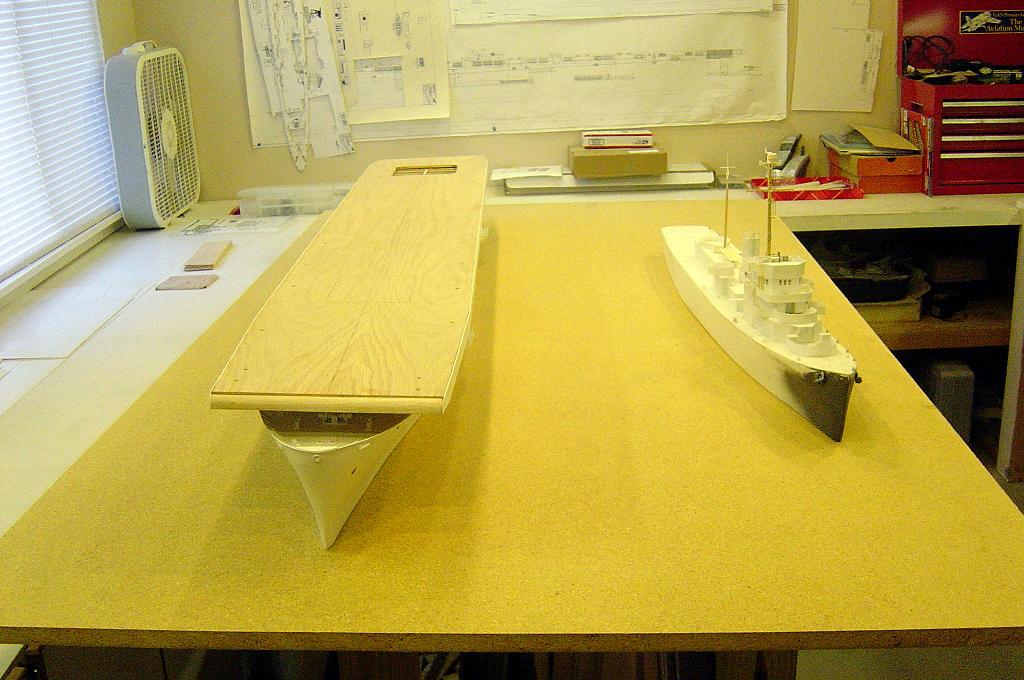

Overall view from portside. Note the DE hull in the backround.

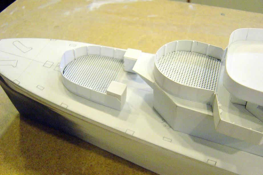

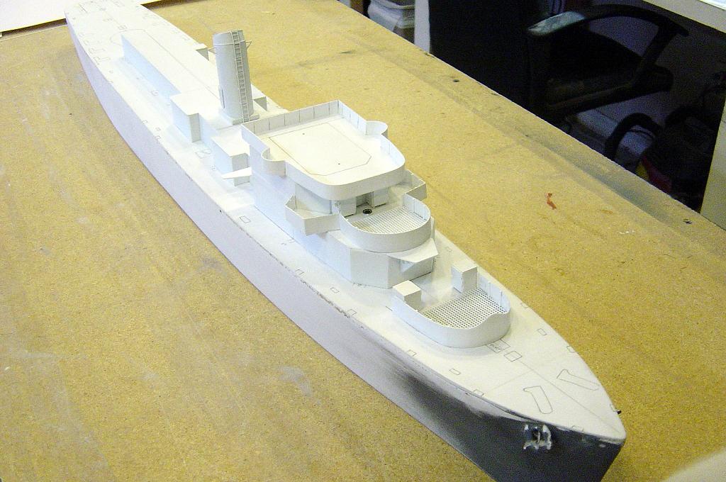

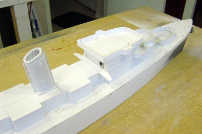

Superstructure work has now begun on the DE. This is all styrene in various thickness. It appears simple enough, but the up sweep of the hull and deck present some challenges. I am up to bridge level here, with bridge top to be added next.

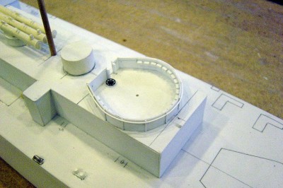

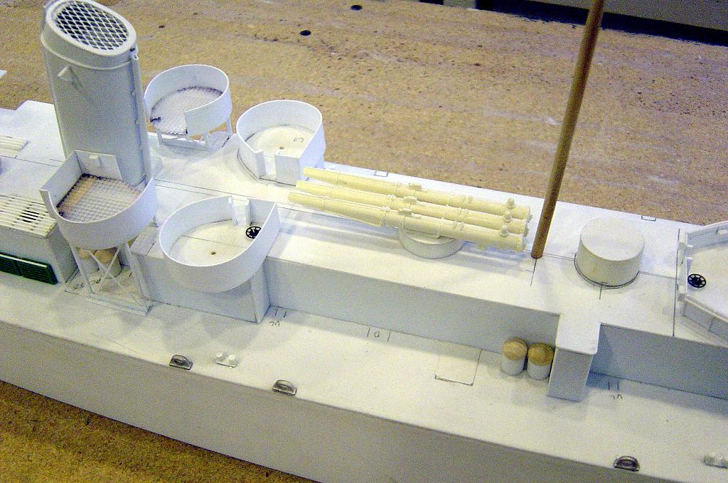

Here are the forward 3" .50 cal gun tubs from port. I fabricated the r/s lockers from balsa block and then wrapped with styrene. Note the perforated decking here. Got this in sheets from a craft store, and it is actually used for needlepoint. Works well here as well as areas on the Carrier.

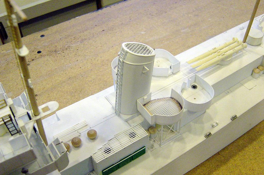

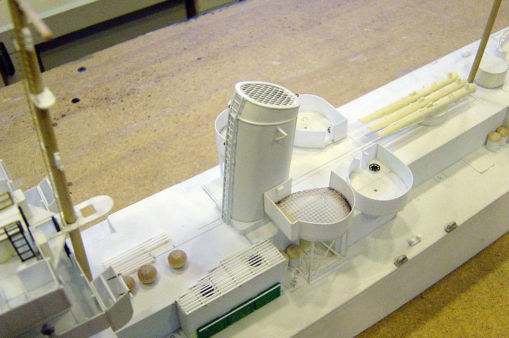

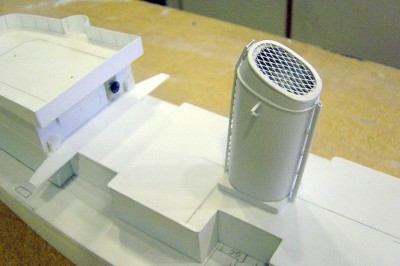

Here we have the funnel. There are three main pieces here. The base, the main stack, and the cap. All are shaped balsa block wrapped with .010 styrene sheet. Other details are then added.
Overall view from stb. looking aft. Several more gun tubs to be added yet, as well as numerous small details, but you get the idea.
Another stb. view looking slightly forward. Note I have marked out locations for other parts, using the plans as a guide.

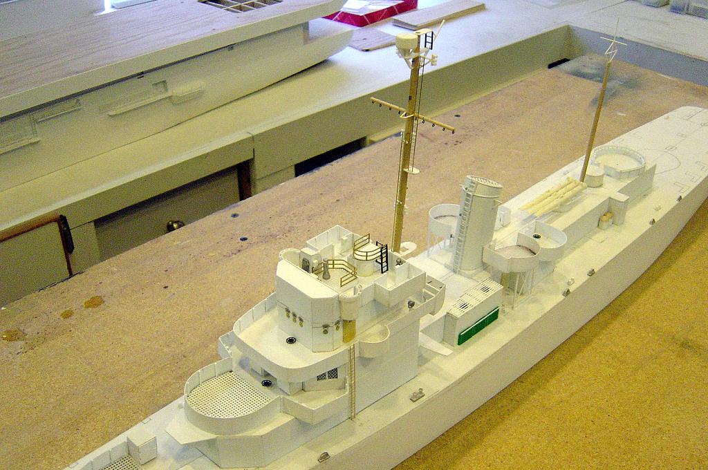

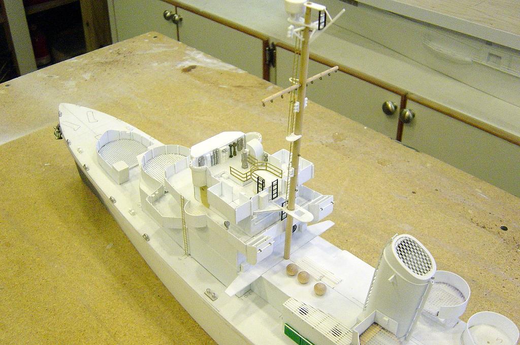

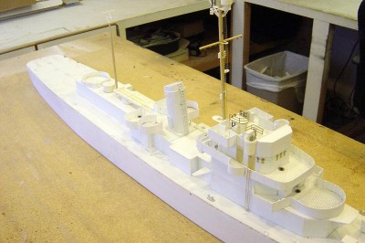

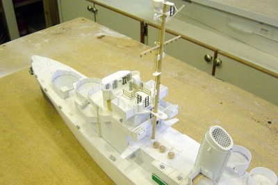

Hello again all :wave_1: Been off line for awhile with the flu....nasty bug. But, I am feeling a bit better. Caught the bug while attending the presentation of the USCG 83' cutter I built for my Master Chief client. It was in Herndon, Va. A stones throw from Washington, D.C. Disaster struck there....see my post in completed builds section. In any event I am back and work continues on the Chicago Project. I am still concentrating on the DE for now, getting all the superstructure and gun tubs fabricated and installed, along with the masts and other parts, before getting back to the CVE. Lets take a look at the recent progress............

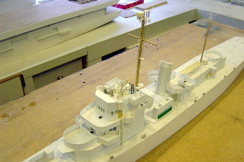

Heres an overall view of the progress on the DE. Note the nav. bridge nearly completed, as well as the mainmast. Aft mast in progress. I have also started to add deck hardware such as cleats, chocks, bitts, etc.

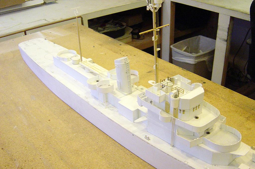

Another view here, looking fwd. Note the mushroom vents and refueling hoses behind the mainmast. I have also fabricated and installed the flagbags. A few more detail parts yet to be added to the bridge.

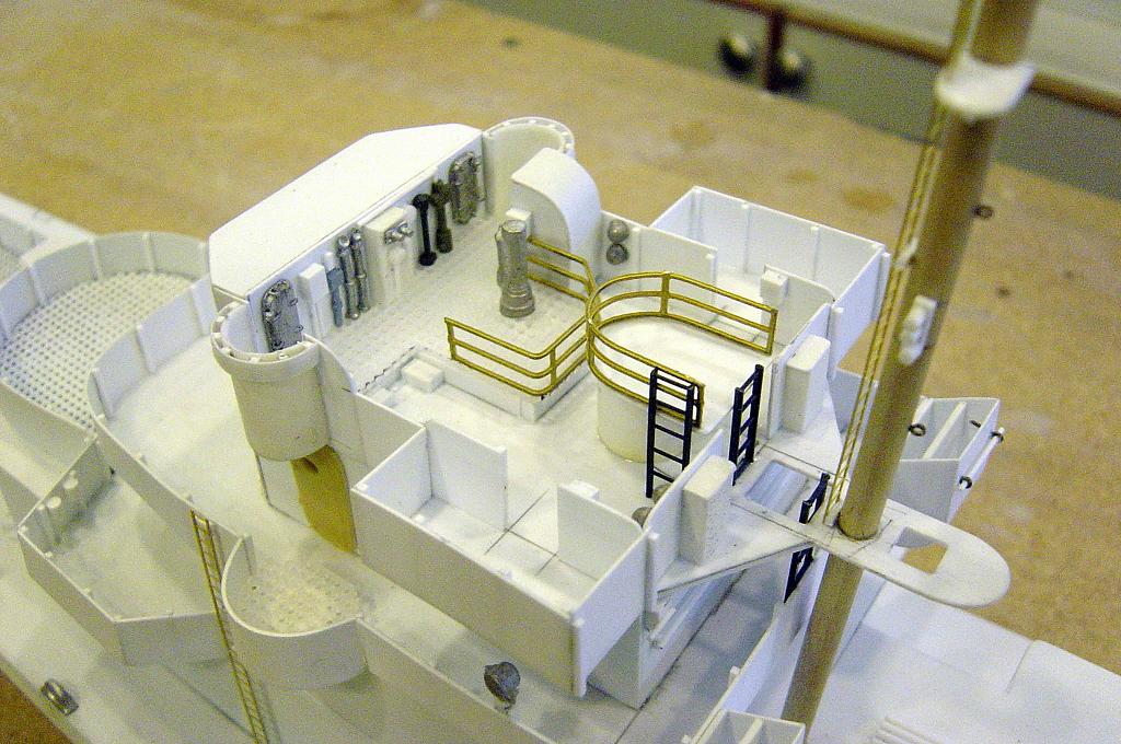

Close up of the nav. bridge. Sky lookouts and range finder, plus a few other details yet to be installed here. Lots of components in a small area.

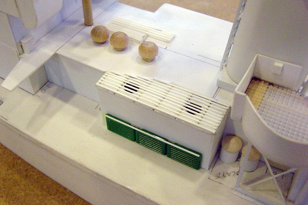

Vegtable storage cooler here. Note the condenser tubes and fans on the roof. Louvers are doctored up lego parts. Note the garbage cans just to the right.

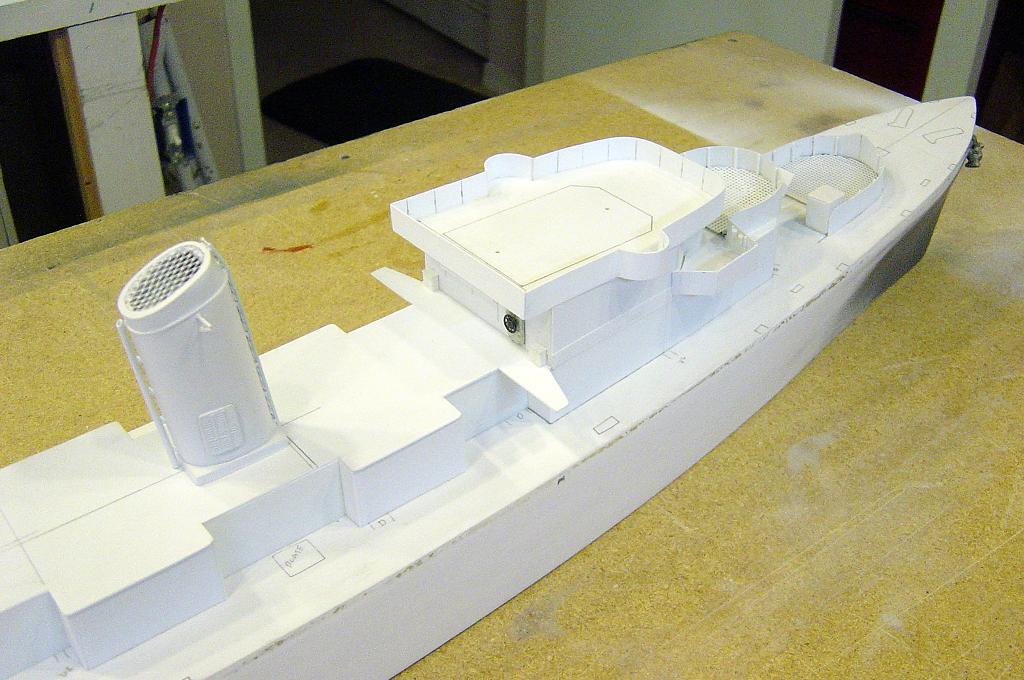

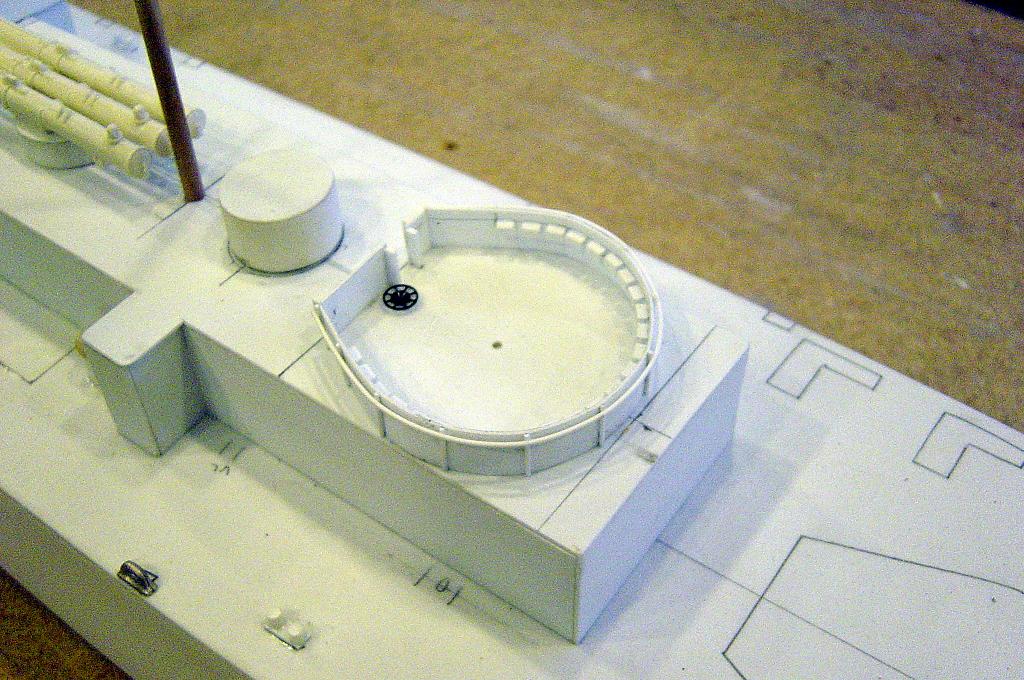

Aft. 40MM tub here and its director foundation just to the left. Small handwheel is the escape scuttle. Note ammo boxes inside the tub.

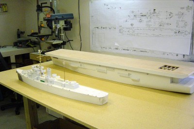

Overall view from Stb. side here. Lots to do yet!

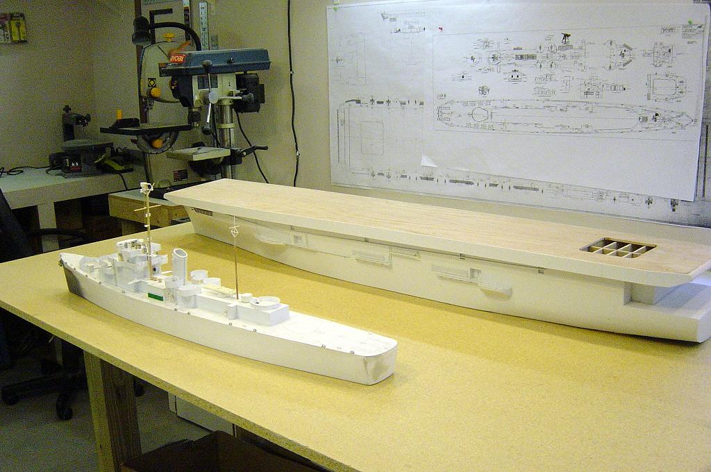

Here is an approximate view of how things will eventually look. The base is 42" x 75" and will become an ocean eventually. Location of the ships is still up in the air, I may reverse this view. A couple more shots below.......
Things are moving along at a somewhat slower pace till I feel better. :heh: Anyway, I'm still breathin' :smallsmile: Stay tuned.......More to come......I continue on................... :wave_1:
