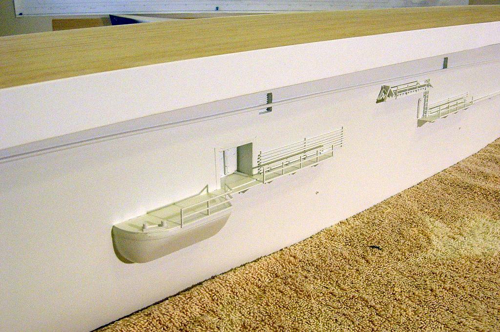

Hello Again all :wave_1: Thought I would post some overall shots of the work done on the sides of the carrier. The DE is now underway and I have begun the superstucture work, using all styrene for construction. Lets take a look.......
Heres the aft sponson on stb side. A small winch needs to be added here yet.
Midships and fwd. sponson from stb. side again. Another winch will be added on the fwd. sponson, as well as paravanes and 26' lifeboats, port and stb.
