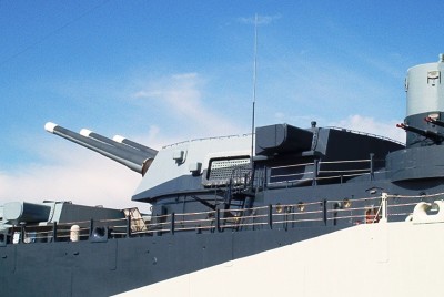

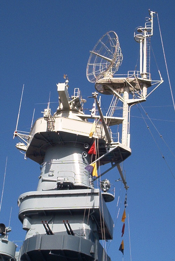

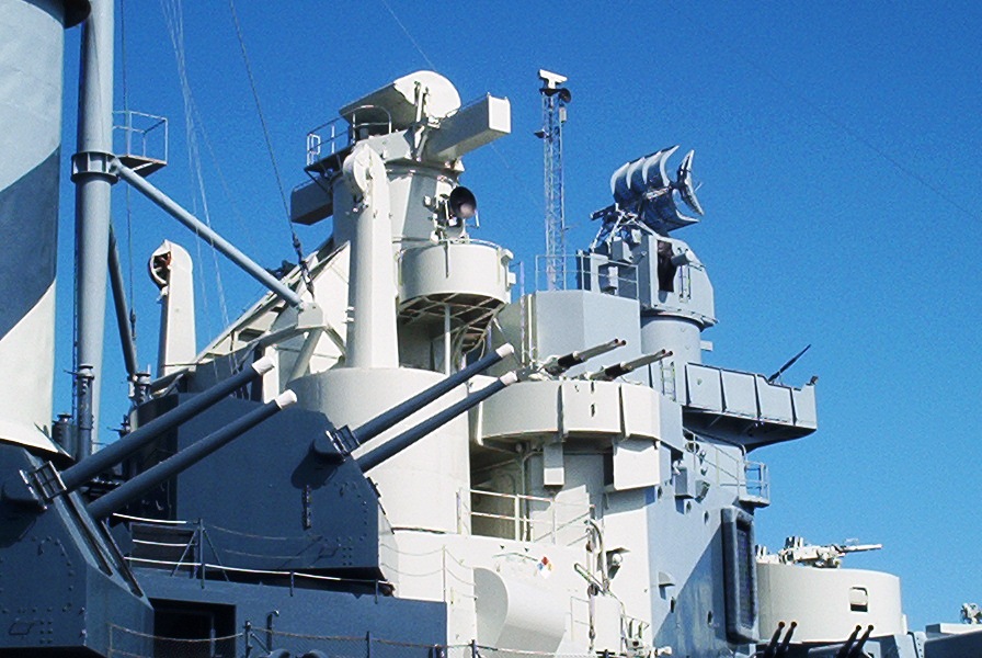

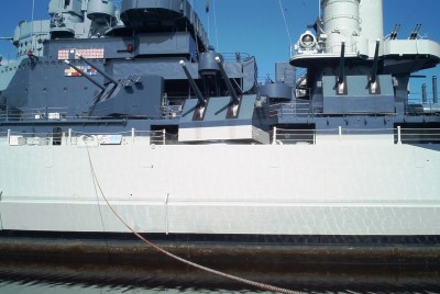

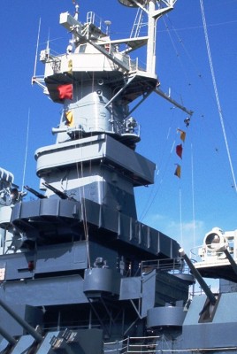

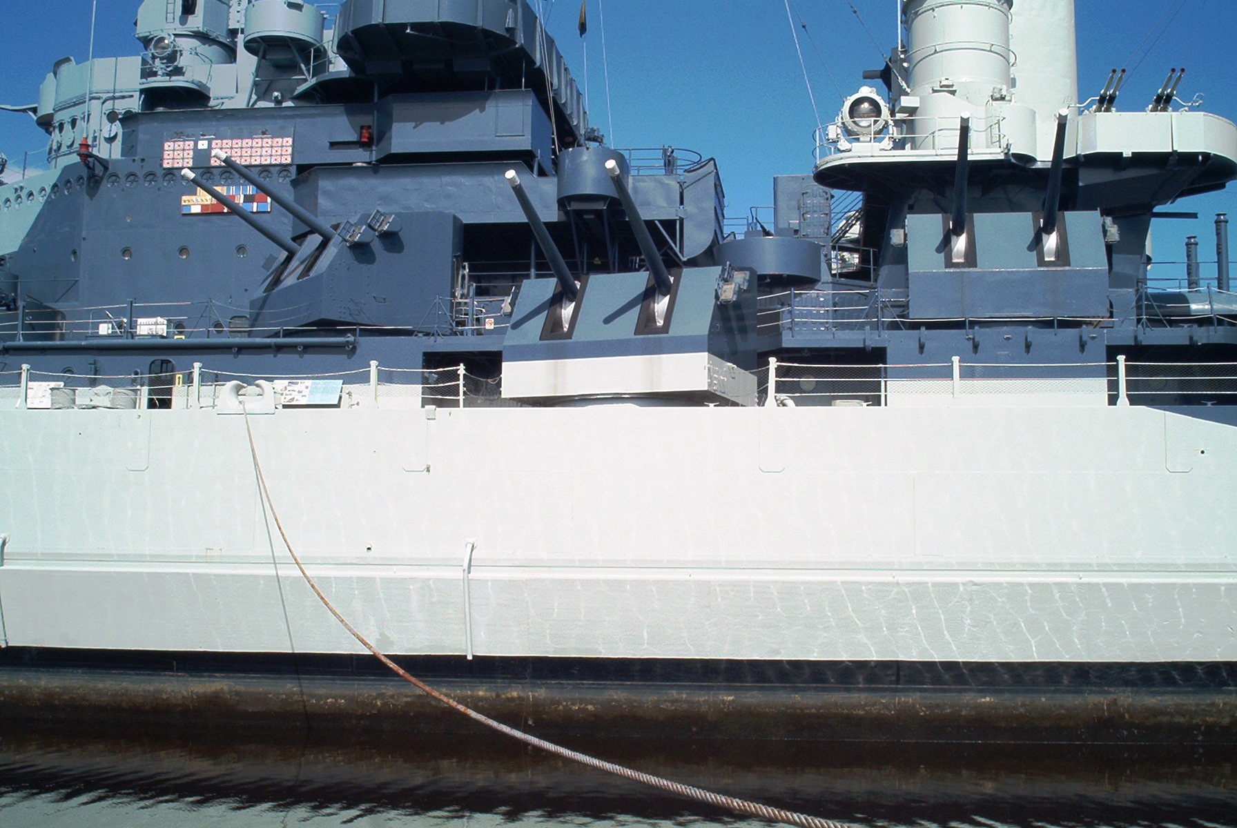

On a business trip this week I had an opportunity to have lunch with a
retired, patriotic lady and took some pictures of her for your viewing
pleasure.
USS North Carolina as she appeared February 15, 2007:
