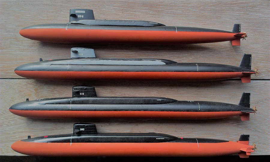

Well, not too difficult, as I described. Here's my Ethan Allen in new version.
- Length unchanged.
- Deck over missile bay replaced with a new version, 5mm longer than the previous one. All hatches enlarged accordingly
- Sail moved forward by 11 mm, so much closer to the bow. Added sliver to make the sail follow the curved contour of the forward hull deck
- Sail to vertical rudder distance is now the same for the Ethan Allan and the Lafayette.
Some pictures:
I left the Allen unpainted for the moment to show clearly the change.
David, many thanks for spotting the error in the assumptions, and Jacob & John for providing the documents to get it right! Good teamwork I would say.

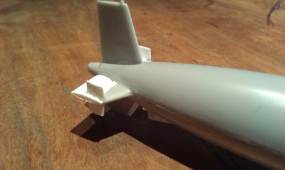

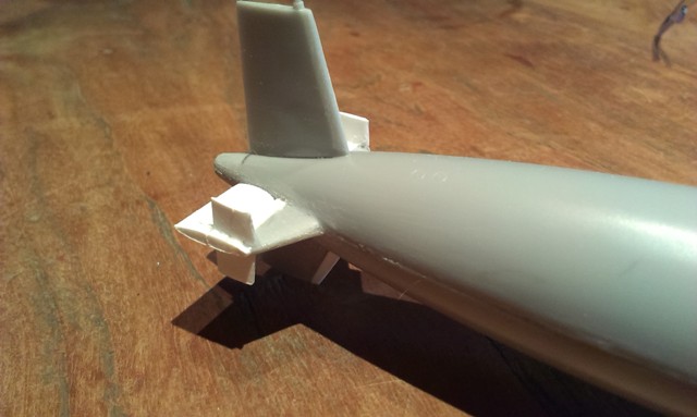

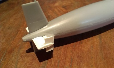

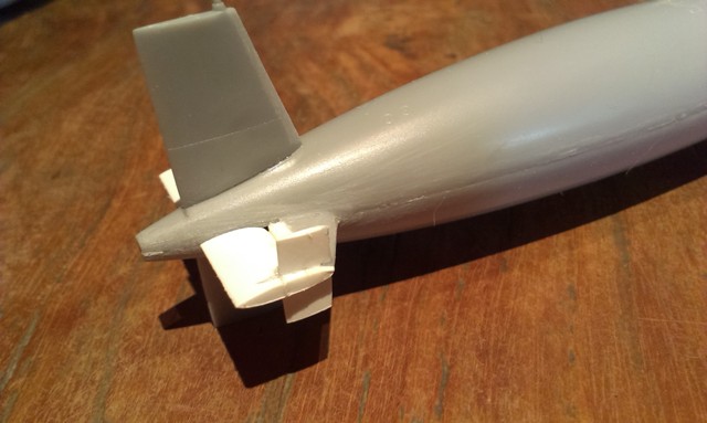

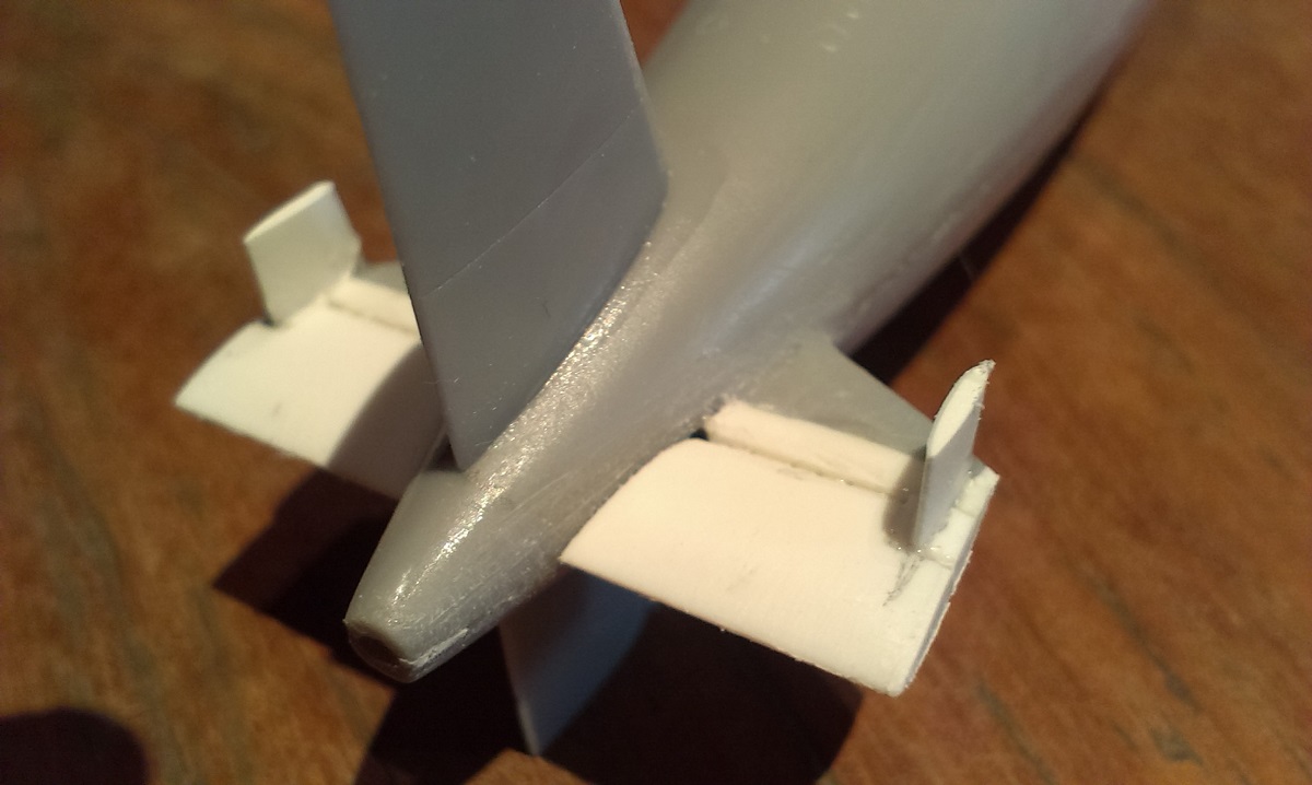

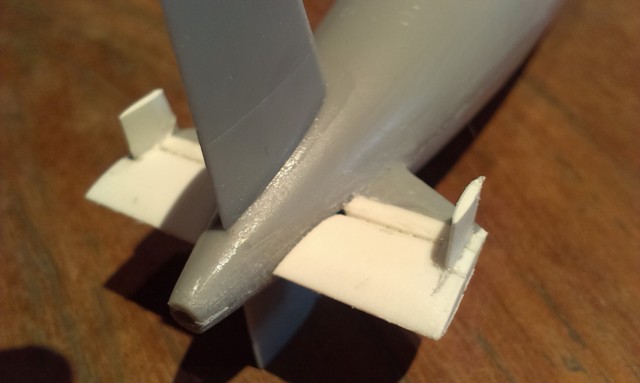

Maarten Sch�nfeld wrote:So, then I will scratch those endplates myself, documentation on the Franklin class was passed in this thread earlier on.
Here some pics in the raw form, so you can see well what I did. Still some sanding to be done when all cement is dry.
It was necessary to modify the aft diving planes to a great extend, as these appeared incorrect in the first place. Also for any of the 609 or 616 boats that is. The only difference is the wider section where the endplates are based on. Some homework to do on my Lafayette and Ethan Allen models!
Roger Whittaker +9/13/2023
Maarten Sch�nfeld wrote:Here's the math: there are eight missiles lengthwise, each Poseidon missile adds 22", so that makes 176" in total. The difference between the Allans and the Lafayettes is 180", so only 4 inches not accounted for, or less than .3mm on 350 scale...
Most authoritative sources quote the length of the Ethan Allens as 410 feet 4 inches, so the difference with the Lafayettes is only 14 feet 8 inches, or 176 inches. This equals therefore exactly the added increase of the diameter of eight missiles.
I was convinced, so I bit the bullet. Here's my Ethan Allen, in company with a George Washington and a Lafayette model, with the missile compartments aligned:
I'm only somewhat uncertain about the location of the hydrophone stump on the bow, it seems somewhat closer to the sail than on the subsequent Lafayettes. Can someone shed some light on this maybe?
Hi kgrf15,
Starting from here you can find everything you need to convert a Lafayette into an Ethan Allen. Beware, my assumption on the size of the tubes was not correct, but then you have to read through the entire thread. Good luck!

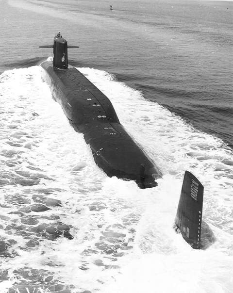

While getting more intimate with the Franklin class I started wondering: looking at the pictures of the rudders it seems that the top draft mark is 38 (feet), meaning that the total rudder height is around 40 feet total.
It seems to me that the Lafayettes and Allens had a much taller rudder, the top standing around 47 feet: the draft marks over 40 are not applied. Picture of SSBN 611 John Marshall (Ethan Allen class) below.
Did the Franklins have a less tall rudder, and was this maybe related to the endplate fins taking part of the side forces? In this case I touched on another error in the MikroMir kit, the rudder being of the same height as the Lafayettes. It needs to be reduced then by about 6mm.
