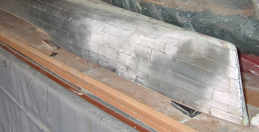

Hi Guys, Here's a close up of under the stern, first 2 full rows of plating applied.
The 5th row of plates applied and sanded down.

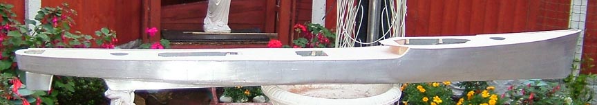

Along shot of the hull.

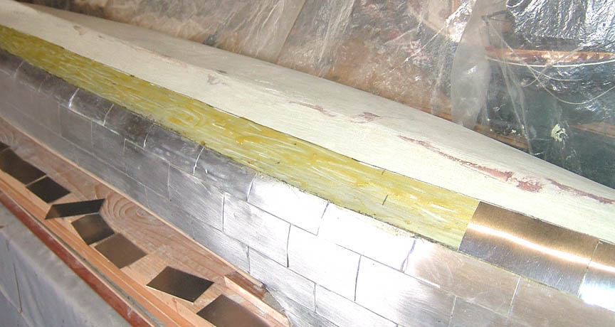

This is the shape of the end of the keel. This is to be fit before the last row of plates are glued in position.
Keel glued in place and plates glued over the bottom of it.

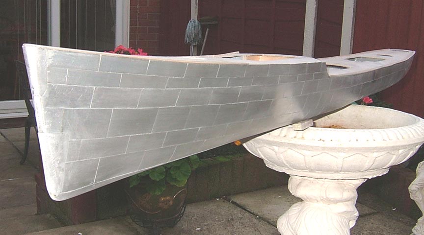

Just a small section to go on this side of the hull.
The hull plating is finished on this side of the hull, but at the bow there are a few more to fit when the other side is complete, they are protection plates for the bow.

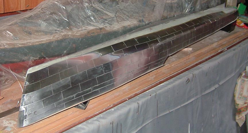

The hull is turned over and the 4th long row of plates nearly fitted.
Only one more row and a bit to go to finish off the hull plating, you may notice the first plate fitted around the bow.

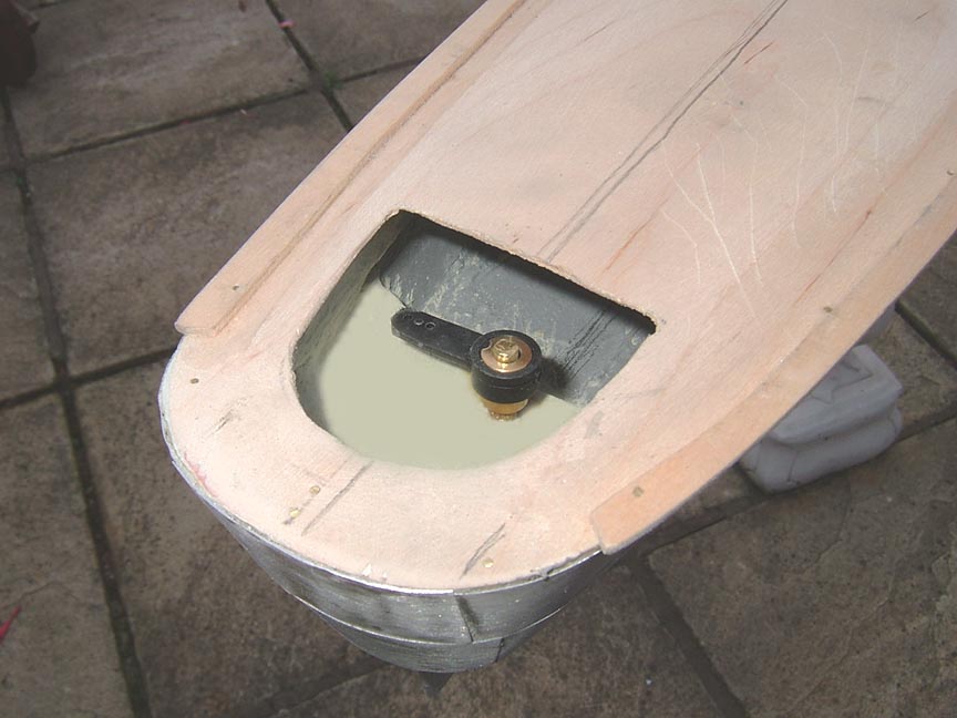

The last plate fitted to the stern, also the rudder has been plated.
Overall view of the hull, still work to do, like bilge keels and props and shafts.
Rudder arm fitted.
