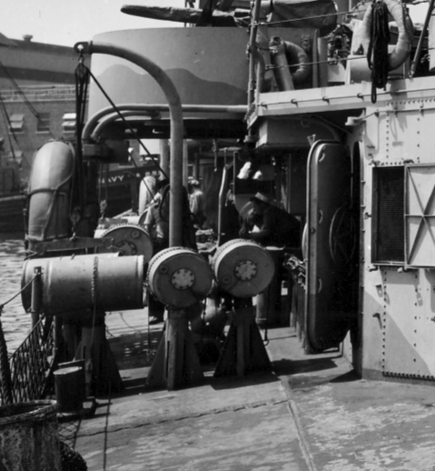

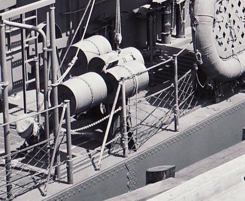

LAFFEY didn't last long enough to get the K-Gun storage racks. She was completed with the post storage with the arbor and 300-lb depth charge sitting in them together in a sort of arc around the K-Gun (the layout on the BENSON-GLEAVES units was different from the layout used on early FLETCHERS).
Here are a couple of images of the arrangement from different angles. The "orientation" of the depth charges on the posts can very.

Rick, thanks. I didn't think she had any, but I wasn't 100% sure. I looked at the NavSouce photo of her and didn't see any, but I always like to double check with those, like you, who know.
