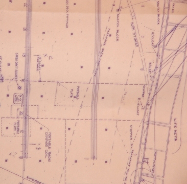

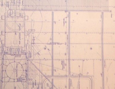

Hi guys. Sorry, couldn't fit the plan on my scanner - hardly a surprise. So I took some photos instead. I hope they help. The sequence is stern to stem, and I've only photographed sections where the drains terminate or change route. I hope you can work out where they do actually change route rather than it being the plan all bent!smithec wrote:Jon - thanks for your kind comments and the link.Jon Barry wrote:Just getting back into ship modeling after a hiatus of around 20 years or so. Busy collecting all these dream ships that I would have died for back as a kid.One of these of course is the Lexington as she appeared when she was lost at Coral Sea. It seems that the mystery of the deck marking is solved. Correct me if I am wrong but there were no deck markings in 5/42 and the three stripes are in fact drain channels that end about even with the last island side 1.1 mount. I can get a pretty good idea of their placement from the pictures of Chris Smithers outstanding build, but aircraft in this photo cover how they terminate.
Does someone have an overhead plan or shot that clearly show the start and terminus of these channels? THANKS!!!
Here is the link to Chris's work. http://www.modelshipgallery.com/gallery ... index.html
You can also find my complete, step-by-step build feature at: http://modelshipwrights.kitmaker.net/mo ... artid=2191
I've got a copy of the 1/16th flight deck plan (builders plan, 1927) which clearly and unambiguously shows the layout and start and termination of the linear drains. The plan's up in my loft rolled up - all 20ft of it. I'll look it out when I've got a spare moment and scan the relevant bits and will post here.
Regards, Chris
You can order this and other plans of CV2 from The Floating Drydock Company @ http://www.floatingdrydock.com/
- TWO: rear elevator and drain port side turns inward. A fourth fore and aft drain on the port side starts in in line with the centre of the elevator, off the photo here.
- DSC_5540a.jpg (101.53 KiB) Viewed 3555 times

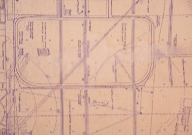

- THREE: Forward elevator - you can see the fourth drain on the port side.
- DSC_5541a.jpg (117.01 KiB) Viewed 3555 times

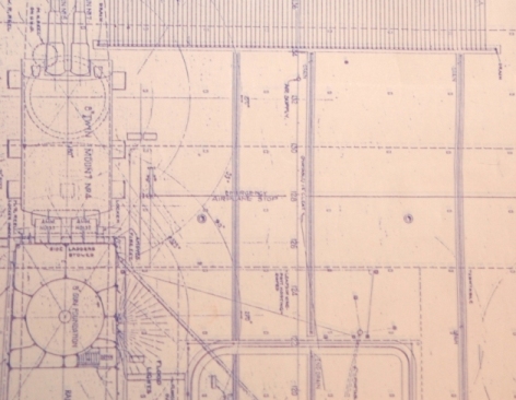

- FOUR: Termination of outer port drain.
- DSC_5542a.jpg (102.88 KiB) Viewed 3555 times

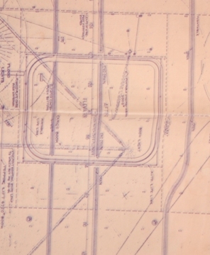

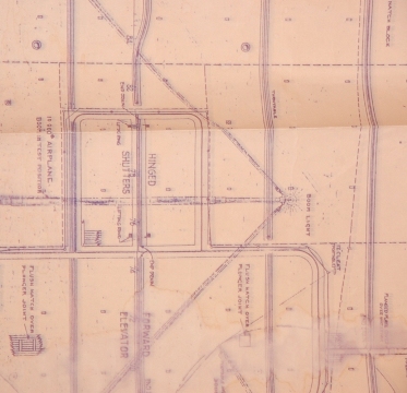

- FIVE: Termination of port and centre drains at fore end. Starboard drain (off picture) terminates a little further aft in line with the upper hatched line drawn across the plan.
- DSC_5543a.jpg (112.09 KiB) Viewed 3555 times
