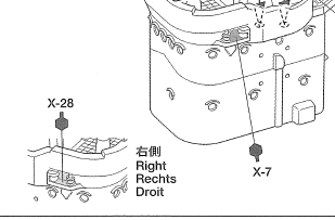

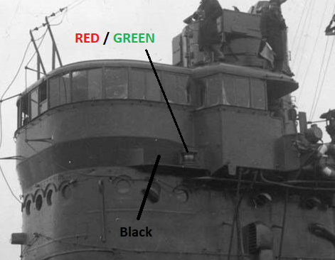

Navigation lights for Kagero
Does anyone have a clear view on the navigation lights for the IJN Kagero-class destroyers? Old black&white photos do not tell much and I noticed that various modellers have used different solutions. I doubt that Tamiya instructions are correct
- Posts: 9073
Re: Calling all IJN Kagero class (??????) fans
Good question. I'm still looking. I've always thought that just the lantern itself was red or green. Different sources show red, green, or black (like Tamiya) colored backboards.
Postwar photos don't show that area to be different then the superstructure gray.
Hi Dan,Dan K wrote:Good question. I'm still looking. I've always thought that just the lantern itself was red or green. Different sources show red, green, or black (like Tamiya) colored backboards.
I agree with you: it is the lantern that has the colour. That is the only way that the nav lights fulfill the ancient old rules and show the light in correct angles. So the Yukikaze photo with my notes should be right. The backboard colour is bit of a question mark, but I have seen in many ships that it is matt black in order to avoid unwanted reflections.
Thanks again for your help!

The interesting thing about the navigation light boxes is that many Kageros (and other DDs) do show a darker coloration on that backboard both prior to and during the war. But not all.
I'm under the impression that the navigation lights weren't even used during wartime, at least at night.
I really don;t know what to make of it.

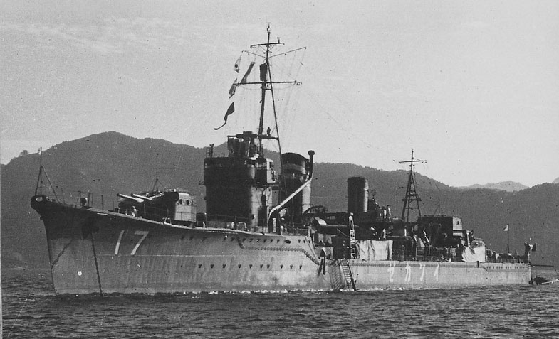

I missed Paris's question from back in February. So, hopefully, my reply is still helpful
These two attachments should help.

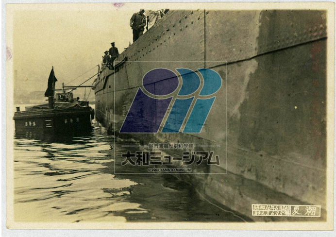

Well, the hull strakes alternated, just as they did above the waterline.1. Do we know the pattern of the plates bellow the waterline?
Both. Welded throughout, plus riveted in the midsection to help with rigidity.2 My second question is more important to me. Do you know if the plates on the ship�s hull were welded or were they bolted?
