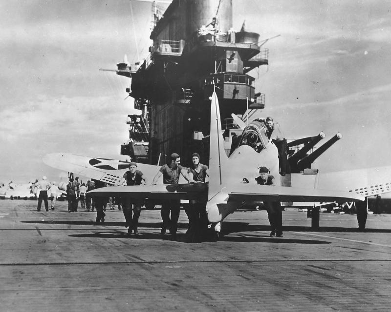

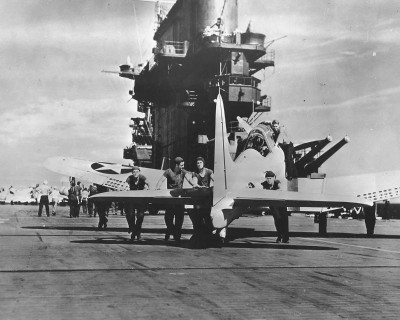

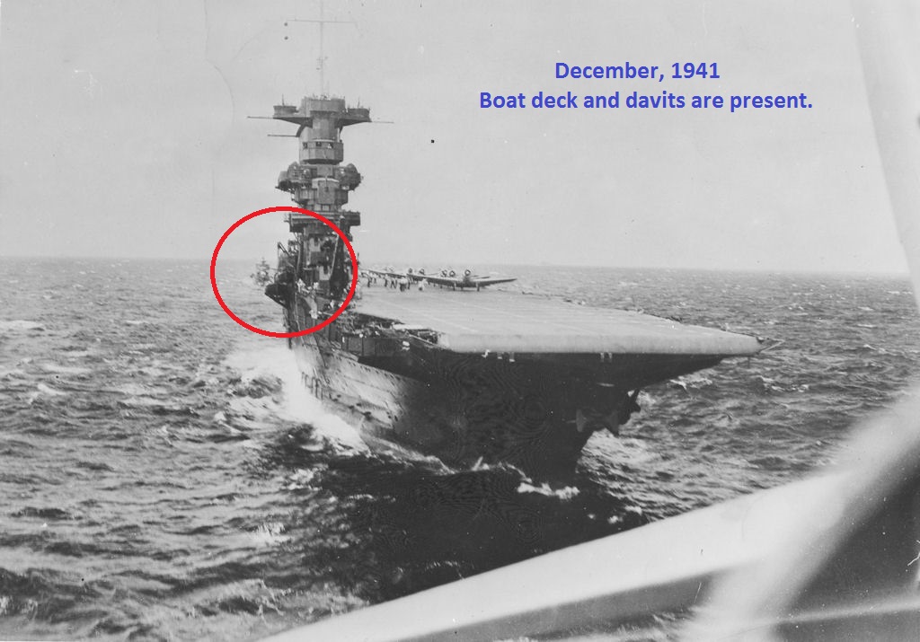

The conversation in this thread got me hooked, and I was wondering what pictures were provided for Model Monkey by Dick J to draw the late 1941 funnel version of SARA. Would it be possible to share those?
Thank you very much!
Akos Gergely
Akos Gergely
- Model Monkey
- Posts: 4112
- Location: USA
Re: Calling all USS Saratoga CV-3 fans
Here you go.
csatahajos
Thank you so much!
Do you have a date on the 1st pic?
Akos
Akos
- Model Monkey
- Posts: 4112
- Location: USA

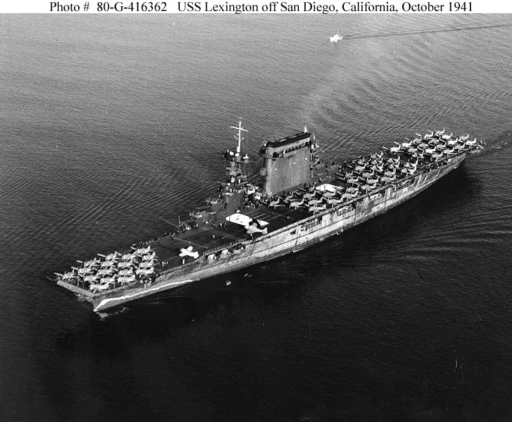

I'm sorry, I don't have an accurate date for that photo other than to say summer-fall, 1941. Similar photos with aircraft in the same colors were taken aboard in early October, 1941 (Doyle, pg. 97) so maybe that photo was part of the same group of photos taken at the same time. Therefore, best guess: early October, 1941.
Sara completed the refit that added the large Oerlikon platform on the funnel and the widening of her flight deck at the bow on 28 April 1941 at Bremerton, Washington. Sometime in late October or early November, she entered Puget Sound Navy Yard where her AA defenses were improved. It is not clear exactly what changed during that refit. That work was complete by 2 December 1941 and she sortied to San Diego to pick up her air group. She arrived at San Diego on 7 December 1941. She sortied for Pearl Harbor the next day.
In January, 1942, Sara was struck by a submarine-launched torpedo. Initial repairs were conducted at Pearl Harbor where her 8" turrets were removed and used as part of coastal defenses there where they served in that role until 1948. She received four 5"/38 Mk.32 mounts in their place. She then went on to Puget Sound for permanent repairs and extensive modifications which lasted from February to May 1942. It was at Puget Sound her funnel was cut down to a lower height, her island significantly modified, she gained Mk.37 directors, her hull was blistered, and her flight deck extended aft, among other mods. Sistership Lexington did not survive long enough to receive similar mods, unfortunately.

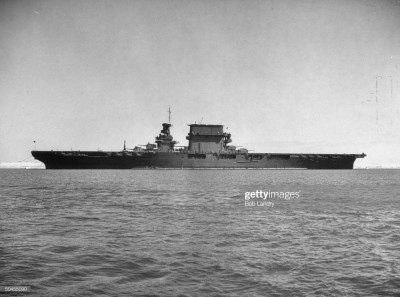

Below is a well-know photo of sistership Lexington. Note that the large Oerlikon platform on Lexington's funnel is positioned much higher on the funnel than the platform on Saratoga's funnel. This means that to build an accurate Saratoga 1941 model, a Lexington 1941 model kit's funnel is not a good match.
Hope this helps.
Hope this helps.

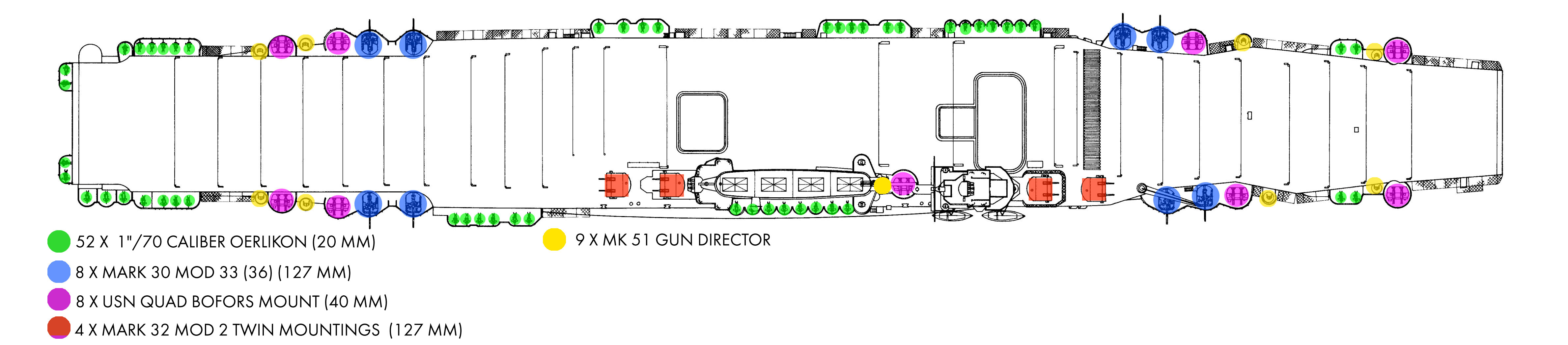

I look at the setup during the Rabaul mission (November 1943)
If possible, few questions from newbie:
- Sarah had nine (9) Mk 51 Gun Director for Quad 40 mm Bofors Mount? Right?
- 20 mm Oerlikon had a Mk 14 sight (Mk 14 Gunsight was an integral part of the Mk 51 director)?
Tamiya Saratoga 1944 model, already has 21 Mk 51 Director (new configuration for more bofors)

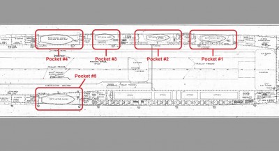

Do all of the boat pockets have catwalks? I is hard to tell. I have the Squadron at Sea book for reference. My thinking is to get the hull right, boats done, railings installed and paint, then attach ship to base. Flight deck can be installed at that point. Any thoughts, or suggestions?
- Model Monkey
- Posts: 4112
- Location: USA
Yes, all of the boat pockets had catwalks. There were a lot of features in the boat pockets and no two pockets were identical. In the US Navy drawing below, the edge of the catwalks is drawn as a dashed line above the boats. Here is our interpretation after a careful study of available plans and photos:Killerbeans wrote:More questions.
https://www.model-monkey.com/product-pa ... -1928-1942
I recommend assembling and painting the boat pockets as subassemblies before installing them in the hull for better access to their features.
Hope this helps.
Regarding your question about the prewar guns and the forward part that folds, I'd like to be able to help with that but I'm not sure what you mean by the folding part. Are you talking about a part of the 8" turrets or the 5" guns' sponsons?
