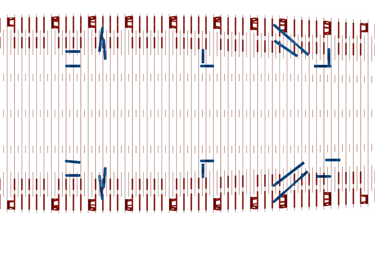

bigjimslade
- Posts: 463
Here are the paths of the 5-inch hoists on top of the framing. Only the hoists for mounts 5-8 are symmetric. The inboard hoist for mount 9 is angled so that it passes through a bulkhead. If it were straight it would miss so I have no idea on that.
In regard to mounts 1-4, I can only imagine the difference is due to the layout of the magazine.The starboard magazine is a few feet forward of the port magazine.
Some documentation refers to one of the hoists in each pair as a powder hoist and the other as a projectile hoist. However, the hoists are the same. Because they are just conveyer belts the same hoist model can be used for different sized guns (up to 6").

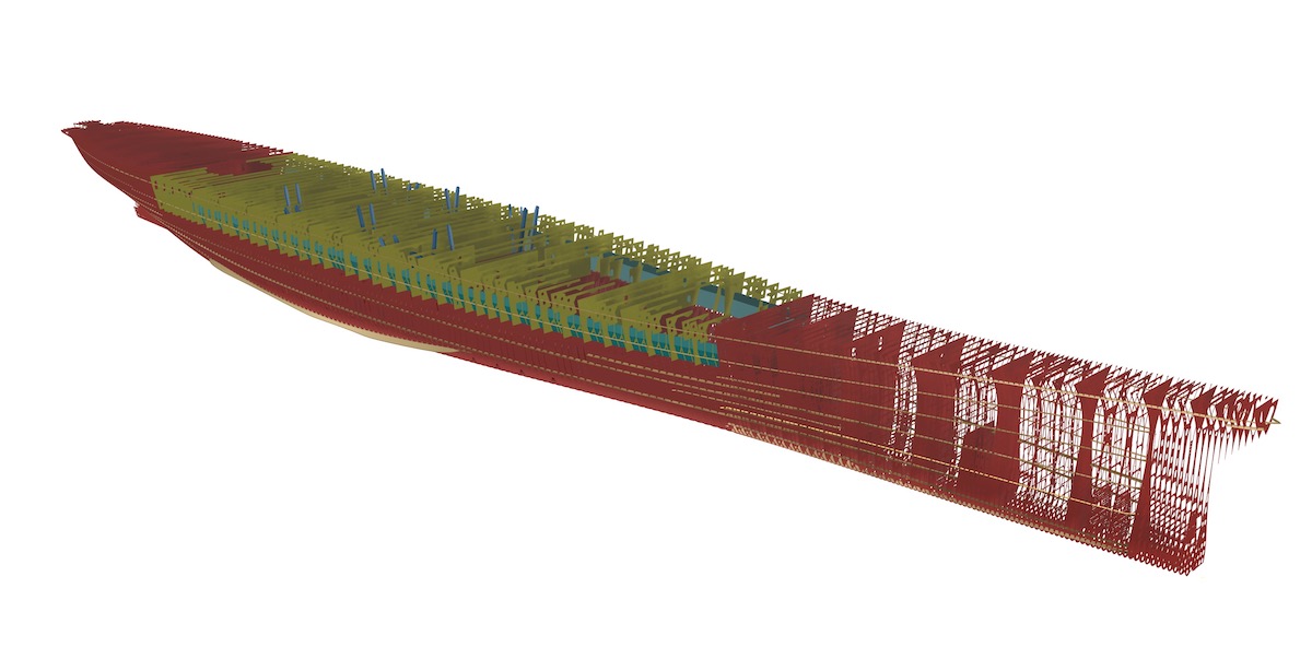

bigjimslade
- Posts: 463
More Pontification on the Iowa Class Structure
The hull internal structure is made up of several elements. There are three main types:
1. vertical longitudinal members (keel longitudinals)
2. horizontal longitudinal members (stringers, breasthooks, and you might include decks)
3. transverse members (frames, beams, floors)
It is hard to keep track of things because one type of member can be composed of subcomponents and members can flow into a different type of member.
A frame can include floors (the part under the deck) and beams but beams and floors do not have to be part of a frame.
Stringers flow into breasthooks and torpedo bulkheads. So part of a torpedo bulkhead could be called a stringer.
Furthermore, the members are not solid structures. Support structures flow and intersect in three dimension so many members have to be intercostal. The general rule is that vertical longitudinal members take precedence over transverse members that take place of horizontal longitudinal members.
Unlike a model ship, the hull shell was built first and the structural members were erected behind the shell. The shell was largely, if not entirely, self supporting.
Here is an image showing the underlying structure going by what the plans call things. The frames are in red. Note that the framing stops at the third deck within the citadel. There are webs at some frame locations that effectively extend the frames up to the second or main deck. Some of these have beams that go all the way across creating a full height frame. However, many of the frames do not have extensions above the third deck in this area. Apparently, the designers were relying on the stiffness and strength of the side armor for support here.

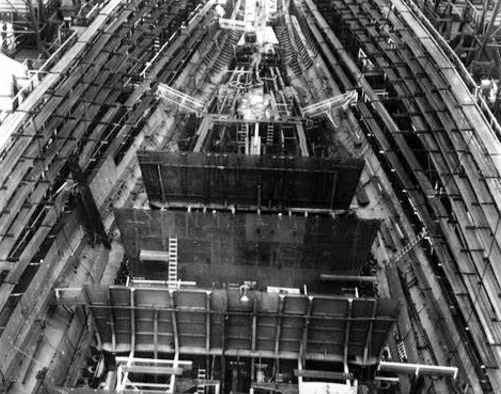

- chuck
- Posts: 3384
I�ve never seen any indication the shell of a battleship can be self supporting in large part. Instead piece of it small enough to be self supporting are erected, then structure behind it are added to provide it with support and stiffness, and provide the strength to withstand the weight of addition structure, the more shell is erected around the first piece.
- Posts: 5068
Here is a photo of Iowa: Plates are starting to wrap up from the bottom. Note scaffolding, probably to facilitate riveting.
- chuck
- Posts: 3384
Yes, but before those side plating get very high, the interior of the double or triple bottom, the bulkheads, the side protection system, and the decks in the lower part of the ship would all be put in. I don�t think you will find many instances where the shell platings rose much more than 1 deck above the highest deck that�s been installed inside it. Also, the framing for the side plating is usually installed before the framing. You often see side frames sticking up above the highest strake of side plating installed.
Note while the scaffolding was erected up to near main deck level early on, not much of the actual shell plating is erected above the highest interior deck that�s been installed:
http://navsource.org/archives/01/061/016162a.jpg
http://navsource.org/archives/01/061/016162e.jpg
