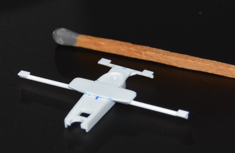

I have started the binoculars sets. The items themselves were a bit tricky to build, but not that complicated. Here you are the basic elements :
After this I have changed the plan completely for a while, and have devoted some time to the main mast, something that I thought would be either tricky again or a real problem.
The main elements in this mast are the mast itself and the first platform, as everything else will be based in one of the two. The platform underside is not bare at all, just the opposite, and had to be done before fixing the mast itself. This is what had to be done:
I made the platform with a piece of 1 mm. thick Evergreen plate, surrounded by a 0.25x2 mm. stripe for the contour, and completed with scraps of 2 mm. rod slices and 0.5x0.5 mm. stripe for the bars.

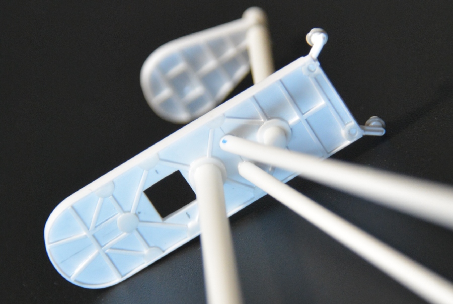

The next step was quite easy as well, the preliminary work in the upper platforms, these two :
The process was easy, using the usual pictures. I used 0.75 mm. Evergreen plate, and 2.00x0.25 mm. strip.
First platform:
And second:
When set in place, the effect is good.
The attachment to the mast has to be refined, and the fine detailing will be added afterwards, once the tripod is finished. I had thought at first to detail and then add the tripod, but I think I will follow Hank's method, first the tripod and then everything else, as I will have to manipulate all these elements a number of times, and breaking these tiny things can be so easy as well.
Nice going and best regards from across the Atlantic,
Willie.[/size]

Something I forgot yesterday: After setting all the platforms in place, I made a general view with a contrast against a straight even line, to doublecheck the setting matched the waterline. It did.
After this, I made the two legs of the main mast.
The problem of how to set them was solved when I started the main platform. All the operation would have to be done using as a reference the main mast in a dry fit, and precision is a must if you don't want to see your mast horribly off line after the process is done --easiest thing ever, if the cuts are not exact-- and the whole lot has to be fully removable to go on with the construction afterwards. But as the fitting had to be set from the underside of the main platform against the light and working with tenths of mm., I considered the most suitable solution to follow the same process used in the main mast to achieve the 5� rake: round heads instead of angled ones, so I made 1.75 mm. holes in the underside of the platform.
With this method, all three elements could get a decent dry fit to make corrections.
The fit is good enough even in dry; when the upper ends were finally glued I added two flat rings at the very top, to cover the small round imperfections, the same that I did with the main mast. Even with the lower ends loose the three legs do not move and the model can be handled without incidents.
The final test is to check the vertical lines, to make sure they are what they are supposed to be. I think that in my case I more or less made it.
This mast seems to be too long, but it is only an optical effect, due to the contrast with bare structures, no bridge, etc. When some of the structures are present the effect is way different.
So, this is it for now. I hope you like it and very best regards from across the seas,
Willie.[/size]
