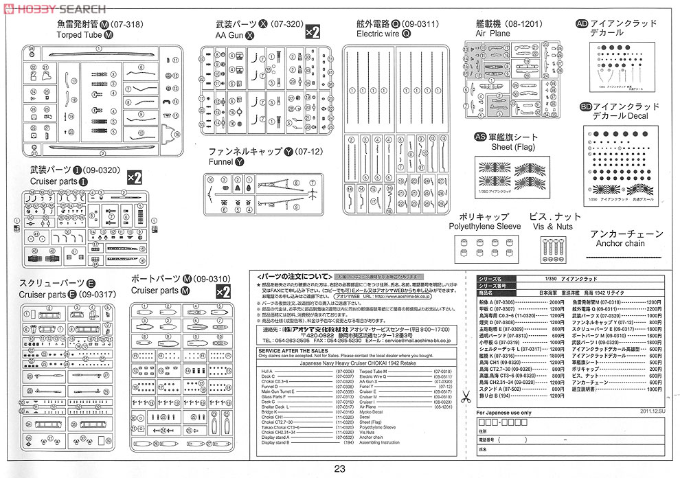

Take a look at these scans to see if the retake Chokai includes sprues that are not in yours: http://www.1999.co.jp/eng/10160974
Looks like all of the sprues that start with "09-" and "08-" are new in the Retake kit, and are on this page of the instructions: http://www.1999.co.jp/itbig16/10160974z17.jpg
Basically, new boats, degaussing cable, planes, misc.
I suspect the "09" and "07" refer to the year that the parts were introduced.
