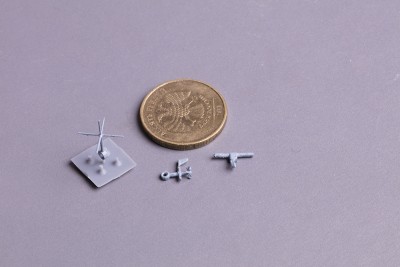

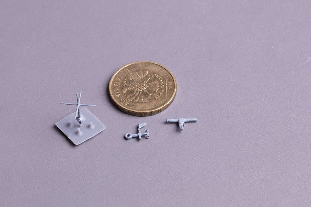

Small progress today, added a six speaker "Boom Box" to the front of the04 level, same unit as used on the Island of WWII carriers. Again repairing rigging aft , standing and running that I destroyed in replacing some 20 mm ready boxes. Printed a few items, some MK 52 directors in 1:192 for Alaska currently printing some jumbo four sheave pulleys for the aft 50 ton boom.

Perhaps Pascal is a bad influence on me with his three projects going at once. So I am going back and adjusting some things on Alaska and Missouri, both in 1:192. For Alaska I printed the fore and aft MK52 tubs and directors and replaced the one's that I had. Added deck binoculars, sky lookouts and 12" searchlights as appropriate. Missouri got both new Mk 141 Harpoon launchers and armored box launchers and some inclined ladders that I was short of.

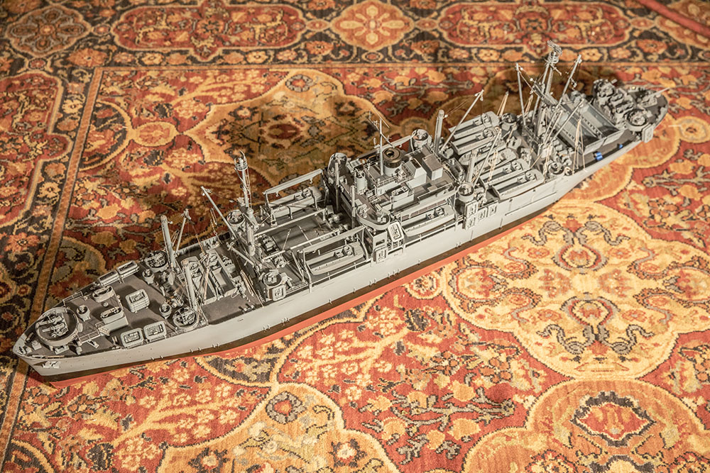

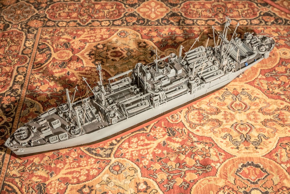

Haze gray and underway on my workshop floor. Many parts to add and rebuild. The fun is in the building!

Tom,
This is a very nice model - excellent work.
I see what you mean about there not being much free deck space!
- Posts: 5068
Re: APA project
Thanks Phil!
Imagine where the stuffed a Battalion of Marines and another six boats! There really wasn't' room for the "passengers" to stroll the decks much!

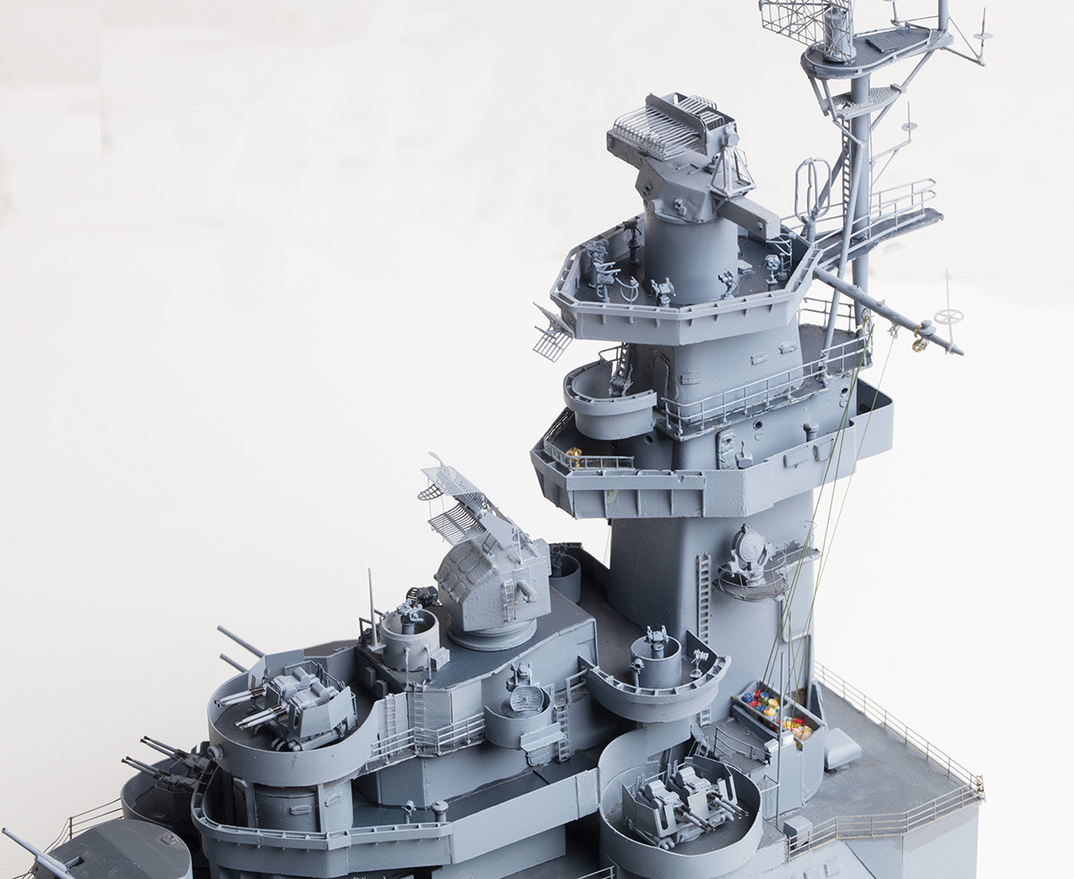

This is part of my 1:192 Alaska where I am in the process of going around and replacing items that I was not happy with, adding new light AA directors, some tubs and some rail on the upper levels of the fire control tower. In printing rail that snakes around corners etc, sort of fun.
So giving me some experimental satisfaction going through and replacing some parts in a "shipyard overhaul"

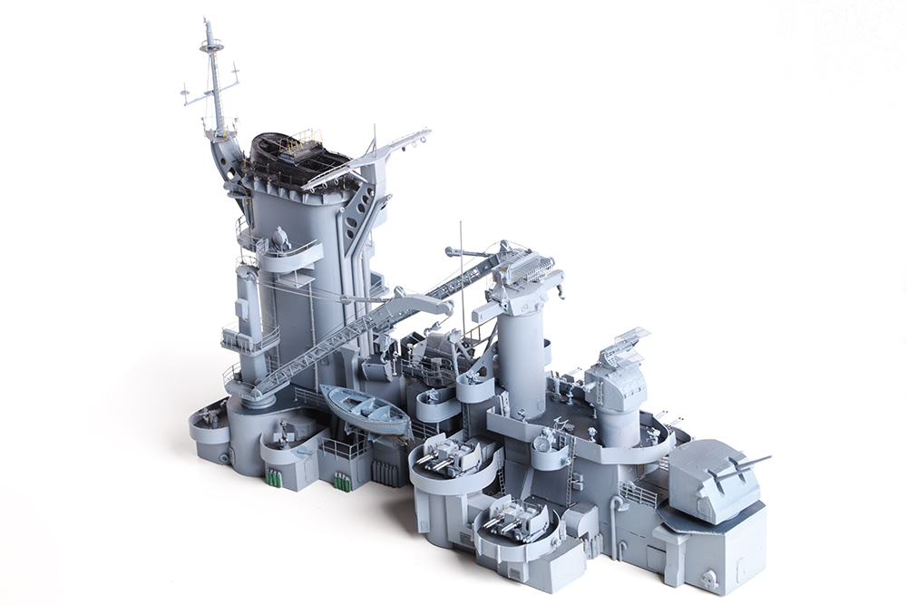

Aft superstructure of Alaska, CB1 1:192. The current modification are the three director tubs and all the pipe rails, light AA directors, sky lookouts, deck binoculars, some vertical ladders and SG radar at the top of the mast. The basic structure is 1/16" plexiglas, the stack a plexiglas box sanded to shape. 26' motor whale boats carved from basswood.
For Alain who is doing his own APA in 1:350, showing the bulge on the bridge deck for the CIC and the extended walkway. Also note that the tubs around the 20 mm are open to the rest of the deck area.
Since this is a tertiary source (my model) I don't claim it to necessarily be accurate for the ship you are building!
Good luck! Tom

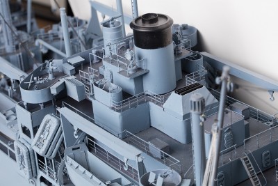

In the photo above one can compare two styles of pipe railing construction. The rail snaking around the bridge and CIC are is printed, note the corners. The deck below is constructed in a more traditional manner, brass wire inserted in holes in the deck (1/16" plexiglass) with a wire top rail and variously thread or fine piano wire for the intermediate rails. They look OK, but the issue is with the corners which can be difficult. Where printing shines is such items as circular rails on radar platforms etc.

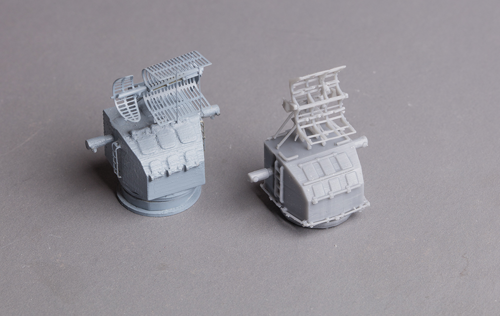

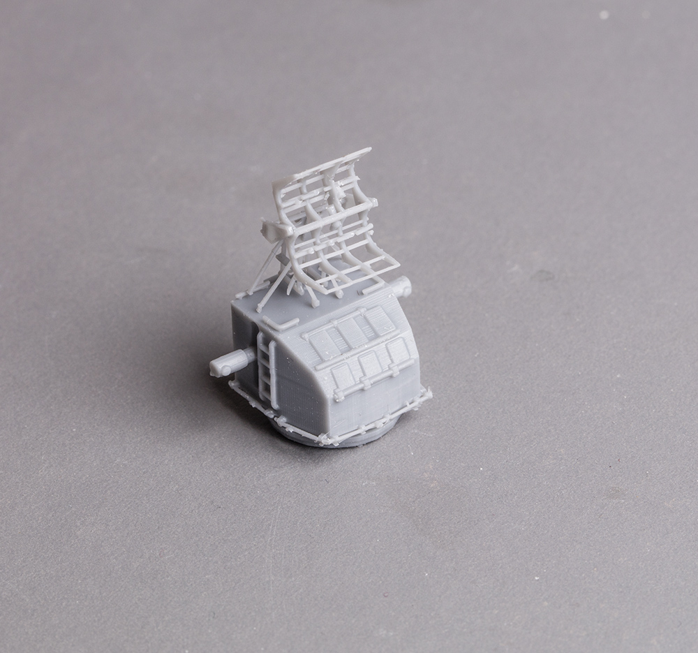

Again off topic... I re did the Mk 37 directors for Alaska, which from a commercial purveyor were about 10% oversize. Not the final product I will install on Alaska, but getting there. Hank Strubb generously offered me the radars left over form hid NJ project. Mine here lacking the height finders so far, and perhaps more detail can be filled in on the framework.
