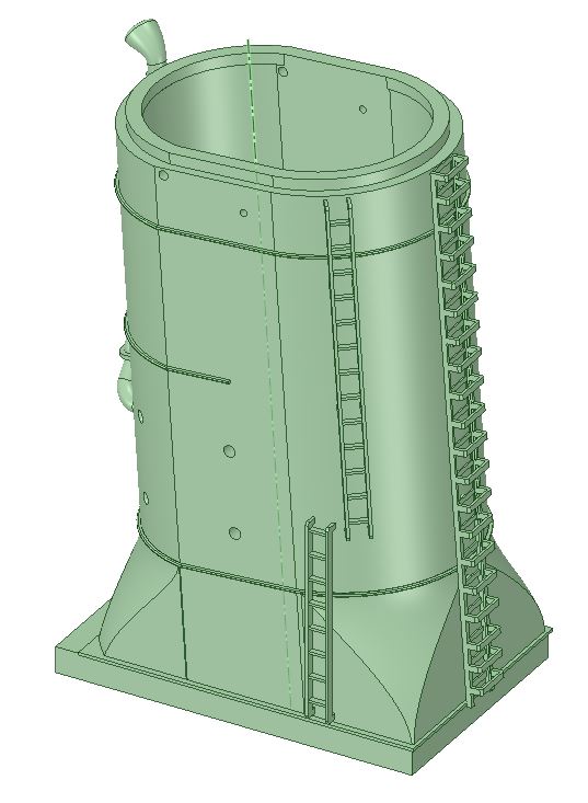

Post by BB62vet »
Steve,
OK, your method (or a modified version due to our differences in program commands) has done very well!!! -
I can now take this and modify & adapt to add all the various items that were on the original stack body. So, I am deeply in your debt, Sir! I've certainly been "schooled" in 3D Design today. :thumbs_up_1:
Thanks so much!!!

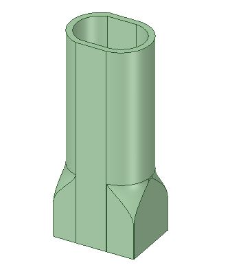

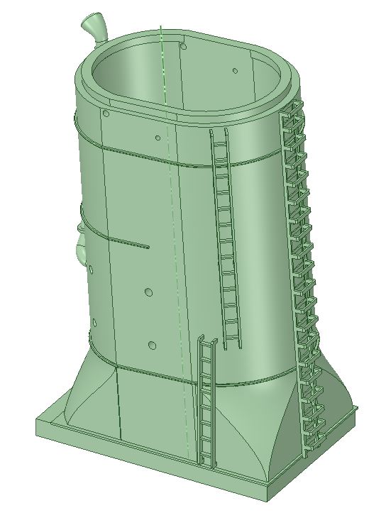

So, the after stack is ready for a test print -
The side intake vent covers will be printed separately. I've made provisions for the after yardarm assembly to be located and have a bit of work to do on that part, as well before reprinting it. I added the ladders, cable tray, and vent pipe as these items are all painted the same and the printer does a great job of printing all the details.
I am still going ahead with construction of the original after stack (kit) to see how the two units compare when all completed. With a new vat on order it will probably be sometime late next week or the following week when I'm able to get things printed.

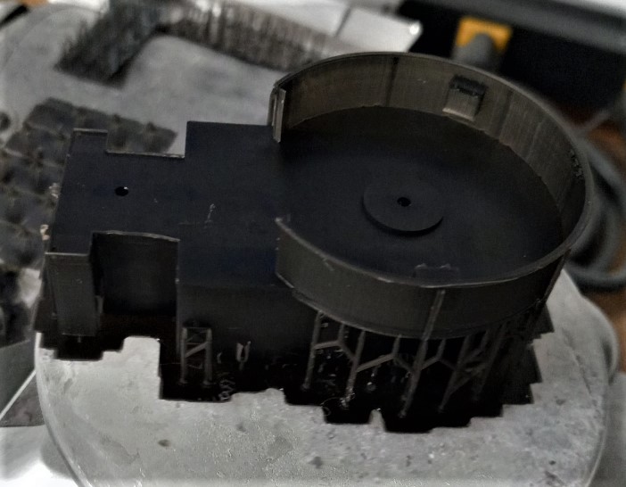

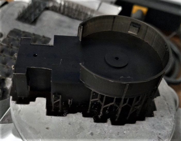

Well, the stack will print tomorrow a.m. or thereabouts!! I've had a week's vacation and have received some new parts for the printer, some 3D printed parts from Tom, have rebuilt my printer for the 2nd time in 2 weeks and have FINALLY gotten a couple successful prints today after a lot of headaches with the LED Lamps, LCD screen replacement and destruction (that one on ME!!), and a vat failure that caused the LCD screen snafu. At this point, I made two good print runs today and have another one running late tonight.
I now have a couple 3D printed gray resin 01 Level Deck House/Gun Tub parts that Tom printed for me and also a Rapid Black Resin part that I printed today - comparisons will be made to see which came out the best and that will be used. Here's a photo of my final effort today -
It is currently drying under the fan but appears to be complete and highly detailed - what I was expecting in the first place. This was the 5th edition design so once the LED lamps were functioning correctly, this part came out very well.

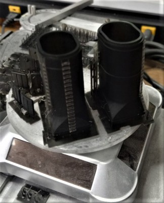

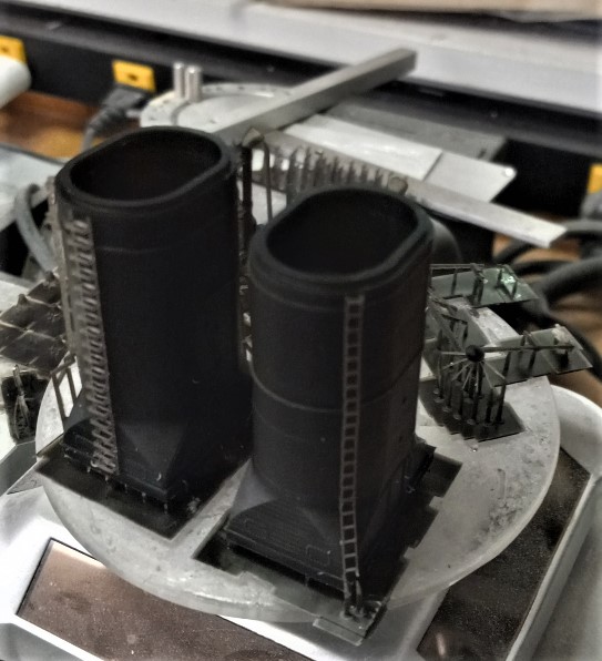

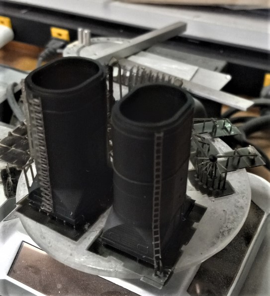

Today's print run went well - I've now got the 2nd edition of both Fwd/Aft Stacks printed and useable. A few parts that go with the stack bodies were also printing and everything will dry overnight and then cure in the morning. I think I will go ahead and paint/assemble both of these as they look a bit more detailed than the kit parts. Well, they ARE more detailed, simply speaking! Here are a couple shots of those parts drying on the turntable -
So, after I print a new cable run part to go into the cable tray, I should have everything necessary to actually get these stacks completed. Unless, of course, I break something...always a possibility these days!

Always hard to evaluate the Rapid Black resin parts in photos before they are painted. I am guessing these will look good indeed. Glad you figured these out!

Thanks! Yes, the stacks came out very nice - I used 2mm thickness on the stack walls (I think I also did on the T-3 Stack, as well) and that gives a solid part that leaves plenty of thickness for surface indentations/details/etc. I debated (with myself) a lesser amount, but this has come out perhaps as a std. for this scale. Perhaps a bit more for larger scale models, less for smaller scale, etc.
I hope to get these cured and cleaned up sometime today.

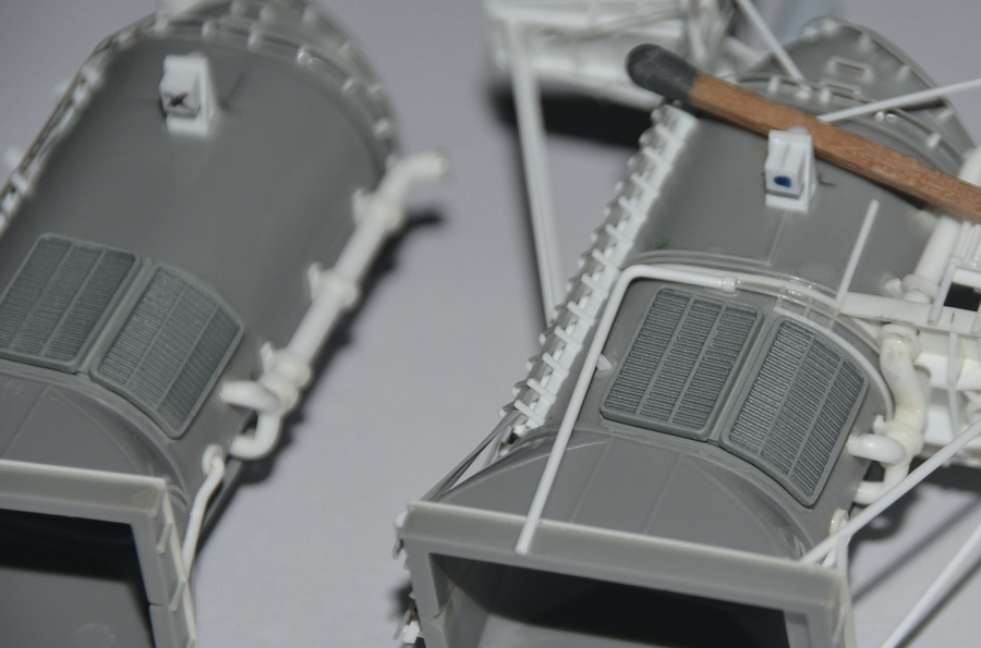

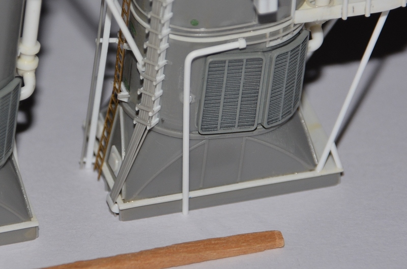

Howdy Hank and all,

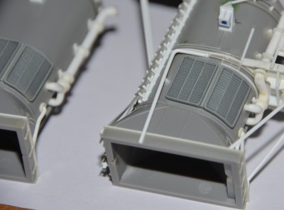

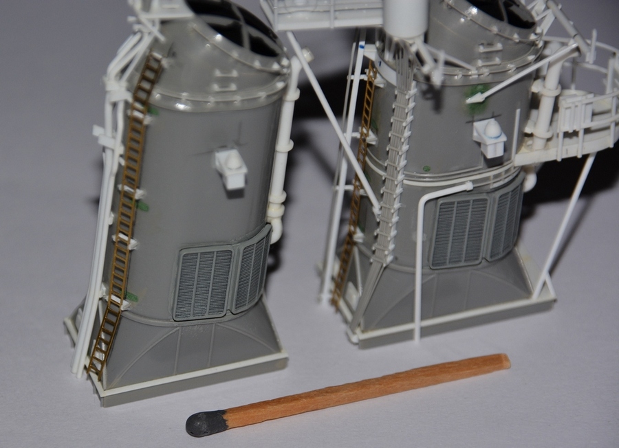

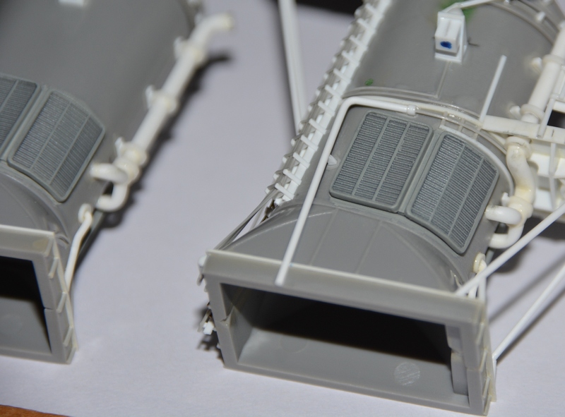

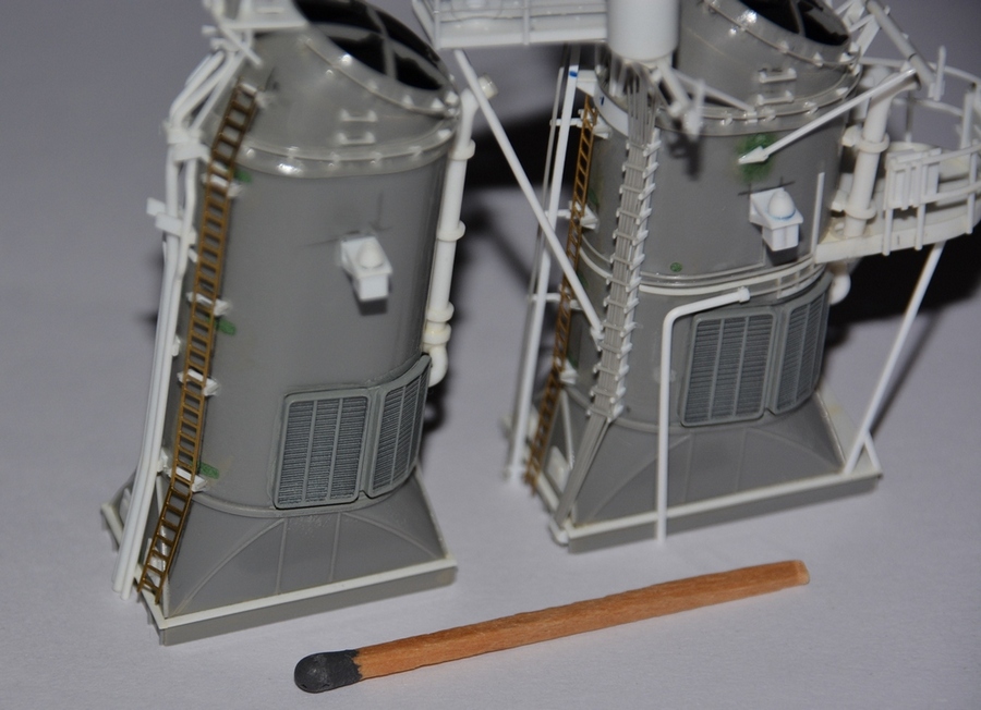

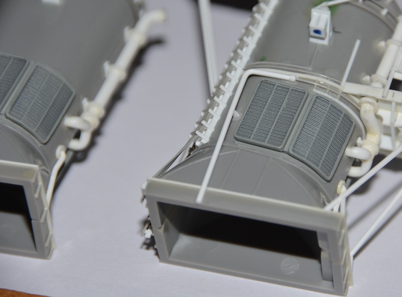

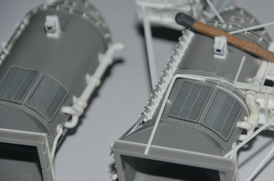

Excellent progress so far, as usual. Great to see that the pains you have taken with the stacks have been fruitful, and that you have come to a good solution.
As for the side grills --and with reserves, as I am a Mr. Nobody reg. printers, and the pics are not that clear-- I am nevertheless not so sure about the results on these specific elements. The bars are very, very subtle, and I have my reserves, as I say, as if you will be able to reproduce them. I would use the ones in the kit, which is what I have done in my case. I applied two layers of a very diluted light grey, and two more of a more diluted dark grey (not black), completed with a very subtle dry brush. I would say it worked wonderfully.
Please notice that these pictures are taken using a very strong light (my flash is actually of blinding quality), that highlights the glossy points left by the drybrush, but under normal light the results are excellent, much better than what you can see in the pictures.
Please disregard all this if your grills have come out well. I am sure you will need a good drybrush anyway.
Keep the good work and the pictures coming, and very best regards from the North Atlantic,[/size]

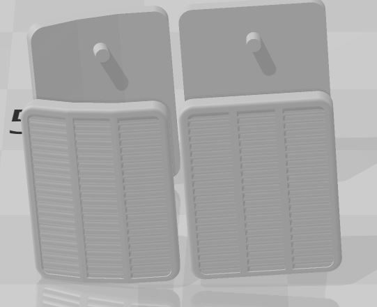

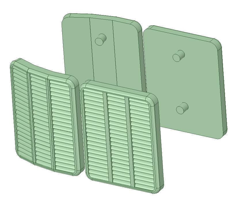

Thanks for the great commentary on the stack intake grilles - as I have chosen to do the stacks COMPLETLEY 3D Design/Print, I have made my own - here is a couple shots of the designed version:
I will, however, try to replicate your methods for painting, etc. - that sounds like a sensible idea.
