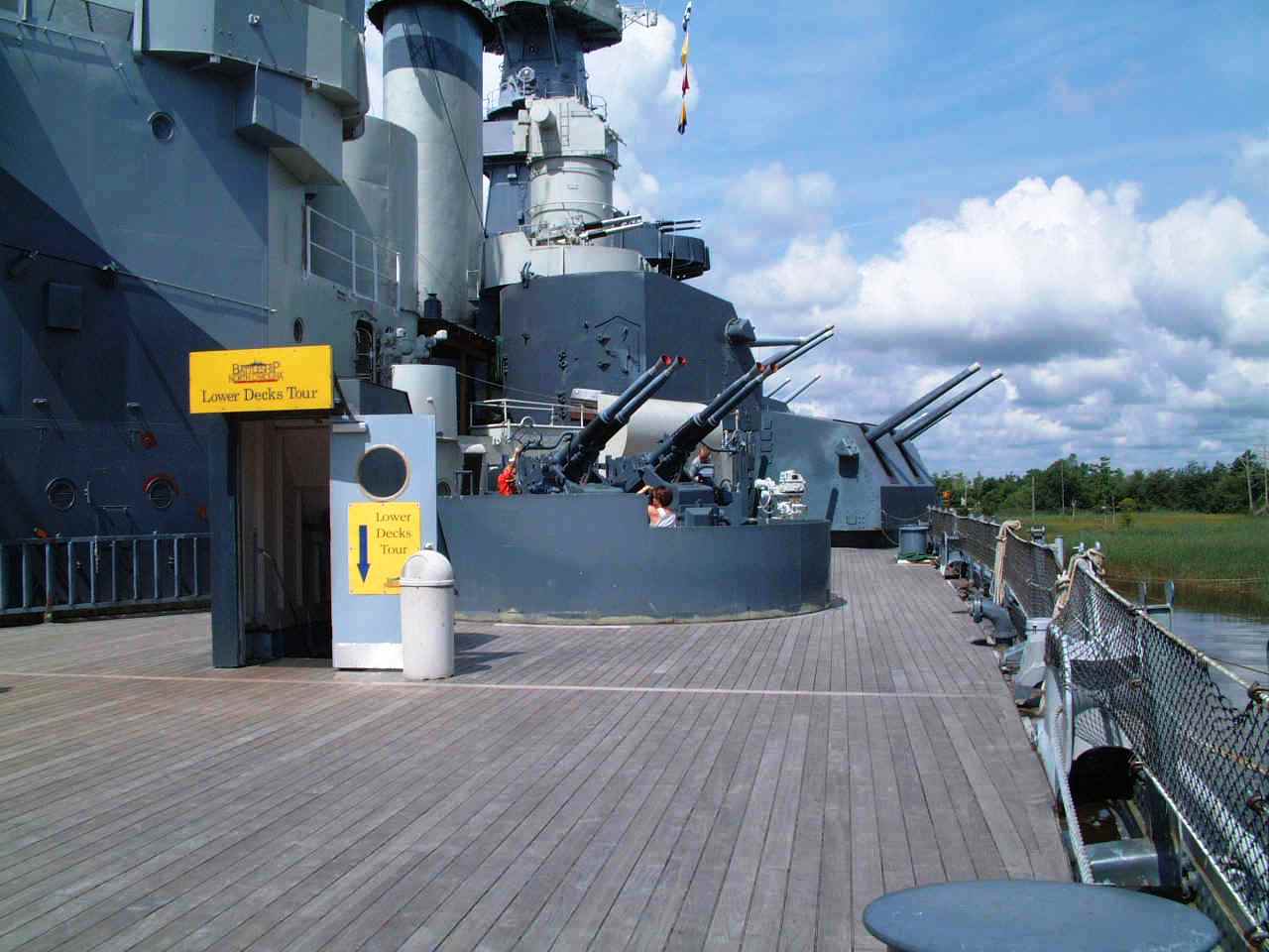

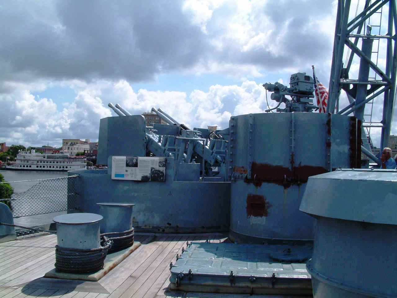

This is North Carolina. Assuming the decks were completed similarly, you can see that the planking does not extend to the edge of the deck, but to a small vertical plate which acts as a lip protecting the outer edge of the planking. Outboard of the plate, the steel deck is not planked, forming a trough known as a "waterway". This is true on main deck and planked superstructure decks.
The outer edge of the waterway has a vertical plate, too, much like a "kick-plate", flush with the side of the hull. It has a rounded pipe welded to the top of it - no sharp edges. Its height (the top of the pipe) is about even with the top of the planked deck.
Within the waterway, NOT on the wooden planking, are chocks, fireplugs and posts for railings (notice that the posts are fixed on a hinge so that they can swivel fore and aft - laid down during combat), among other features.
The waterway is the width of the chock. Also, notice that there is a tunnel-like opening under the chock, permitting water to pass fore and aft along the waterway under the chock.
Note, too, that in photo "007.jpg" there is a joint running traversely just aft of the "lower decks tour" vestibule. In person, the joint is very subtle but shows up well in this photo due to lighting. It is not certain whether the joint is new or original. North Carolina's planks are replaced as they wear out.
The planks are fixed to the deck by large, countersunk bolts which are laid along the centerline of the plank. The holes in the planks for the bolts are then plugged with wood and finished smoothly with the surface of the plank, thus, they are largely invisible.
Hope this helps.

Actually on Missouri, and I presume the others, bolts are not used, but threaded studs welded to the deck with nuts and washers holding the planking down and finished on top with the previously mentioned plugs. Threaded sockets for bolts would be a much more complicated instalation and more likely to seize. Some such areas could be seen aboard BB 63 where deck maintaince was underway. I don't have a waterway measurement, but the width is in the 8" range.

Same on NC. My bad.Fliger747 wrote:....bolts are not used, but threaded studs welded to the deck with nuts and washers holding the planking down and finished on top with the previously mentioned plugs...

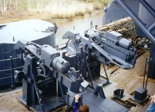

I am looking for precise drawings of 127mm shells loading device. Or pictures from side and top view... any suggestions for source?
