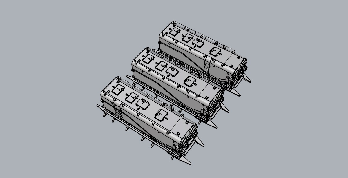

This is rendering that shows the three basic ABL configurations on the USS New Jersey. There are actually more variations because the four end extensions for the bases are aligned to the beams under the deck so they do not have the same length.

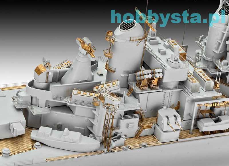

Hello everyone,
I'm building Revell's platinum 1/350 USS New Jersey right now, and I'm seeking additional aftermarket parts for elements of the model that even with Revell's upgrades still look shoddy.
In particular, I'm looking for any improved parts on the small rigid hull ships (Seen here) that are lacking upgrades.
Does anyone know the name of these particular vessels to help my search for better pieces?

You can find the names of them on the first page of this set of drawings, and then on the overhead view you can find the specific boats with the names attached to where they are: https://www.hnsa.org/wp-content/uploads ... 8/bb62.pdf
bigjimslade
- Posts: 463
On the port side, it's 40-foot utility boat with a 26-foot motor whale boat above.frenchc197 wrote:Does anyone know the name of these particular vessels to help my search for better pieces?
On the starboard side, it's a 33-foot personnel boat with a 26-foot motor whale boat above.
A variety of boats were used on dollies, including
26-foot personnel boat
28-foot personnel boat
40-foot personnel boat

For the larger boat aft of the refueling tower look up "USN Captain's Gig". Yours will need be hollowed out and an interior fitted, that upper projection removed to be replaced with a windscreen, the windows either cut out and replaced, or painted black to simulate glass, railings added fore and aft, and a prop before the rudder.frenchc197 wrote:Hello everyone,
I see on Shapeways that "BaconFistModels" produce several 1/350 USN boats if you want an upgrade. I've not bought from them so I cannot speak to their level of detail.

Some accuracy notes (just addressing the add-ons):JoeP wrote:frenchc197 wrote:.
1. The ladder openings on the ABLS face inboard on the aft group and forward on the forward group, except that the two forward ABLs on the NJ have openings on both sides.
2. There is a full deck behind the Harpoon shields at the top of the shied.
3. The aft harpoon platform is the narrow version that is correct for early 1980's It was widened to add tracks for ABL reloading.
4. There is a bulwark (rather than railing) at the O1 next to the refueling kingpost.
5. There is no border around the odd shaped decking around turret 3. The non-wood area was a a rubber mat over wood.
