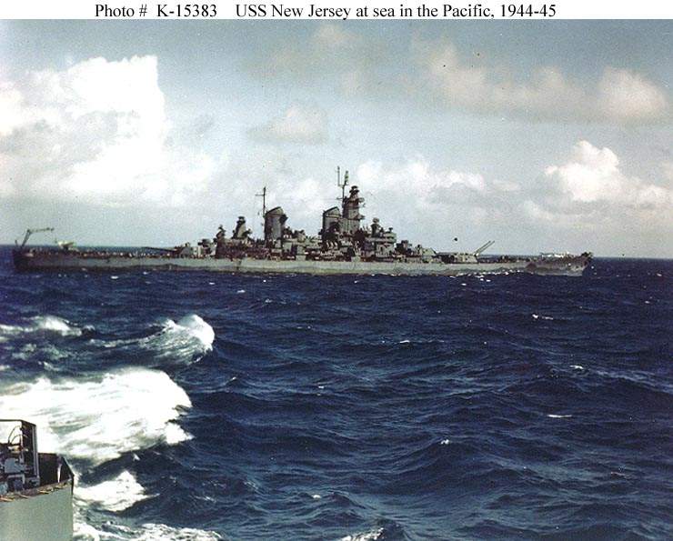

Or to put it simpler, I wanna build this NJ as attached in picture.

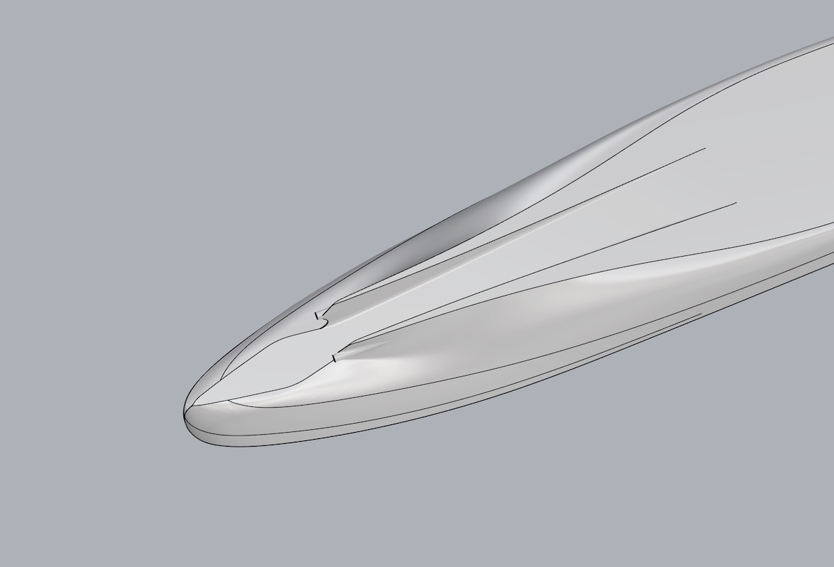

Yes, the stern section Im clear on (i saw your post earlier). What I wonder about is the bow shape. Is that alright?
Good that the bridge is square - I can use the one from Missouri without changes, then. (or?)
Posts: 12454
Pretty sure it's the round bridge in that photo - when NJ got her square bridge, she was also repainted into the two-tone MS 22 scheme.

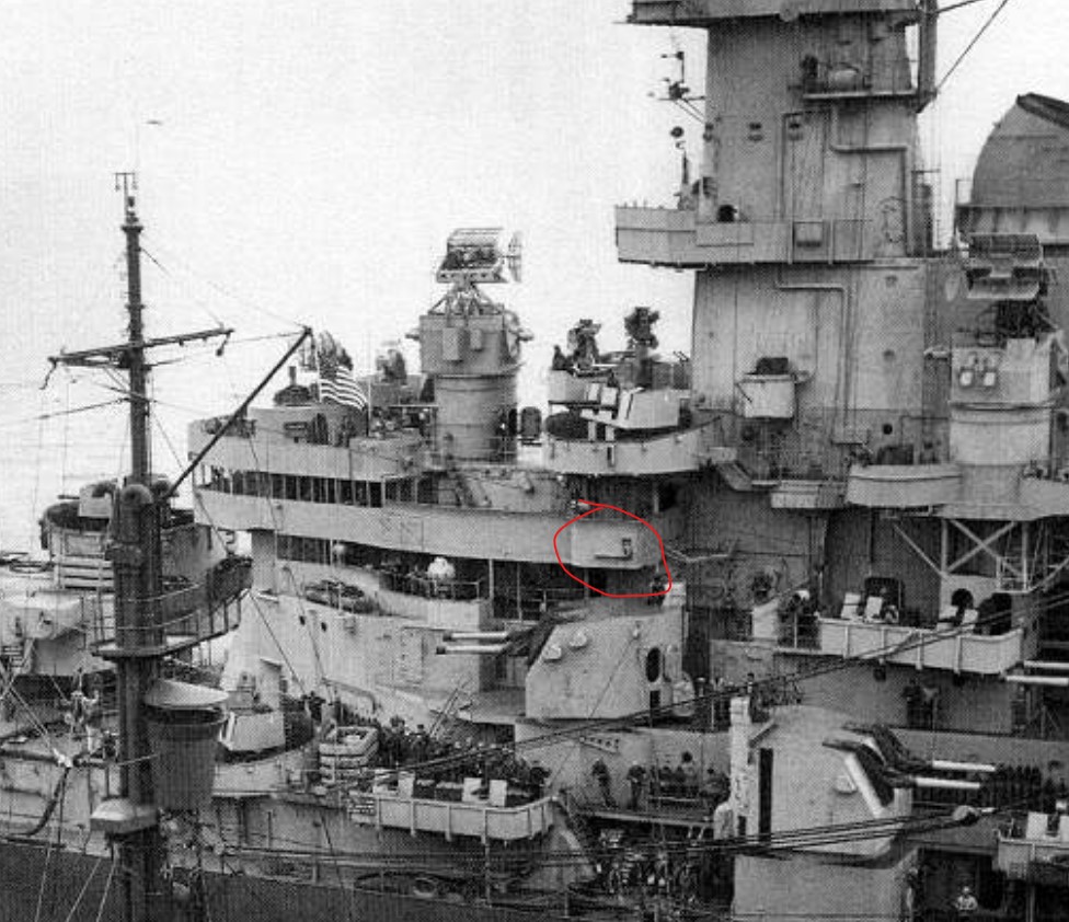

Maybe someone can help me, I'm looking for the position of the navigation lights on the Missouri, a drawing would be ideal, and the bridge lights too.
Pascal
Posts: 12454

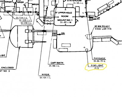

In WWII, they're here:
For the 80s modernization, it seems they ('sidelights') were moved down to the 01 level (taken from New Jersey's plans on HNSA):
The museum Wisconsin has them quite prominently but I'm not sure how reflective they are of the original location: http://www.navsource.org/archives/01/016442.jpg

Thank you Timmy for taking the time to answer me quickly, to post pictures and the plan. :thumbs_up_1:

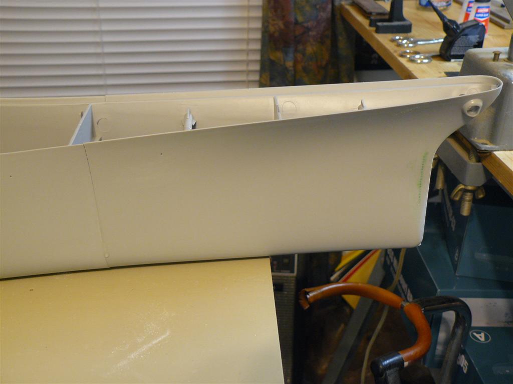

I have started the Trumpeter 1/200 USS Missouri
The photo below shows numbers painted on the hull. It appears that Trumpeter placed holes in the hull at the same location as the numbers on the actual ship. I can only guess that the holes are meant to represent the numbers. That doesn�t make sense to me. Why not just a decal?
http://www.navsource.org/archives/01/016308b.jpg
For anyone else that has this kit, am I correct in assuming the holes somehow represent the numbers that one would find on the actual ship?

Post by BB62vet »
Greg,
Strange moniker (Mr. Nobody) :scratch: Sometimes when I'm out in public I wear a nametag that says "N. Cognito"......................... :doh_1:
Anyhow, more to your question re. the hole in the hull - say, that might be a good Beatles-type of nautical disaster song....has all the earmarks... :big_grin: OK, must be the COVIDs got me!!!!
About the hole - here is a picture of the beginning stage of my build back in 2012 - just so we're talking about the same hole, right??? The hole is located about an 1" to the right of the hull joint, correct?
If memory serves me right, this is just ONE of several holes, slots, indentions, etc. that you'll find in the kit that has no reference at all in the instruction manual. Why is it there? Well, it's there because of 3rd party accessories that are produced to enhance the basic kit. At least, this is my theory on it based on having purchased the Pontos Detail Up kit - the items in that upgrade matched quite clearly the "unknown" types of hull indentions you describe. I have another theory about this and that is that the kit mfgr is somehow in cahoots with these 3rd party providers (whoever they are) and someone is getting a kickback somewhere each time you buy one of their upgrade offers. When the kit first came out in the early 2000s, Pontos was the only 3rd party mfgr. to offer a MISSOURI kit upgrade so I'm pretty sure they are the ones in bed with Chicken Chow Mein, if you catch my drift. :cool_2:
Hope this helps - my build is located somewhere in the completed forum and also on the SMF Gallery - look for 1/200 USS NEW JERSEY (1967-68) ETC. - I did a 6 year project on her using this kit as the basis to begin with. Also, over on Works in Progress, create a build log so we can see what's happening in Mr. Nobody's shipyard. :thumbs_up_1:
Posts: 12454
Mr. Nobody's talking about the vertical holes near the stem where you've got your green putty - the numbers he's referring to are the draft markings.

Thanks for the reply Hank. As Timmy C stated it is the vertical holes that you filled in with putty. I had come to the conclusion that I would fill them in as well. I have the Pontos set. The included instruction aren�t to helpful with this but if you pull the instruction up online you are able to zoom in and make the small print and details large enough to see. The instruction show dry transfers that they supply, applied to the same location as the holes. I still don�t understand the reason for the holes but they do provide a good way to determine where the boot line goes and the decal. Before I loose their location with putty and paint I will make a template or take notes as to their location so that I can place the dry transfer decals properly.
