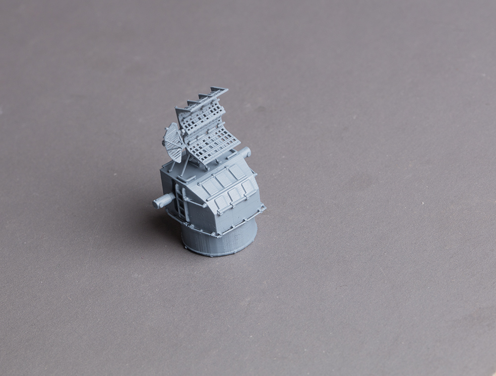

Post by Fliger747 »
Thanks Pascal!

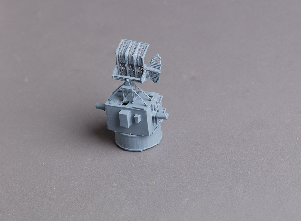

I printed a few more parts to go with this and sprayed some warpaint on. I am reasonably happy with the radar and heigh finder, but possibly could open the mesh up a bit.

Hi,Tom!
It's wonderfull!!!!
Cheers; Song
Posts: 5068
Re: APA project
Post by Fliger747 »
Thank you Song! It's not a traditional construction, but still requires the breaking down of construction into various pieces of relatively simple shape, something that you are very good at!

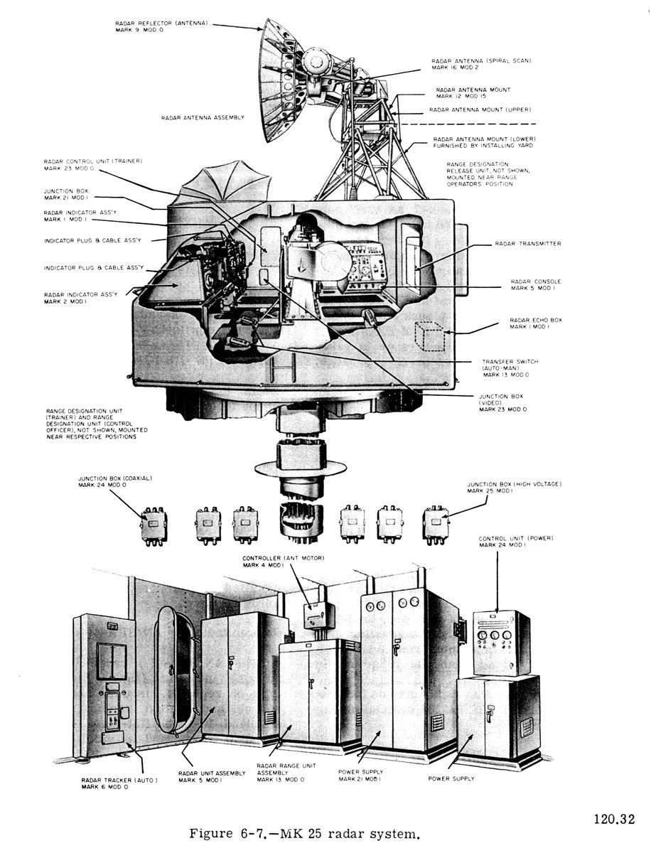

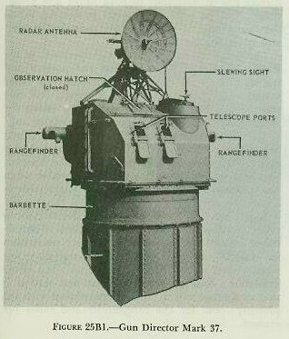

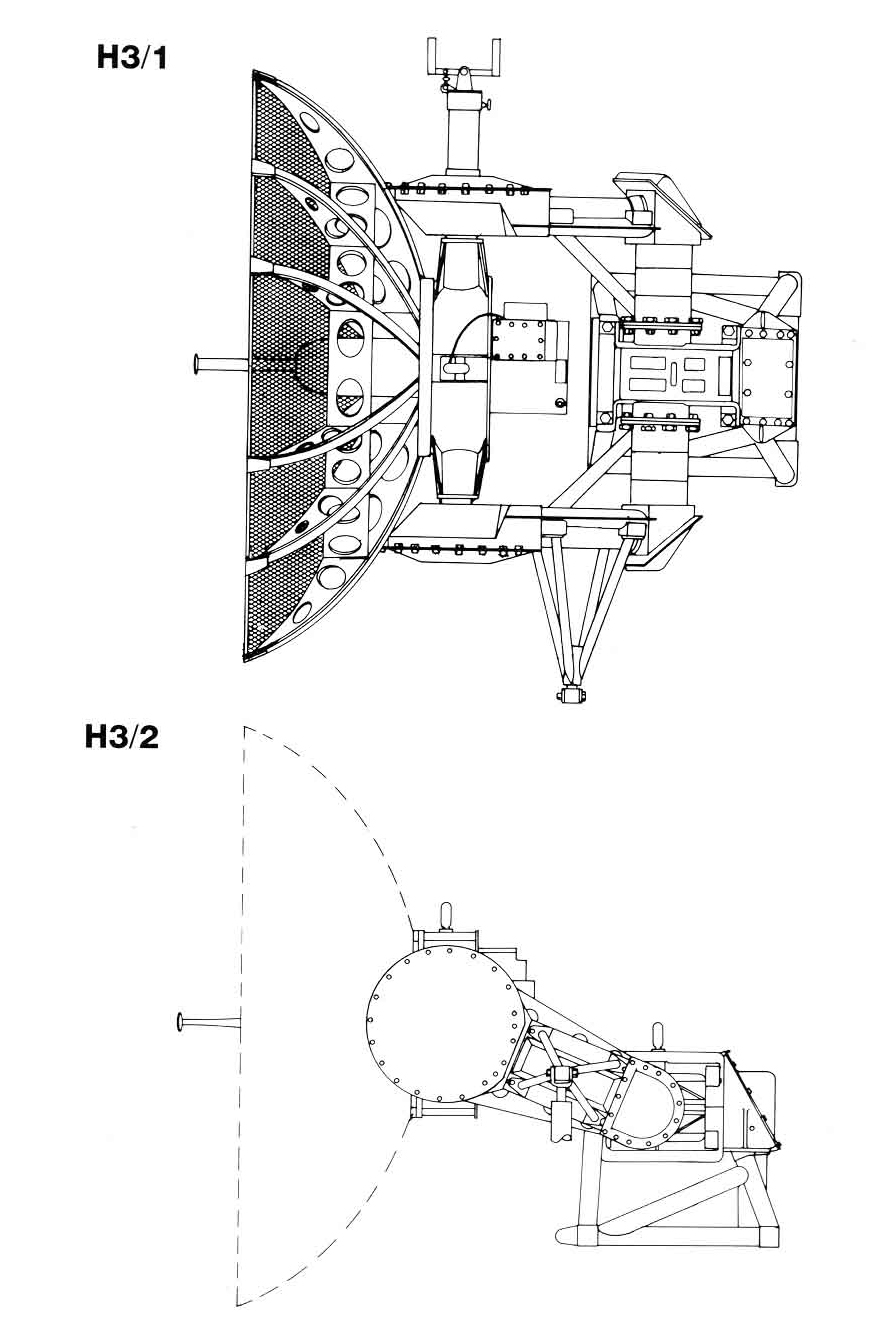

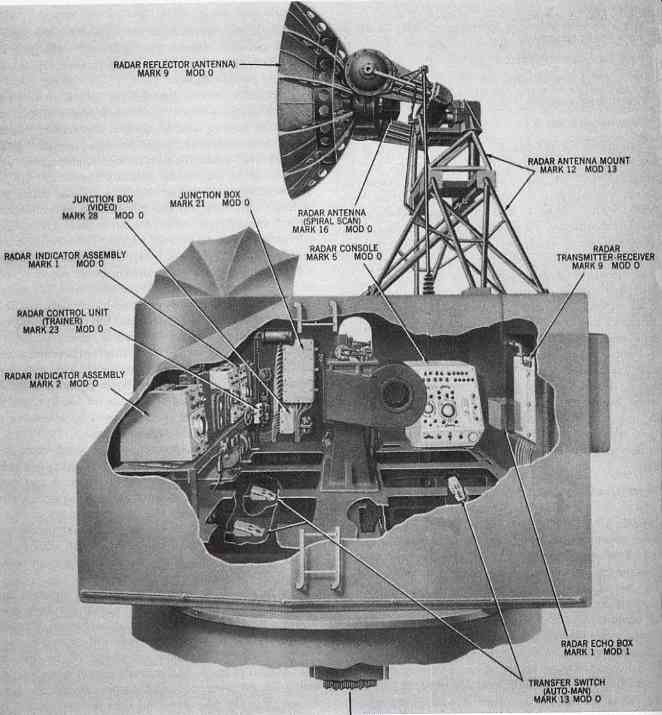

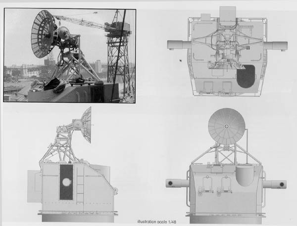

Tom,
Here are some images of the SPG-35 on the Mk 37 director:
https://www.okieboat.com/CAD%20radars.html
Here are some of the pictures I used to make the model.
Fig 25B1.jpg (45.93 KiB) Viewed 1408 times

Thank you, additional information is always valuable. My USN Naval Gunnery manual Vol. 2 has a number of illustrations of the interior arrangement of each station of the MK 37, a pretty common unit! It shows binoculars attached to the slewing sight in the cupola, removably it appears. Earlier versions seemed to have the ring sight similar to as seen on the mount captains station for the 5" 38's. You obviously have put a lot of work into researching the Okie City radars. Guam and Missouri had the cupola style MK 37's, Alaska had the earlier units.

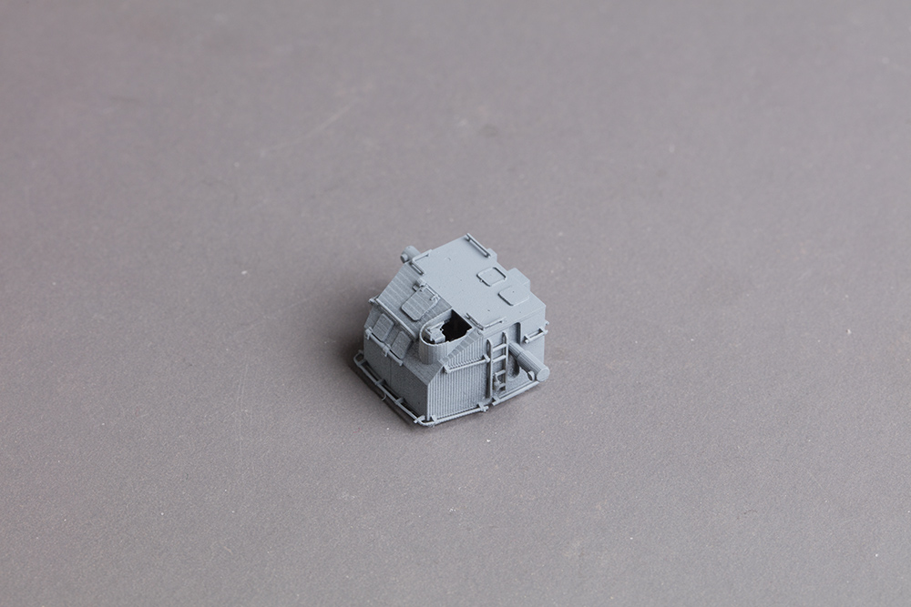

Here is my revised MK 37 for Alaska with cupola, slewing sight (w/o) Binoculars in 1:192. Also includes Director officers's knucklehead seat and supporting pedestal etc for the slewing sight.

What is your sonic setting, Tom?
Nice print! :thumbs_up_1:
Pascal
Posts: 5068
Re: APA project
Post by Fliger747 »
Pascal:
Sonic Mini Bottom lift 6
Layer 0.04 Lift dist 5
Bottom 10 Bottom lift speed 50
Exp time 4 sec Lifting speed 50
Bitt exp time 30 sec Retract speed 200
Light off delay 7
Bitt light off delay 7
This is with the Phrozen "Rapid Black".

Tom,
The binoculars were removable. I served as Director Officer for a while (lots of sea stories - don't get me started) and I would remove the binoculars from the stand when I just wanted to look around without rattling the fellows in the director. I could rotate the director with "handle bars" just below the binoculars. It would spin pretty fast! With the binoculars on the stand I could see what the pointer/trainer or the radar was aiming the director at, and give spotting corrections for direct fire.
I have noticed that many Mk 37 models omit the "bloomers" on the optical rangefinder arms. The rangefinder was stabilized to correct for ship roll (and pitch), so the arms rotated up/down relative to the director body. The bloomers (rubberized canvas) covered the openings in the side of the director shell. They were strapped around the cylindrical rangefinder arm and extended to cover the entire rectangular opening.
The cover over the Director Officer's position was rubberized canvas on metal hoops that hinged at the side of the opening frame. It folded back behind the position when the director was occupied.

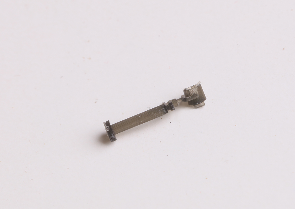

12 inch searchlight in 1:192, something like 8 mm high. Note the handle at the back printed OK.

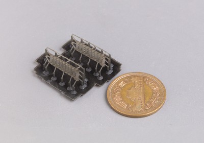

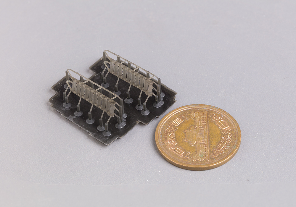

Inclined ladders in 1:192. For these I increased the designed diameter of the hand rail to .32 mm from .28 mm which printed much more successfully. Looking all the world like some sort of dried Krill...

Post by BB62vet »
But, does it smell fishy??? :big_grin:
Tom, those look good! I can see the difference in the color of the resin - I guess this is the "black" resin you mentioned? It looks rather translucent. But, it also shows the detail very well. Sort of reminiscent of the older Shapeways plastic parts.
