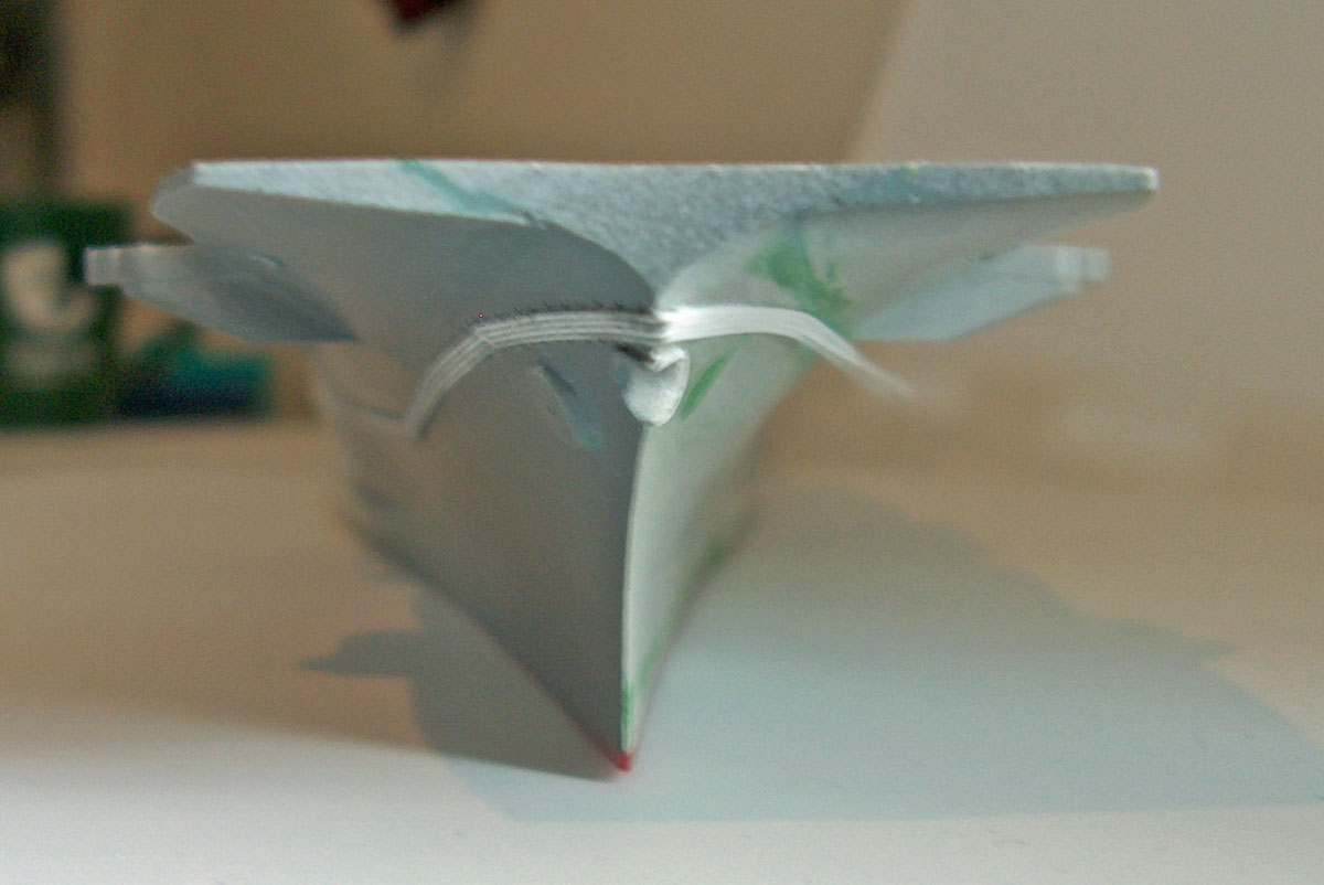

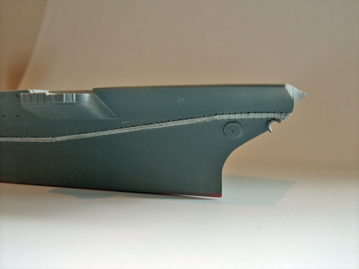

I'm back to work on my 1/350 Lex while i wait for some items to be released for my 1/200 Arizona. I am going to run the degaussing cable all the way around the ship because from looking at pics in WP33 (pariculary pages 21, 24 and the two page photos on pages 50 &51).It appears to me at least that it the cables run up above the stem hawse pipe and that also it may be a group of four just like what you see around the stern. I would like to get everyones opinion on this if they don't mind talking about it again. I don't know how to post pics at this time but if you would like to see what I have done so far, e-mail me at j_ryckert@live.com. Jon

I had a long reply to your post but for some reason Internet explorer quit working so I'll make this short so that it does not happen again. :) Please look at the upper pic on page 16 of WP11 and compare to what I have done.

One more. BTW, I have thought that what I may be seeing might only be ropes like what you see on pages 50 and 51 of WP33. A big "THANK YOU" goes out to Martin Quinn for the tip on picture posting.

Jon...great workmanship! However, I personally dont believe that the degaussing cables wrapped around the bow. It is my belief that they stopped aft of the anchor p/s postions on the fwd hull. This is based on the few poor photos of the Lex. hull for 1941-42. I believe that the fwd sweep you have depicted is correct (similar to CV-5). BTW, what diameter of plastic rod did you use....looks pretty accurate in dimension. Please keep us udated w/ your build!

Thank you Jerry. The rod is .015 from Plastruct. I drilled holes about every 1/8 inch above and below the cable which is probably to far apart for scale but I got lazy. At first I was 'sewing' it with copper wire but it looked too big so I got rid of the wire and went with nylon sewing thread that the soon 'misses to be' gave me but my eyes could'nt see that stuff so I'm looking for something else to use. Wish me luck. I can see your reasoning about how it may have been ran since all of the pics of carriers I've seen show it stopping where you said it did on Yorktown. BTW, in an earlier post you or someone mentiones how Saratoga's was ran in a certain pic. I saw the pic but the quality was poor so I could not make out any detail. Do you know of a better website with the pic? Thanks for the input

Pictures of CV-5 and and -6 show the degaussing cables entering the hull forward of the hawse pipe. A drawing I shot photos of for CV-4 shows the cables wrapping around the bow, but I have no photos that show if this was actually installed in this way. THeoretically if could have been done either way, but I have a hard time picturing a bow that fine running cables around it.
