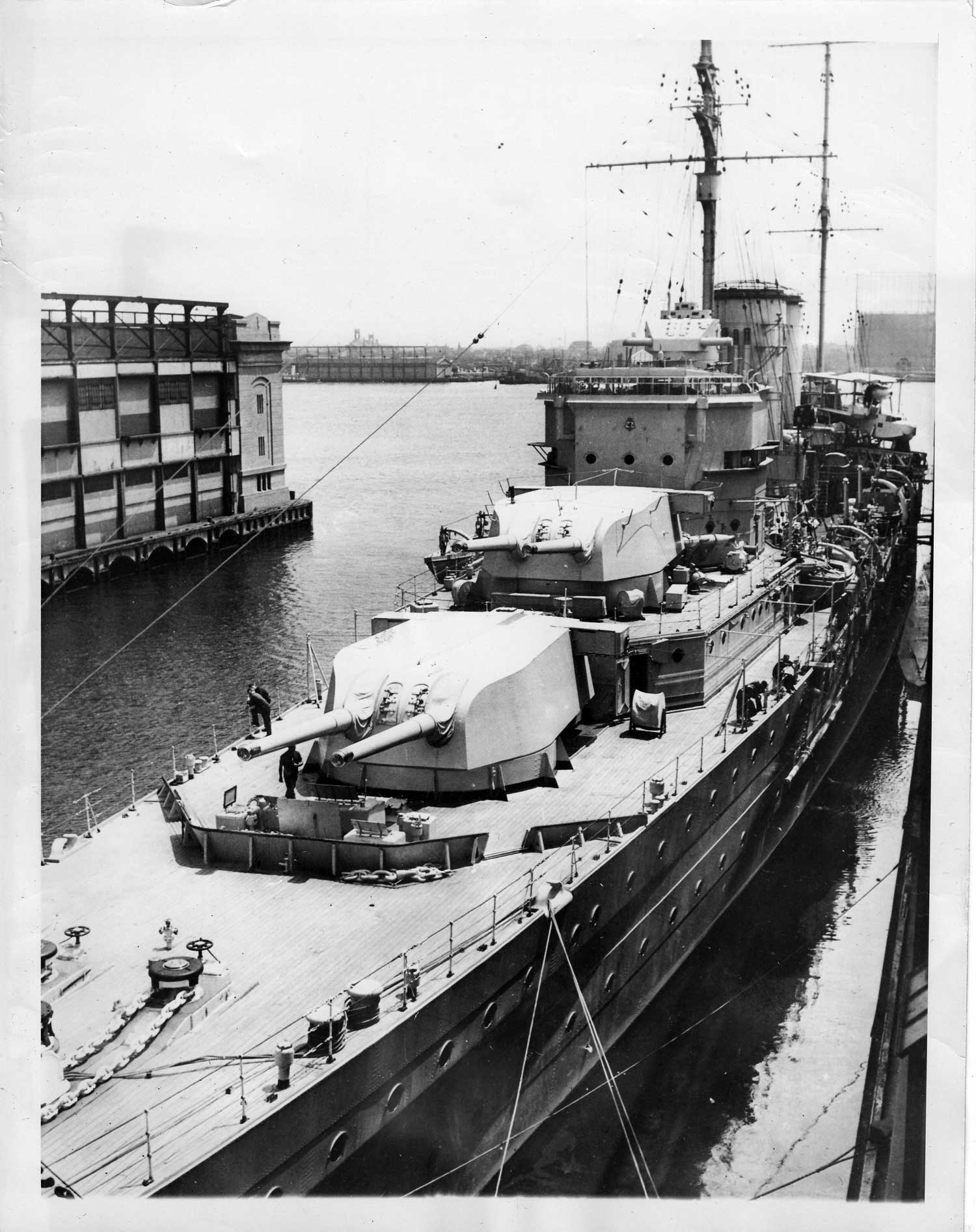

Marco wrote:Quite interesting picture here, I hadn�t seen it before, and only 5 months before the Battle of River Plate.
If you liked that crop Marco, then here is the fill image.
EJFoeth
Posts: 2931
Re: Calling all HMS York class (HMS Exeter-WWII) fans
Post by EJFoeth »
Incidentally, great pic; nice to see the cables' swivel piece stored in front of the breakwater.

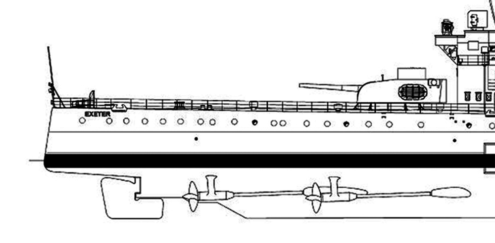

Hello all
I am helping a friend build a 1/96 HMS Exeter and need help with the shaft arraignment.
I am looking for photos of the Exeter or York shaft supports and strut arms.
Any help would be appreciated
James
KevinD
Posts: 490
Post by KevinD »

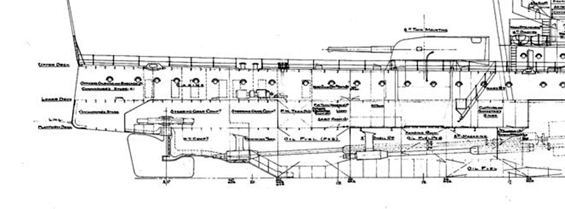

James M wrote:I am helping a friend build a 1/96 HMS Exeter and need help with the shaft arraignment.
I dont know of many photos that show what your looking for, as not many of her in drydock. I might have one. Would plans do?
Thank you, I have several plans, of which may or may not be helpful.
A photo would help figure out which ones are the correct shape and profile.
James

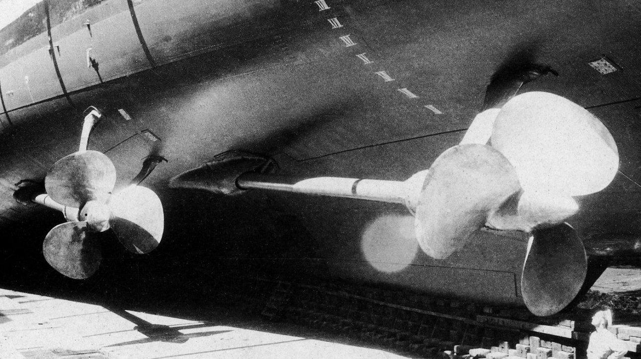

This is the only one that I know of in drydock that shows her props (barely) but not the struts unfortunately.
What exactly are you looking for re struts? I have recently been going over video of them / that area (on the wreck) maybe there is something I can pull from there that would help?

I'm looking for the strut info mostly.
I need some starting point on how long are they, what kind of taper or radius they have
The strut arms, how wide are they, what kind of radius do they have where they are welded to the strut bearing support
James

James, I am making the assumption that the prop/bracket arrangement was identical or very similar to a County class.
Perhaps this image of Canberra could be of assistance to you.
James M
Posts: 252
Location: Fullerton, CA
Post by James M »
Thank you Brett
That is exactly the information I am looking for.
It shows the detail of the shaft exiting the hull, the connection point of the struts to the hull and roughly how log the bearing support is.
