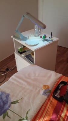

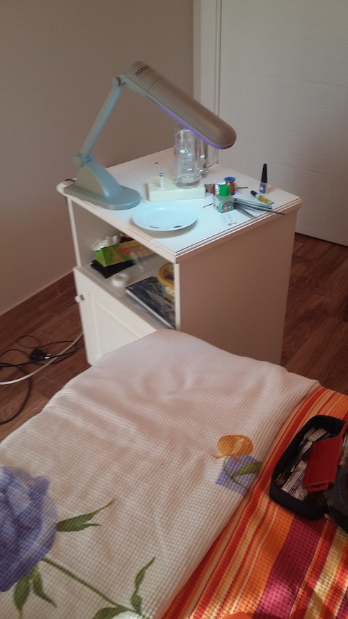

By the way, lack of hooby space is only an excuse if you let it be one!
We don't really need much space to keep going...
This is my holiday workspace when a family visit is continuing long enough for me to get permission to withdraw.
The rest of the time I was a bit more comfortable on the dining table on the terras, but still cleaning up for each meal...
Cheers!
Marijn
