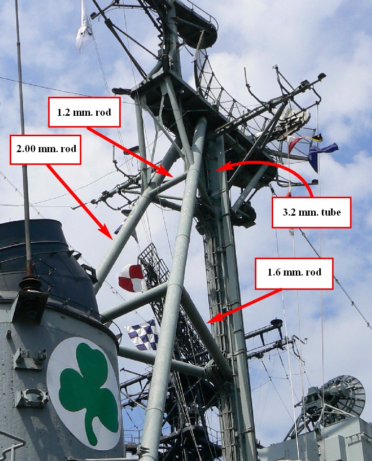

Next step was the main mast again, to build the cross bars, so that I can go on with the rest of structures and fine detailing.
This is the main thing to build.
As it can be seen, the cross bars are not uniform at all, and as the main mast was made with 3.2 mm. tube and 2.00 mm. rod, I found a compromise with cross bars in 1.6 and 1.2 mm. rods.
With so long elements I had to make a kind of scaffolding first, setting the mast in the upward position and adding strips all around, so that the three legs did not move at all. In the heat of the operation I forgot to make a picture of the whole scaffolding. This one was made when the strips were removed in the most part, but it gives an idea of the otherwise very simple process.
With all the strips gone, the glue markings were deleted with fine sandpaper, and there are no marks at all.
The mast looks now really good. The cuts in the bars had to be very precise, following the rake of the three legs. It took some time and some rod sections wasted, but it was done in due time with no further problems.

Your tripod mast looks excellent! Good work, as usual! The cross members are a bit tricky to get correct, in spite of being rather simple tubes. Once again, these were not a std. design as there are a couple variations of the basic mast. CASSIN YOUNG and THE SULLIVANS do not have identical masts - each varies somewhat in the basic structure. I think this was due to the type of RADAR unit that was intended to be installed and also (again!) shipyard preference in final engineering/design.

A correction of sorts about Tripod Masts on FLETCHER's (and SUMNER and GEARING's). The tripod mast was developed for the SPS-6 radar antenna after a few units had a SPS-6B antenna installed on a pole foremast. The pole foremasts (seen on early DDE's, both FLETCHER's and GEARING's) utilized heavy stays to keep the mast and antenna from falling over from the weight. To keep weight low as possible, aluminum was selected for making the Tripod Foremast. The Tripod Foremast was given a ShipAlt number and was specifically called out for use on the recommissioned FLETCHER's after being introduced on SUMNER's and GEARING's before the Korean War. However, for interest of frequency diversity, one or of four destroyers was directed to have a lower frequency radar installed (like SC-5, SR, or newer) and didn't require a tripod foremast. When the FLETCHER's were first upgraded after recommissioning in a near WWII configuration, the tripod foremast was often installed, but older SC radars and their antenna were installed back on the tripod mast. This was because demand for SPS-6, then SPS-6C, radars and antennas exceeded production with a sudden demand for 82 FLETCHER class destroyers being added to the fleet. Eventually, most units with tripods got SPS-6C radars installed. The planned one out of four plan for a lower frequency radar on all destroyers, didn't pan out in practice, with more units getting the SPS-6C radar than was planned and development of a new radar with lower frequency AND could be installed on destroyers was protracted.
So in fact the design and build of the tripod foremast were the same across the FLETCHER-SUMNER-GEARING destroyer fleet. However, things like antenna runs and new equipment (or different equipment) and waveguide runs being installed introduced different or additional platforms/brackets. Also, after a few years of use, the problem of dissimilar metals (steel ship and aluminum mast) causing corrosion became apparent after at least TWO destroyers experienced main legs of the tripod mast breaking off at the base at sea!! So mods were done to ensure that grounding straps had "backup" paths and beefed up base. For modeling purposes, these are invisible.
About half a dozen FLETCHER's got a revised tripod foremast, as seen on USS CASSIN YOUNG, designed for the new low frequency radars which reached service in the late 1950's. (the new low frequency radars were widely installed on FRAM and new construction) I call them "Step Masts" because the platform for the new radar was lowered for the increased weight. One of the destroyers planned to get the new radar and had the "Step Foremast" installed, in the end didn't get the radar, and she carried the SPS-6C radar and antenna on the new mast.

After the very basic work on the main cross bars, I have done something else in the rest of the bars, using 1.00, 0.75 and 0.50 mm. Evergreen rod. As hank points, there are many differences among the different units, but for once I have got some excellent pics of USS McGowan mast, so the work was easy this time.
Now I have to solve the problem of how to attach the main leg to the rear of the bridge, and then I will proceed inmediately to the fine detailing. I have many pictures of this mast, so I hope it will not be complicated.

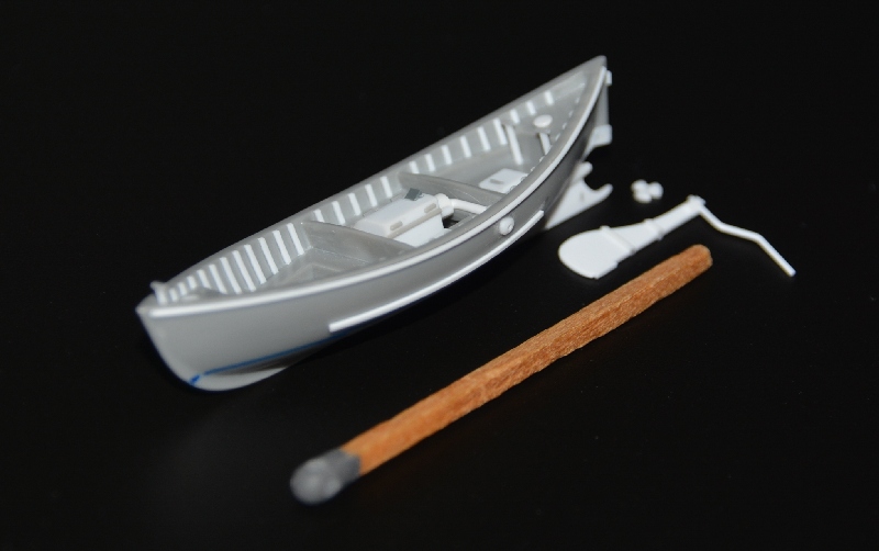

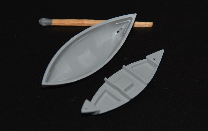

As I am bogged at the moment with the wiring on my mast, I have devoted some attention to the motor whaleboat. Hank sent me some months ago one of the redundant whaleboats of his 1/144 WWII Revell Fletcher. This model was actually one of the two described in AOTS The destroyer THE SULLIVANS, by Al Ross, pag. 117, the one without canopy, that is apparently the one that the sister ship Alcal� Galiano had onboard. This one :
Revell's whaler is very basic, really crude, but the general lines are aceptable.
Firstable I had to delete the motor canopy and open the deck to make room for the operator, and then to make the motor itself.
This whaleboat motor had a canopy that was not simmetrical, this one:
Once I had the information the canopy was no problem at all, as I had to use only some Evergreen scraps. For the detailing I could find one single picture, this one:
So I had to adapt the details, to make this:
The next step was make the rear section with the shaft and the supports for the rudder to form a curved line. I made this with three elements welded together with Revell glue (very thick) and then filed and sanded to the right proportions, and then more sanding to put the adition level to the rest of the keel.
After this I had to make a screw, simply a section of rod filed and sanded.
Then I added frames, hatches and some other small stuff, to give the thing some more detailing. Very easy.

Posted: Sun Jan 22, 2023 7:45 pm
by Willie
I don't want to glue the rudder and the screw yet to avoid potential damages with the masking tape when painting. As for now the thing is like this at the moment:
I hope you like it, and very best regards from this side of the Atlantic,
Willie.[/size]

Nice work on the 26' MWB!! I noticed that you have added frames on either side of the inside of the hull - this would be consistent with the boat as shown in your photo #1015, but only partially exposed. I can't explain this as the same boats in our navy had the framing covered, at least as far as I can tell by a photo of our 26' MWB on NEW JERSEY, the photo taken during her rebuild in Philadelphia in 1967-68 -
Here is basically the same type of boat shown in 1943, belonging to CV-10 -
My guess is that the framing was covered by the 1950s, but that's only a guess. I know STODDARD's 26' MWB was identical to the one on NEW JERSEY and both those boats no longer had exposed hull framing. It could also be that there was no consistent std. for how these boats were refurbished when they were brought out of reserve fleet storage.
I'm only pointing this out in order for you to have some pictorial reference to other similar boats. Since McGOWEN was transferred from the USN in the mid-60s my guess is that her boat may also have had her interior hull framing at least partially covered by that time. I searched thru the few photo I have of STODDARD's one wooden 26' MWB but they don't show the interior of the hull.
Your details, as usual, are over the top - very well done!! :thumbs_up_1:

Excellent fairing of the shaft, keg and rudder assembly. You might want to check the inclination of the shaft as it is probably not parallel to the keel bottom but inclined as often were the motor assemblies. I used to run a 26' MWB at one time, as I believe did Hank, but I never paid much attention to the details out of water (half century ago). I am glad you were able to make a nice work out of the kit boat hull. With our 3D printing program, Hank and I had much teeth gnashing to create an accurate smothed hull. By contrast the curved canopy were quite easy. Yes I have smashed either rudder or tiny prop a number of times on these small craft!
Just curious as to how you intend to suspend this boat from the davits, something i haven't yet done for Whitehurst. Fortunately wartime she only carried one boat.
