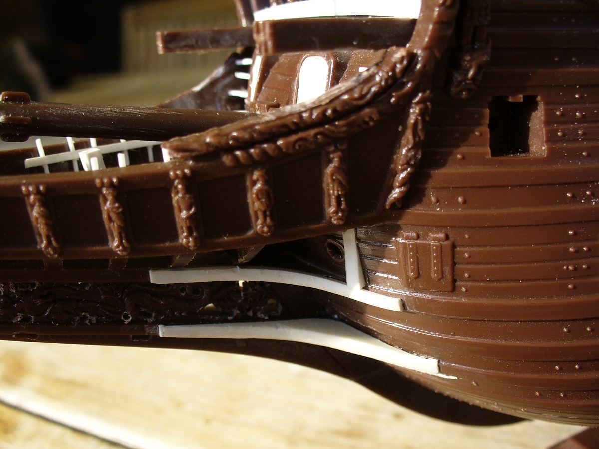

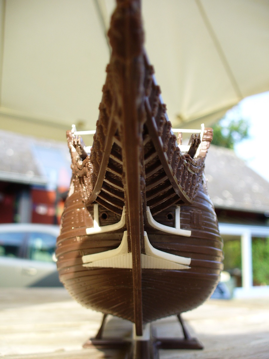

A small sidestep: the 'cheeks' are often missed in kits. here my corrections to the Airfix Vasa. Look at the considerable curves, if the part would be an angle (or worse: two separate parts) it would definitely be too weak. It is essential to be cut from an appropriate grown curved oak.
Btw: the Revell Wasa has these cheeks added correctly, but the Revell Batavia is also missing them completely!
